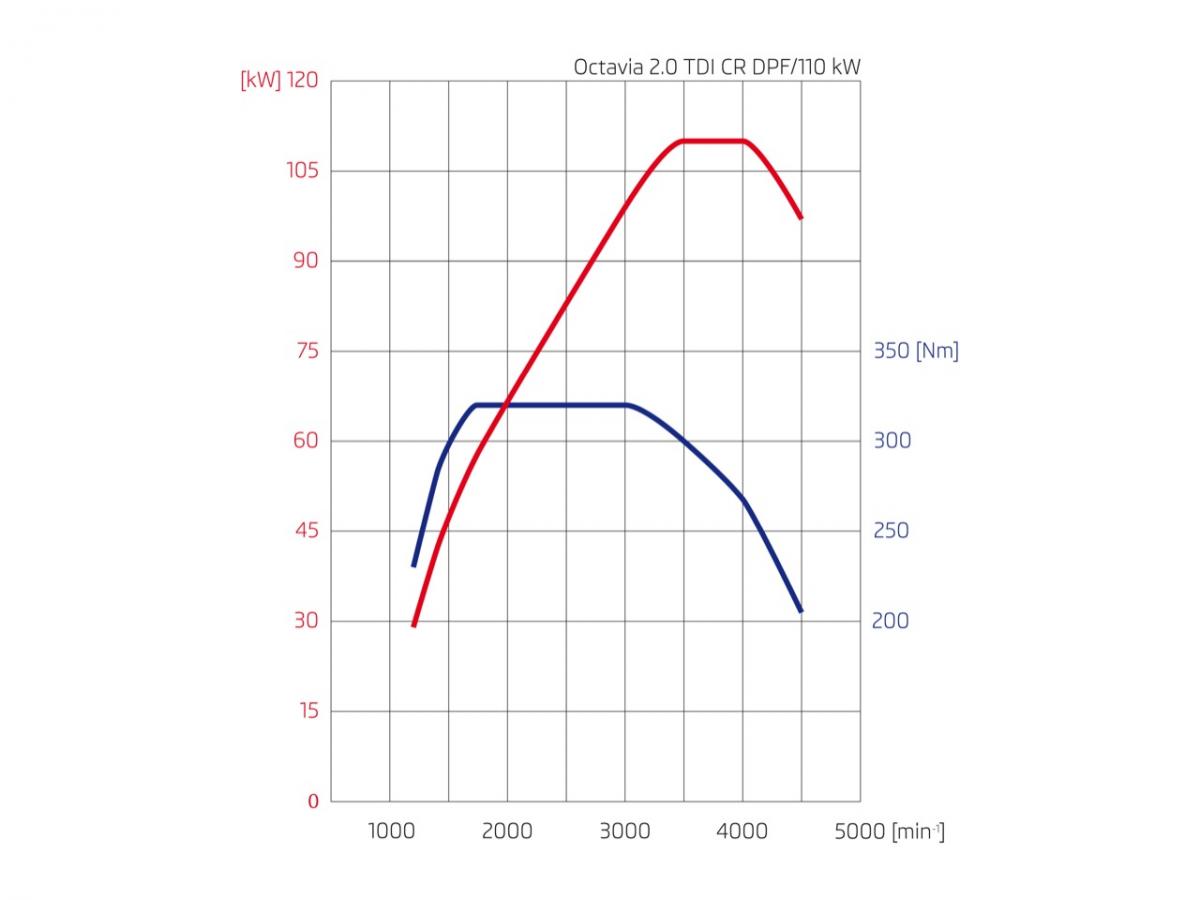

This may turn a bit technical for a Friday afternoon, but if you really want it to go then you need to target the power band rather than the torque band. What I'm about to say goes against the grain since even Clarkson and company accepted that it is torque that makes you go, but it is torque at the point of traction - where the wheel meets the road - that matters. Gearing comes into it in a large way, since the gear ratio fixes the torque multiplication factor between flywheel and road wheel, but also fixes the engine speed for a given road speed. Since power and torque are directly linked by the engine speed, it is actually the case that at any given road speed the maximum torque at the road wheel is found by choosing the gear that gives the maximum power at the flywheel. If you had a CVT box that can hold the engine speed at one single RPM point for all road speeds you find that the fastest performance is found at peak power, not peak torque as measured at the flywheel.
This is the reason that true racers prefer close ratio boxes and engines that peak high up the rev range. If you cane it and work the cogs it is the fastest way to get around, but it's hard work.
What low down torque gives you is a better spread of the power band and accessible performance that means you don't need to cane it at high revs all the time. It's not optimising out and out performance though, even if you believe that it is optimising the driving experience (which I do).
If the OP really wants it to get a shove on he should change down before he squirts the throttle, even in a modern turbo diesel.
Just to illustrate the point I took a look at the 150ps TDi curves (I couldn't find the vRS version) and the turbo is fully spun up at around 1700rpm. At this point you have around 50% of full power, which is very decent (in an old fashioned petrol engine with peak torque at 5000rpm and peak power at 5000-6000rpm you'd be lucky to get 20% of peak power at 2000rpm), but the best performance is still going to above 3000rpm.
So the car is very useable from 1700rpm if not at it's quickest, but it will be faster if you change down and below 1700rpm it's going to be a little sluggish (OK for cruising but definitely not overtaking).
