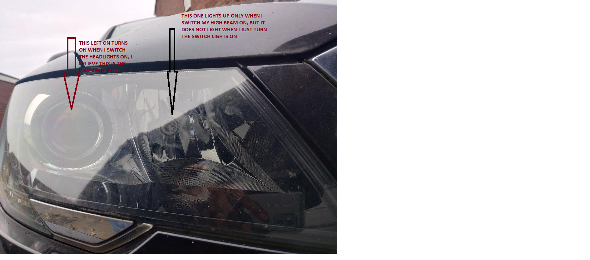

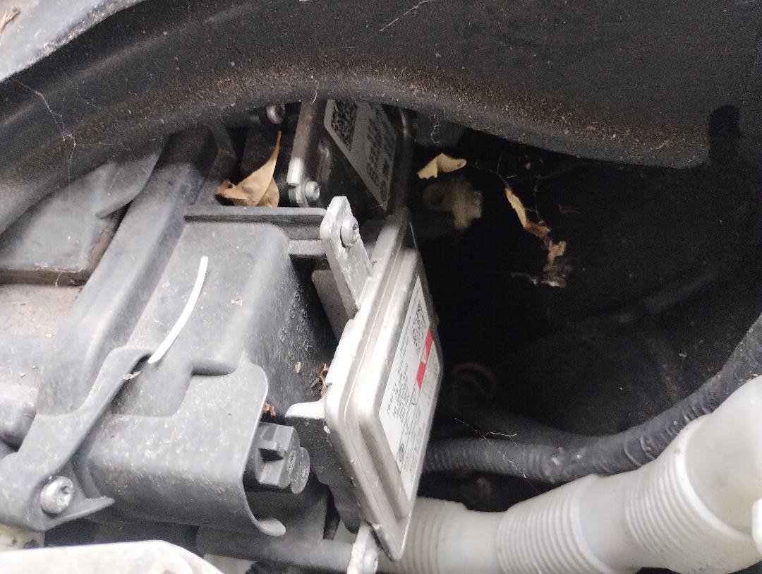

Headlight experts, I am happy to have stumbled onto this thread which provides some insights into bi-xenon headlights. I have a 2015 diesel skoda superb elegance mk2 170 estate and I was struggling to get to grips with what types of bulbs I have. My low beams were appearing to not project enough lights and I wanted to replace them. After entering my registration number on a parts website, it recommended H7 halogen bulbs and I bought two good quality long lasting osram bulbs and during the annual car service, I gave the garage the bulbs to replace what I thought were my low beam bulbs and they replaced them and gave me back the old bulbs which were also H7 halogen (they did not specify which bulb - low or high - that they replaced). I asked them how they replaced it given there was no rubber cap for access to the bulb (see picture below) but they just said it was a bit fiddly...I did not think any better and went home as all lights were working fine. However, I did not feel the low beam lights were any different from before, so I started searching and came to understand (helped by other skoda drivers on this forum) that I might have xenon or bi-xenon lights. Unfortunately, I was not sure which. To put my mind at ease, I went to a skoda dealer parts branch yesterday and I believe I spoke to someone who might not necessarily have been a technician. I initially gave them my registration number and after checking, they told me that I have halogen bulbs. I then asked him but why are there what seems like ballasts behind these lamps (please see pics attached). I asked him to come take a look under my the hood but he did not seem to want to. He went back to his office and came back saying I have halogen H7 for my high beam and xenon for my low beam. I thought I had single beam xenon bulbs but on trying to find out what type of xenon bulbs to look for, I ended up more confused as to whether I have xenon or bi-xenon bulbs. On reading the above thread, I now understand that it is likely that I have bi-xenon bulbs (i.e. when I put on my high beams, the high beam component of the bi-xenon bulb activate and the halogen bulb also lights  up - please correct me if wrong?). I would have liked to check whether I have xenon or bi-xenon bulbs by removing the bulb and checking its product number and find out on the web but unfortunately, I am not sure how I would access the bulb compartment because of the metal plate fitting (I believe these are 35w ballasts - I used the product number on the metal plate to check this) at the back of the lamp as in the attached picture. I do not have a workshop manual so was not sure how I would access the bulb compartment - if anyone has any idea how to do this, please advise. Do I remove the screws on the ballast fitting or do I remove the screws on the black plastic casing that you can see on the picture to access the bulb compartment. I will do this with the engine switched off of course, but is there any risk of voltage shock from doing this myself or should I go to a garage? The skoda shop person was quoting £50 just to check what type of bulb I have and diagnose the dim light problem and mentioned something like £240 for two single xenon bulb + labour costs on top. This sounds exhorbitant for a bulb change (if the dim light problem is only down to bulb replacement). The car is almost 10 years old which is about the life span of xenon bulbs so I felt new bulbs are in order. I will change the tail lights and indicator bulbs as well myself. Any advice here will be much appreciated. I have also posted a pic of what my headlamps look like. Thank you in advance.
A facelift elegance like this will have D3S xenon and yes, new ones make a big difference as they fade with age, mine on 63 plate car were changed at 8 years and difference was literally like night and day.  Unfortunately it's a bumper off job to get access to take headlamp out to get to all the screws you need to undo.  Old pre facelift cars used D1S xenon and could be changed in situ via little access hatch
Thank you @DrCorbyLee, this is very helpful indeed. It has been (and still is) a struggle to find out that information, so I am very glad to hear from someone who owns/owned a similar vehicle and went through that process. If you do have a link to where I can find very detailed specs about this facelift model, would be very grateful if you could share this. With the bulbs being that old, it is no wonder they are losing their brightness and it makes sense to get new D3S bulbs and see if I can replace them myself. If not a trip to a garage is warranted.

@DrCorbyLee - When I search for suitable headlight bulbs by putting in my registration number on car parts websites, they are only coming up with Halogen and D1S bulbs (no D3S bulbs). I am wondering now if my skoda superb model was the pre-facelift, although my registration number was after yours which you mention is the facelift version. Somewhat still confused I have to admit...
Looking at the picture of your headlights it's definitely the facelift car.
