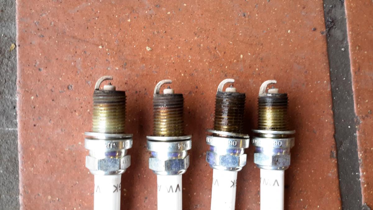

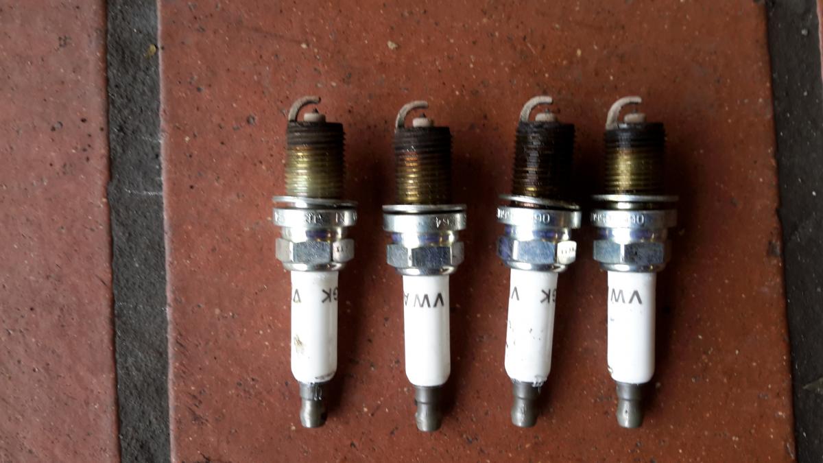

Photos of my Spark plugs from the change.
Have been replaced with NGK BKR7EIX's
Do these look like the car is running a bit lean?

Yes slightly
I'd need to have a look inside the plug to tell but from what I can see is lots of ash deposit meaning burning oil in all pots.
It also looks like the ignition advance is too much, there should be a dark(er) line roughly 1/3 up the ground electrode.
And yes, from the bit of the center ceramic bit I can see it could perhaps use a little bit more fuel.
I think because of the appetite for oil ECU reads the combustion as rich and leans it out.
Otherwise plugs are healthy, no damage and no signs of detonation.
Thoughts on the oil consumption Jabo cause/solution? I changed oil from 5w30 to 5w40 this service. Will see how that goes.
There are two ways for the oil to get into the combustion chamber in the quantities we are talking about here i.e. very small. Large amount of oil being burned manifests itself usually as a James Bond style smoke screen behind your car :).
In this case we have valve train or the pistons or more precisely piston rings. In charged applications valve train is less likely a culprit since any oil passing through valve guides along valve stems and into the combustion chamber will be pushed back due to charge pressure. That leaves the pistons and the rings.
As you know my experience with VAG motors is with the now infamous yet brilliant twincharger.
I have seen a report, probbly even through Briskoda, of worn oil scrubber rings causing oil usage, Replacement fixed it.
The most current, not sure if you follow mk2 vRS part of the forum any more, is the piston oil cooling jets. VAG is replacing them and it stops the oil usage, Apparently CAVD engines got it right and they are taking parts from those motors.
So oil is passing the piston rings from the crankcase and into the cylinders. This is exacerbated by high crank case pressure.
Also, a "thicker" oil helps as well. I am using esther oil Motul 5W-50 Sport with high resistance to fuel oil dilution. This seems to almost stop the oil use but does not cure it - I will be needing squirters replaced.
The other thing which almost ALL VAG engines suffer from is a dreadful exhaust manifold design. Cast iron log type unequal very short runners design implemented is simply unusable and kills those engines. Waay to much scavenging leads to poor combustion environment leading ECU to go bonkers, overfuelling or leaning them out.
I'd not mod an engine without sorting out the exhaust first. Some tuners got it completely backwards and employed stiffer valve springs to cure this issue. Stiffer valve springs are a great idea but it will not sort the underlying issue which is the engine suffocating. Exhaust first then the sky is the limit or the flow of the turbo actually :D.
Something like the 3" APR downpipe mated to the K04 Jabo? ;)
Thanks for the response, very informative. I know we have talked about that Motul 5w50 oil before and it sure looks good. Certainly something I will consider when the engine work is completed.
