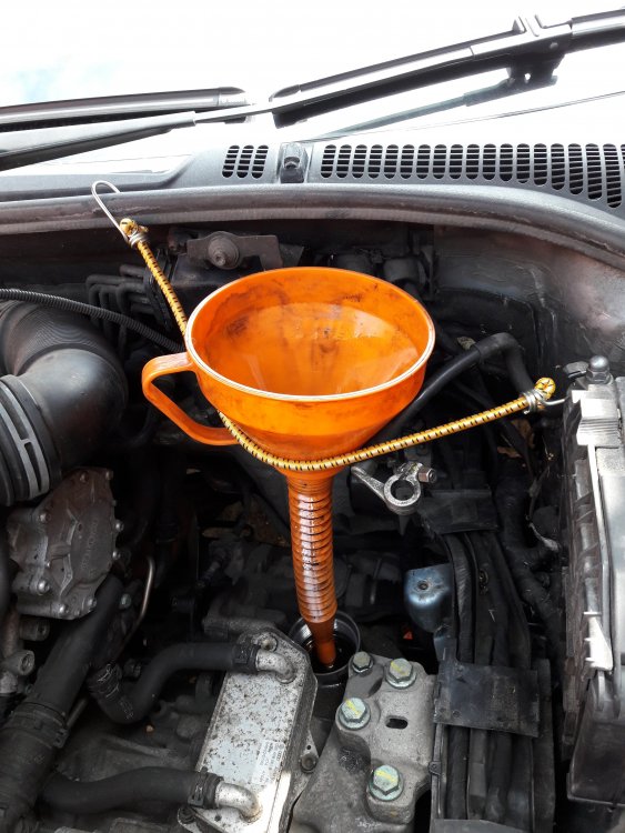

  • I've just done my DSG gear oil change.   On a difficulty rating of 1 to 10 (10 being the hardest) I'd say it was about 3. No harder than doing an engine oil change.   The fiddliest bit was removin

Have you got the right tool to fill it? As you fill from the bottom I believe? Also something about the oil being 35c and monitoring something with VCDS as you fill?
Phil
You only need to measure the temp when doing the bottom fill method as there is a plastic insert in the drain plug.
You basically overfill it, get it up to temp, then let off the bottom of the drain plug and let the excess overflow over the top of the insert.
This is far quicker and is what the dealers do, but it relies on the temperature being correct, and can result in being not filled enough if too much spills out.
You can fill from the top with just a funnel, it's just much slower.
Measuring the amount of oil released and then refilling the same from the top is easiest to do as far as I can see :)

Do you fill through the filter housing then?
Phil
Yep, it's just a small hole so takes ages to drain.
