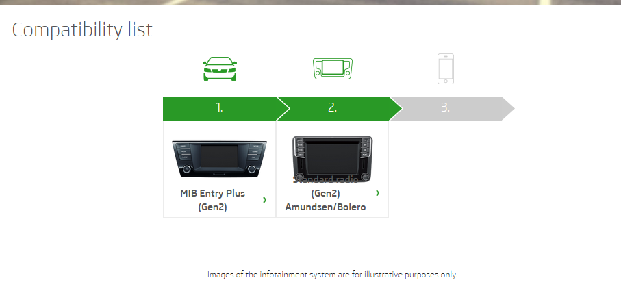

That is the generic blurb though. What happens when you put a valid chassis number in?
If you follow the link for the list of supported devices and choose an O3 with Columbus manufactured between 04/11/13 and 03/11/14 and then choose a phone that supports MirrorLink such as a HTC One M8 there is no mention of MirrorLink functionality.
Do it again with a Columbus after 03/11/14 and still no mention.
Someone must have a chassis number of a O3 manufactured after 03/11/14 with a Columbus in it to give that a try and see if anything different happens. Interesting that the only Gen2 MIB unit being fitted to the O3 after 03/11/14 is the Entry Plus.
I would love to be proved wrong and all of sudden MirrorLink is available as a firmware update, but that would be dealer only anway as SVM kicks in after a firmware update.
Also, if you choose the new Fabia it shows you what the Gen2 Amundsen/Bolero looks like.
The Update Portal mentions a MirrorLink upgrade for Columbus and it only lists one Amundsen - 6.5" screen, no DVD drive but with MirrorLink. That must be the Gen2 (Yeti only model). The picture shows the 5.8 inch version though.
And what if the MirrorLink upgrade exists, what should you do if the car is delivered with Mitsumi instead of USB ??
That seems to back up the notion that mirror link is not available on older kit, needing Gen 2 hardware. Go to the Czech configurator and you will see for the new Fabia that you can spec a Bolero, which specifically mentions mirrorlink. And looking at the info it specifies USB connection which includes Apple devices (much like the current Columbus) "Aux in, USB vstupem s Apple konektivitou, SD slotem, Bluetooth audiostreamingem" > google translates to > "Aux in, USB input with Apple connectivity , SD card slot, Bluetooth audio streaming". Mitsumi is history for Gen 2.
I see that configuring a Yeti on there too gives a Mirrorlink option when ordered with Amundsen and Bolero - so they will be Gen 2.
