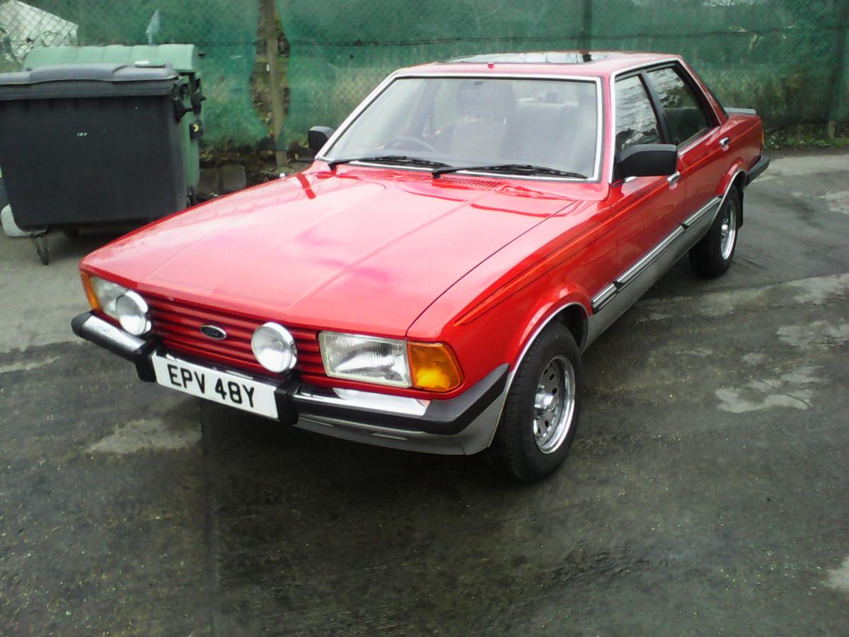

Cor Blimey!, It's A Cortina Crusader!
:envy: very nice :)
Wow! That's tidy, it looks better than new.
Wow thats really impressive condition!

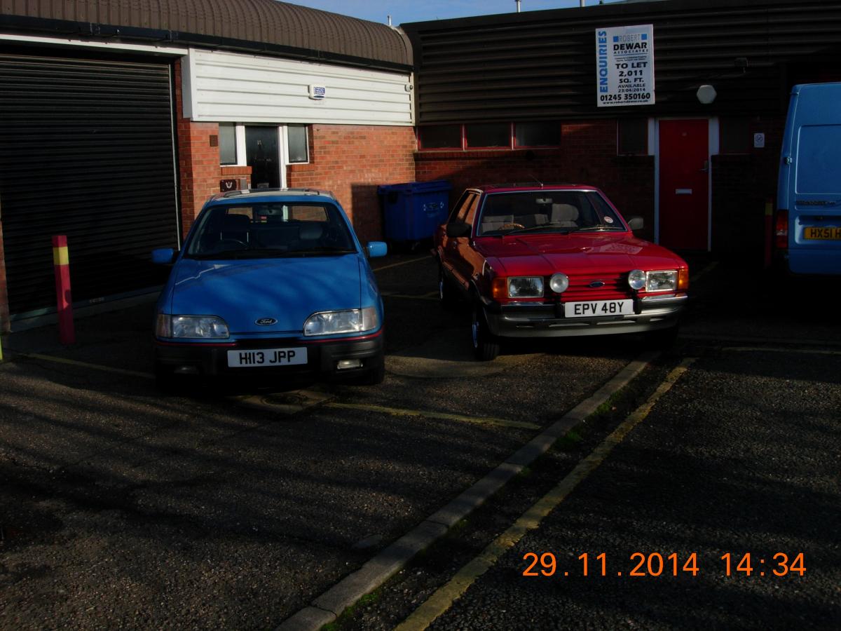

Do you still have that blue Sierra?
The Sierra is going strong, it did nearly 500 miles at the weekend without a problem.

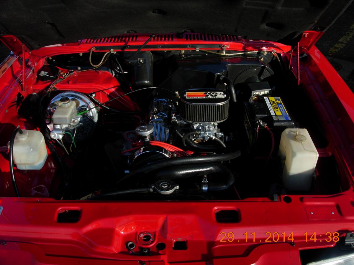

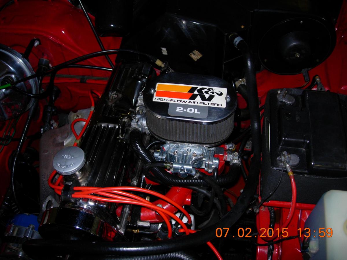

Is that just a K&N or has it got the 3.0 capri carb mod done on it as well?. Lovely condition, makes me think of my old 2.0 ghia. Just not sure if I like the steering wheel or not - probably looks better in person.

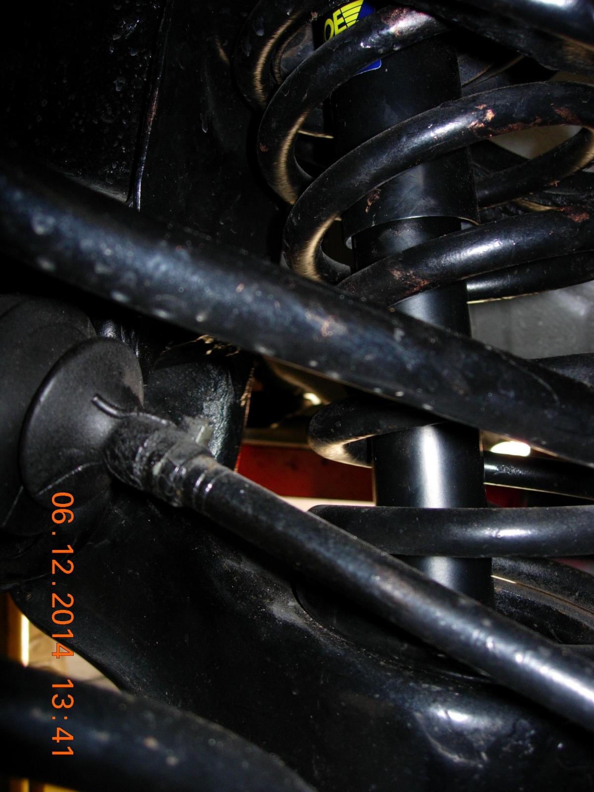

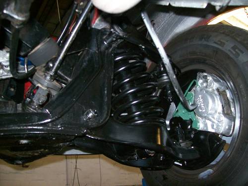

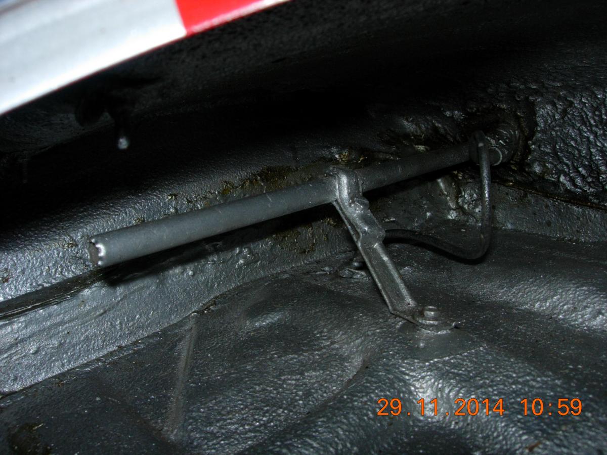

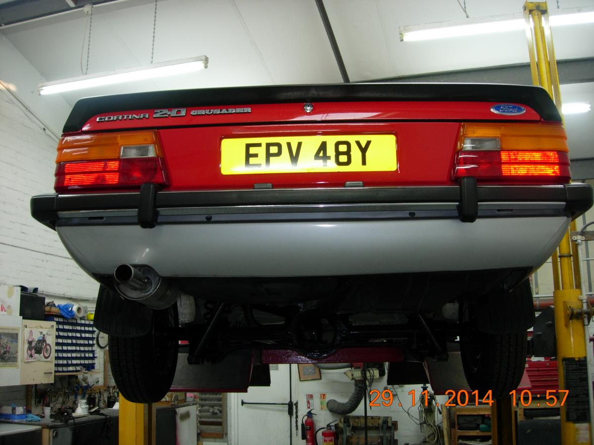

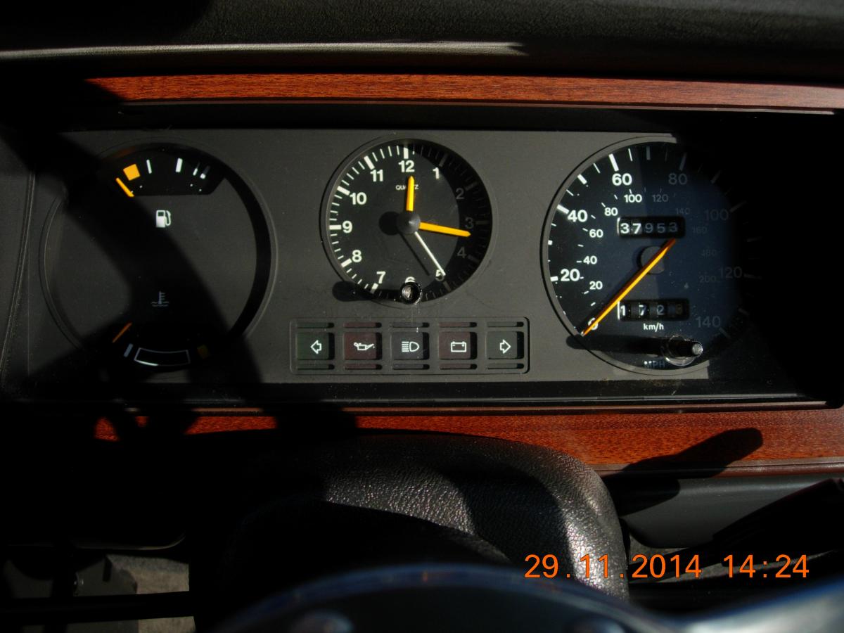

Had a bit of time on it yesterday to find out what needs doing.  New shock absorbers all round, sort out the 40 mph steering wheel wobble, look at the brakes.  It had done only 65 miles over the last 3 years.
Gave it an oil & filter change, checked the gearbox and back axle oil levels, inspected the cam belt and cleaned the cover, drove it a little and took some pictures. The foam on the wings is quite oily, so hopefully no major rot problems.

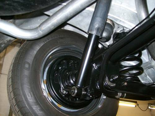

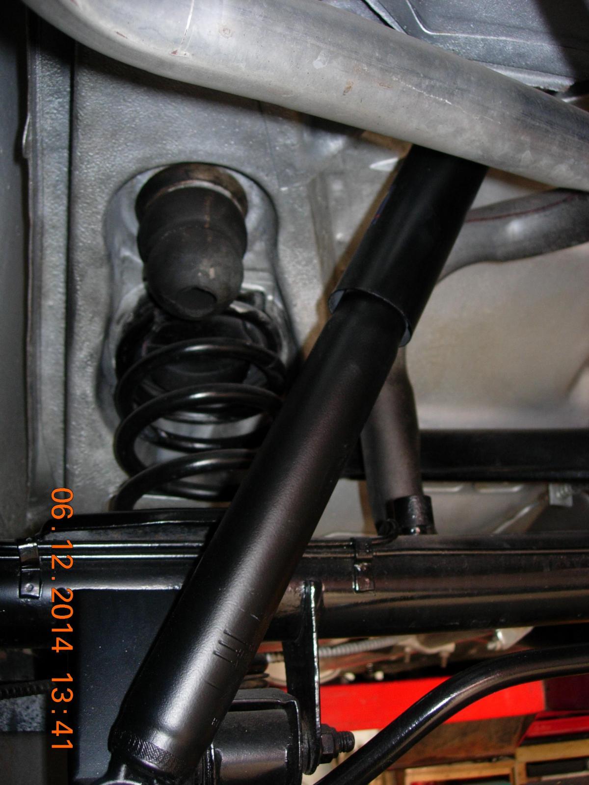

Not quite, a bit of research shows that it's around £200 new.  It's now been replaced by the original which is in as new condition.  A set of new shock absorbers fitted today has made it noticeably less bouncy.

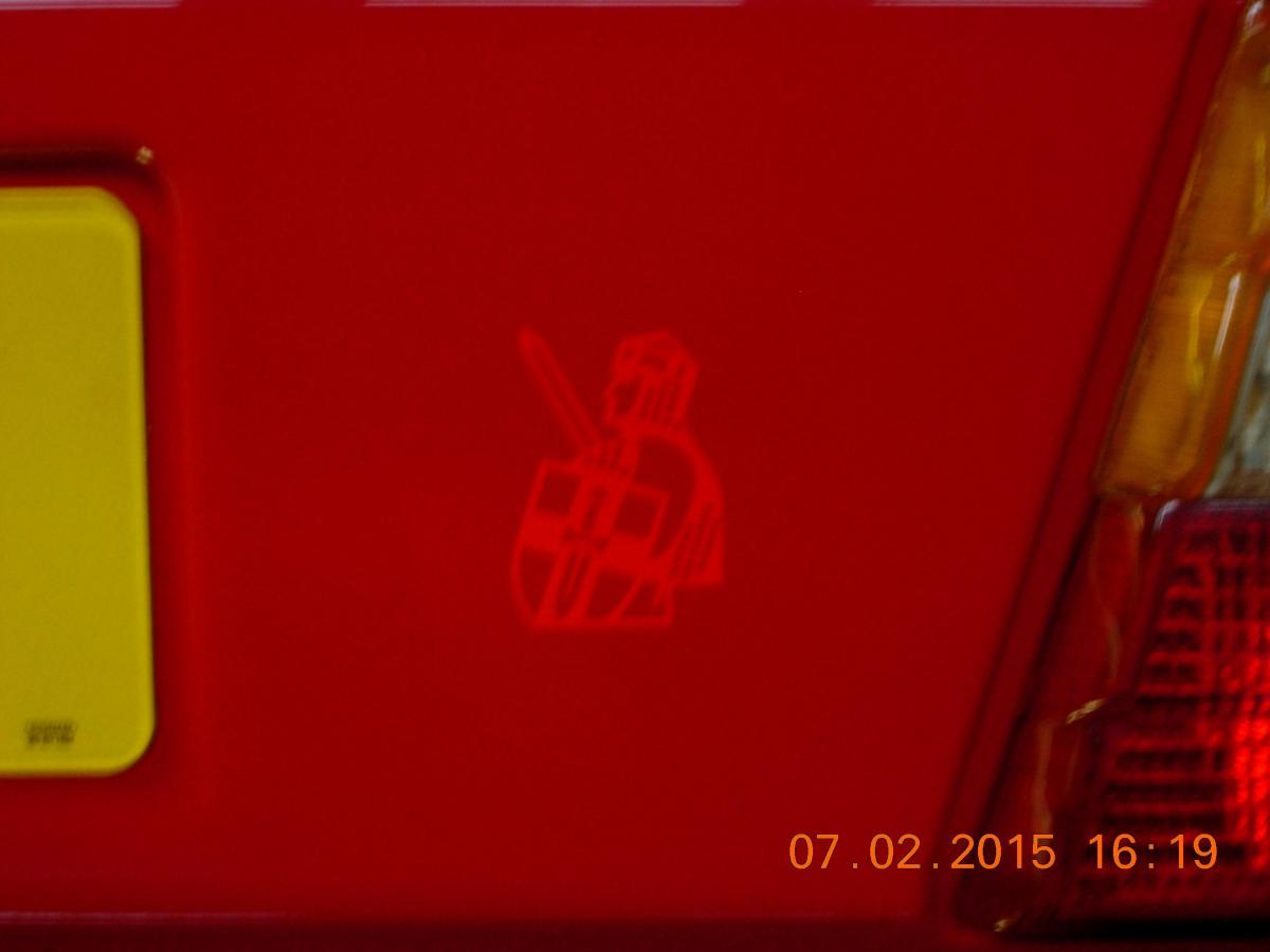

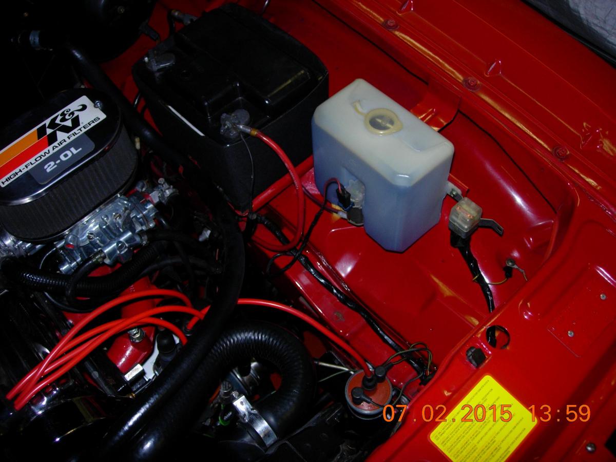

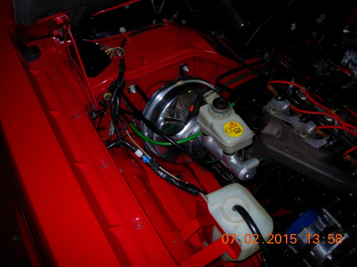

General fettling and cleaning around the engine bay and a few stickers added for coolant, engine capacity on air filter, brake fluid and rear panel logo.
Replaced a bulb, wired in the radio correctly, added an alarm some immobilisers and remote central locking, removed some extra wiring and interior lights which were added by the previous owner.

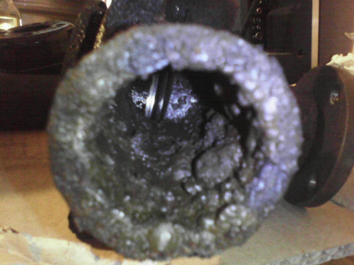

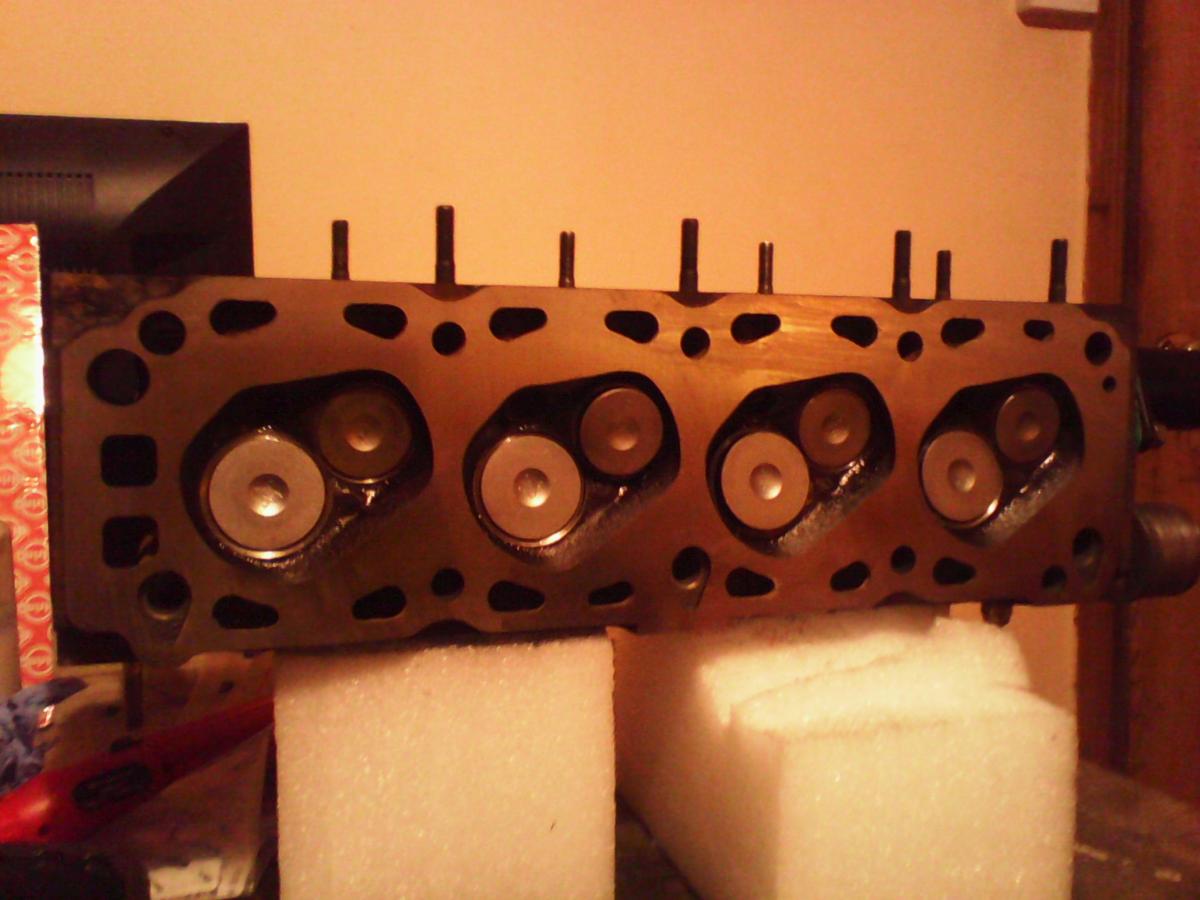

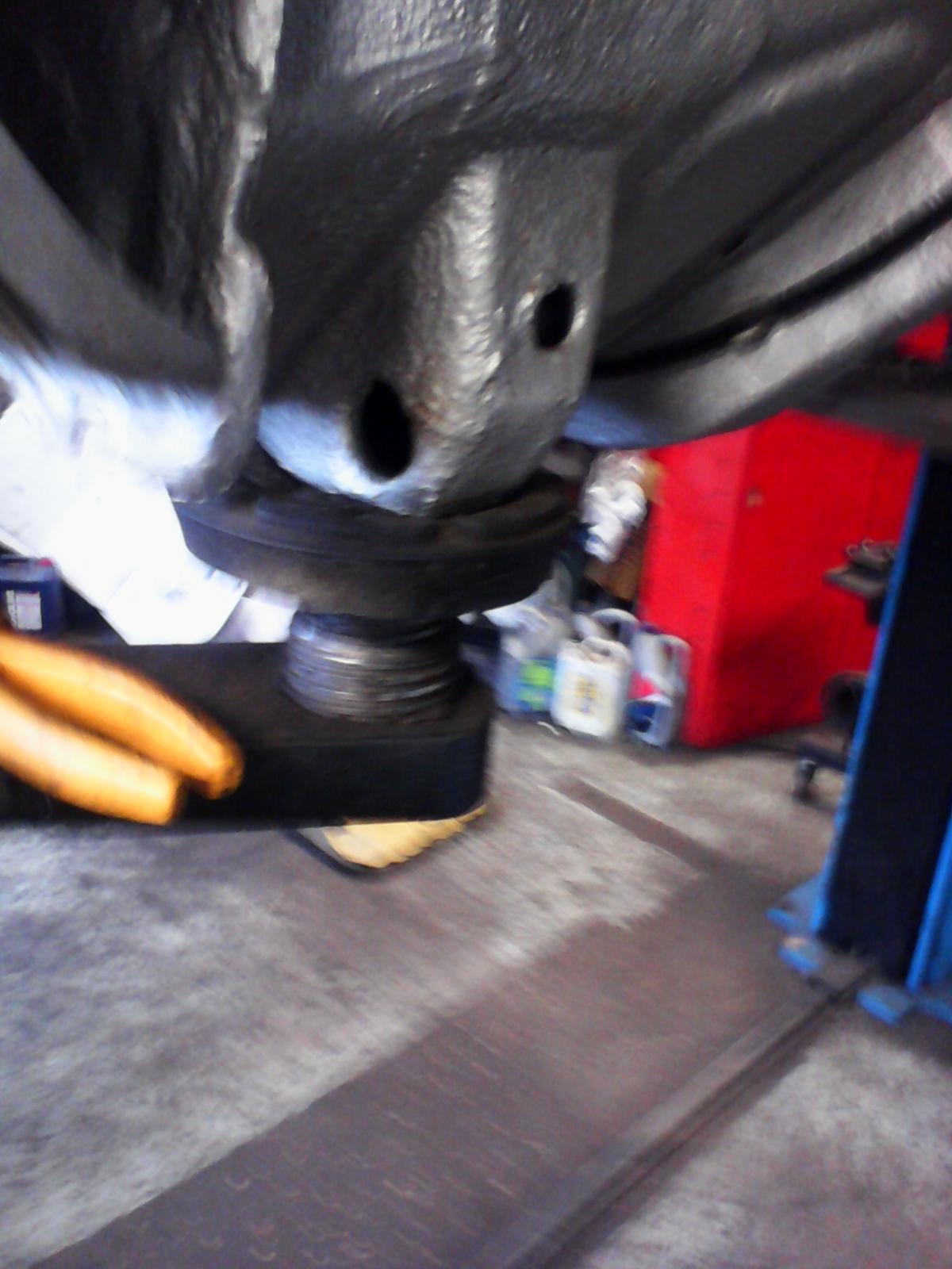

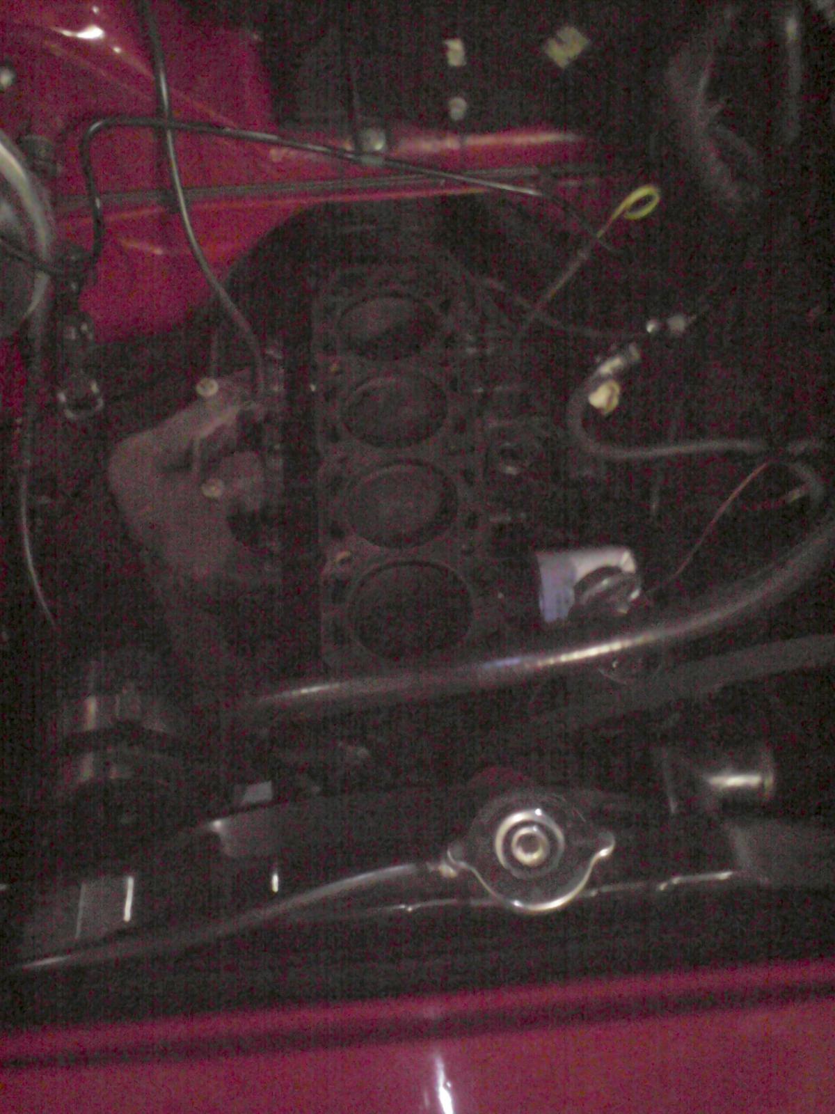

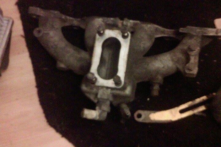

Today I went to replace the valve stem oil seals, using a lever so that I didn't need to remove the head.  I nearly completed the first one which was fiddly and thought that I didn't fancy doing the next seven too much.
This was the result:

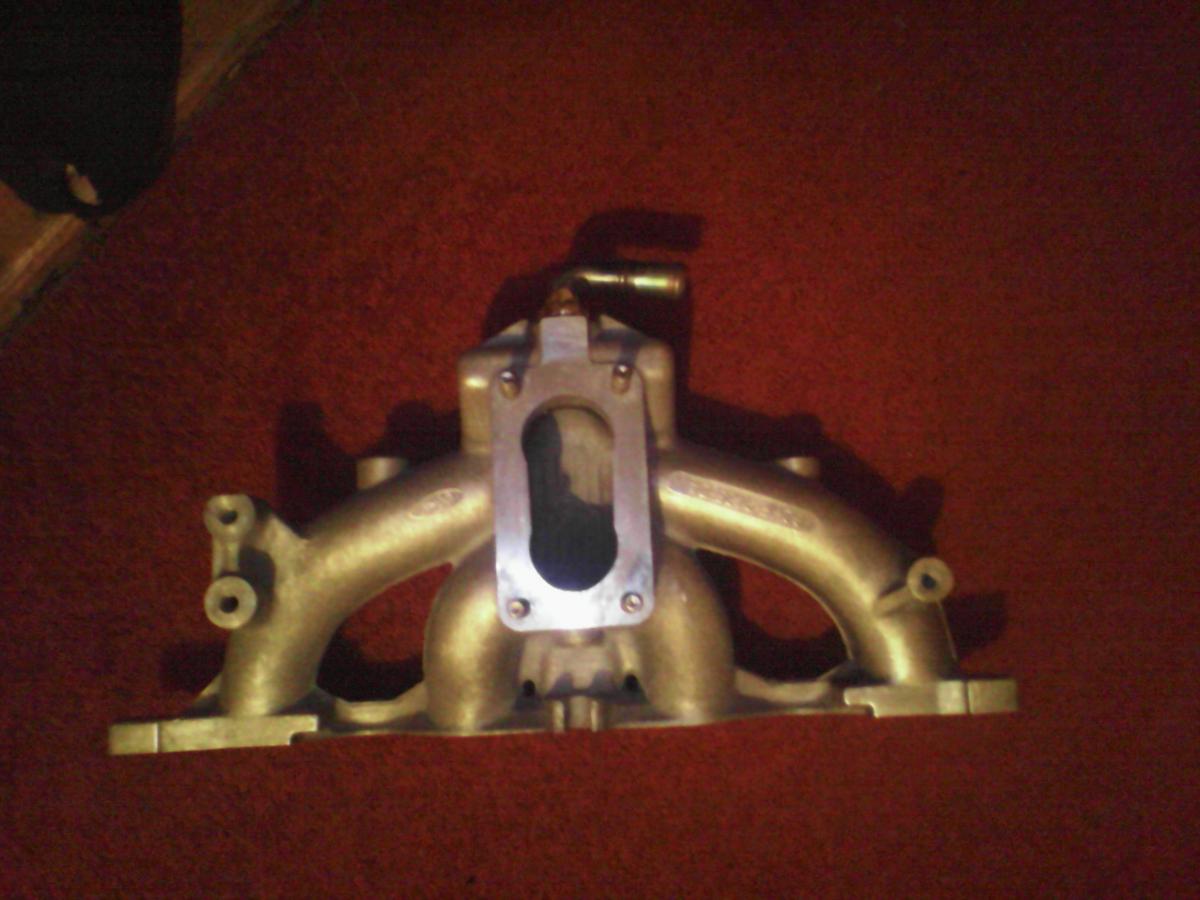

I may as well get an unleaded conversion done and clean up the bits that I can now get to.

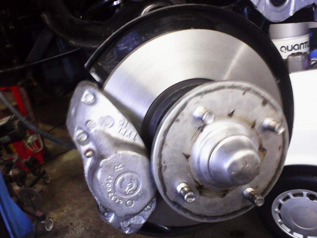

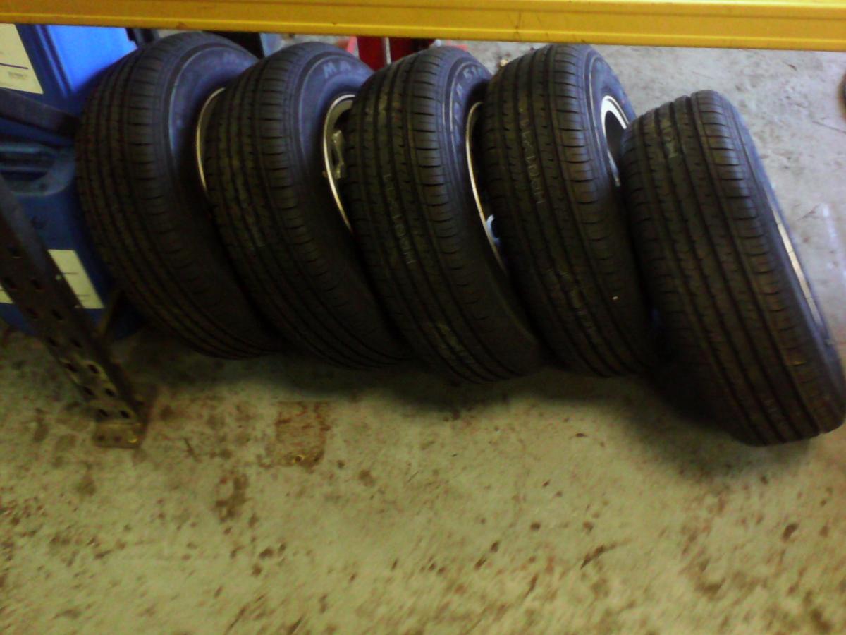

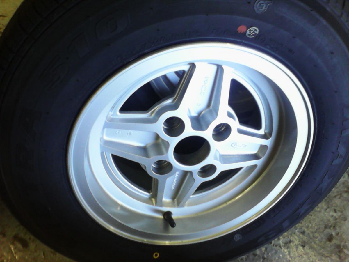

I chucked the wheels on it on Saturday and the wheel wobble has disappeared, it drives quite nicely now.

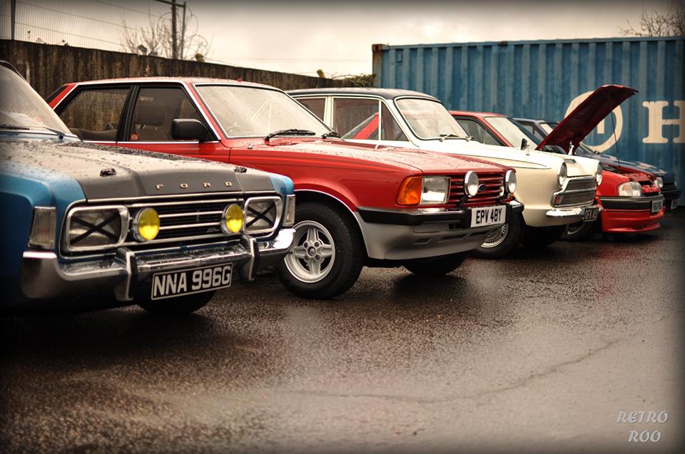

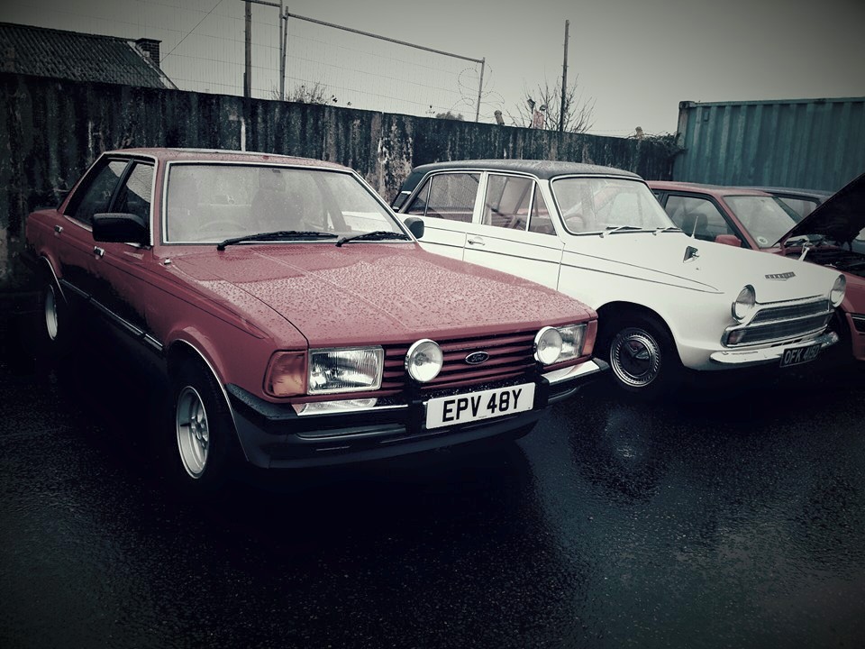

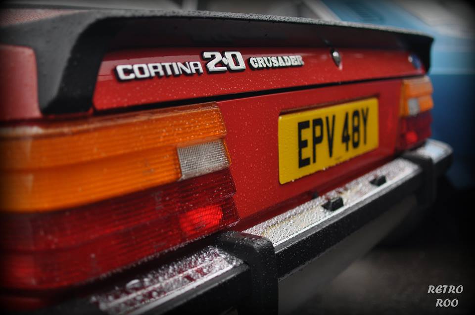

I took it to a show at the local transport museum yesterday, it was a bit wet:
Despite the weather we had a good turn out, even if at one point it did look like a Ford show, we even had a free ride on an old bus.

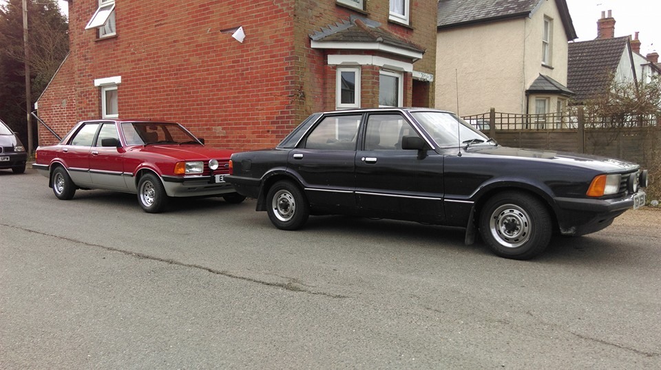

Some pictures of the Cortina, taken by others:
