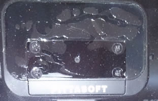

Looking at the adhesive mount from outside the windscreen, the adhesive now has many air bubbles trapped inside the mount - when installed it was perfectly even across the glass, so I am guessing the adhesive may become somewhat more fluid when heated. Adhesive pad is black which would not help - all our motorway tags have white adhesive tape, possibly for that reason. Having said that it shows no signs of detaching from the screen.
Rear cam (liftback) is much cooler thanks to dark reflective tint installed. Muddies the video a bit though.
I spent ages trying to get the mount on the windscreen with no bubbles or air pockets. Even the plastic base below the adhesive isn't 'flat' so I'm pretty certain it's nigh-on impossible to get the mount on without any air trapped. Are you sure it was perfect when it first went on?
I'll have to agree, hot or cold, once that adhesive's on, it's on. I fear for the plastic mount if you try and pull it off the glass. it's impressive stuff!
OK not 100% perfect but much better than it looks now. At most it had a couple of very tiny bubbles.
Not easy, but in the past I have improved stickies further by pushing a pin between the glass and the sticker and then squeezed the air out along the side of the pin (if that makes sense) then when it's as good as you can get it, pull the pin out while pushing firmly on the mount to stop the air getting back in.
I've always found the double sided 3M sticky sheets that you can get from the likes of amazon to be the best. A bit of give in the sheet seems to help avoid vibration and no air bubbles from what I can see but I've never been able to get that close to look  at the middle of the screen if it's anything like the pic above from sjabs101. It certainly looks fine from what I can see.
Some handy tips thanks.
In my case the original mounting was fairly even with almost no bubbles but once this thing heats up the bubbles appear. I will soon find out if the bubbles eventually break the seal as summer has a way to go yet. My motorway tag is bubble free (white adhesive) and sits next to the camera. Lucky the Blackvue has wifi to download videos so rarely need to remove it from bracket.
