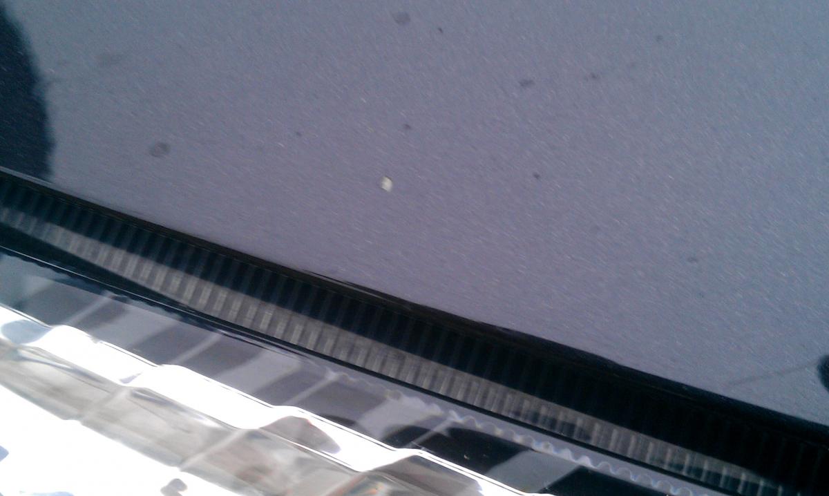

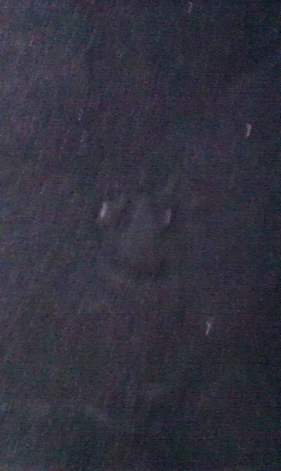

Update on the paint blisters on my Yeti, jury's out with BLADE SKODA GLOUCESTER as dealer etiquette was called for. Warranty Claims manager says he had not heard or seen zinc inclusion blisters so I was not surprised by his diagnosis of YES YOU GOT IT "stone chips". Without prejudice will probably be order of the day now the claim is going in and I am hoping SUK will honour the paint warranty as so many have been mis diagnosed before. Never had a problem with my ROOMSTER or my PASSAT in my 10 years of loyalty to VAG/SUK .
Stone chip v paint blister.  Mis diagnosis. Logically I see stone chips on my car that have only taken off the paint revealing the anti corrosion primer underneath, NO RUST and NO BLISTERING. These stone chips have been caused by a hard object striking the front of the car at a great velocity. The side of my car, the doors to be precise have some advanced paint blisters and some just becoming visible. I fail to comprehend what object could have struck the door with such force that the paint and the anti corrosion layer were damaged sufficiently to cause rust blisters before the stone chips on the front of the car. I have tried to download pics of a stone chip and a blister for comparison.
Anyone with similar thoughts or reasoning?
Maybe as a layman my common sense is misguided.post-126476-0-76111600-1423732226_thumb.jpgpost-126476-0-15441600-1423732285_thumb.jpg
Classic zinc inclusions.
Skoda initially refused to authorise warranty on the worst of the two rear doors on my 61 plate Elegance DSG but strangely agreed to do the front doors ,which looked like road rash! The paint on the rear doors had obviously bubbled from the inside out and you could clearly see where more rust was beginning. However Benfield at Harrogate,who incidentally were not my original dealer persisted on my behalf and after a bit of a delay,all 4 doors were re-sprayed at the bottom. So far so good. The key is to not accept the first refusal because on previous occasions Skoda's first response has been to refuse e.g rusting rear brakes. I love my Yeti but since I've had it since new, both front shocks have failed and been replaced under warranty, the rear brake discs have also been replaced which is a bit disappointing in what is supposed to be a fairly rugged 4x4. I also near total brake failure when a hose at the front burst, fortunately at low speed. Whilst the split system is supposed to prevent total loss you soon learn that without fluid there is very little the system can do to overcome this.
Just hoping the images BLADE GLOUCESTER took will be good enough to prove the point however the claims manager gave the impression I was wasting his time with "stone chips" but as you can see the "blister" on my less than 3yr old yeti is not a stone chip! I will persist as you suggest because if a refusal is forthcoming I will ask for a second opinion at a dealership aware of "zinc inclusions".
