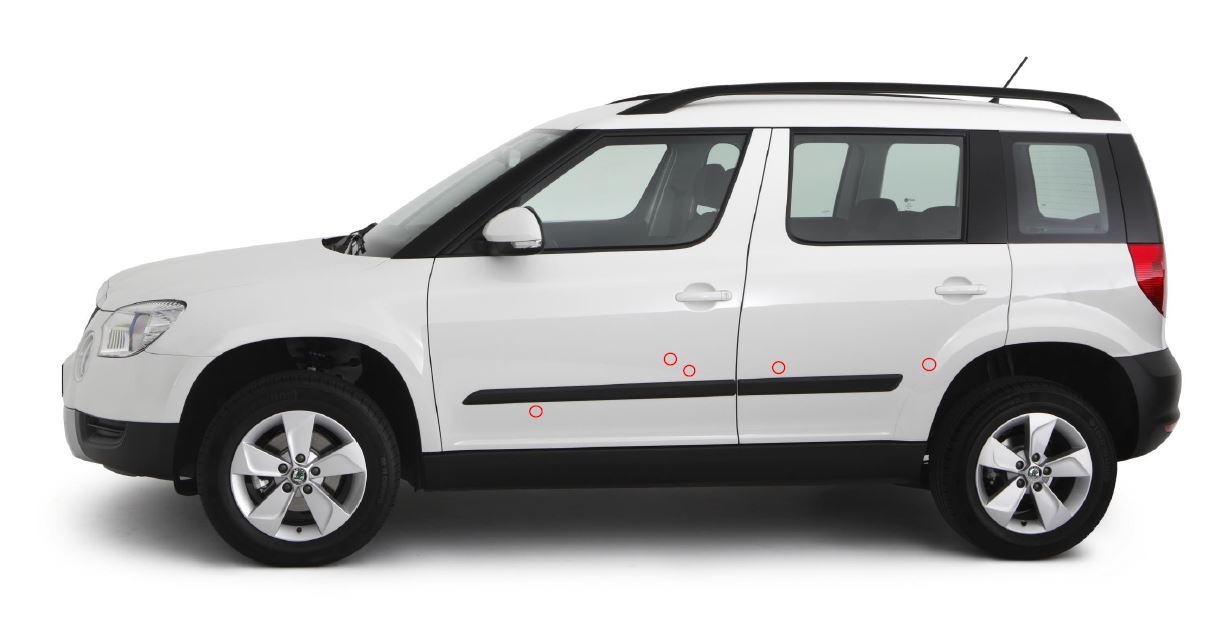

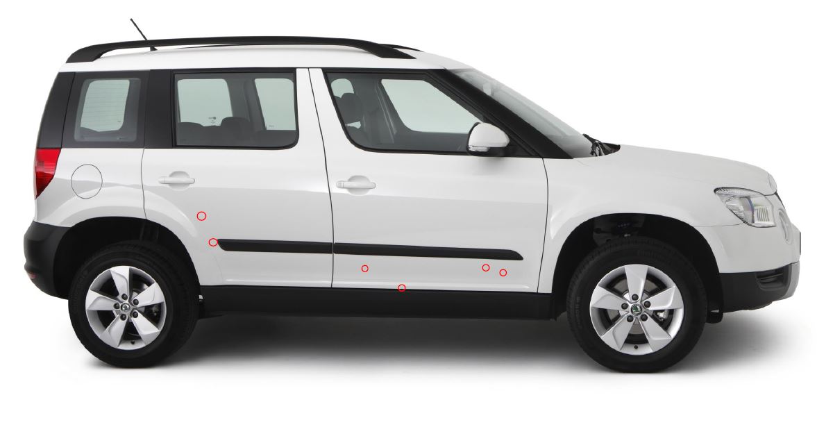

This is where I found the bubbles on my Yeti in 2014.
Time for a new inspection, I guess?

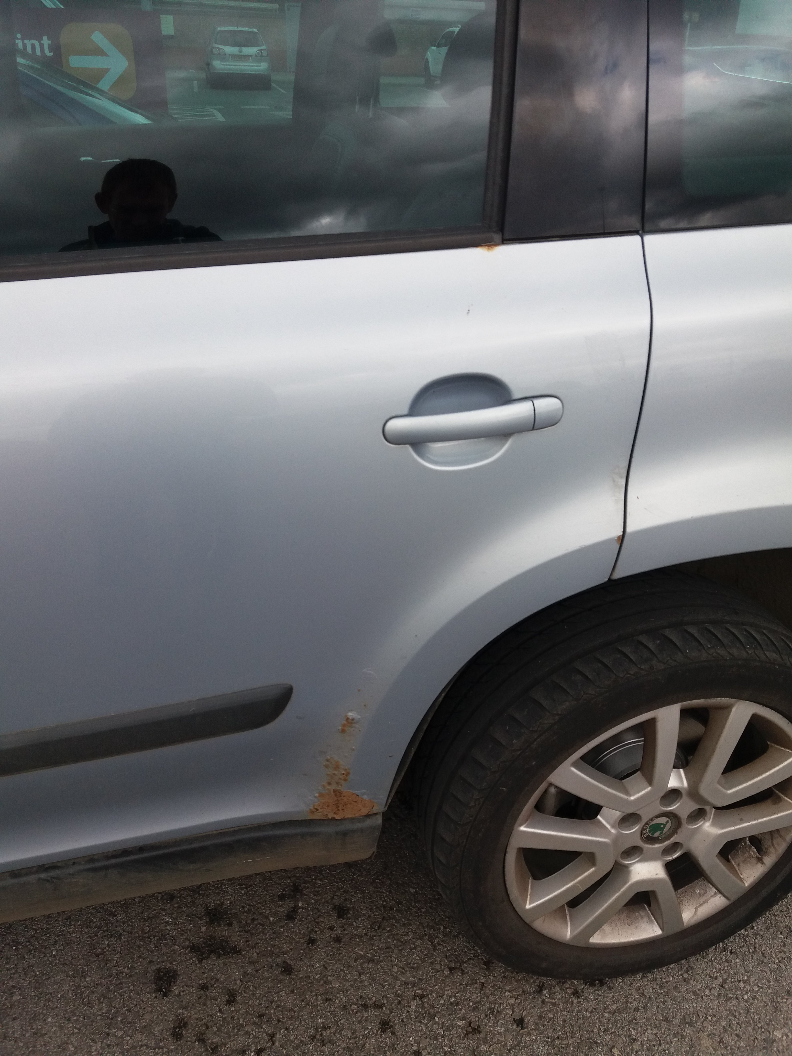

Just saw this in Sainsbury's car park in York today.
A 2009 (59) Yeti, very much unloved looking at its overall condition. Still a very unpleasant sight...
I'm assuming it's lived a rural life spending a lot of time on rough roads, the missing foils have taken their toll on this 9 year old Yeti.
The rust spot on the trailing edge of the door could easily be from fair wear and tear, the rust spot under the window frame could however collaborate the theory that Yeti's of a certain era are poorly protected.
At least it's had new rear discs recently :D
Edited by silver1011
