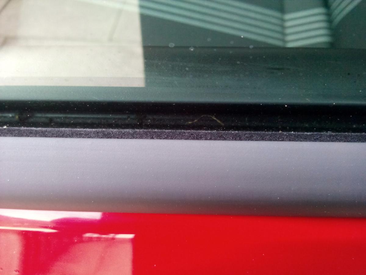

Just taken the car into Alex Lawries,basically they were not interested started by accusing me of 'using chemicals' on the car! and then when I explained it was a common problem with the green mould/algae growing on the seals I was accused of not cleaning the car properly.Have to take the car in again next week for the 'warranty guy' to have a look.Waste of time and petrol.
Took the car back today,started off with 'we will take photos and send a report to Skoda'.By the time I left this had been advanced to just bring in next Tuesday and we will replace both window seals.Will report back next week.
All done!,looks alot better now.
Whoops the photo did not load, see if this works.post-59816-0-49457200-1429008007_thumb.jpg
Great that's better [emoji4]
I used to scrub the bottom window seal when I had a Citigo, at 2 years old they were ok but Kept on getting the green algae on.
Now I have the Toledo it's on all 4 window seals, all cleaned up now but I bet it will be back after a few weeks.
Might just be my eyesight but,I think the new trim is different from the old trim-a little thicker,more sturdy perhaps.
