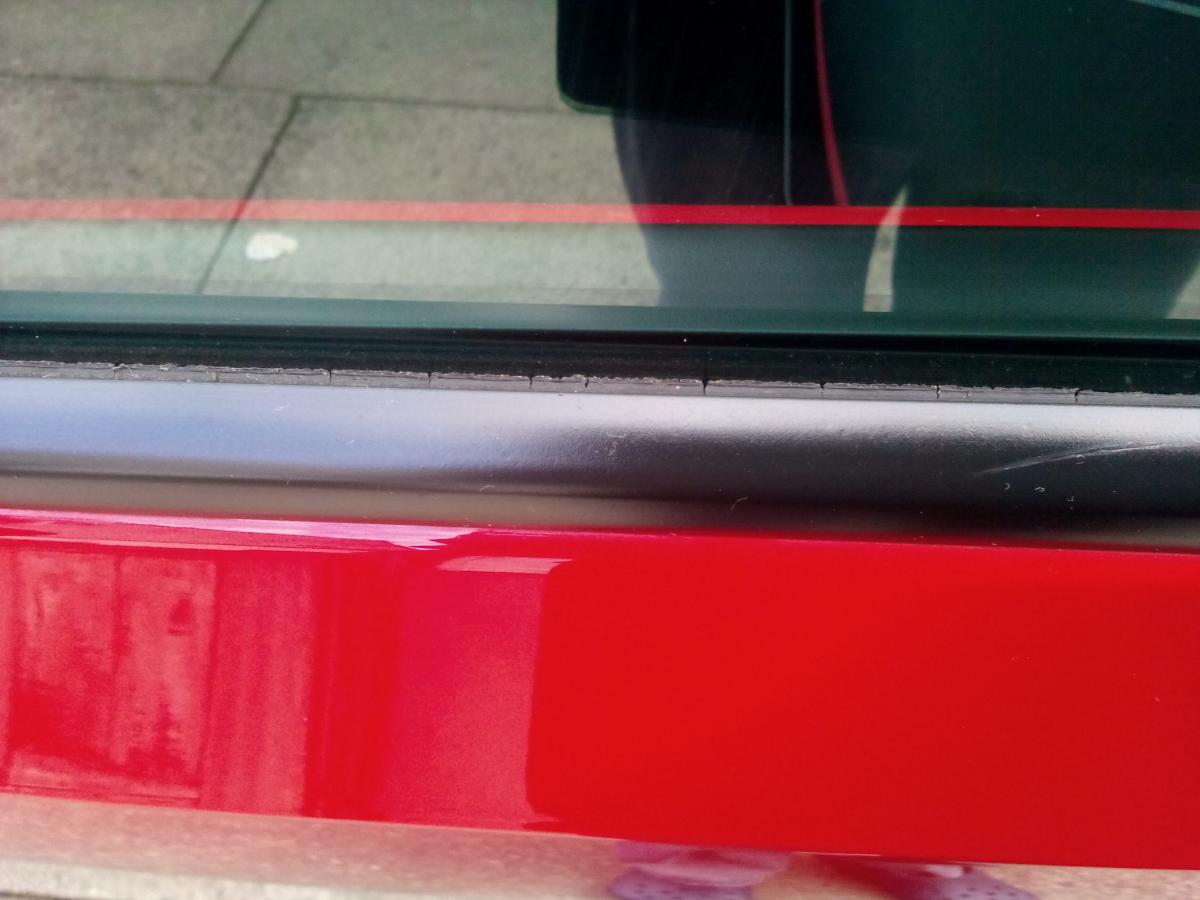

I have the algae on my door seals but,now the seals are rotting away.
See this photo
This on the passenger door after I cleaned.Have left the drivers side mouldy!.
How old is your car? That is not good.
Just under 18 months old.
That shouldn't happen on a car of that age; what have you been cleaning it with? Acid?
I do not think my Citigo can be the only car with this problem.Check your cars next time you wash them!.

Just taken the car into Alex Lawries,basically they were not interested started by accusing me of 'using chemicals' on the car! and then when I explained it was a common problem with the green mould/algae growing on the seals I was accused of not cleaning the car properly.Have to take the car in again next week for the 'warranty guy' to have a look.Waste of time and petrol.
