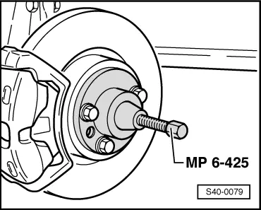

This page http://workshop-manuals.com/skoda/octavia-mk1/chassis/front_suspension_drive_shafts/repairing_front_wheel_suspension talks/remove_and_install_suspension_strut_and_wheel_bearing_housing/ talks about using a special tool to remove the driveshaft (see below).  Is this needed?

Trust me you don't need a ball joint splitter and there is no need to remove the drive shaft I have never done this EVER
