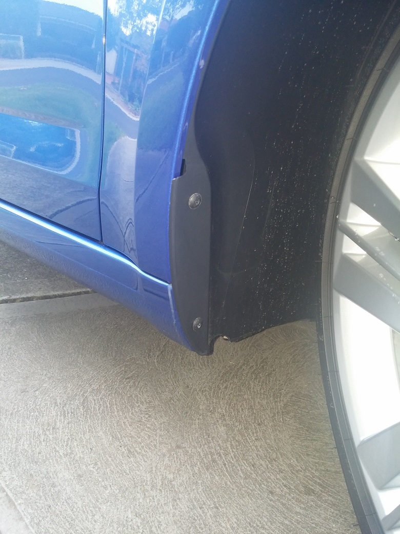

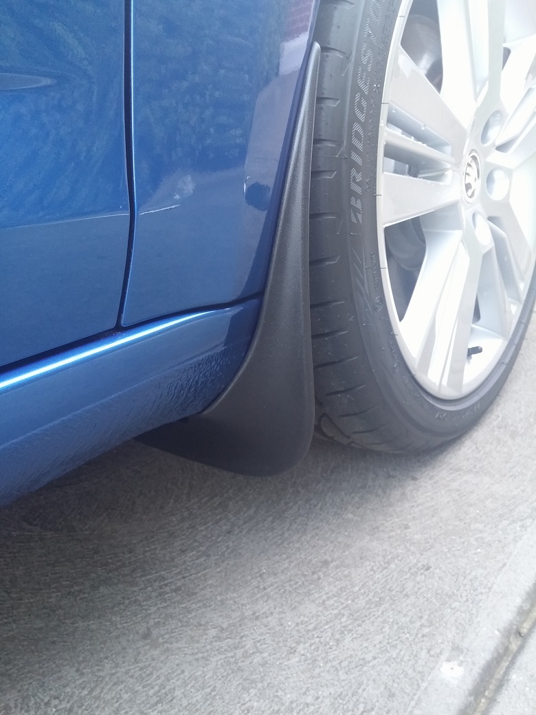

Mine with them on:
And the awkward to get to screw, just left mine off as it hold fine without it. Havent had any problems with them, and they make a big difference to the amount of dirt up the car IMO.
No problems with speed bumps. They catch occasionally if I reverse up against a curb, but they just bend and flap back into place after.

Thanks Mike, perfect photos, just what i was looking for. Cheers.

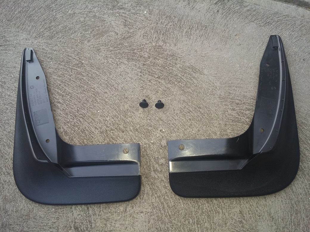

The kit I got came with some rubber push in grommits which I was able to use for that far screw. From what I could gather it depends on whether you have a diesel or not as to whether you need to use the screw. I did manage to get it on without removing the wheel though.

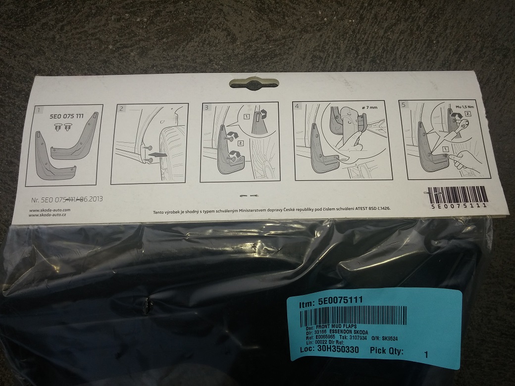

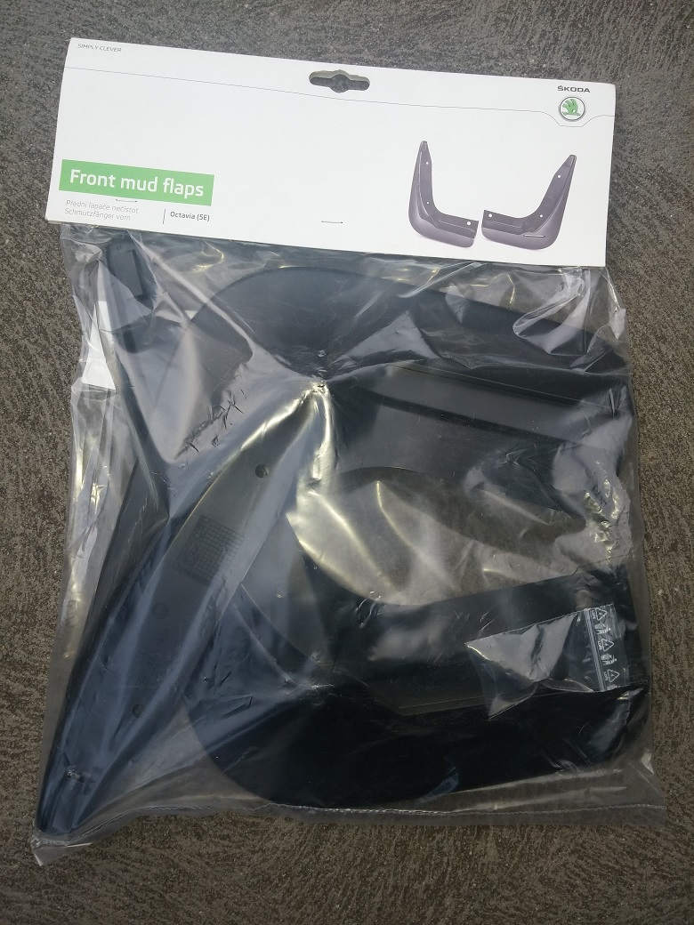

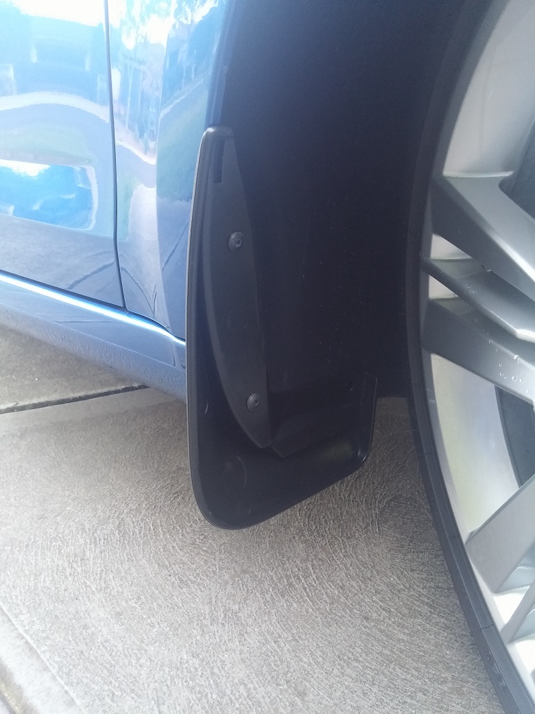

Finally got around to installing the front set.
Easily done by turning the wheel as needed and using the star screw driver in the boot tool kit.
The genuine kit comes with a push in plastic plug...but you have to drill a small hole where the 3rd hold is (furthest hole away) but i'll do it another time.
