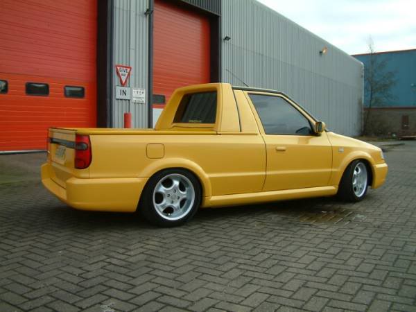

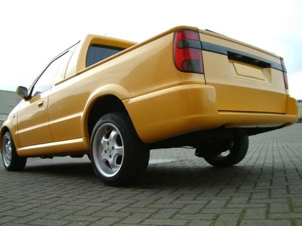

Raised, and lowered :)
Thanks for the photos Tech 1e,  love the raised version, how did raise your car, what shocks did you use did you do anything to the front and how did it handle,
You can tell I having messed with cars in 30 years so many questions
Full air suspension kit from Rayvern Hydraulics

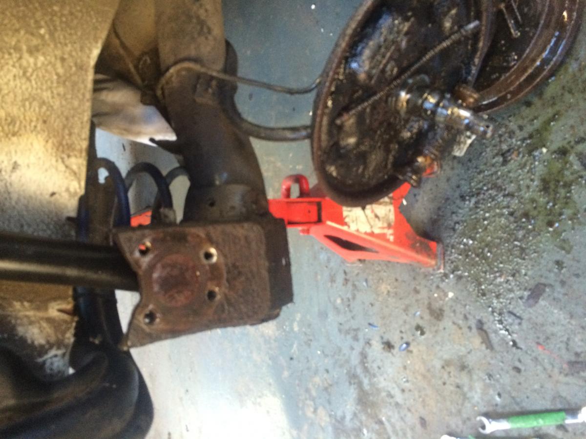

Found this pic from when i testfitted the Focus coils
Thanks for the photo lahenvirta,
How did you mount the shock or did you change them

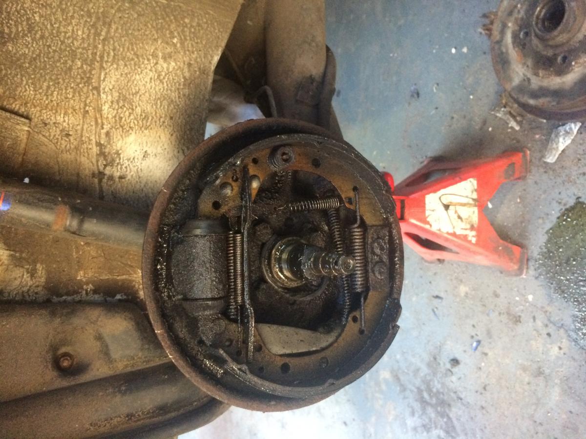

Just taken apart the drivers side drum and good job I did too
Are you going to go for the rear disc conversion while you're at this point?

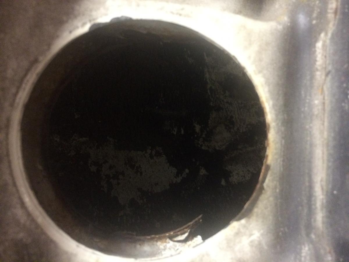

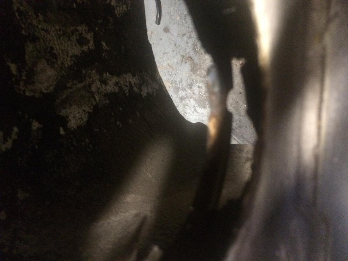

Yeah i have all the parts but as I removed the fuel pipes the there's a hole where it's rusted through :( any one know any replacements that fit that i can cut out of another car? Or a link from a previous fix? I'll take s picture in a sec
Here's the holes
