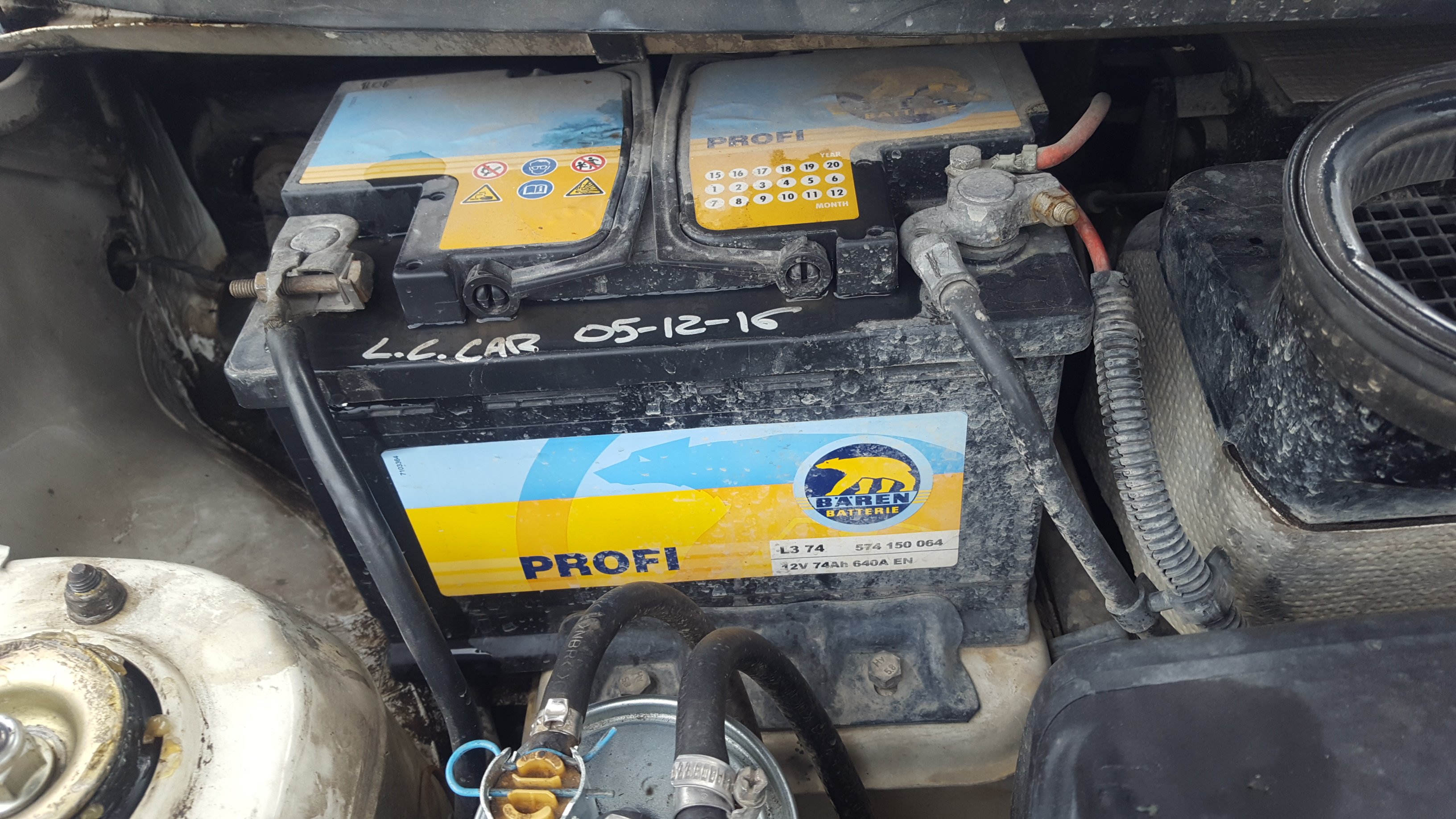

 this is the actual battery, 74ah 640a, size around 175x272x190mm......
Edited by Zimo
I recommend a Bosch battery (series S3, S4, or S5) of 70-77 Ah depending on your budget.
Their dimension is 278x175x175 up to 278x175x190.
Last two batteries lasted 5-6 years each given the electrical system was in top condition and I didn't abuse it.
And what about the starting current power? ( don't know if it's the right words in english). I mean the "axx" after the ah number.

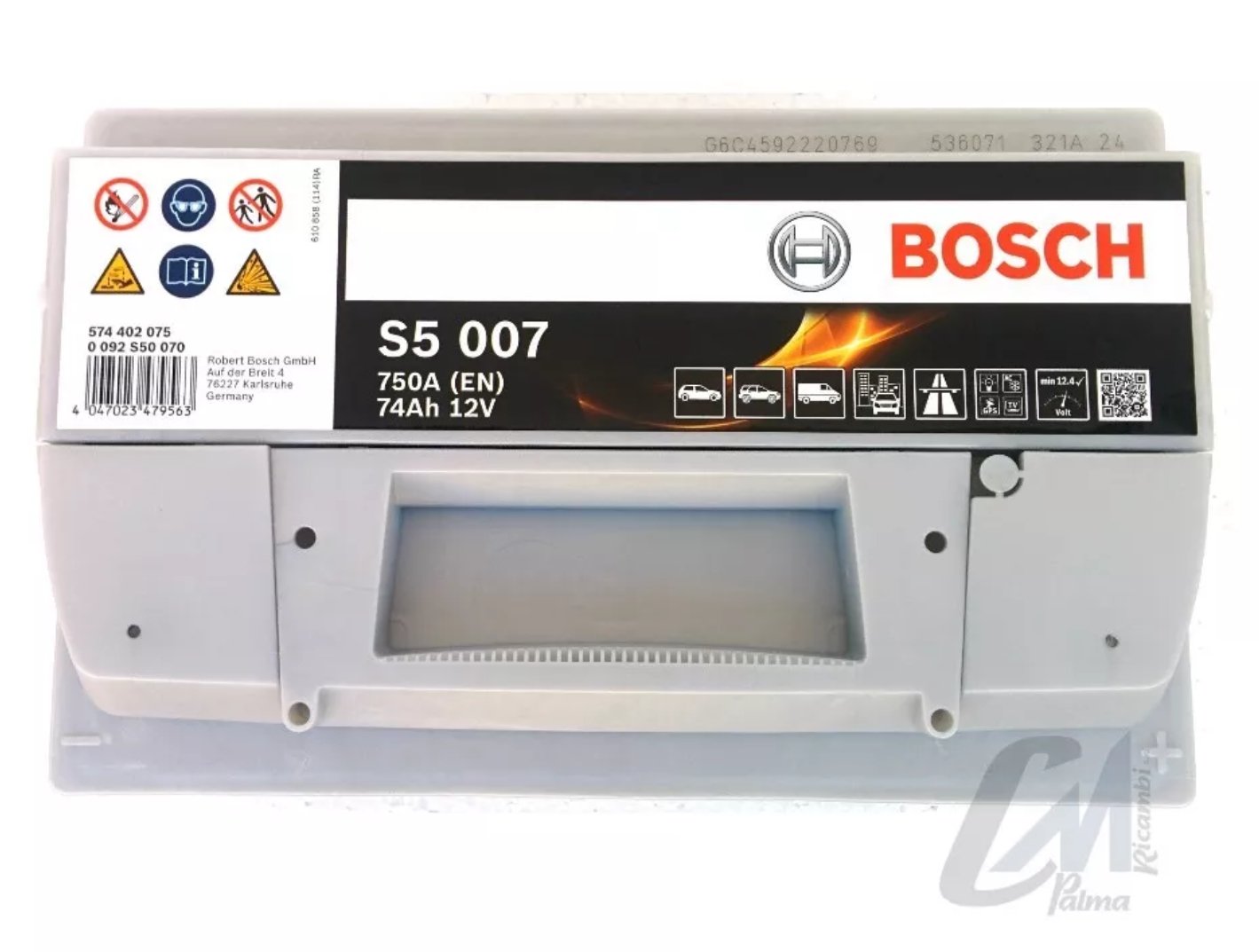

This should be fine

The cold cranking current (CCA) required to start an engine in cold weather  varies from vehicle to vehicle and is dependent on the engine size, circuit resistance, temperature, engine oil viscosity and the accessory loads.
600 CCA is a a standard option for many cars, including yours.
Wait !so i ahould buy a 74ah up to 660a ? Is it right
This maybe is too much?
If dimension wise fits your space, buy it.
I'm waiting to recive it!
Battery replaced and everything fits well. It is smaller than the old one but more powerfull! I would think this can help also the hot
start problems , we will see.
