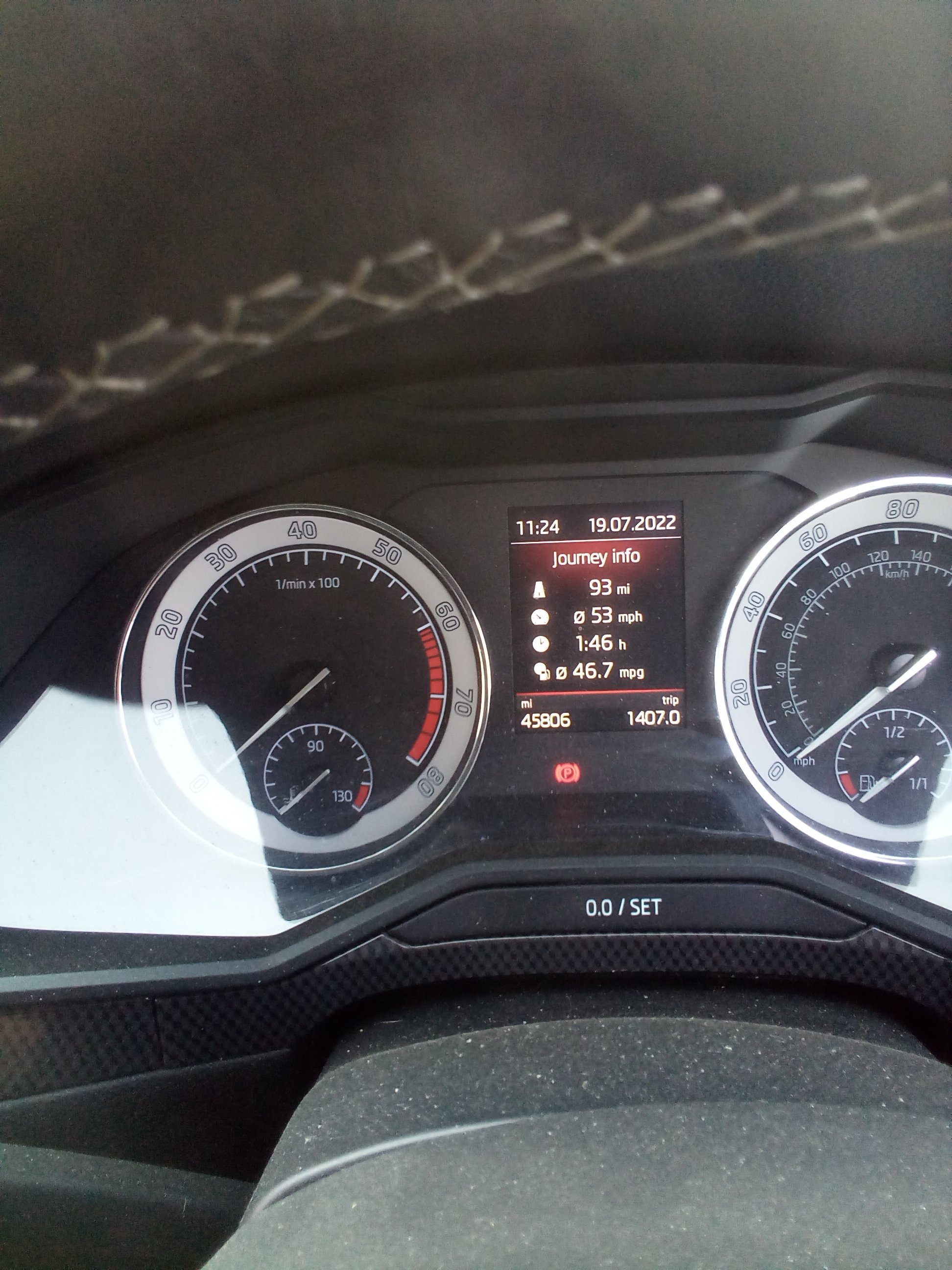

There's a thread about 190 fuel consumption. Today on my trip to turbo technics I thought I would see what I could get. I shan't be doing this again.IMG_20220719_112311.thumb.jpg.79f1bc4e1506e23e82698bb1bab95b22.jpg
After visiting TT, I went to see fellow forumeer Awe Sam so that we could compare my stage 2 to his stage 3. All I can say is that he's convinced me to do it.

On a return trip home from Cairnryan a couple of weeks ago, I got an average of 41.09mpg. Delighted with that.
Mine may have the bark, but his has got the bite!
Awe Sam by name, awesome by nature 👍
I like that journey info! Is it only available on 2017> vehicles or something you can enable on all MKIIIs?

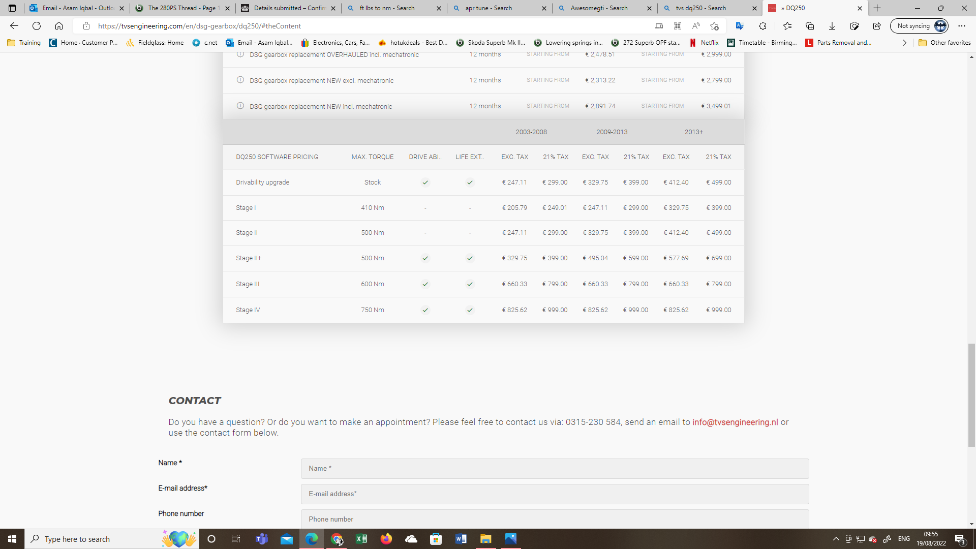

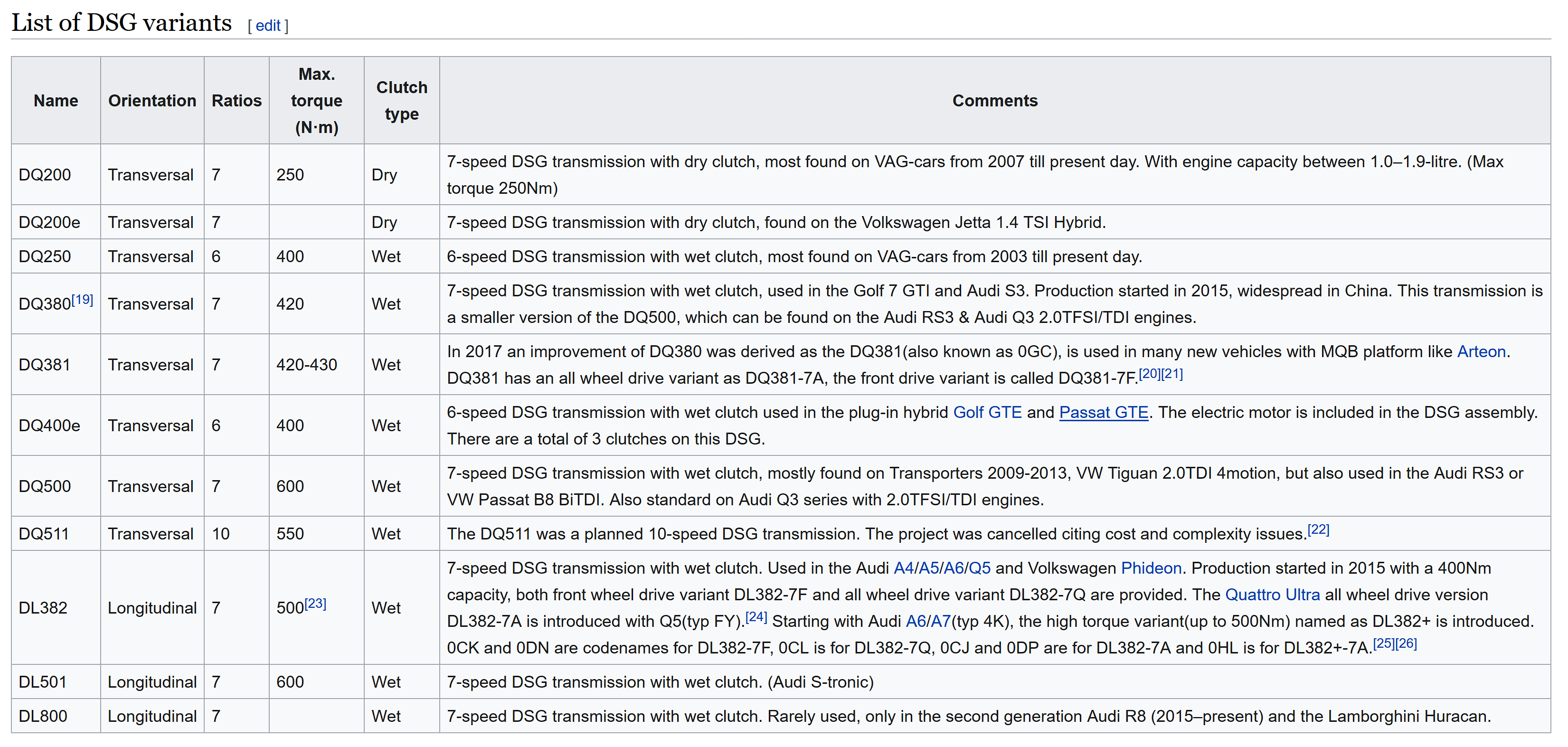

On 04/04/2022 at 10:42, Awesam said:
depending on which DSG you have:
DQ250 - 600NM Max
DQ380 - 700NM Max
This is the Wikipedia entry on DSG gearboxes.
https://en.wikipedia.org/wiki/Direct-shift_gearbox
The torque ratings are very much lower than what you're stating, @Awesam.
Where did you get your numbers from? (Also fao @LeGrumpy)
Im running a stg3 ECU & TCU tune, my torque is 422 ft lbs which 572.16 NM so I can tell those figures are conversative!
Also from TVS Engineering, who are the best DSG tuner globally.
I can't say that Wikipedia is well known as a reputable source of information, I have to wonder what keeps Wiki going these days?
Thanks for giving the source of your numbers. 👍
Does anyone know if this journey information is only available on post 2016 SIII or can it be enabled on all SIII models?
