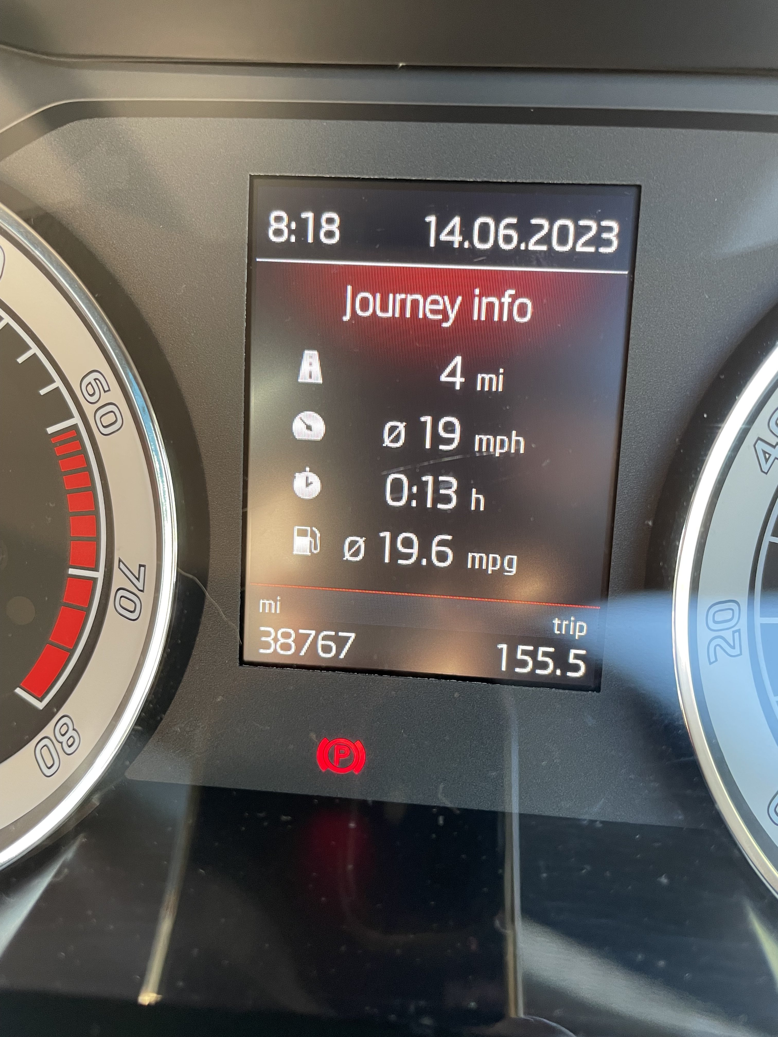

Hi guys, new here and new owner of a 272. Sorry if there is a specific 272 thread rather than this 280 one. Car is great in every respect so far except….mpg. Now I knew it wouldn’t be great, but a lot of what I’ve read on this forum says I should get maybe 25 around town and 35 on a run, if not more. I seem to be getting 20 around town and no more than 27 on a run. Was just wondering if you guys had any thoughts on anything that might be up with it?

You didn’t say how long your commute is, but if I take the start-up average on my massive 2.5m each way commute, I get about 22mpg first thing (06.00) and about 23, maybe 24mpg back at (08.30). My long term is still showing about 28.5 but that’s because I did a 1k round trip to Ireland about 6 weeks ago which got my long-term avg upto 35. Cold engines use more fuel and when it’s winter I get 20-21 there and back.
So given this I’d say what you’re getting isn’t off, it’s in the about right arena; if this was a V6 or worse, a V8 developing 280’ish bhp, you’d be looking up the noisy exhaust at 15mpg or even less.

20 around town is about right if the town is like London with lots of 20/30 limit and traffic. Even stop start won't make it any better ...
27 on a run (assuming definition is same as me.) Sounds low. I'd expect more than 30 in a 272. You must be ragging it,😂

This mornings commute. The ‘runs’ it’s been on so far are 50/60 wide open country roads with a bit of 70 A1 thrown in. I’m yet to take it on an extended motorway run. But given plenty of people are getting high 30s on longer runs, mine feels a fair way off.

If your commute is only around 4 miles I’d say that’s probably about right. My 280 gets around 28-34 on a 28 mile work commute (mostly motorway) depending on how heavy my foot is (with a DTUK pedal box in sport plus mode but no remap) but if I do the school run (2-3 miles tops) no matter how gently it’ll be well under 20mpg every time. Down to the local towns (I live rural 10 miles from everywhere) I get between 27-30 on average round trips and seem to be averaging 27.4 mostly long term. That’s with “enjoying” the power using D, S and manual modes mixed on mostly Sainsbury’s 97 octane with occasional Tesco 99 thrown in. Last year when the financial crisis hit I drove it like a grandad for about 4K miles and got the averages up to around 32 but my god was it a boring way to drive it!

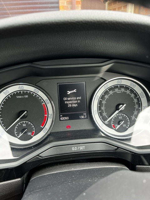

Yearly oil change / inspection coming up. I just hope it doesn't mushroom into another expensive one like last year - replacement water pump / thermostat & new discs & pads 🤞
