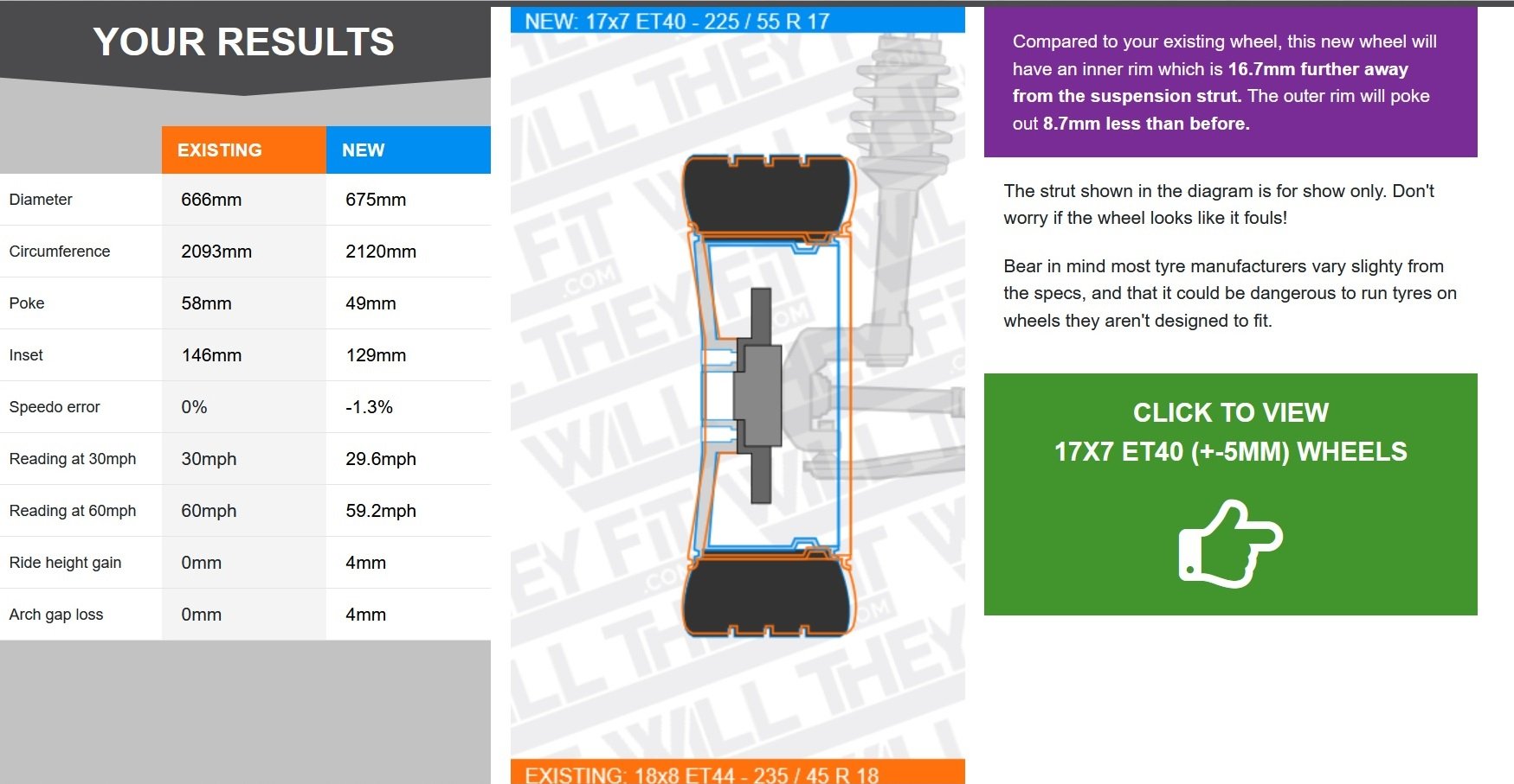

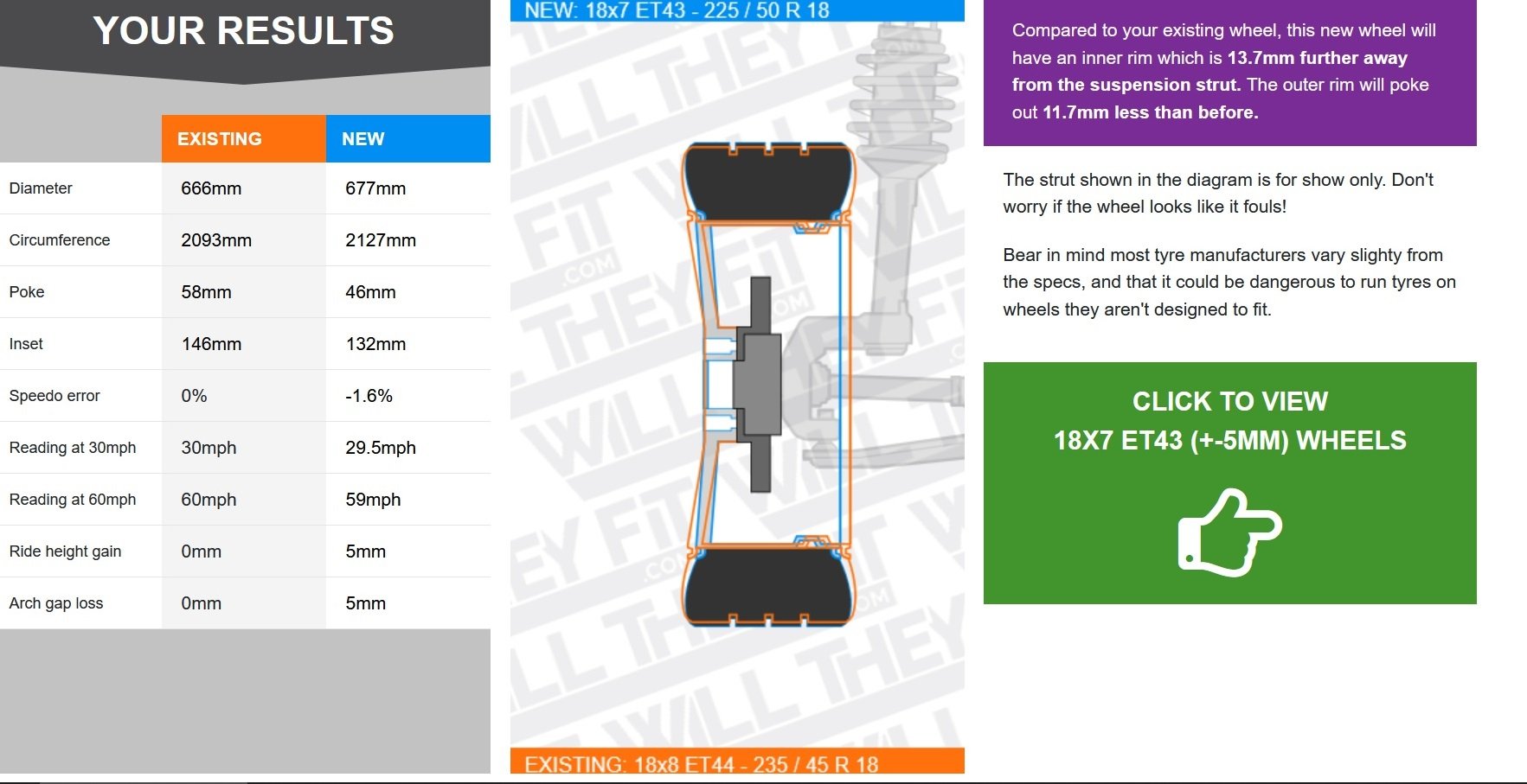

Well, as it was correctly advised by @Carlston the 18" rims from the Kodiak, while a delight to the sight, are a bit further inside that the original sizes, and after a while I get this "Lidl cart" feeling.
So I was thinking for starters to get some spacers, but I am torn on the size ....
As seen in the one of these online calculators, the difference between the OE size for rim and tire and mine is 11.7mm.
However, the difference for the 'winter tires' is 8.7mm
As I would like to avoid faffing around with the spacers, which happens I dislike as well, I was thinking of a "one size fits all" approach, but I am torn between 8mm or 10mm, or larger if I am to accommodate only the 'summer' size.
Also, I do not understand if I should also get longer bolts, I have seen and played around only with larger spacers, 15mm and above, but this was aeons ago ....

On the Superb MK3, non-standard 225/50R18 7Jx18 ET43 5/112 57.1 wheels could be used with 10mm spacers. This will change the effective offset of the rims from ET43 to ET33.
Make sure the spacers are hubcentric, so that the wheel is centred on the hub.
With 10mm spacers, the wheel bolts need to be 10mm longer.
Perhaps look at Eibach spacers and wheel bolts.
The standard WHT001812 wheel bolts have a specification of M14x1.5x27
Eibach M14x1.5x27 wheel bolt S1-6-14-50-27-17 (standard length)
https://www.autodoc.co.uk/eibach/1931742
Eibach M14x1.5x37 wheel bolt S1-6-14-50-37-17 (10mm longer than standard length)
https://www.autodoc.co.uk/eibach/15258679?search=EIBACH+Wheel+Bolt+%28S1-6-14-50-37-17%29
Eibach 10mm wheel spacers S90-2-10-027 (5/112 57.1)
https://www.autodoc.co.uk/eibach/1931843?search=EIBACH+Wheel+spacer+%28S90-2-10-027%29
Edited by Carlston
