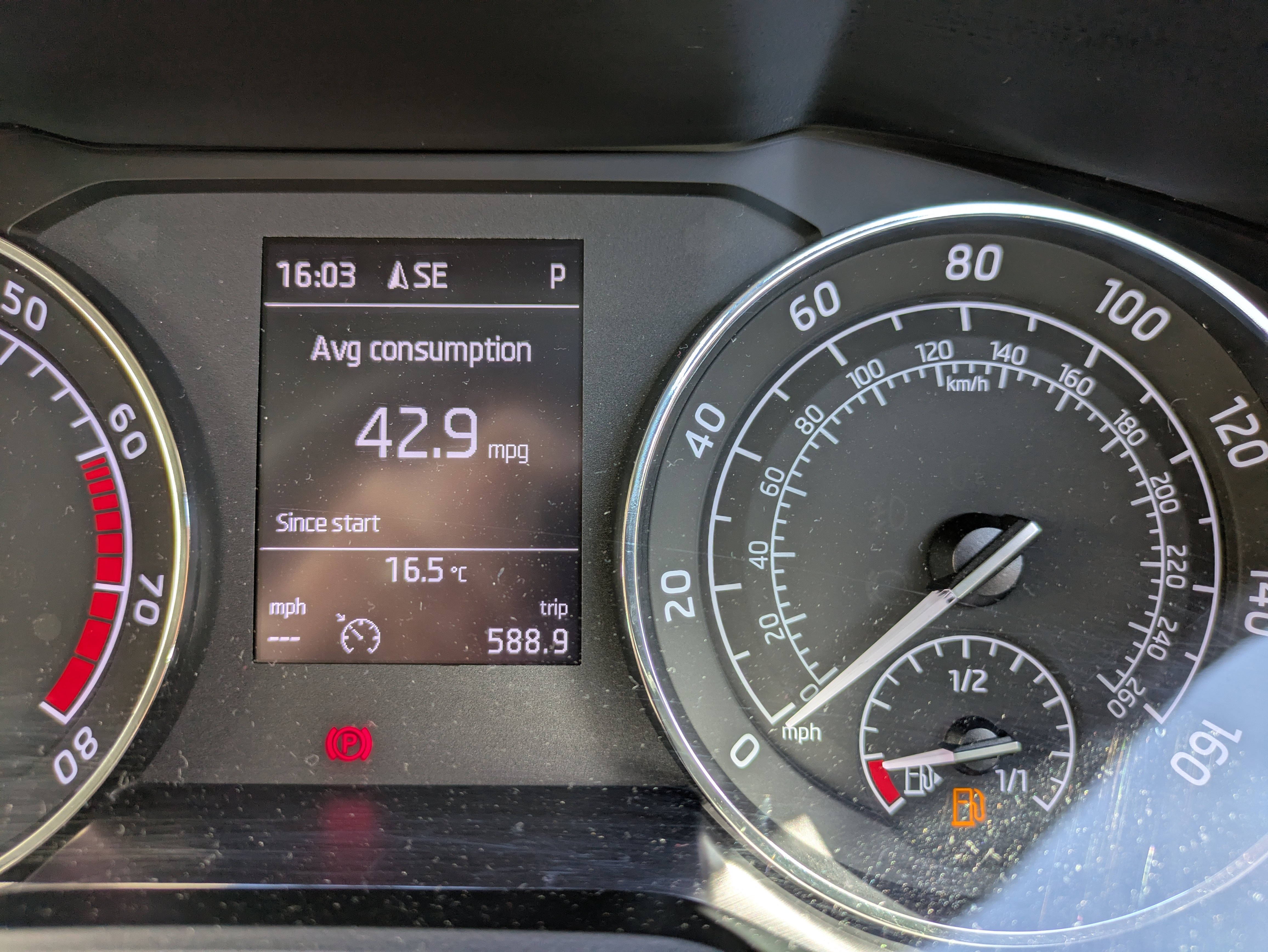

Very impressive - I drive my 280 like a saint and can only get 40mpg.........
its brilliant on a steady cruise on the motorway (sticking to the limits) but still pretty poor everywhere else, non motorway use is usually around 30mpg or under.

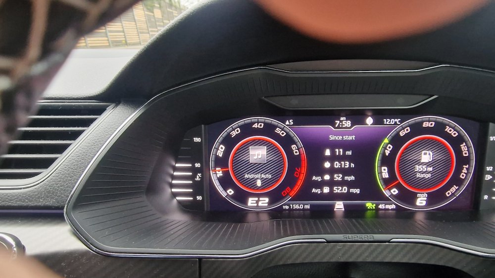

I've managed 28mpg average over the last 20k miles in my 2017 280 but last week I actually tried hard on a run from Cornwall to Gatwick and back in a day......42.9mpg....589 miles and computer still giving a range of 60 miles.

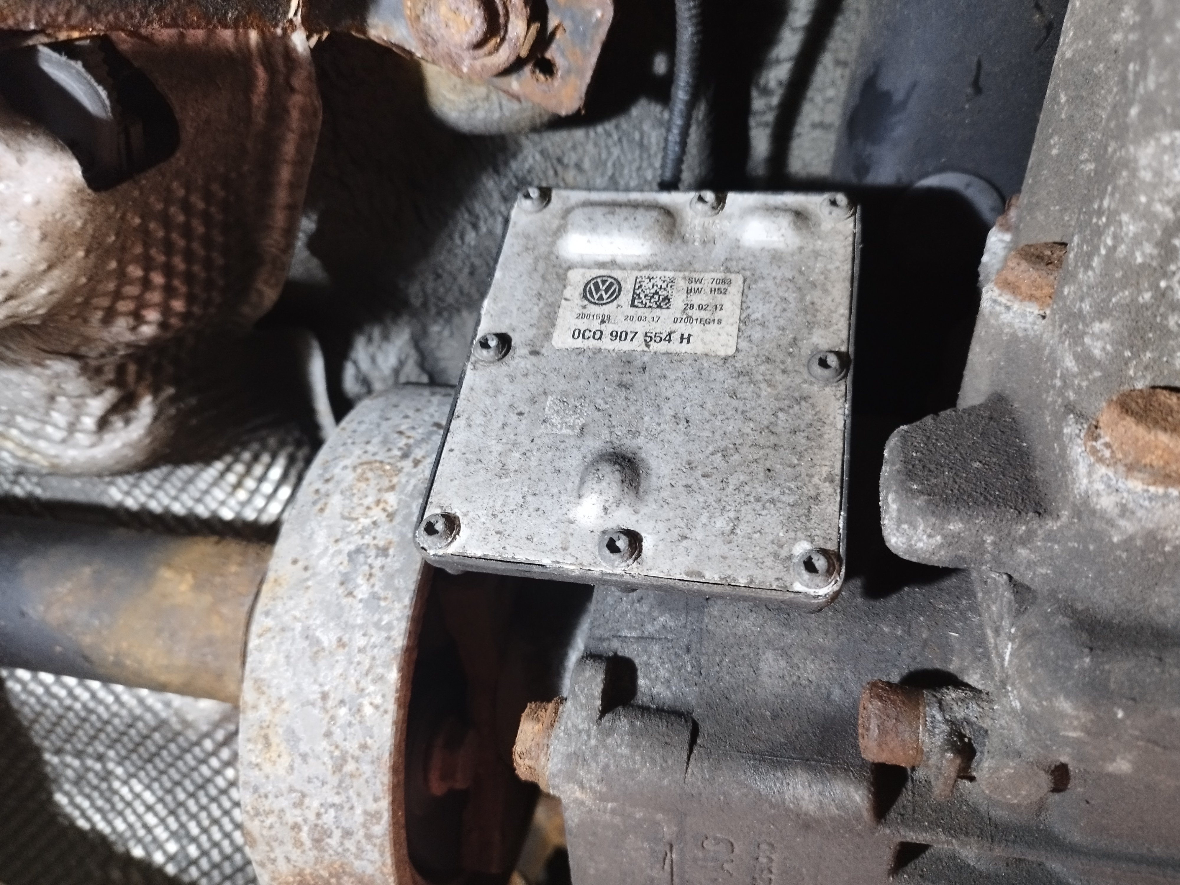

On 15/03/2025 at 10:54, Just said:
Fault codes I'm getting are:
Gateway U011400 Lost communication with four wheel drive clutch control module - Static
Brakes U112100 Databus missing - Static
Engine U112300 Databus error value received - Static
ACC U112300 Databus error value received - Static
ACC U112200 Databus implausible message - Static
The only other error is:
Central Electrics B126301 - Trunk lid unlock activation - Intermittent
Hi, I like to give an update when I get to the bottom of an issue in case it's of use to anyone else.
The intermittent issue I've been having was resolved after referring to a Golf R 7.5 forum where it was suggested that a common issue is the Haldex controller becoming damaged by water ingress, and a repair service being offered by Haldex Repairs UK.
Sure enough, after I'd started off by replacing ABS wheel sensors (cheap and very easily done) but that didn't work, I carefully removed the Haldex controller, 2 10mm bolts (also T30 torx), the bottom one a little tricky due to proximity to the propshaft. 2 electrical connectors at the top with the traditional VW push clip setup. Sent it off by post Friday afternoon, received back repaired Tuesday morning, fitted it today and fingers crossed all the warnings have gone 😄
If anyone else is doing this on the drive, the smaller cable connector, which I think goes to the Haldex pump, has 2 wires covered in braid which has disintegrated on mine and turns to dust which falls directly into your eyes! So best to wear goggles - I re-covered the wires with loom tape, not sure if it gets hot up there - it's miles away from the exhaust, but something has led to the braid disintegrating.

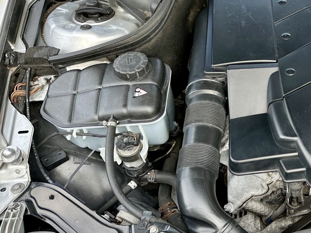

Are you aware G13 is compatible backwards or I need a very very very dedicated flush instead of a "normal" flush - meaning difference between making one water load and spending the entire day at it ...
Anything else besides the coolant that I should buy?
I am planning also to take down the Haldex pump and check the strainer, I will buy the necessary kit.
DSG will wait until 60k, or when I have time after the summer.

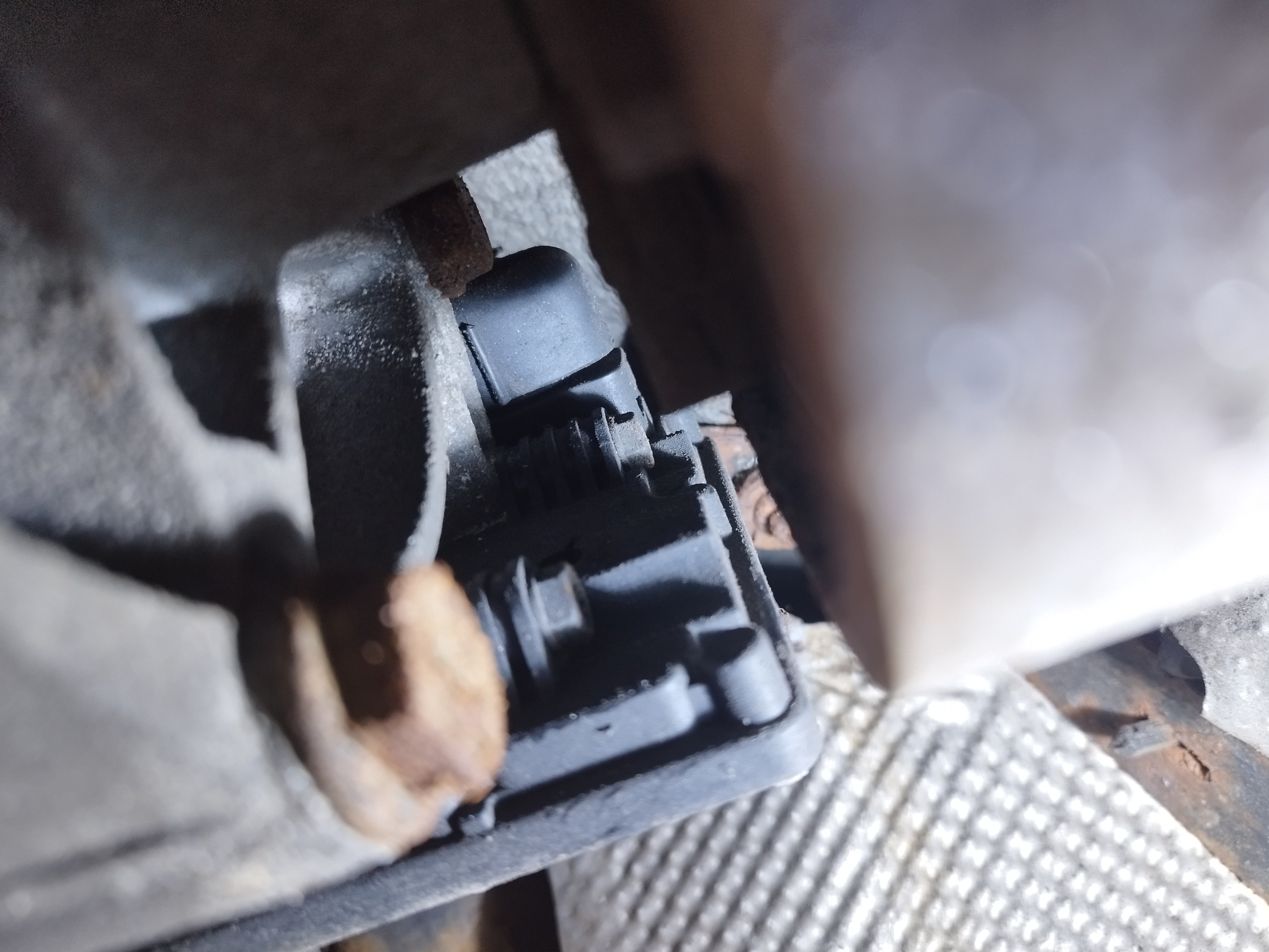

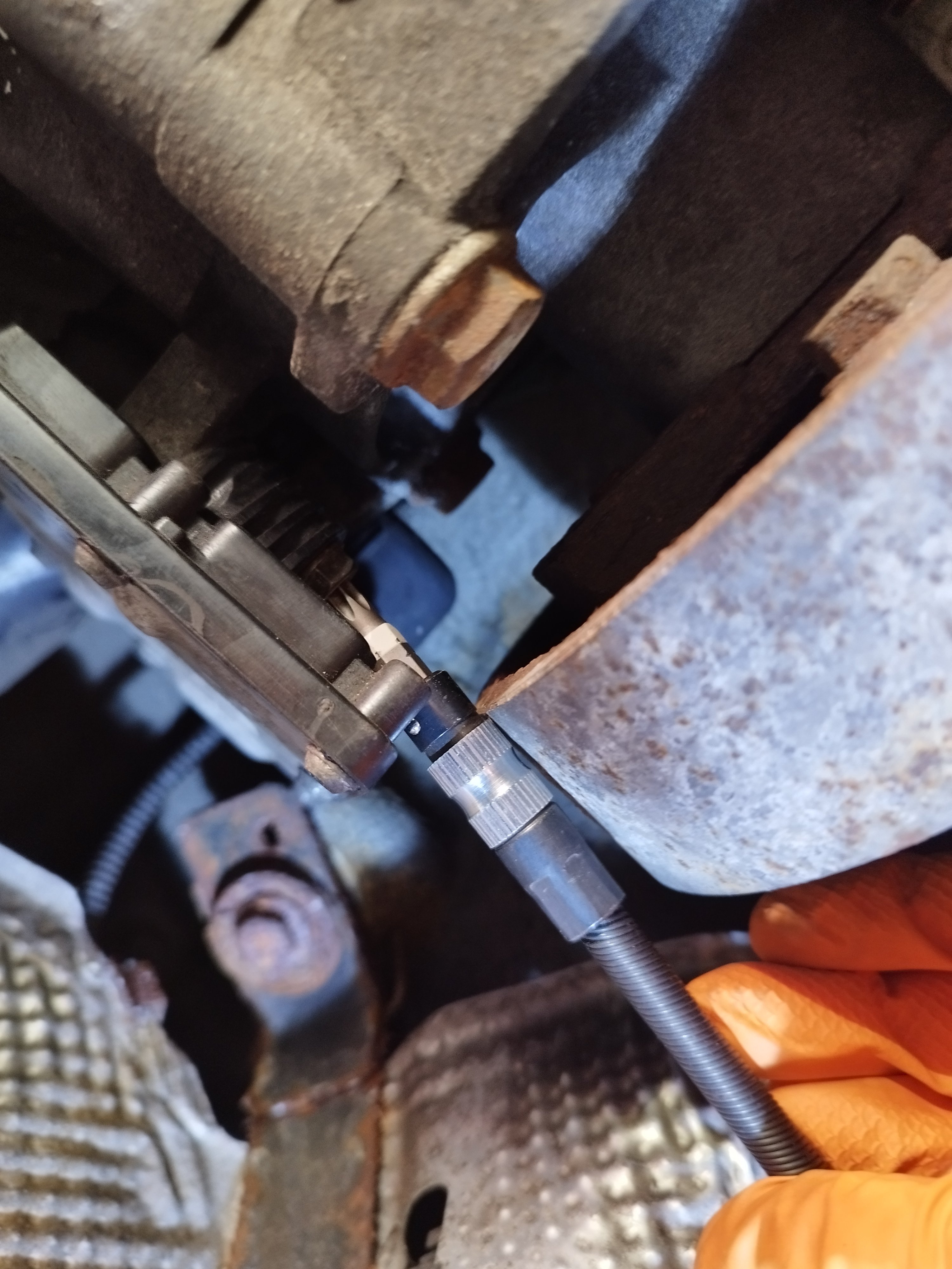

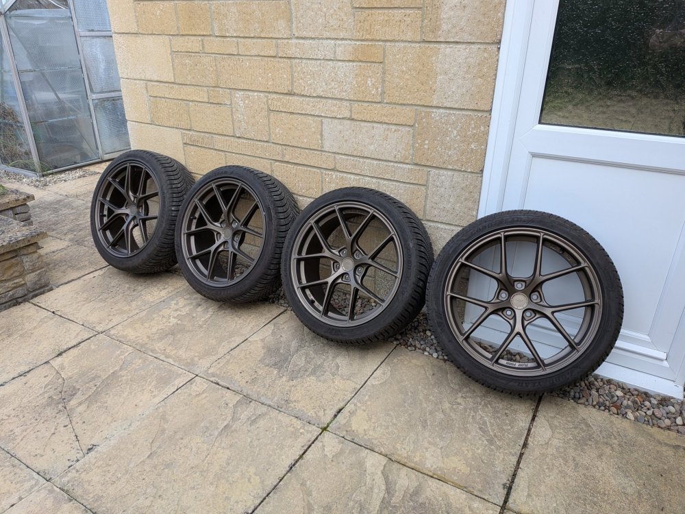

When I changed to summer tires - must show pics - I've noticed the rear left inner pad was down to like ~1mm hard to measure, because I did not take it out, but I sense is not a lot. The outer one was more, and right hand caliper similar situation. I will not take chances and replace them.
Travs, guys, options for rear calipers? I prefer less brake dust, I do not mind soft compound rather wear them and replace em, than leaving 'em to harden and cristallize/crack.
Waiting so I can make some order. Thanks!
Hi @leolito Judging by your mileage your car is newer than 2018. If that's the case you should use G12evo coolant which is actually newer generation compared to G13. AFAIK G12evo is backwards compatible so you can use it in cars older than 2018.
Unfortunately I don't know if using G13 in post-2018 car would do any harm or not.
Thanks Setesh, mine is '21 indeed, but it does not say anywhere what type of coolant has been used.
I see this stash of G13 will have to go elsewhere 😁 and will look for G12evo then.
Thanks for the heads' up ...
@leolito - do not mix G12 and G13!
They have very different coolant properties and very different service intervals for flushing.
G13 is dependent on the Silka to keep it in "good" condition, allowing it to last longer between flushes.
G12 does not dependent on silka, however requires more frequent flushing.
