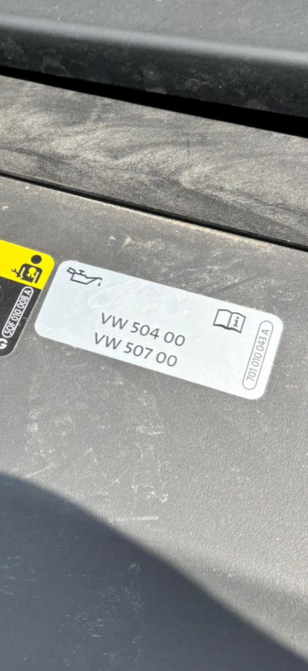

This is my engine bay - this is the gen4 engine so with a GPF.
Okay so the 507 00 is the old Longlife 3 that’s been out for years, I already use this stuff it’s 5w30. No idea where the dealer gets 0/20or 30 grade in Castrol as the equivalent LL3 they do is also 5w30. I have seen grade differences between brands on another VAG car but this time points to a 5w30 in both Quantum and Castrol. I have Quantum on my garage shelf so all good for any top ups. Cheers

Long Life oil is VW504 00 / 507 00, 0w 30 FS III or 5w 30 FS III, then VW went for most other than some engines in time for the WLTP Certification to VW508 00 / 509 00. 0w 20 FS IV.. Not backward compatible. Non long life for TSI,s was and is VW502 00. Usually 5w 40 FS. @gav_is_con For decades since Skoda / VW recommended Castrol and put a litre in cars boots. Unopened. Dealerships in the UK used Quantum, now TPS supply Quantum in the UK, from Fuchs Oils.
