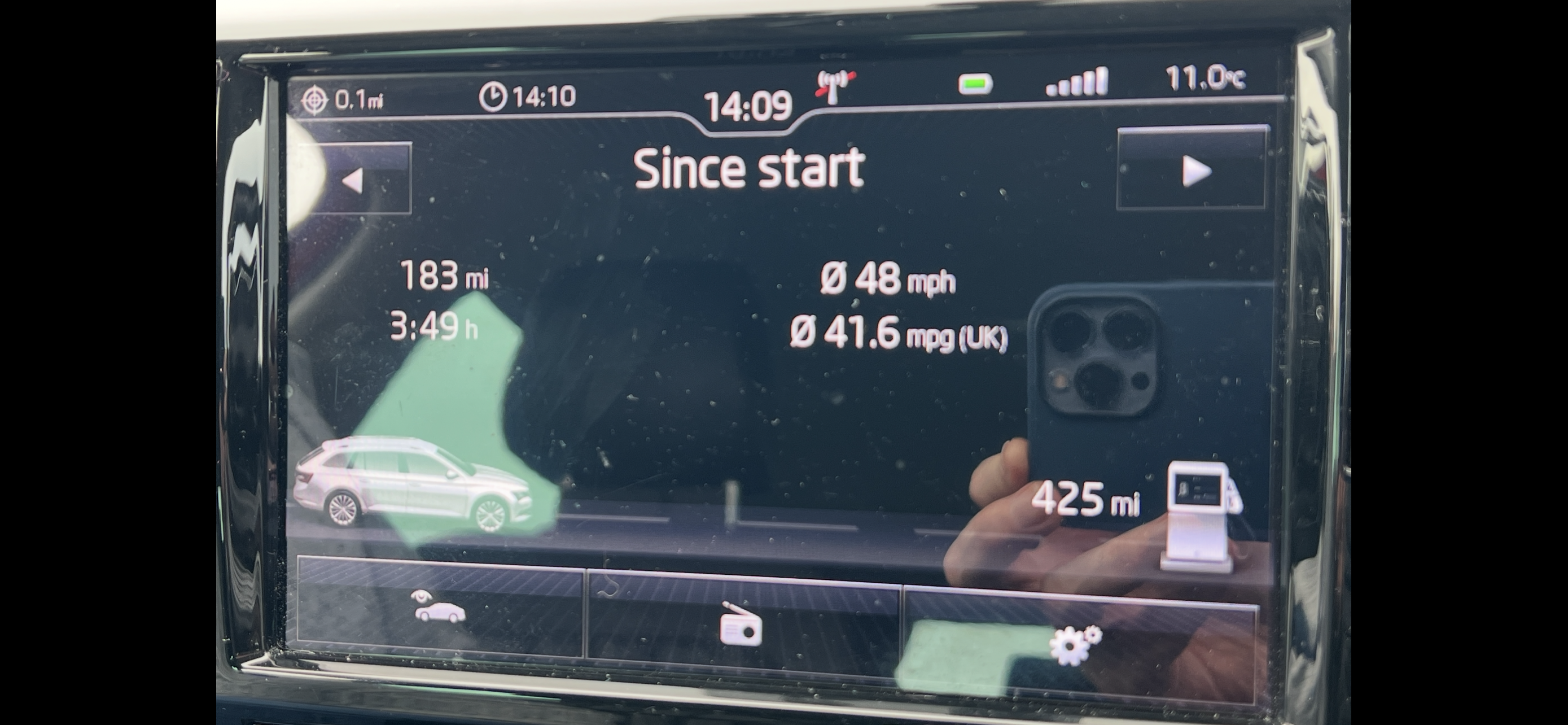

Personal best today started out with a full tank and 300 mile range and ended up with 425 mile range after driving 183 miles !
41.6mpg
I love it when the 99 Ron Fairy tops the tank up as I drive along ! 😂
41.6mpg
Impressive. Don't think I've managed much better than 38mpg on a run.
Yeah I was pretty pleased with that !
Good work. I get up to 40 when driving sensibly. My enthusiasm usually drops it to low 30’s but I can live with that.
