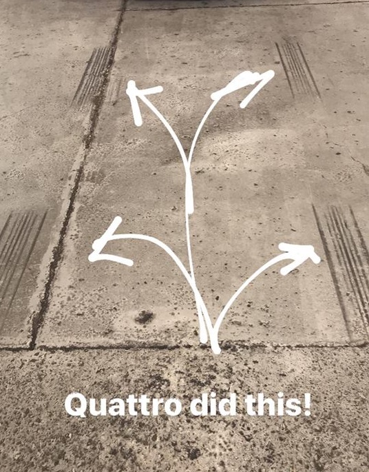

Got to love this photo that The Toy Shop Wellington just sent me. :D

In other news - my brakes should now pass a WoF. Apparently they worked but the car dived left and right under braking! Then they worked out that there's a bleed process for the power steering pump which also provides pressure for the brakes. Bleeding that sorted it.
