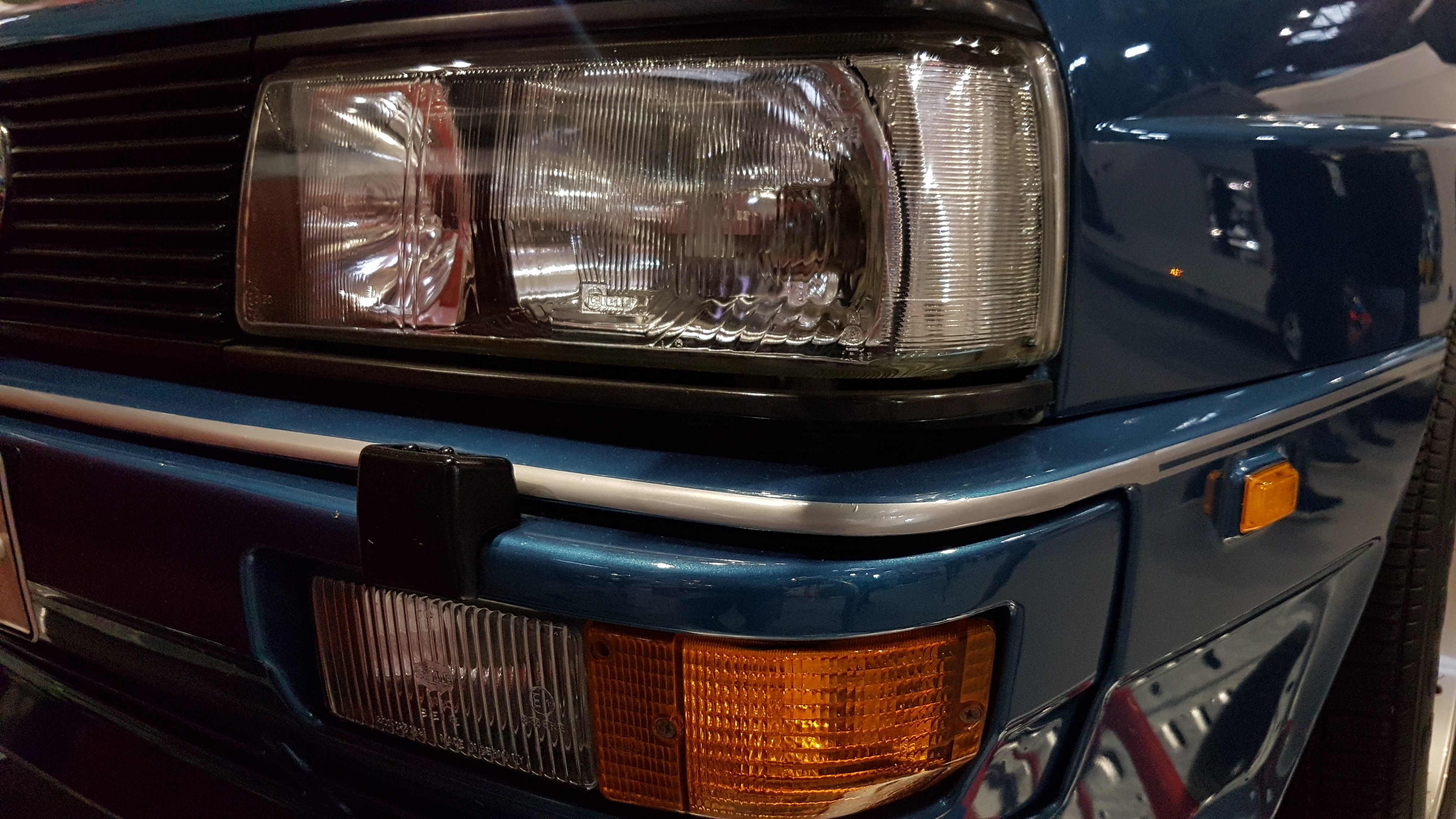

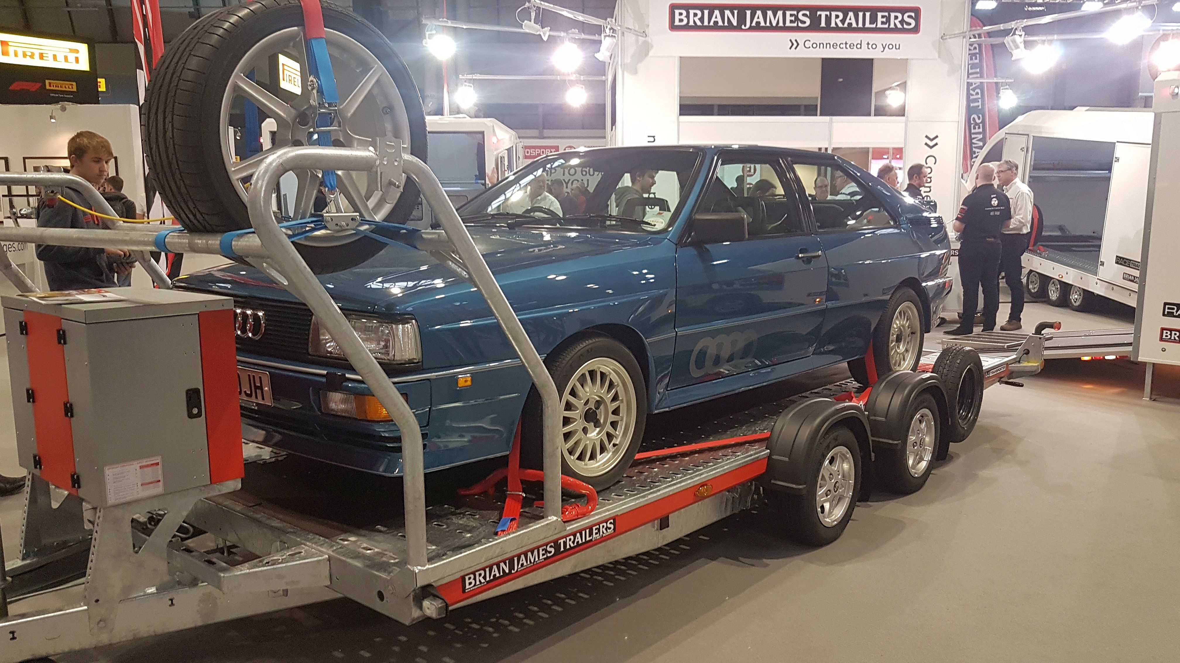

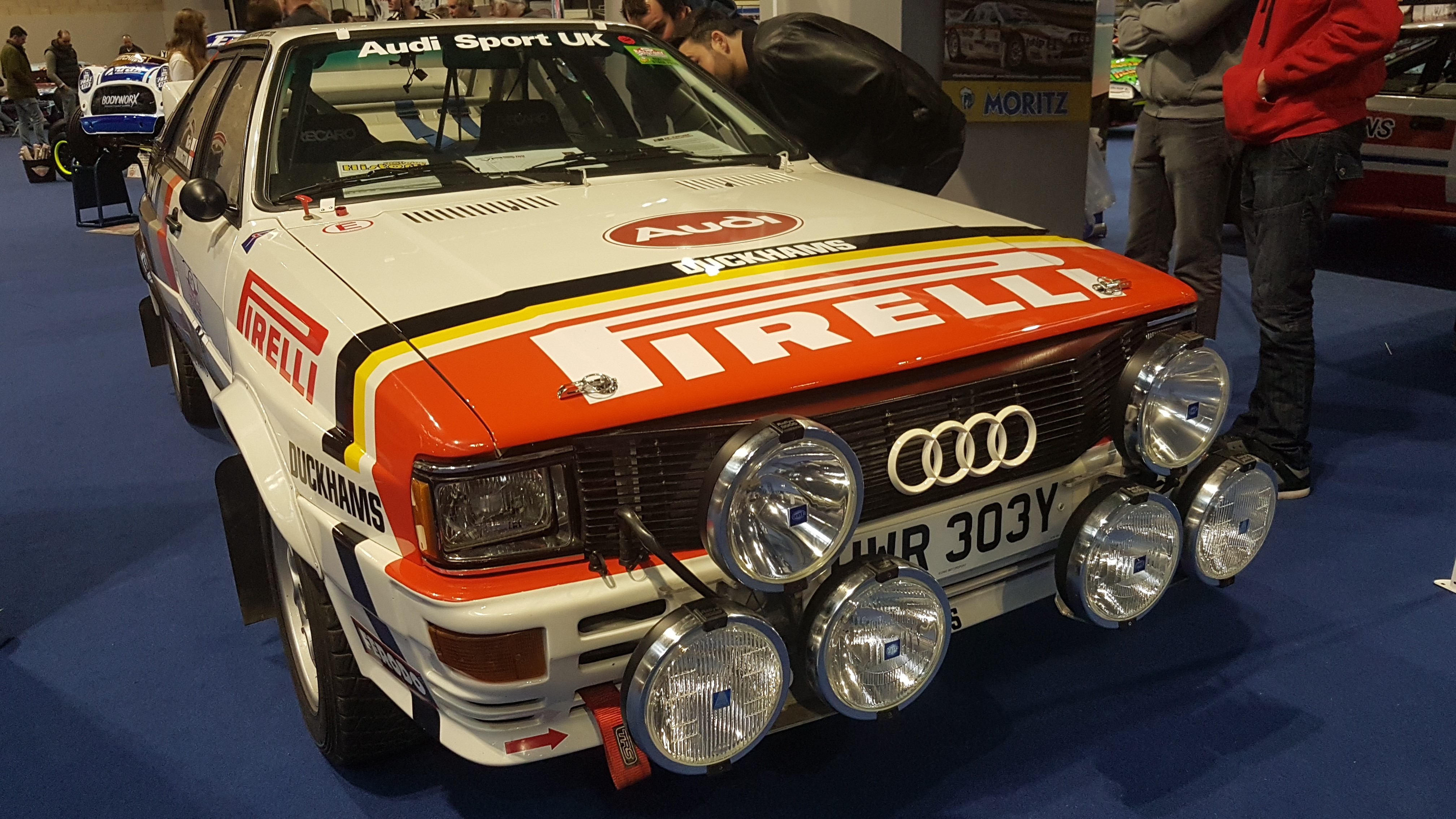

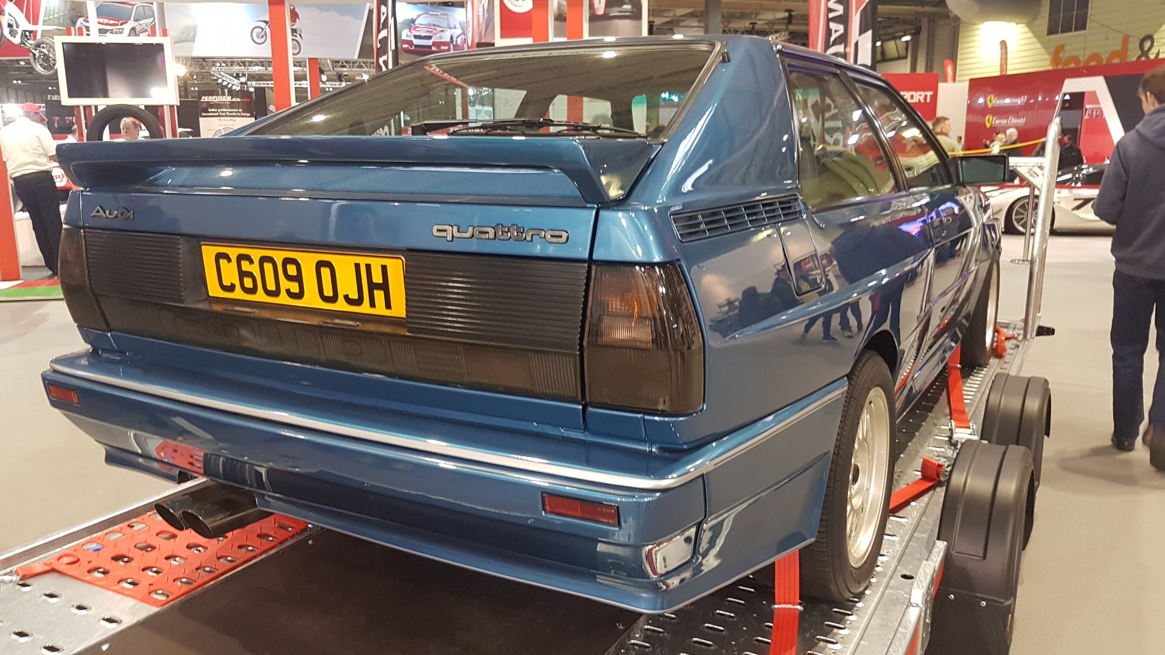

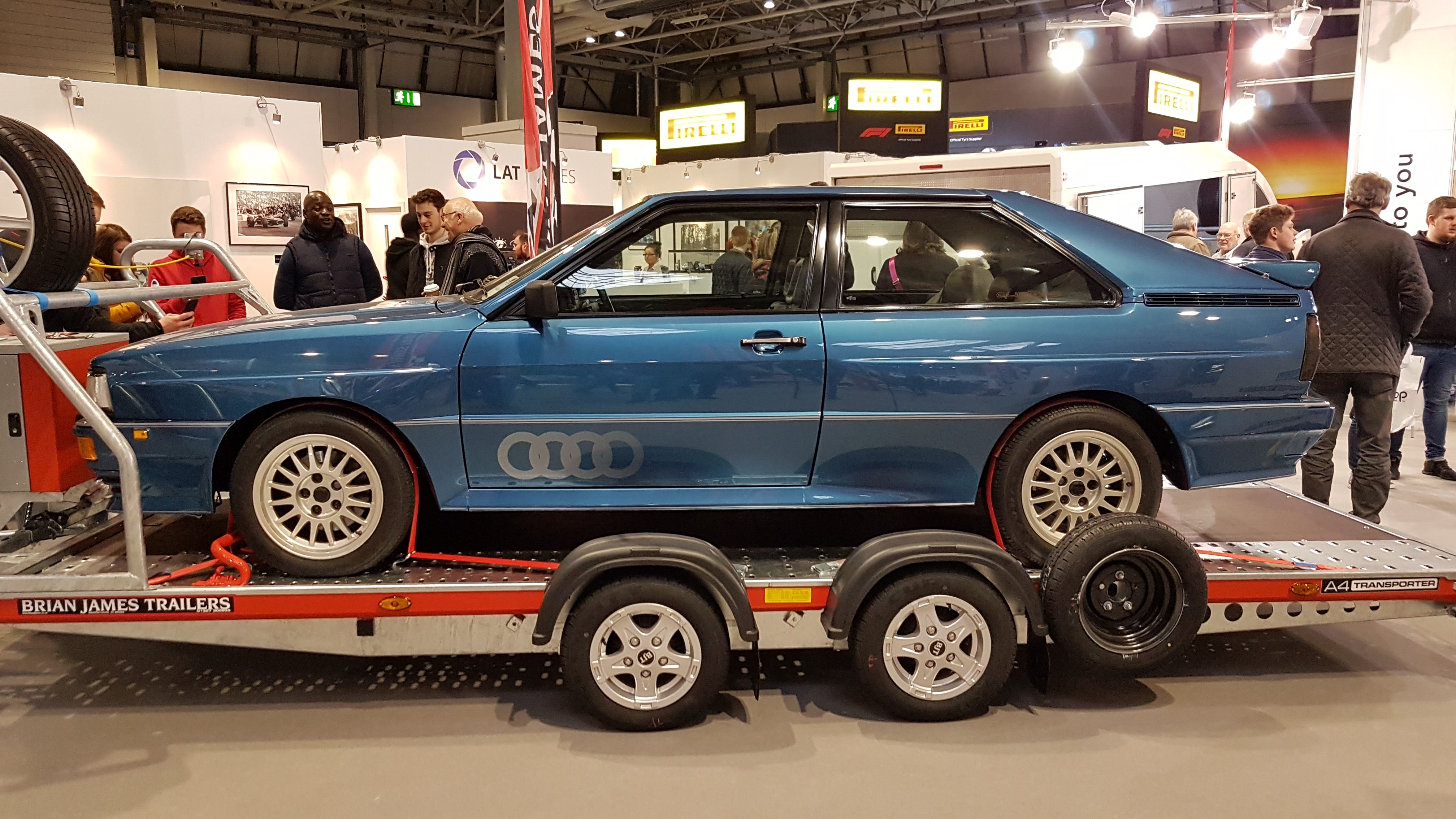

I saw it yesterday @ Birmingham Motorsport International. Love it!
Love it! Until recently the blue one was owned by Andi who runs one of the ur FB groups.
