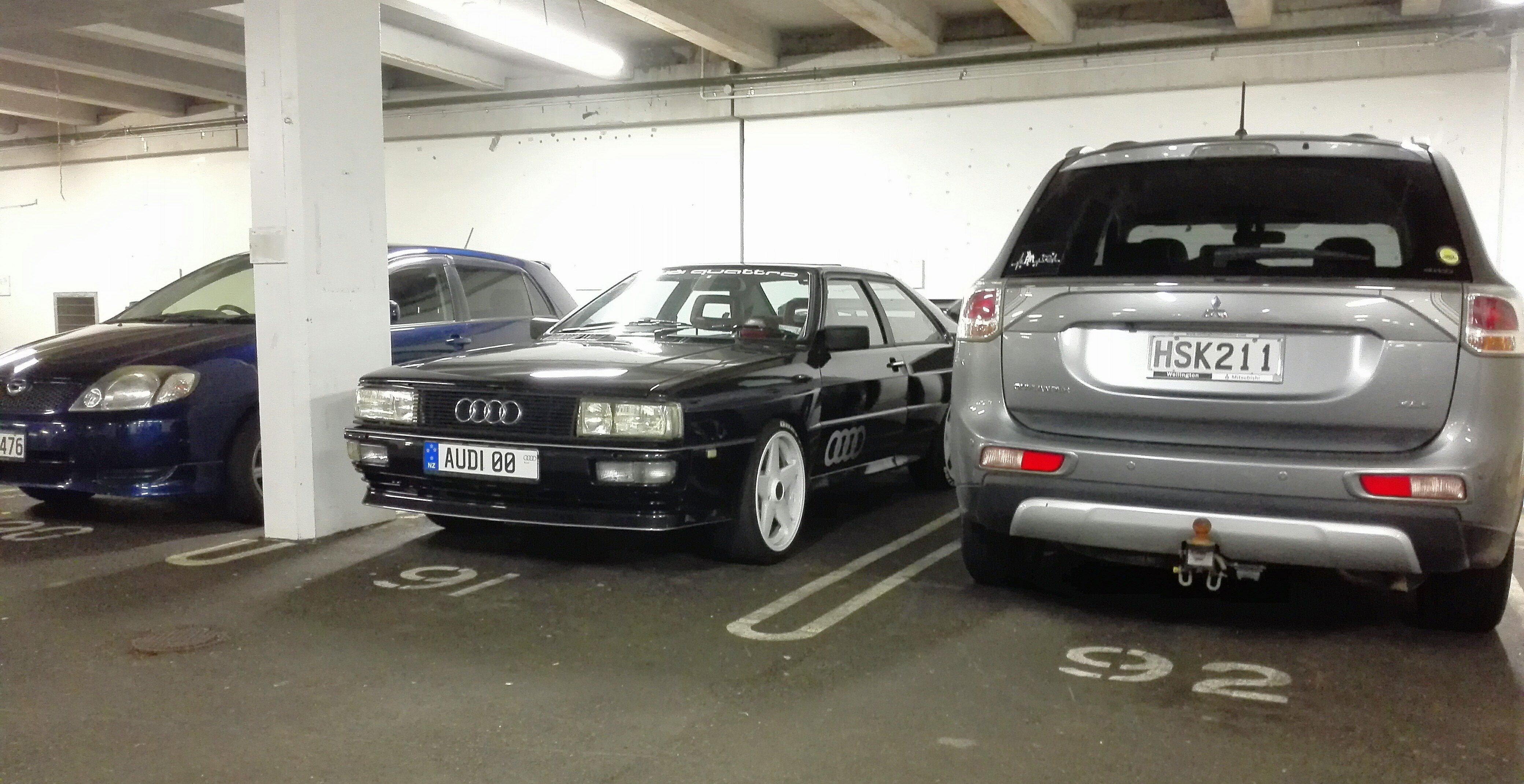

  • Went to the supermarket while I waited for traffic to die down a bit. Second supermarket car park of the evening. Terrible pic, it was getting dark The drive home was uneventful. L

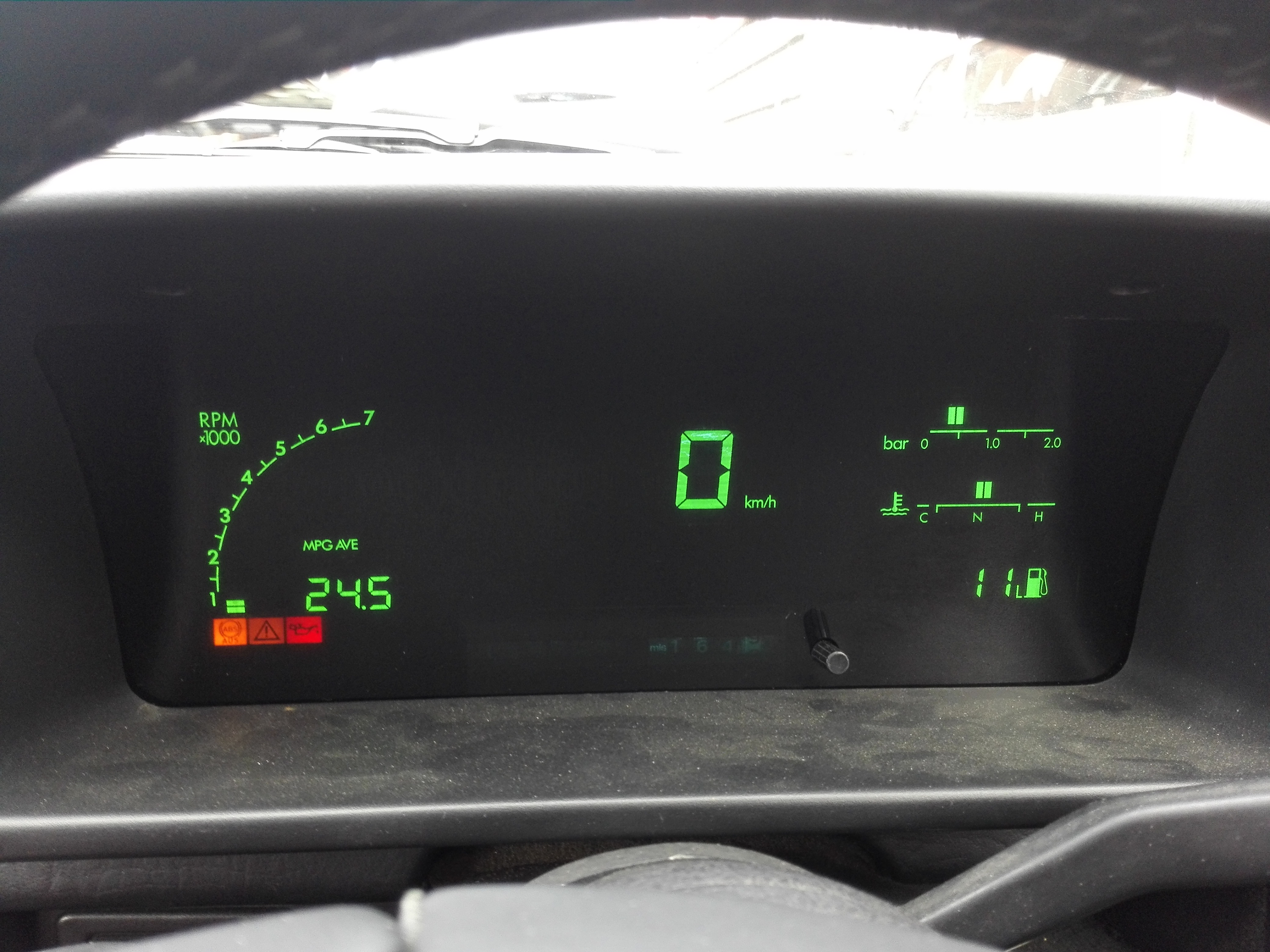

Average MPG isn't too bad over the first 200 miles or so.

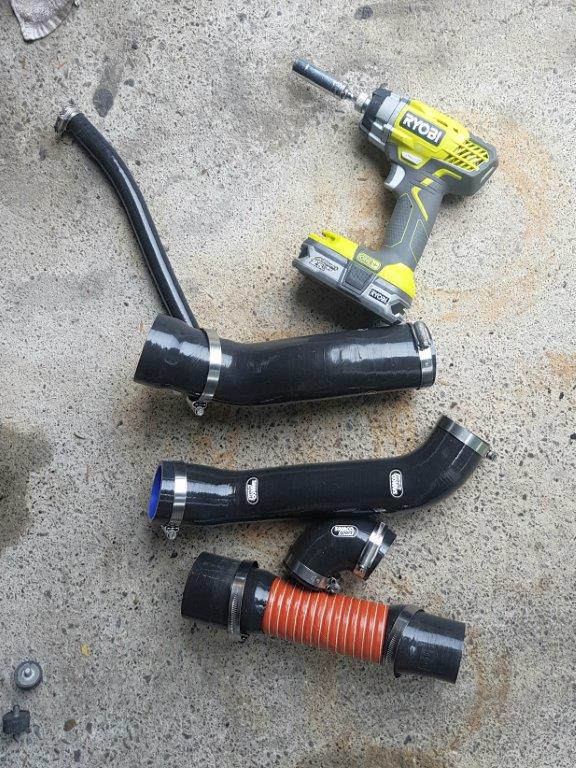

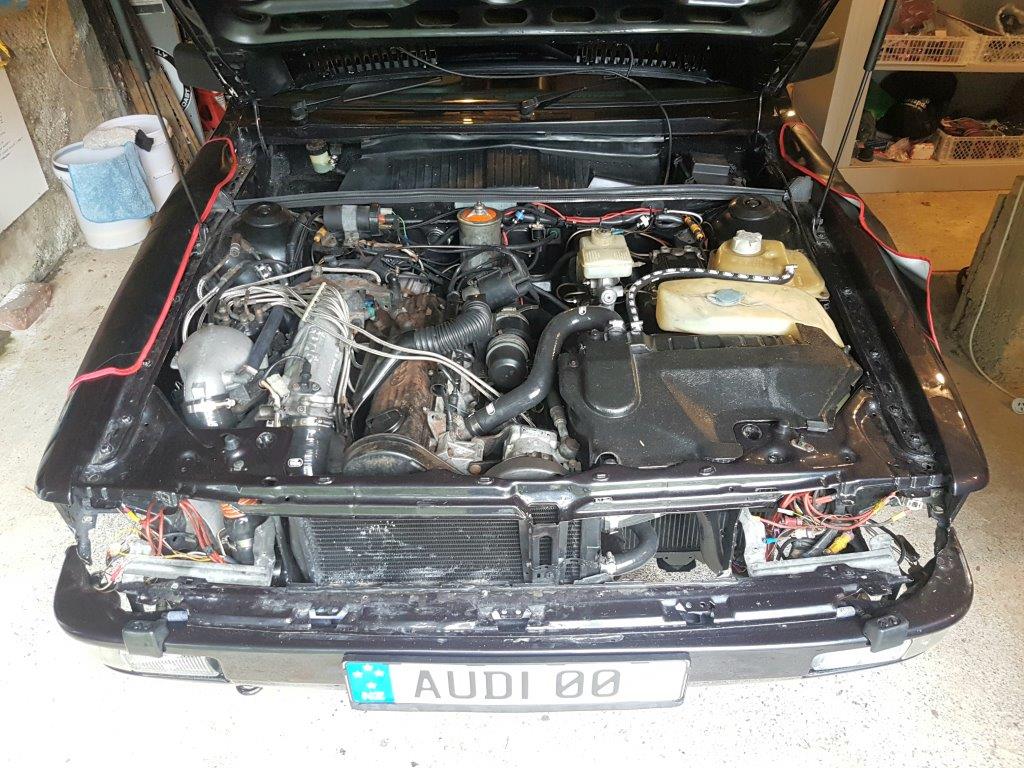

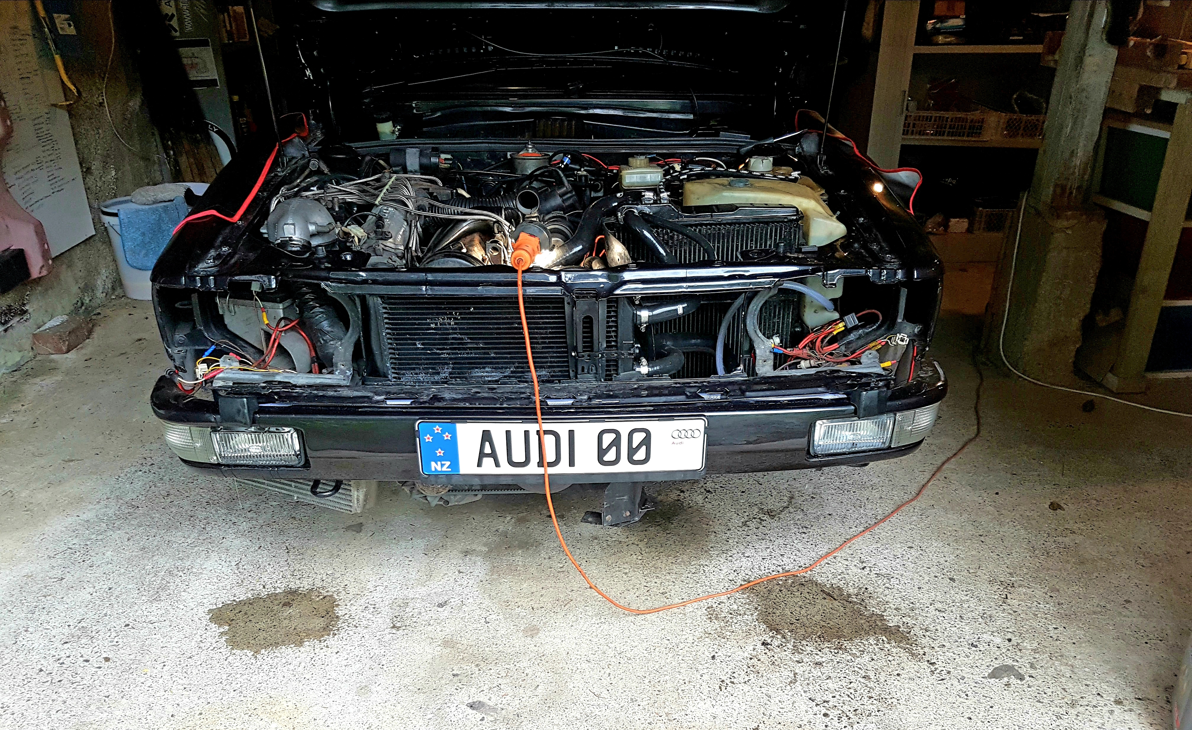

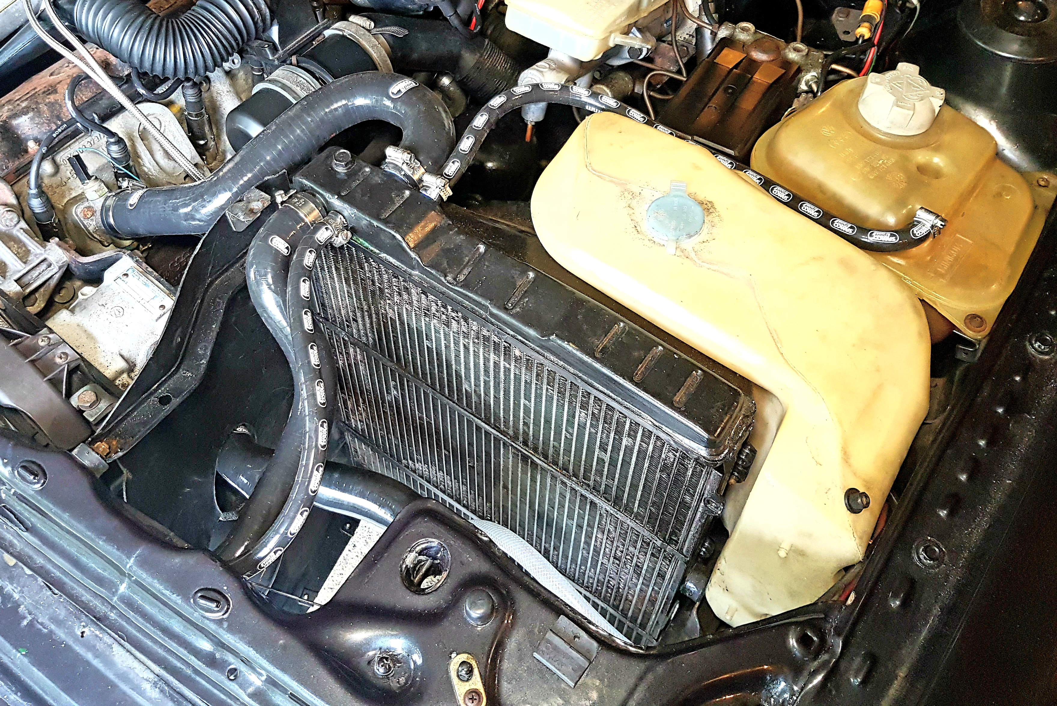

Took the front apart to start on the list of jobs I need to do. First, start fitting the Samco hoses.
31531602_1325505340883092_28409167608681
Coolant was weeping through this one.

Water hoses done.
Edited by RobClubley

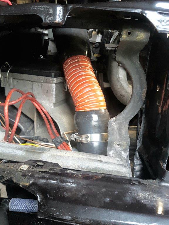

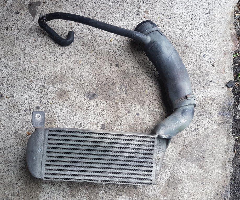

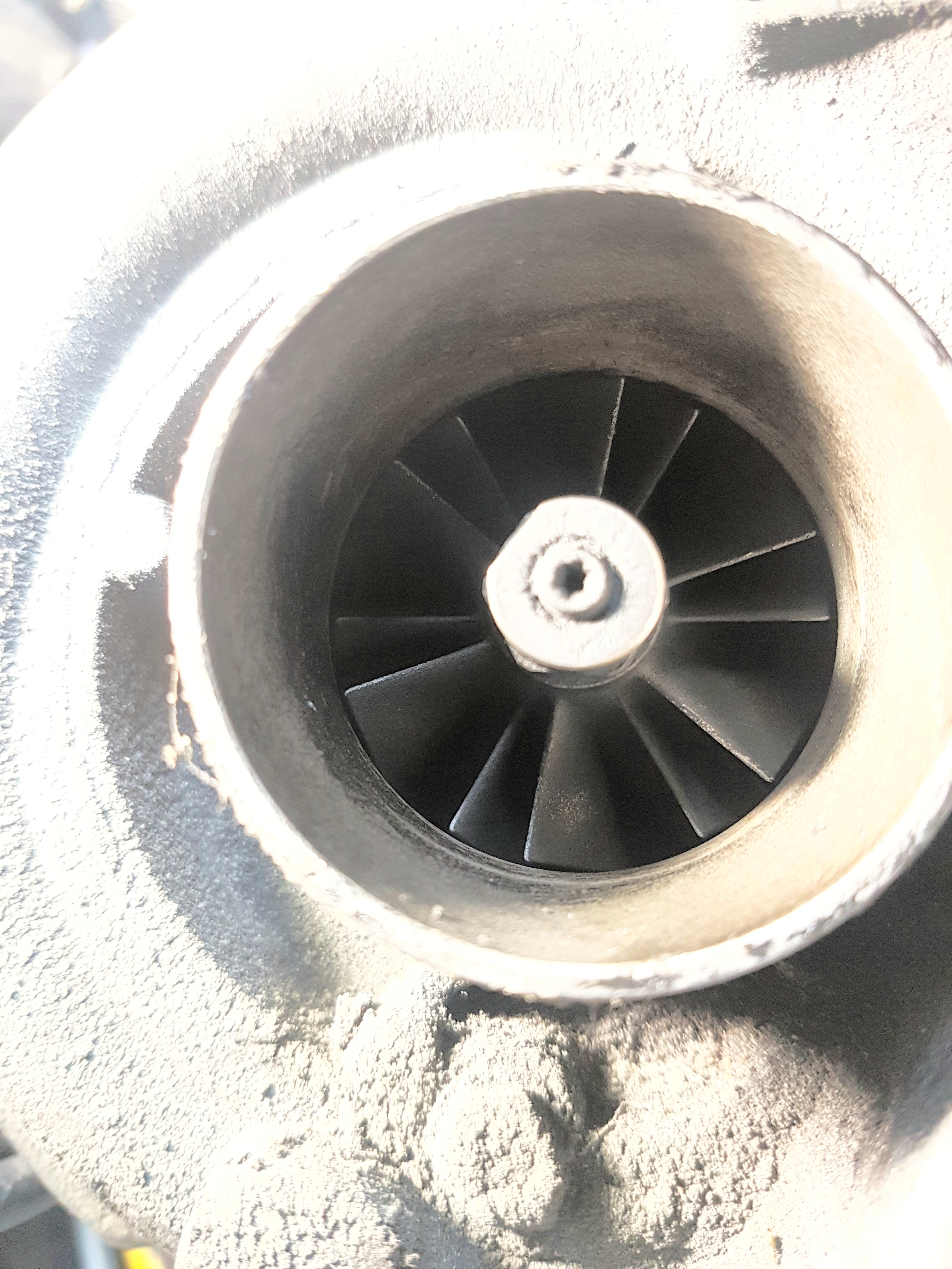

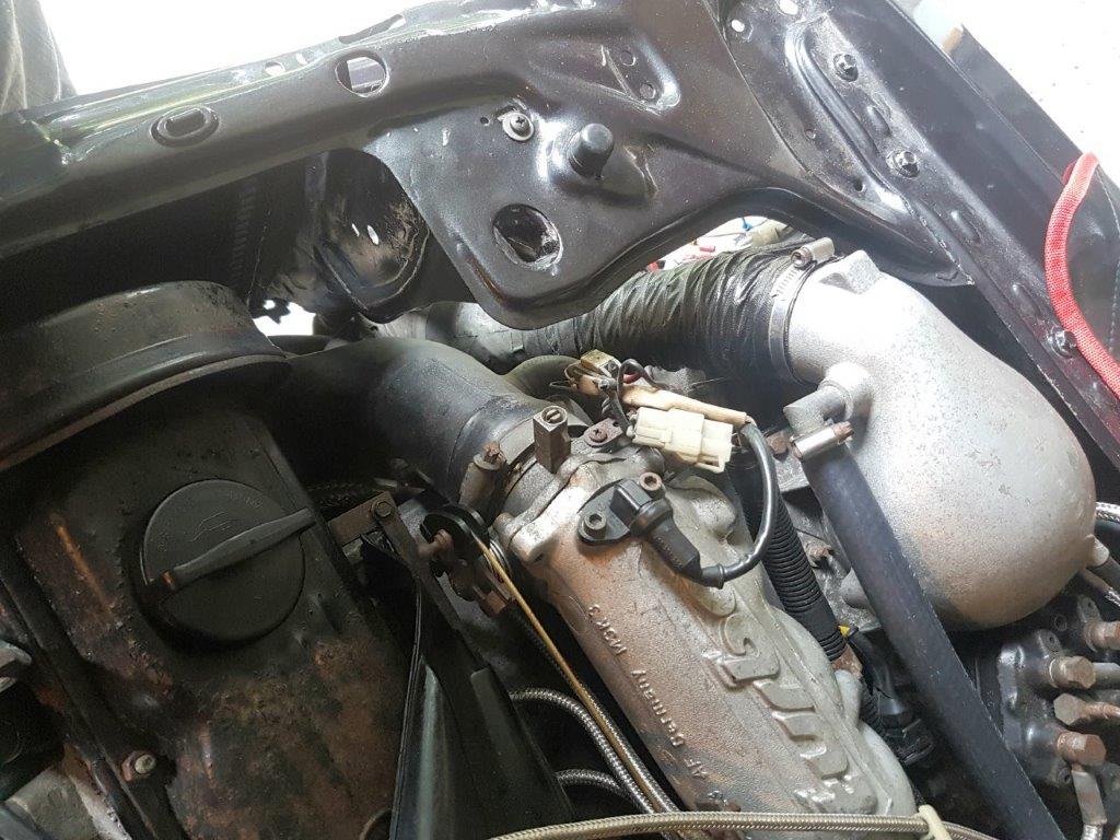

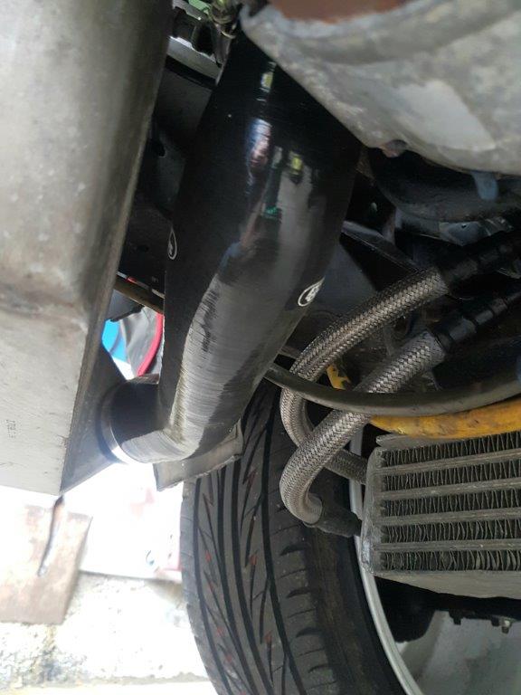

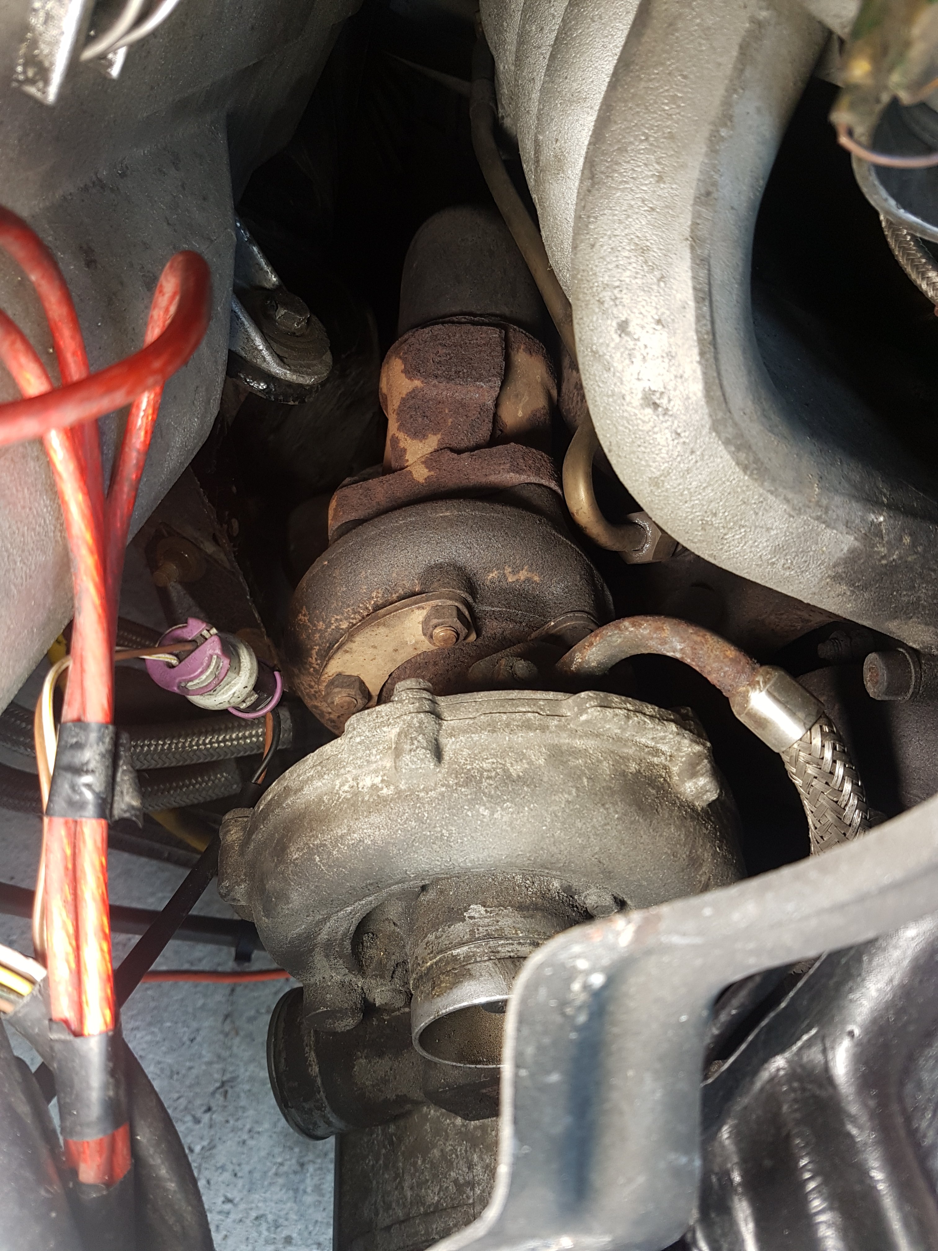

Got the boost pipes done today.
First time I've really got a look at the turbo. It looks alright. No play in the compressor wheel.

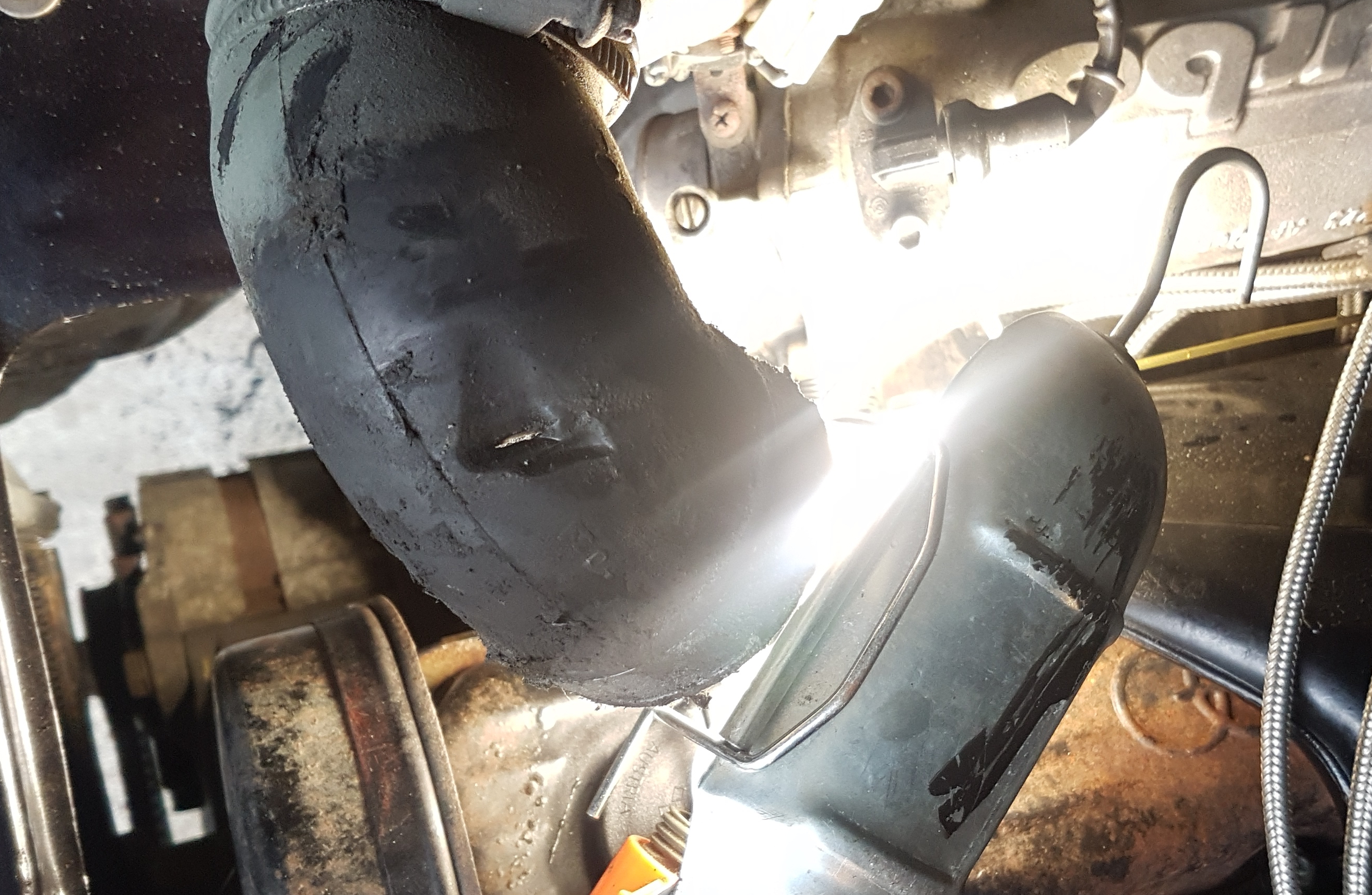

Hmm that's not so good. The flexi hose to the intake was repaired with duct tape, too.
All back together - time for a test drive. It feels a bit better but still runs out of power at about 5000 rpm.
The intake hose is slightly twisted so might be deforming under boost - need to loosen it and sort it but it's a pig to get to.

Just checking.. yep the coolant stayed in.
