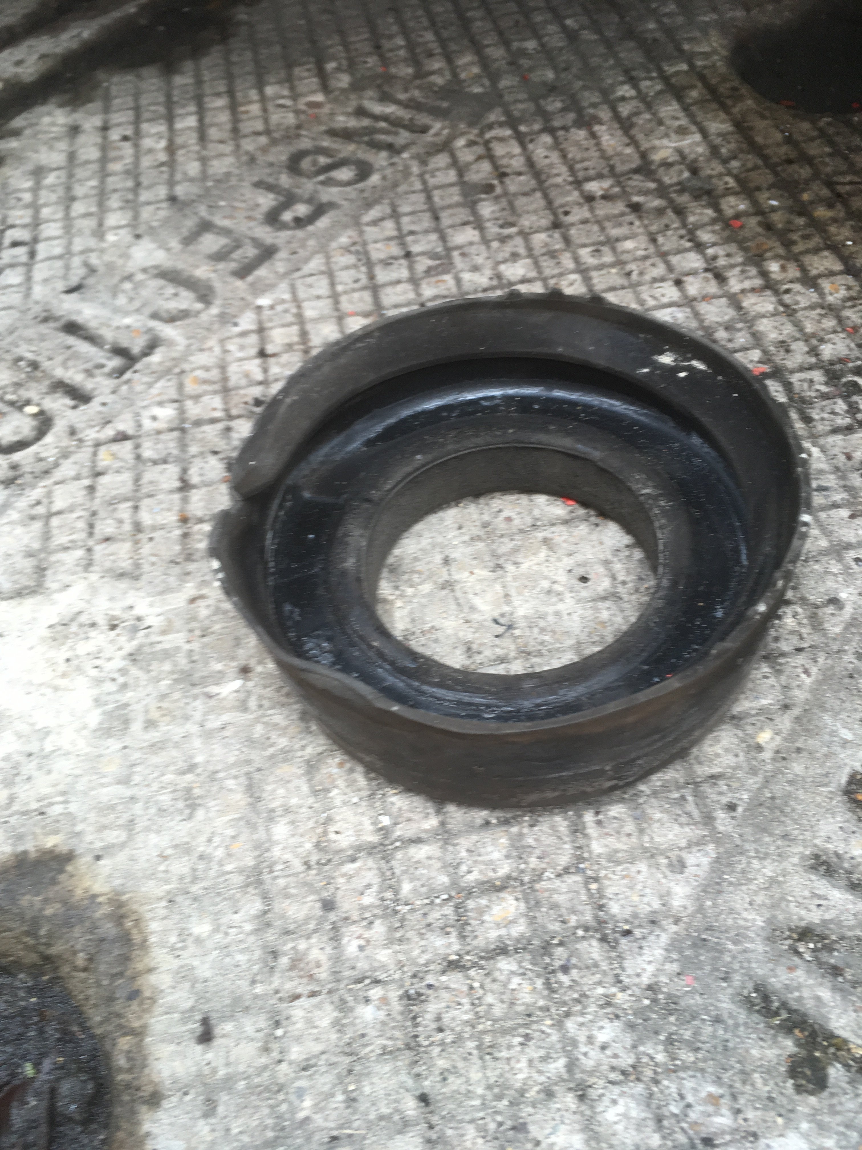

On the way home we had 4 people in the car, and it started and went well. Rear wheels were rubbing though. It seems to be about 2cm lower on the rear left, which is weird, and doesn't help.
Not sure why that would be but I'm going to have to give in and take it apart at some point I think. I'd like it to be a little higher at the back, but I'm not sure how I can raise it just a bit without changing springs.
Also I really need to get a resonator added to the exhaust - the drone at 90-100kph is a bit much
43059048_1513719012061723_42659630940873
Have a look at/for the spring pads that go between the coils and the seats.
At least it looks level on that slopey floor :D
Still love those wheels :)
Ditto, my old merc 190e has different thickness spring pads depending on the equipment on the car. They go on top of the spring to the cup and you could get different thickness to fine tune the suspension, I assume most of that era has similar things
Edited by TrevorB33
This looks promising..
https://www.trademe.co.nz/motors/car-parts-accessories/parts-other-makes/suspension/listing-1793919863.htm?rsqid=2fc20b4593e84074b6b513ad29e94207
It'd be sandwiched between the top of the spring and metal top cap, so would be captive.
If it helps any, the red 'un looks to be sitting lower on the offside and your's looks about level based on measuring on my monitor.
