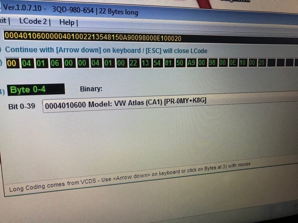

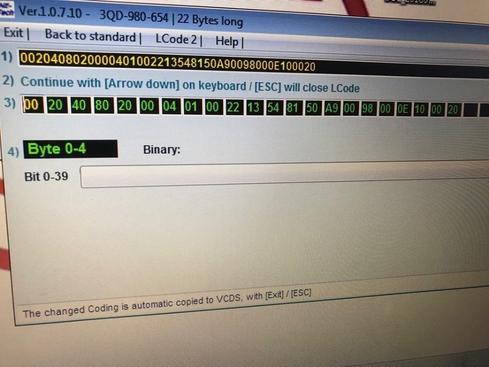

I think I have a big problem with А5 controller (FrSensorDrvAssis). When I enter the 07 Coding Menu, in Byte 0 it says VW Atlas,  it does not say Skoda Superb. It does not accept the coding when I reselect Skoda Superb and the field becomes blank. Why is that happening?

Is there anybody who could enlighten me what should I do? I starting do get worried a bit :D Vw Atlas is a SUV and when the A5 controller is coded for Atlas it may have different values that are set for the HBA. Maybe I have messed something up when I coded the HBA. Still, I haven’t noticed any other problems with the car.

Do you have backup before doing any coding?
Never change first few bytes of this module. There is no need.

Unfortunately, I didn’t make a backup. When I opened the controller, I just saw that it stated VW Atlas. When I tried to change it, it didn’t accept it. Can somebody upload  a photo of Byte 0? Thanks in advance.
It would be easier if you could copy/paste all the data for A5 controller, together with which version of VCDS do you use...

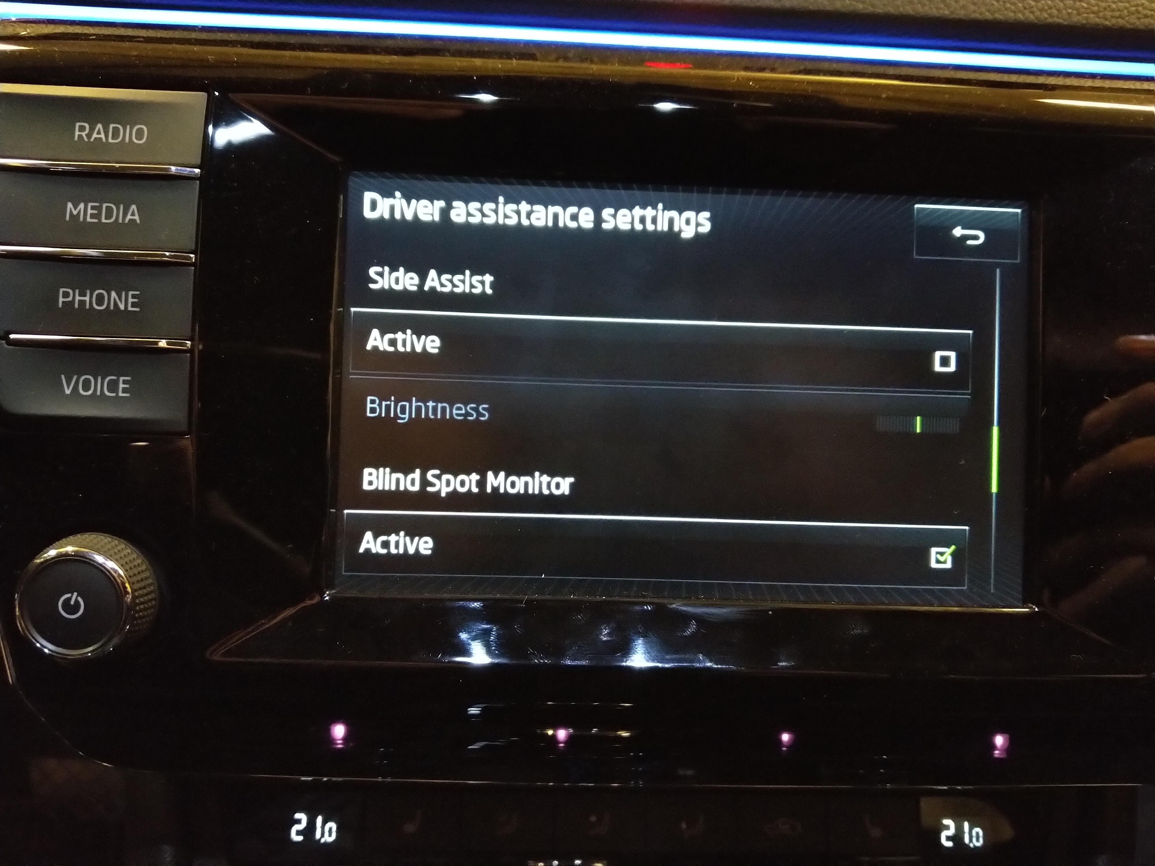

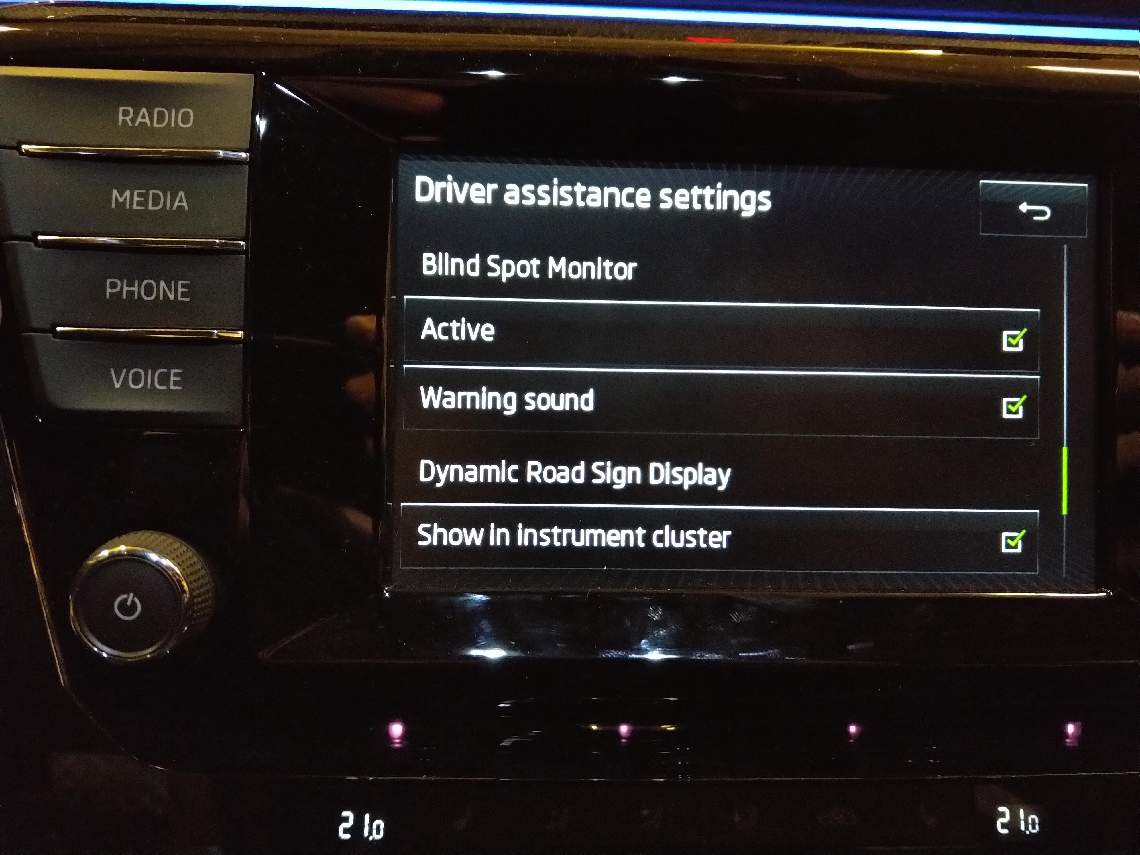

I too have been doing some coding and adaptions. My S3 MY16 was originally fitted with ACC and HBA so I enabled TSA and Lane Assist. All works as expected but I have magically gotten a few extra features enabled that are not supposed to be there:
These are Blind Spot Monitor and Side Assist. I don't have the hardware for these (yet) so the should not be there. Another problem is a few errors that are (probably) related to me entering some wrong adaptations. To sum up:
  1. How do I hide Side Assist again from the menu?
  2. How do I hide Blind Spot Monitor again from the menu?
  3. What does A5::C10ACF2 - Steering - Interface for lane departure warning system not coded, HC_interface_at_the_steering_not_activated mean and how do I get rid of it ?
  4. What does 5F::U111100 - Function limitation due to missing message - Road sign display (0x21) - function restriction due to communication error - BapErr_retry not successful mean and how do I get rid of it ?

Without trying to sound too harsh, contacting CarPort is your best bet.
