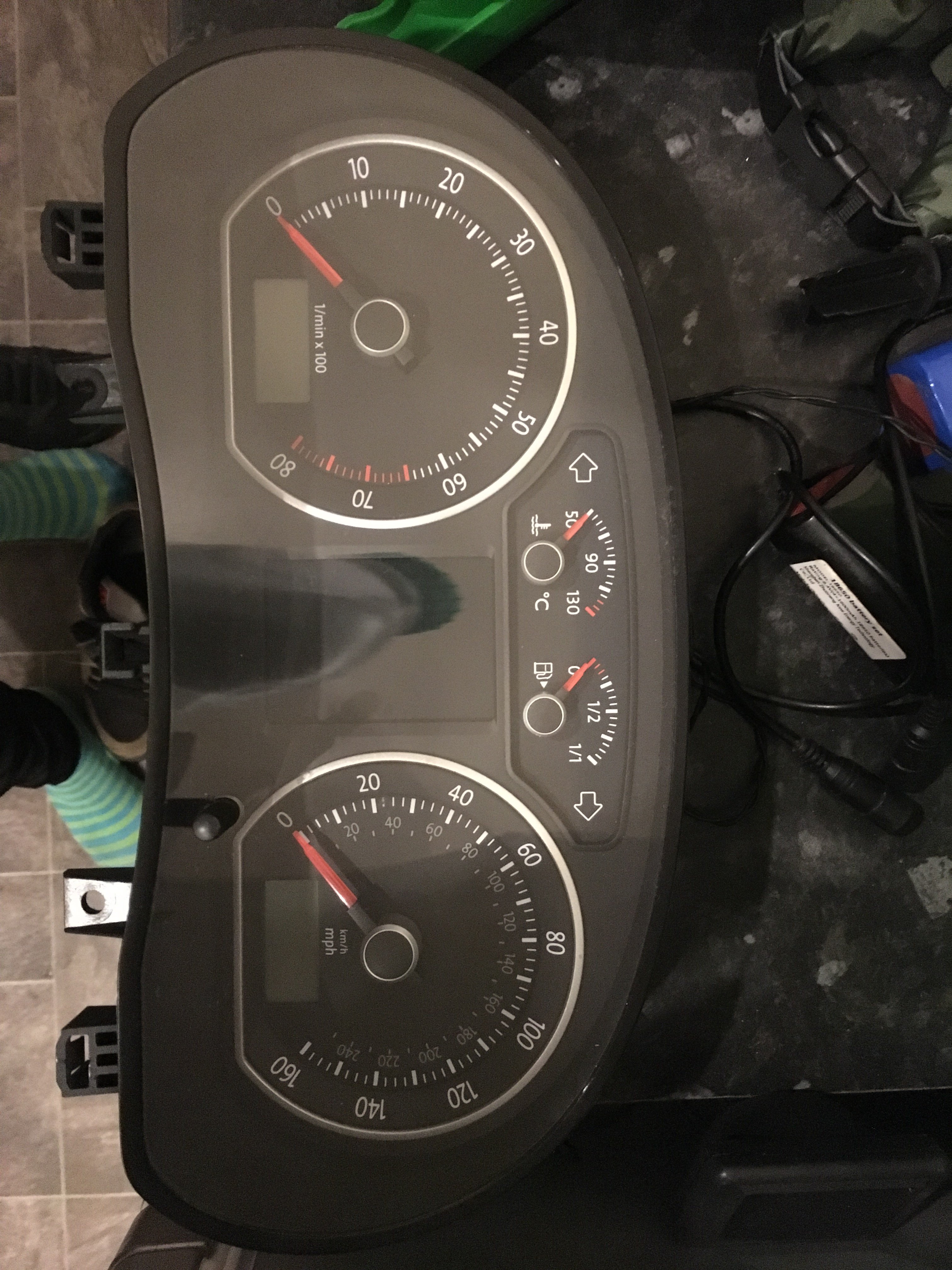

hopefully i can get these Polo GTi ones in and working.

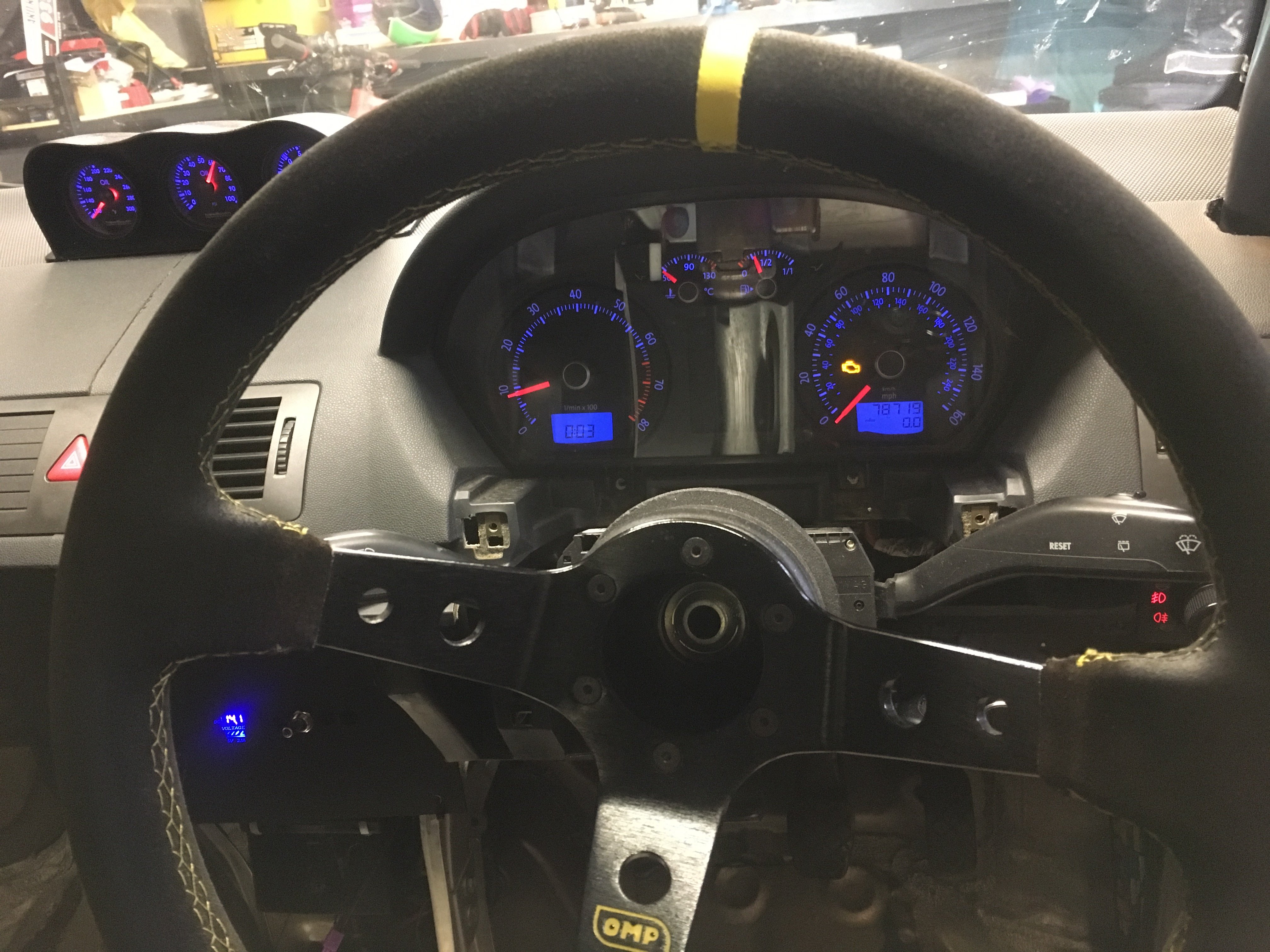

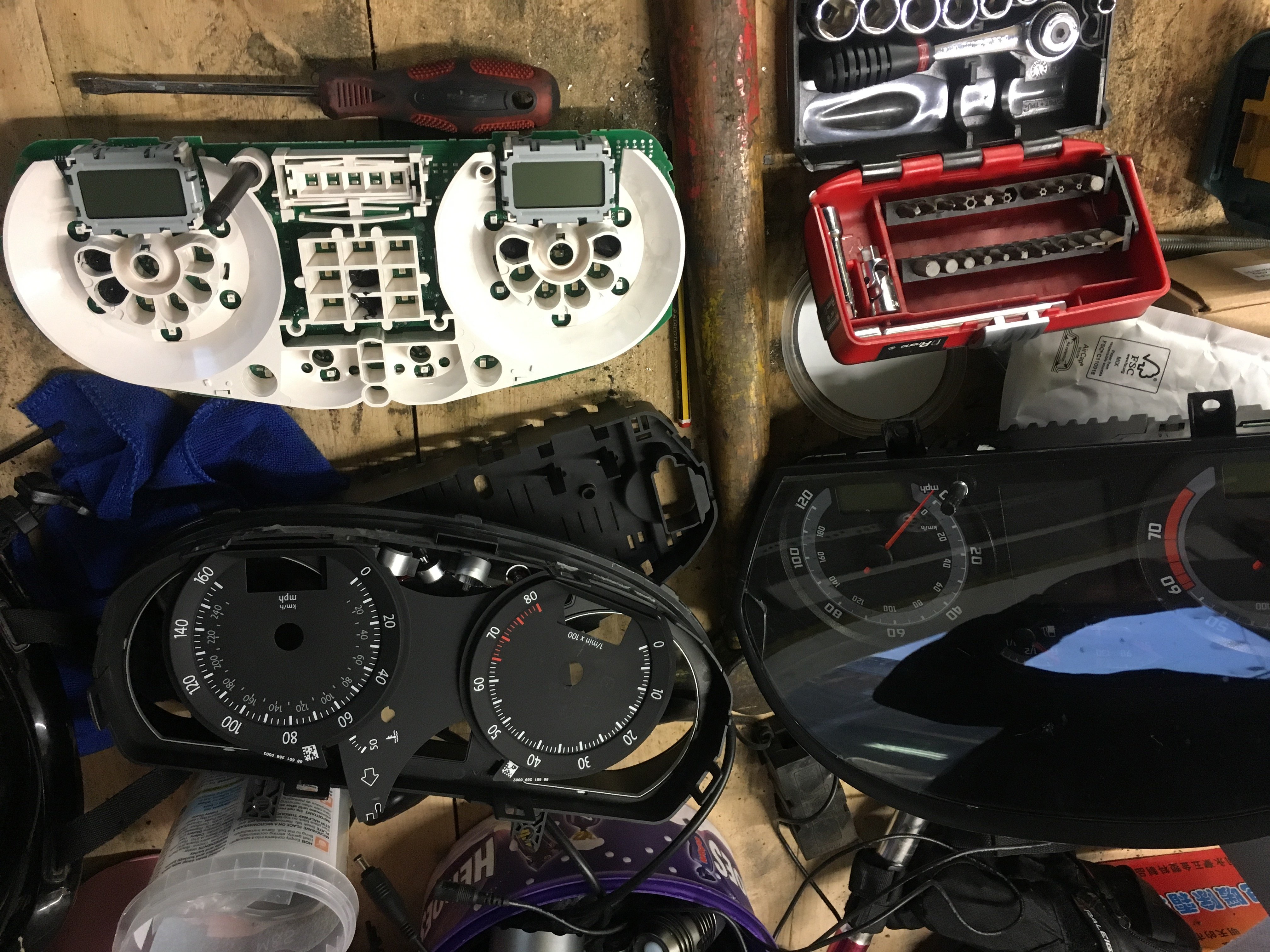

Trial fitted the clocks, car starts and runs fine. So coding works. Split down the GTi clocks, put some black silicone over the LEDs that arent needed like airbags etc whilst its apart. Mainly so in the future i can strip the wiring back and not worry about spurious lights coming on.
Dropped my fabia clocks, so now need a new housing as its cracked the screen :@
Were you running the 1.2 dash still ? I can’t remember
Yeah, clocks only go to 120 and cant keep up. They werent smooth, just step changes :rofl:
Polo clocks fitted, need some more work but they will do to see how well they work.
look miles better :)

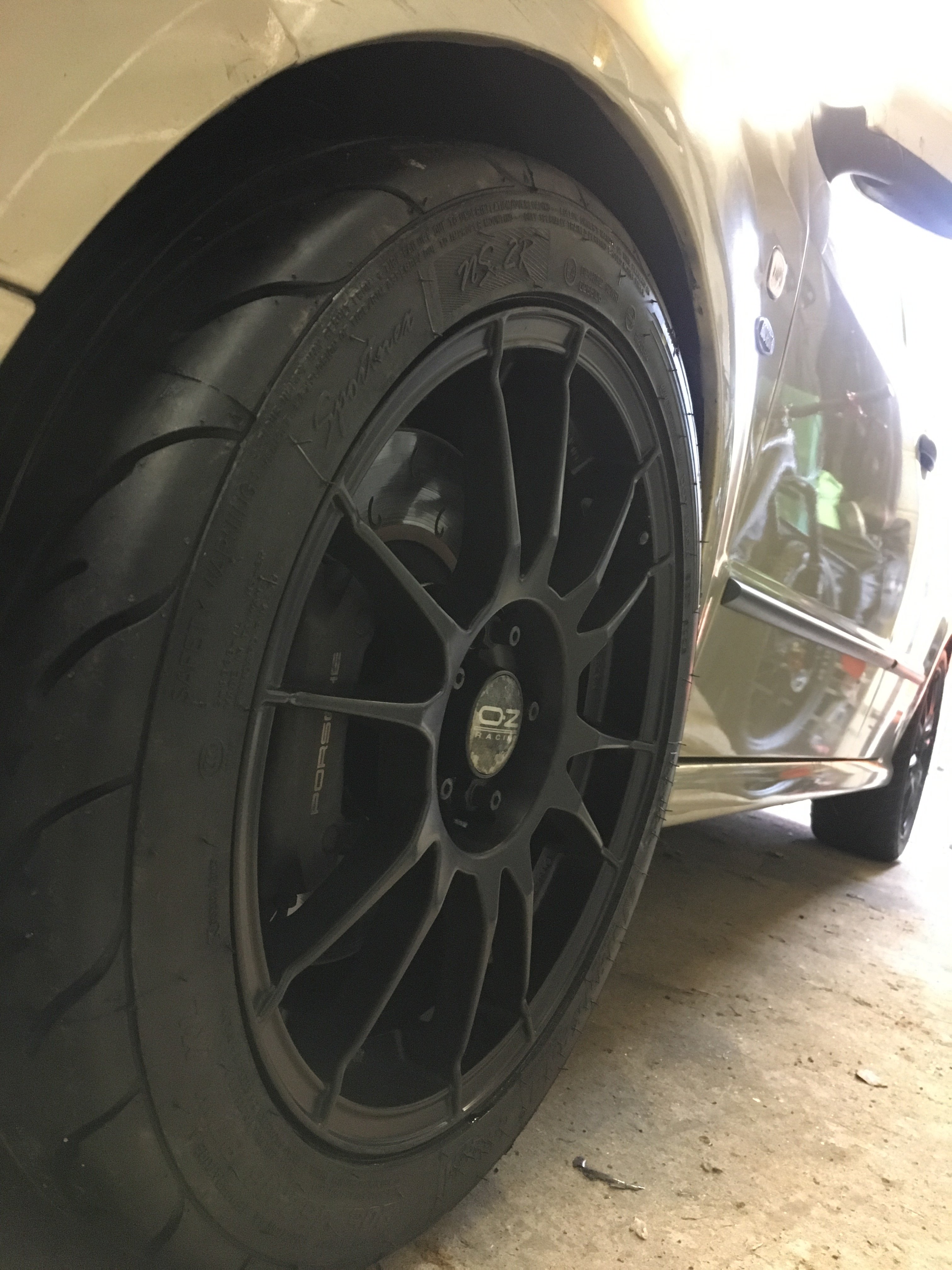

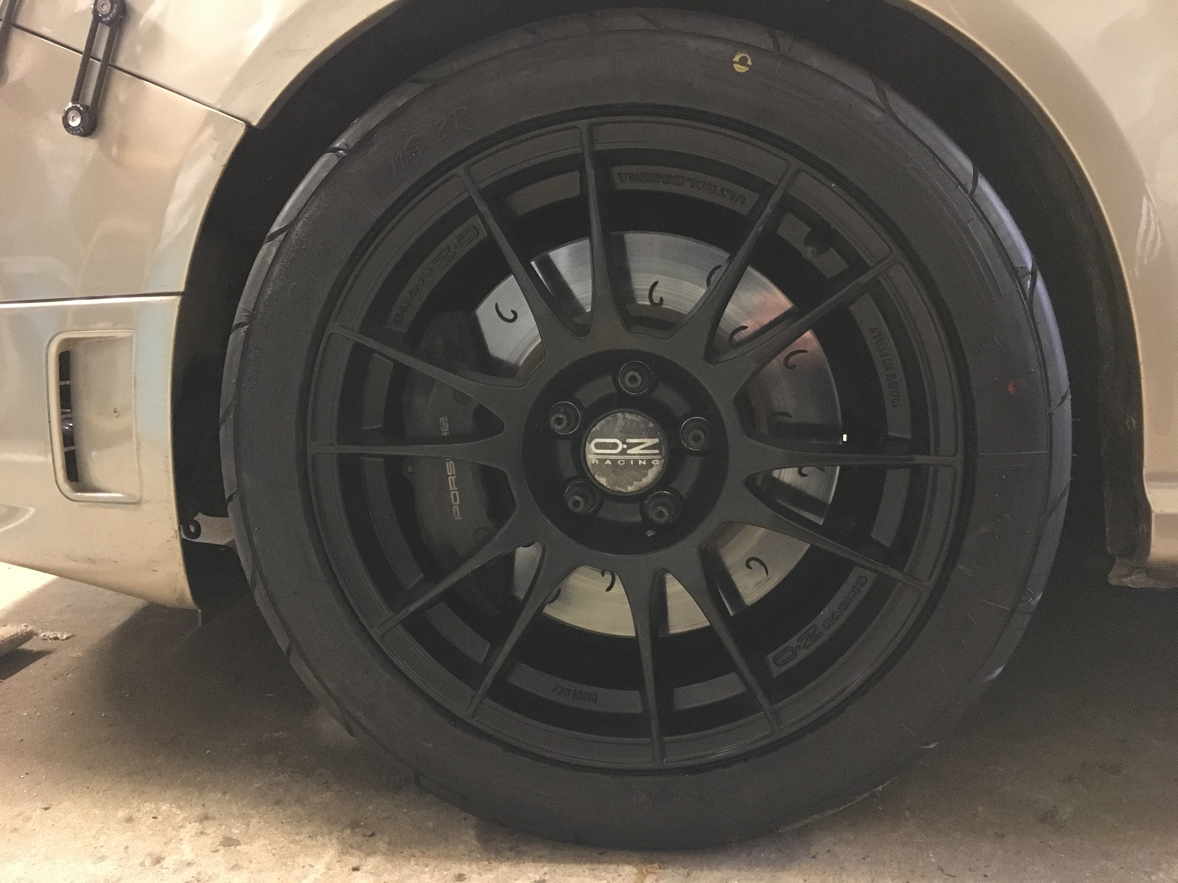

New Nankang NS2Rs fitted, never tried them always ran Federal RSRs so will see at Snetterton on Monday.
Not sure if i want bonnet vents either :wacko:
30 minutes ago, pip_vrs said:
Yeah deffo, hopefully accurate though. Will help next year in Germany to see how fast i’m going :giggle:
lol... yeah, helpfull to see how fast its going :) I stopped using the RSRs because they kept going oval on me.... the NS2Rs are just as good in the dry, need some heat in them though if you have gone for the "street" meduim compound.... not as good as the RSR in the wet I think.... (mine now have 3mill on and have stopped working in the wet! lol going to put some pilot supersports on the front now, to match what i have on the back, and hopefully try to stop killingmyself everytime I touch the throttle in the wet!)
Give us a little review after you try them on track on monday :)
Cars looking good. I used to run the Ns2r. Not a bad tyre. Found them quite slippy in greasy/wet conditions myself. But for £70 a corner there pretty damn good
Yeah ive had severaly sets of RSRs and allways been decent. Just thought id swap it up a bit.
just bought a new set of wheels too, should recieve them at Snetterton B)

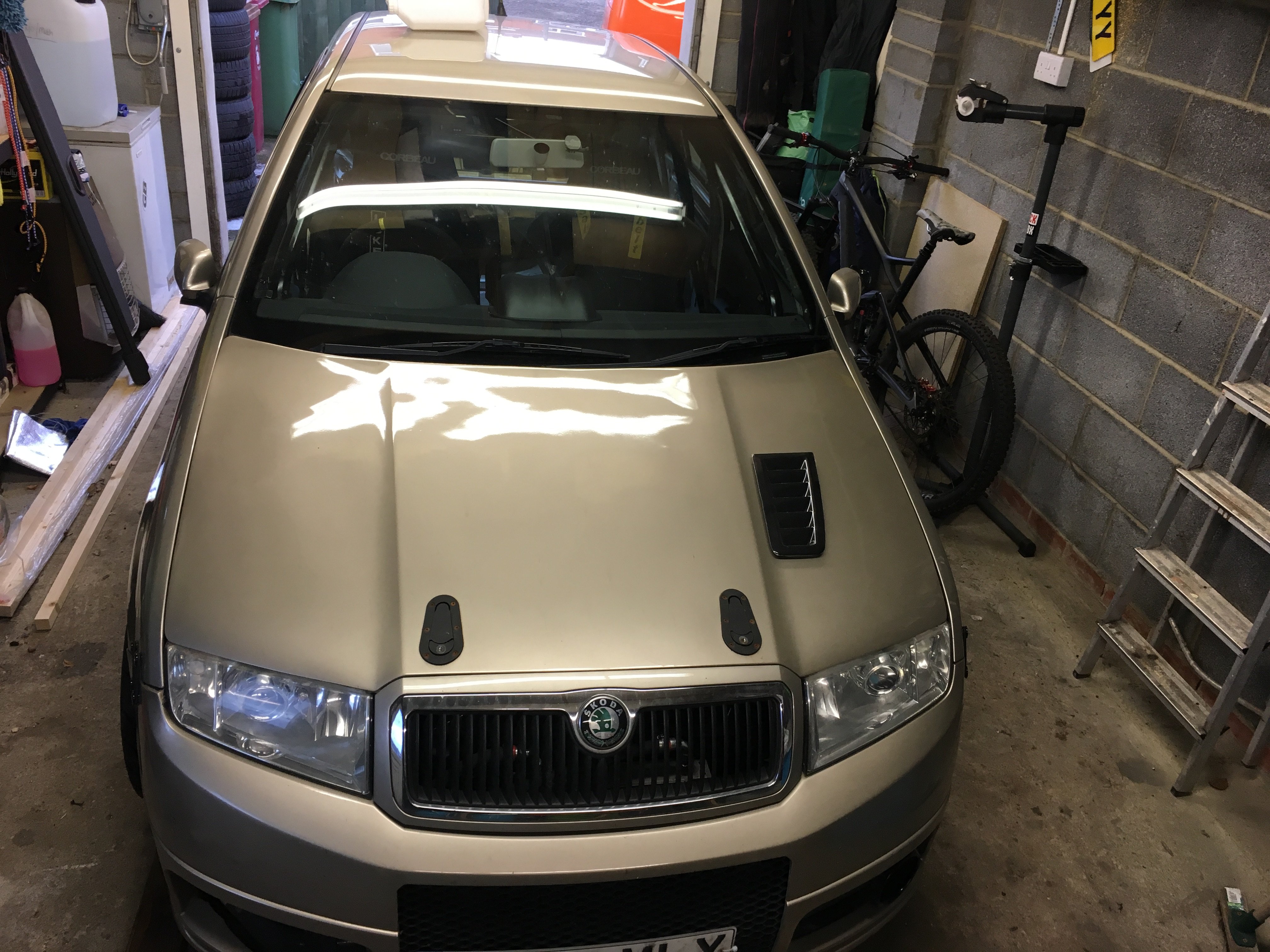

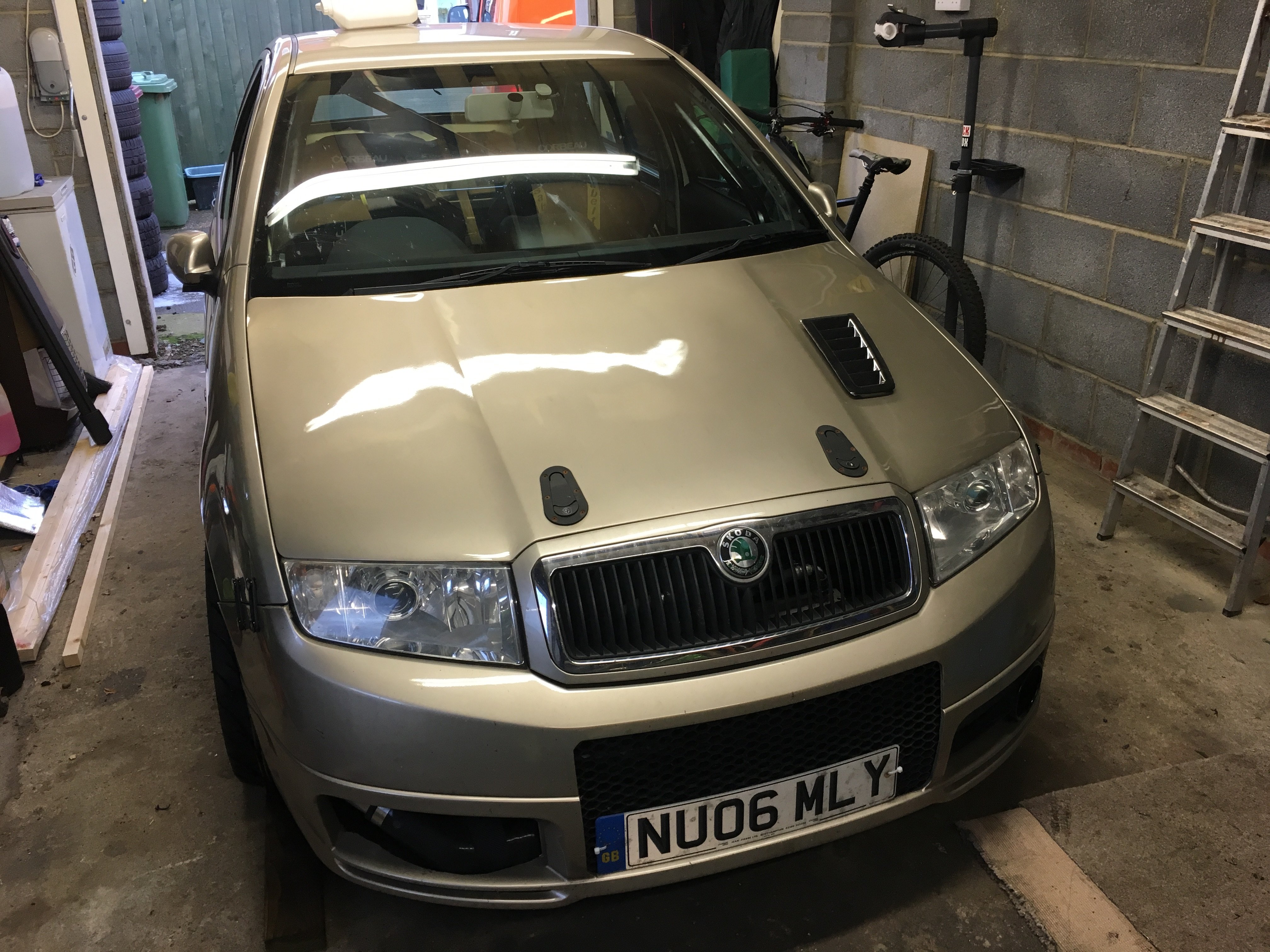

Think the bonnet vents would look pretty good :)
Yeah i just keep forgetting to fit them. Wont take 2 mins as bonnet is fibre so cutting out will tke 20 seconds.

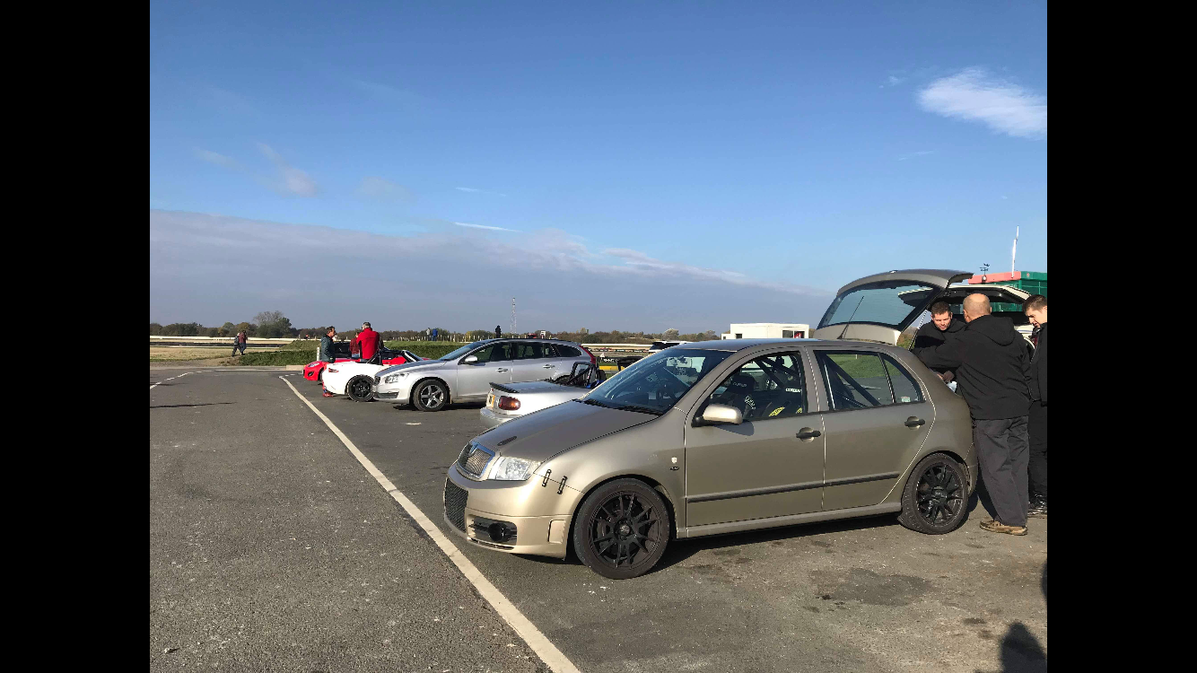

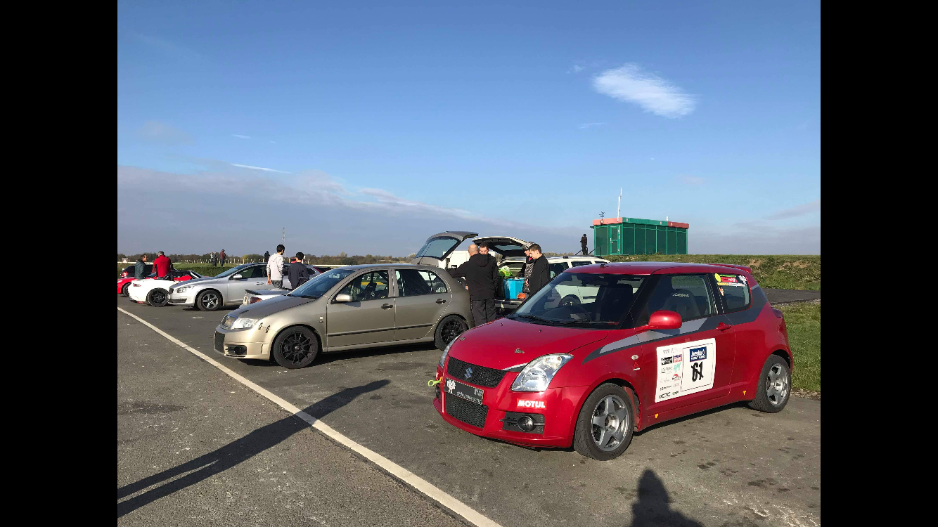

Snetterton bound. Hope i havent forgot anything.
It was a good day. Your car looked quick!
shame I didn’t get a few passenger laps with you
Looks like you hada fun day. What did you think of the nankangs
Slippery in the wet, but i dodnt expect otherwise. In the dry they seemed on par with RSRs, maybe lasting a little longer. But i wasnt braking as hard as i could have, so hard to tell really.
