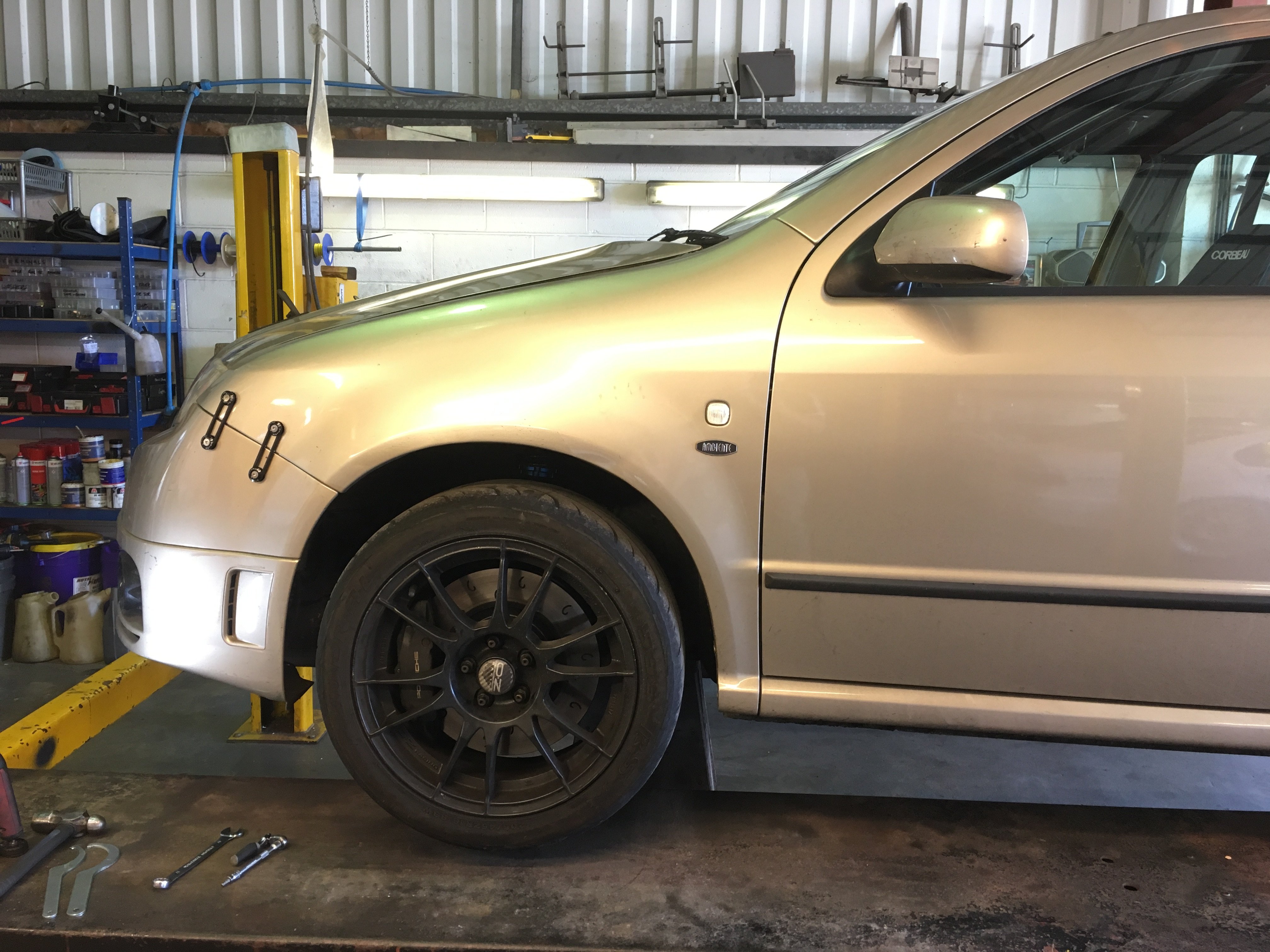

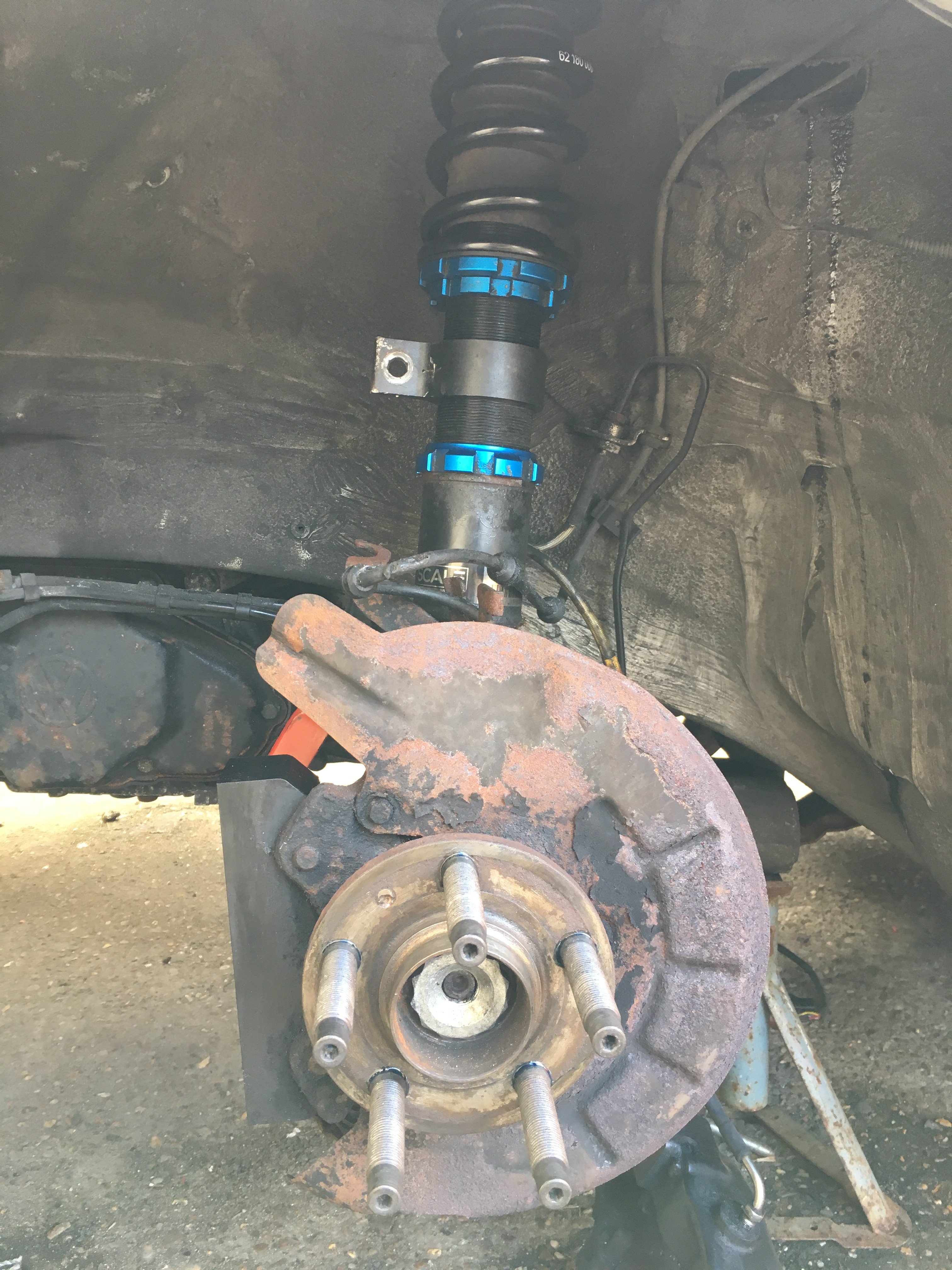

  • All fitted, all rattles and clonks gone. This Scale suspension is the shizzle. So well made its defintly worth the money. Damping set to halfway (6 clicks out of 12) Up on the ramps stripping everyt
  • Fitted driveshafts and all bolted up. Wheels on and lowered to the floor. All intercooler pipework installed, just front bumper to chop up to fit.   Started it and it runs!!! WHOOOOOOO

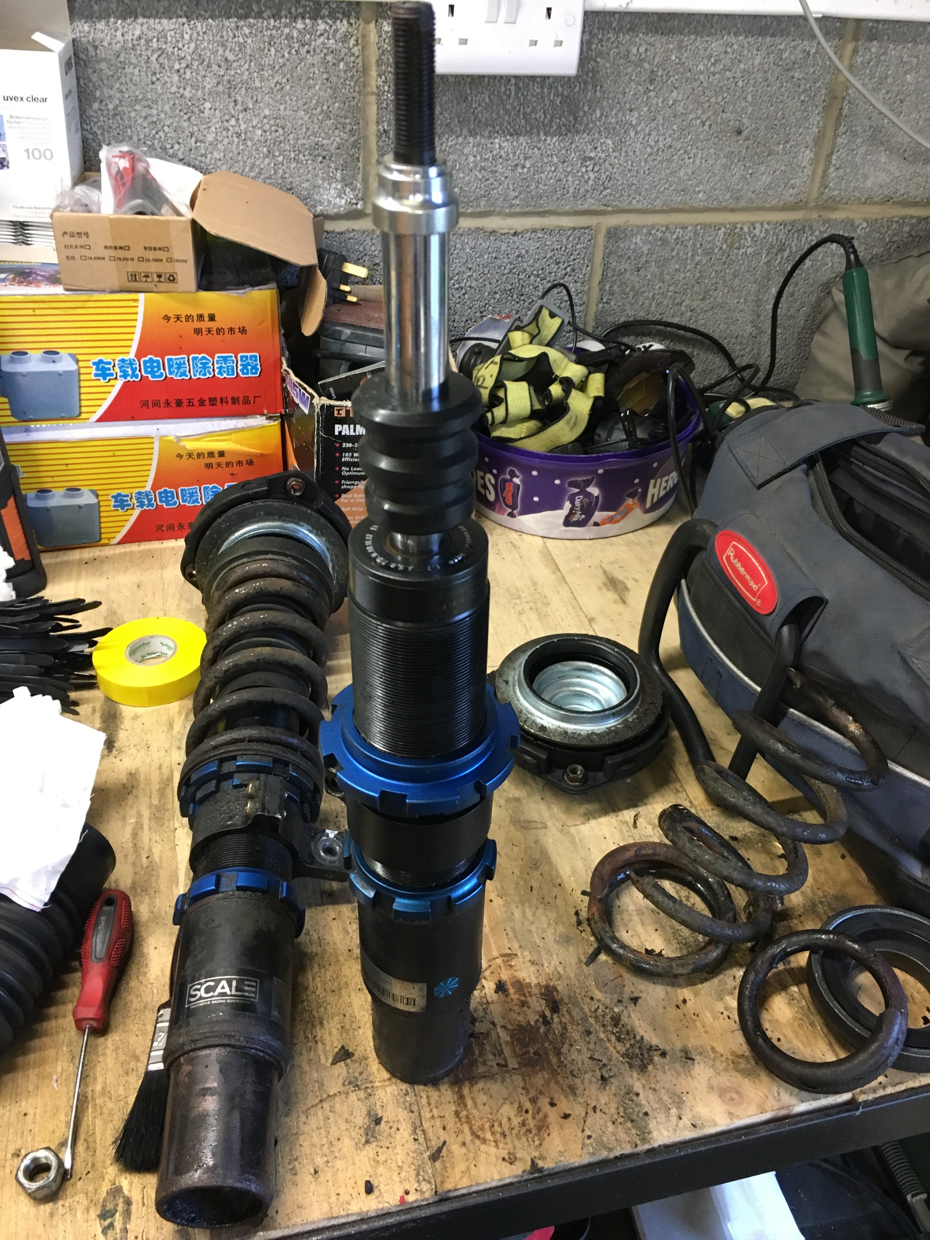

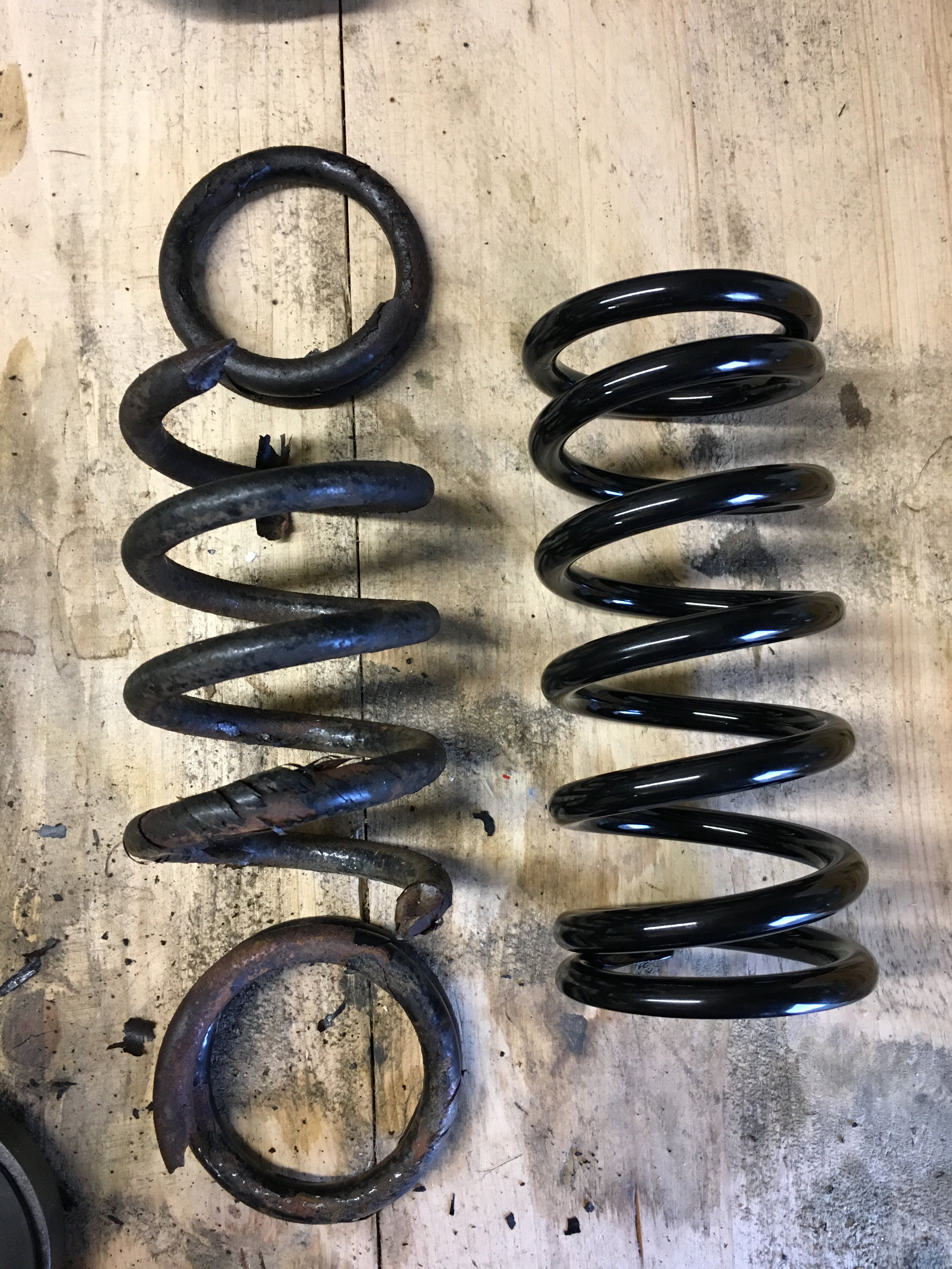

New springs and top mounts arrived so i’ve started on them.
Passenger spring snapped in 2 places.

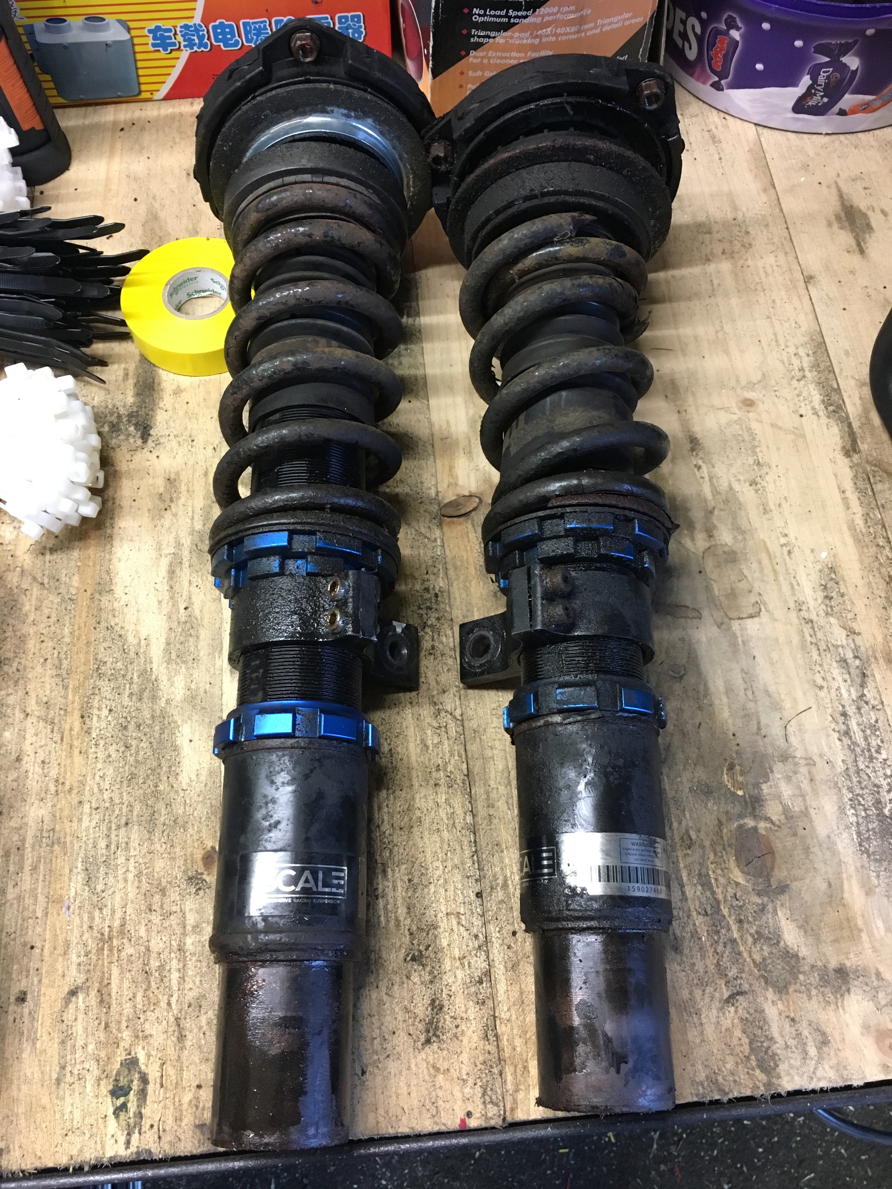

Gave them all a wipe down, measured up and adjusted for preload. Suprising how easy they adjusted, by hand aswell.
Will finish them off tomorrow.

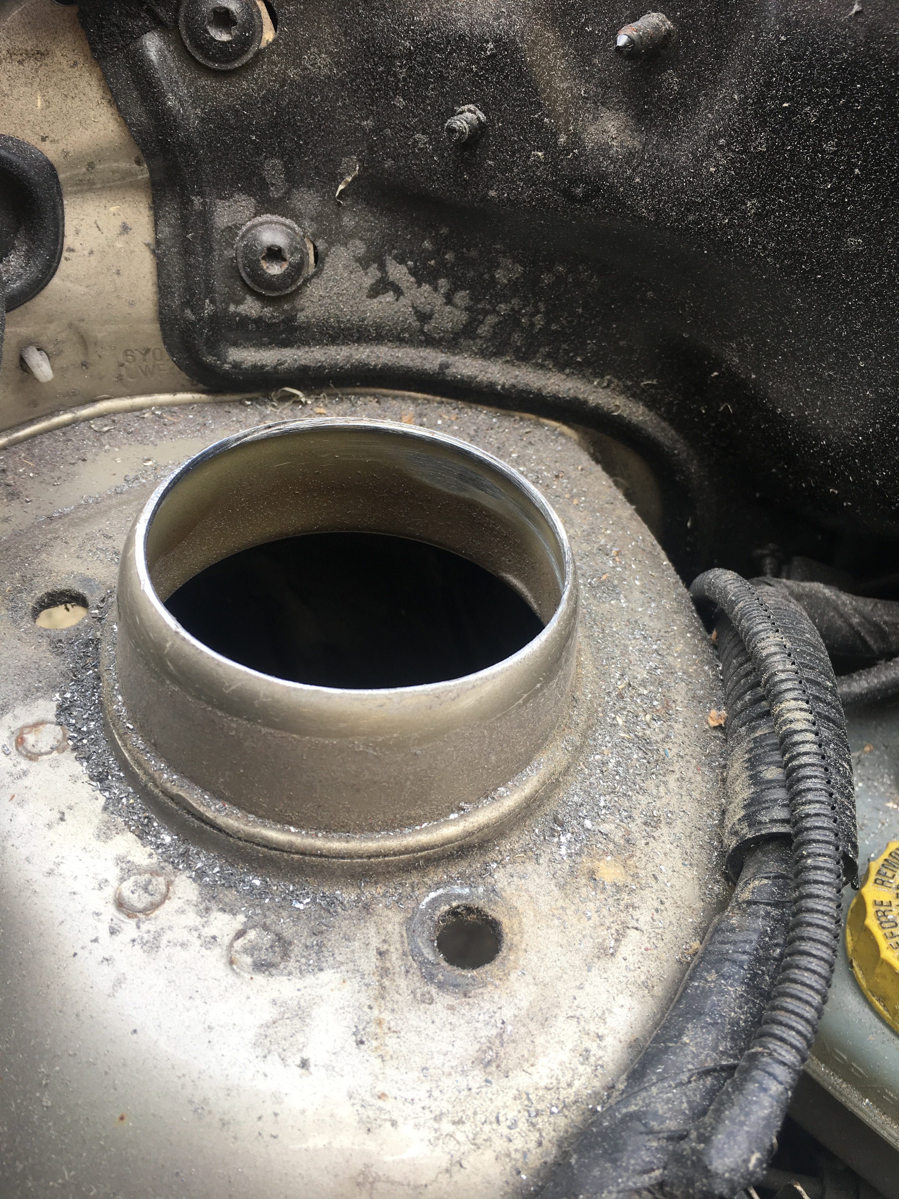

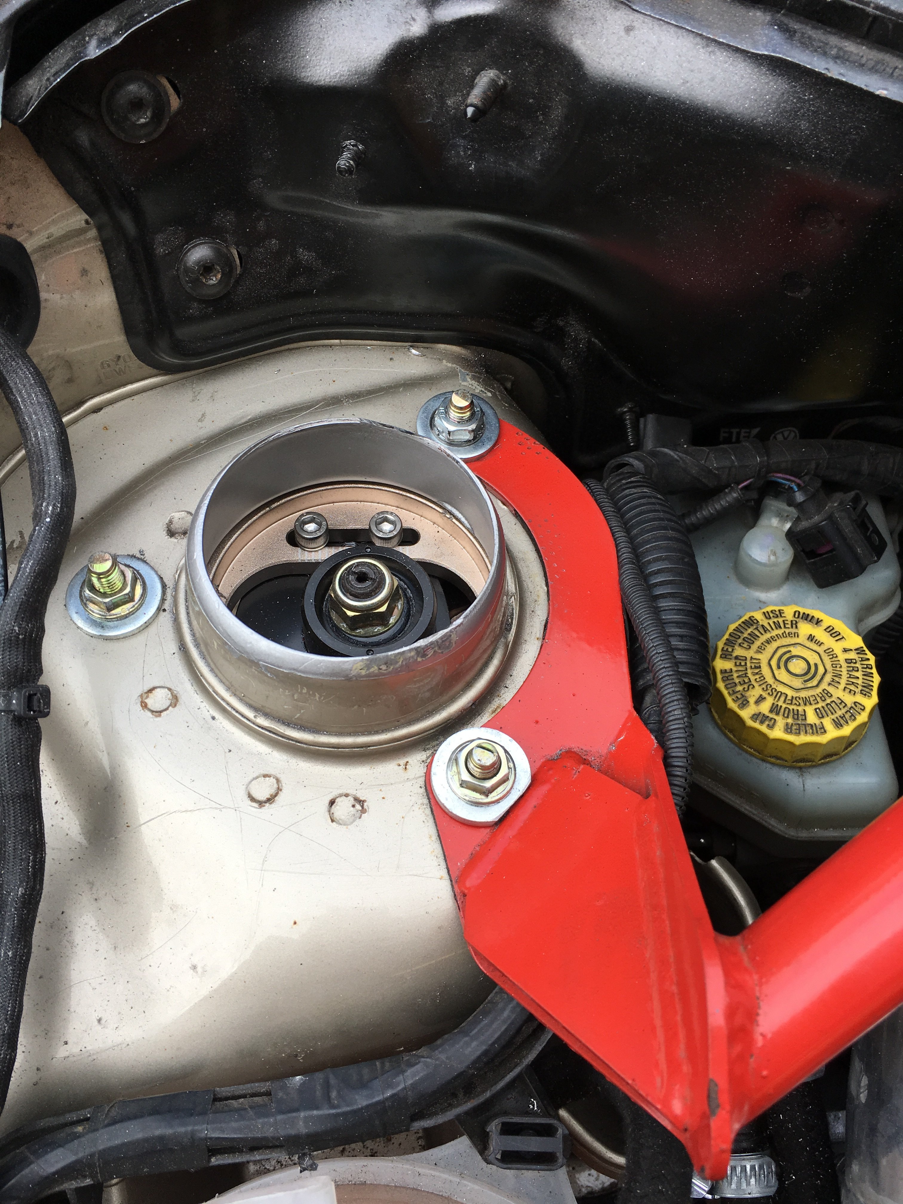

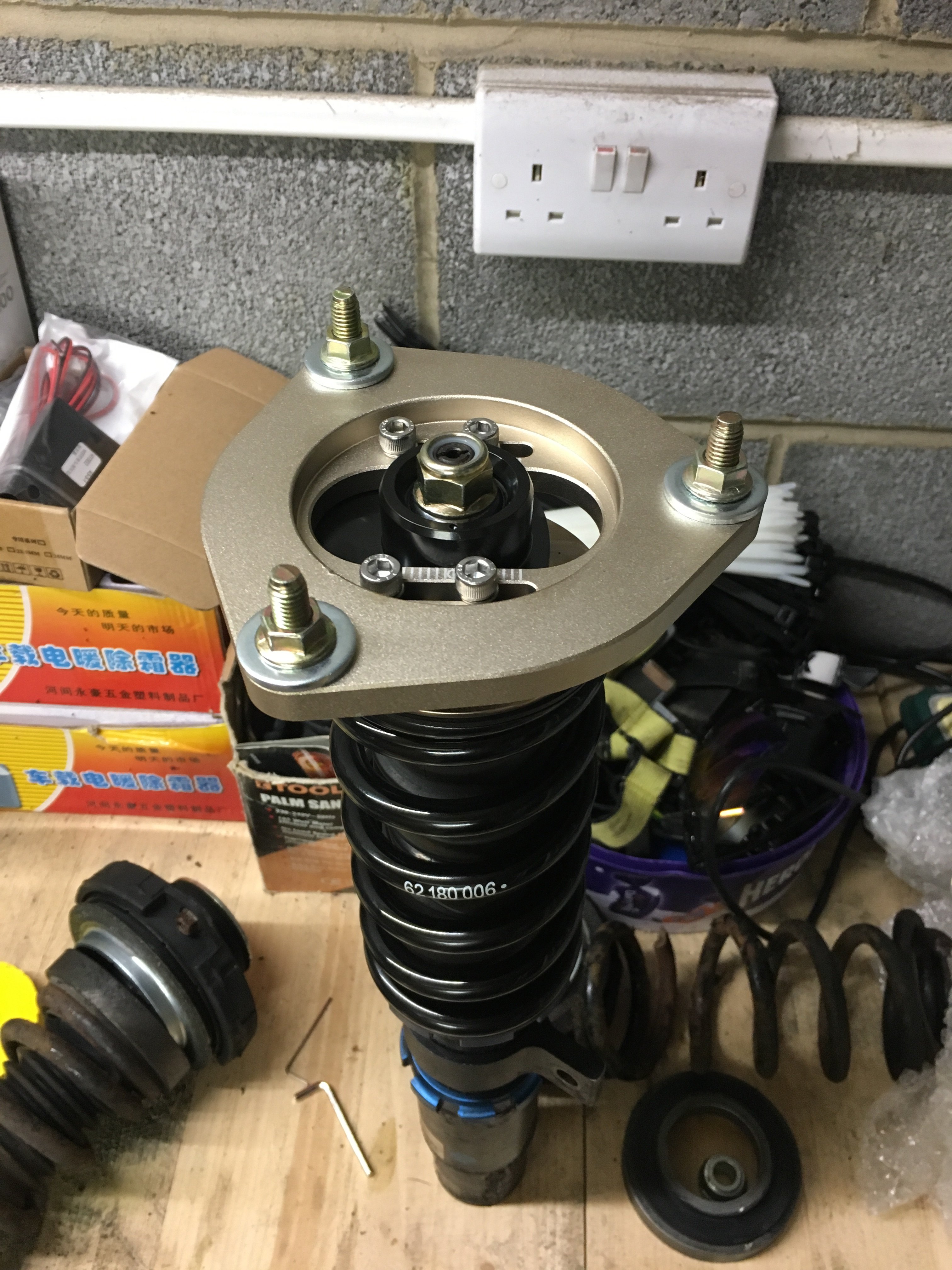

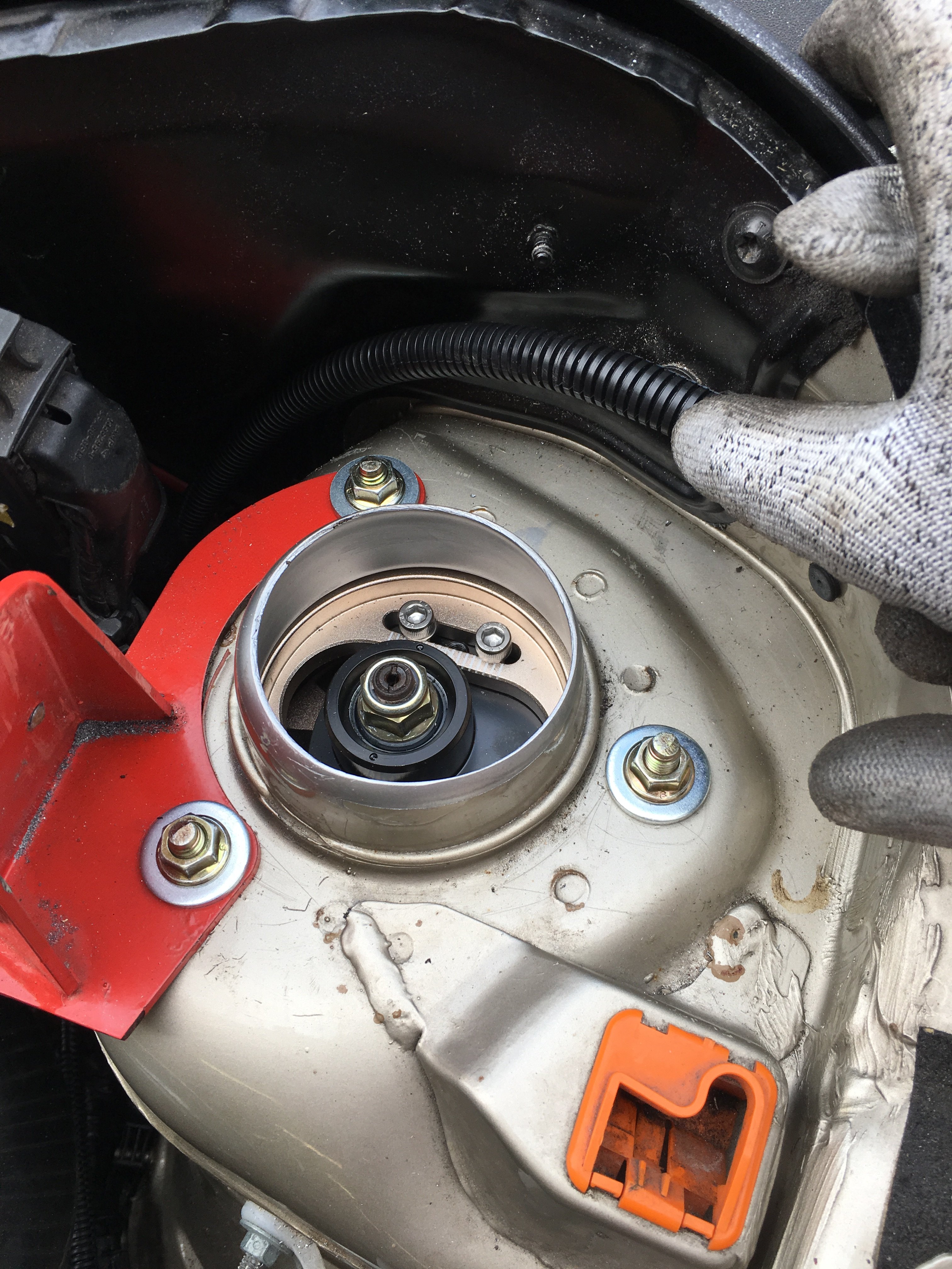

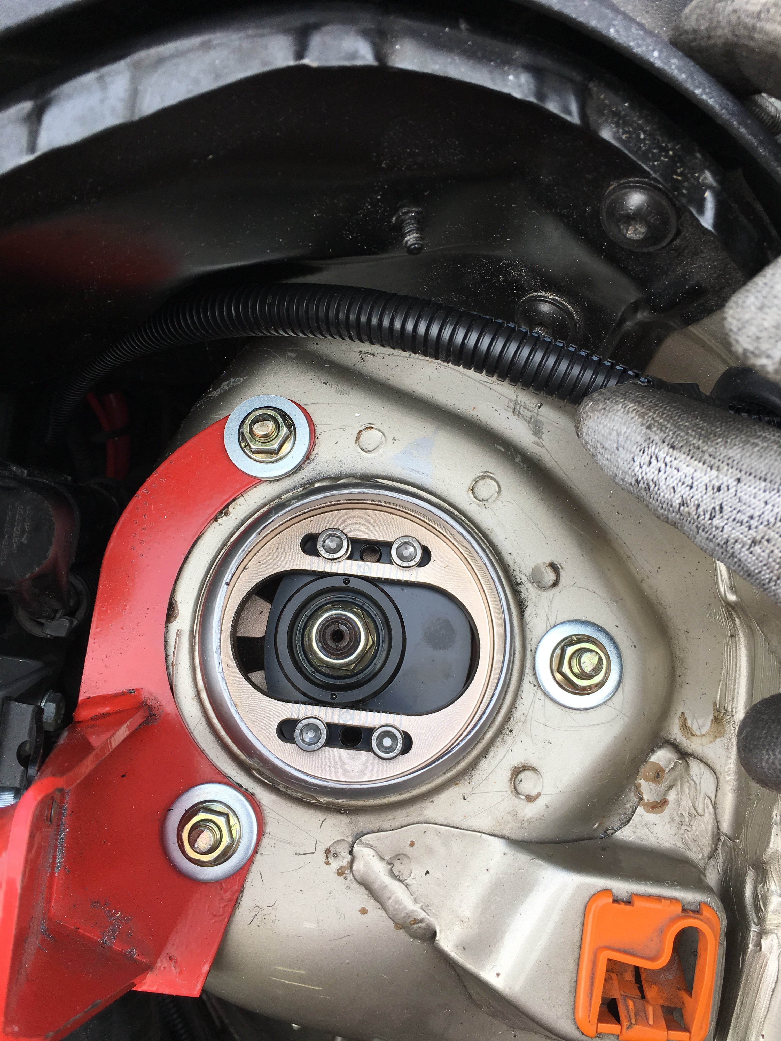

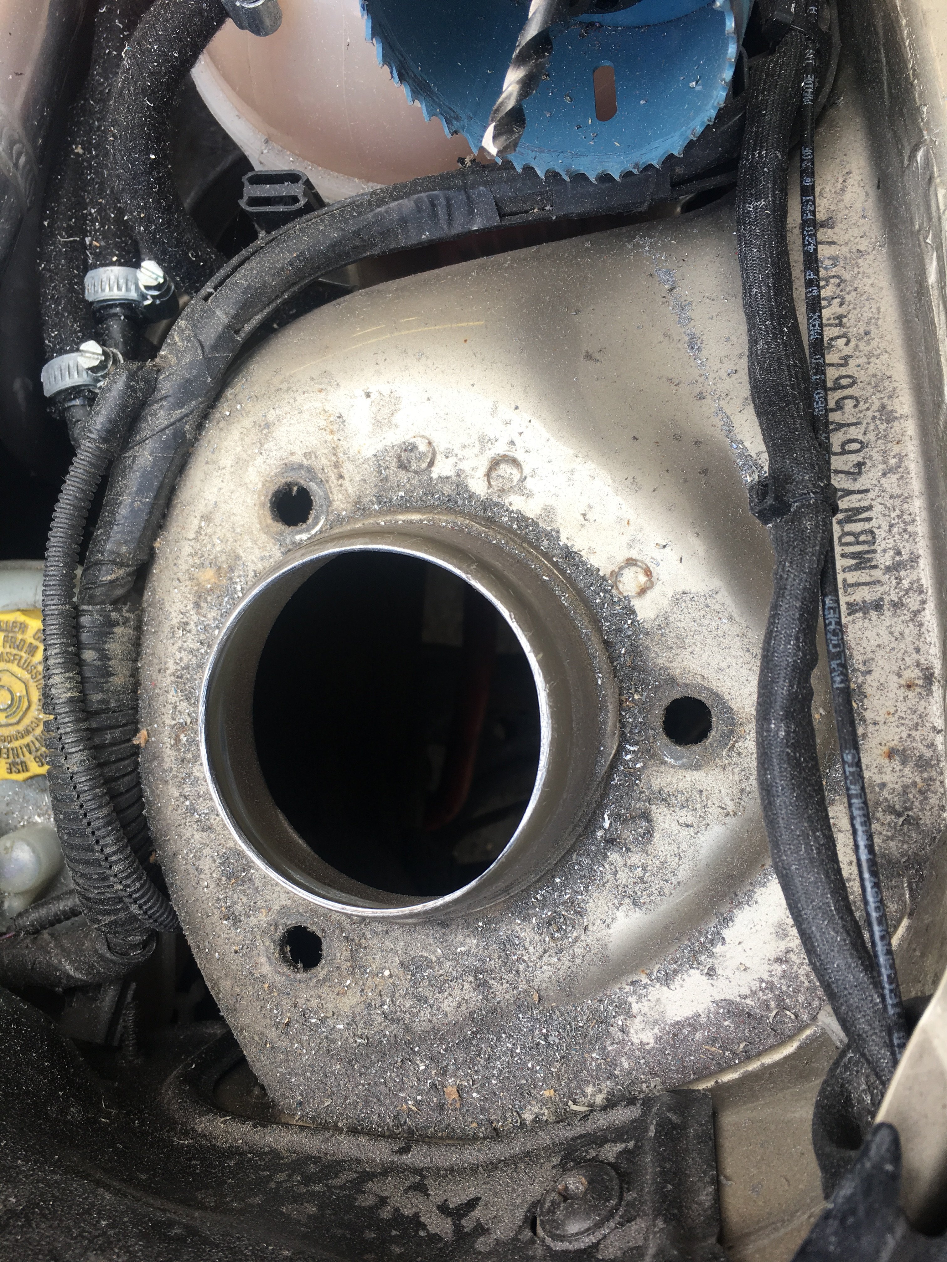

Chopped the strut top up today, so i can adjust the camber easily if required.
Could you not cut the raised "top hat" bit clean off down to the surface where the bolts go through?
Mind you I suppose with a long allen key you can get to the adjusters ok?
Yeah, but wasnt sure how much strength there was in the top hat bit.
if i chopped it off there would only be 10mm at most between bolt holes and the edge.
Yeah I guess it was designed that way for a reason.
Suspension fitted to strut tops now, perfect for adjustment. Had to elongate the three holes a few mm, on the drivers side i caught the freshly fainted strut top with the bloody die grinder :blush:
Suspension back together, just need to fit droplinks. I’ve bought Ford Mondeo/Puma drop links but unsure how to set up the length they need to be.. so ill tackle that tomorrow.

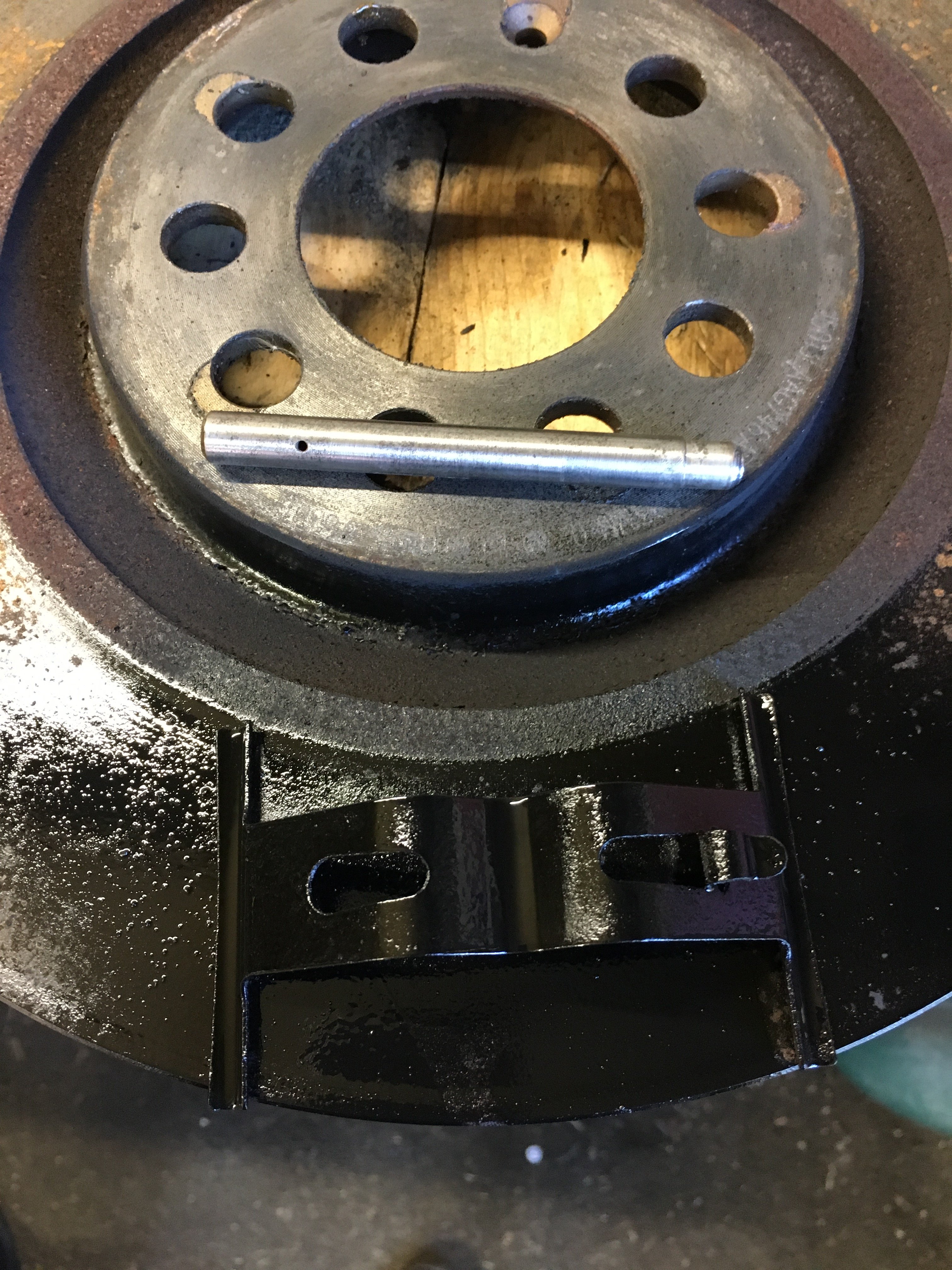

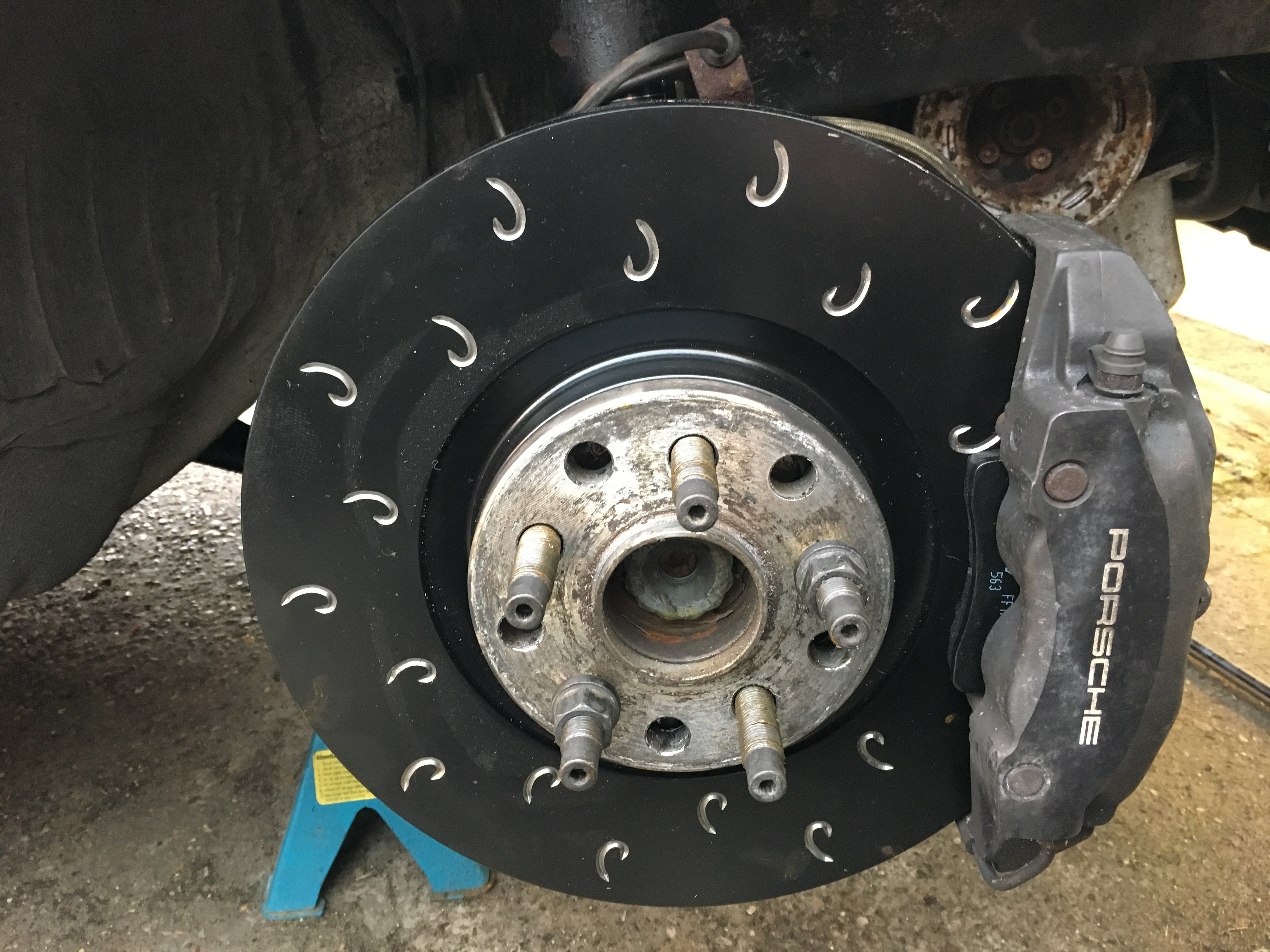

Removed brakes, pistons all free and all in good condition so i’m gonna wait till winter to strip them down. New ‘J’ hook discs to hopefully stop the pad deposit and new DS2500 pads.

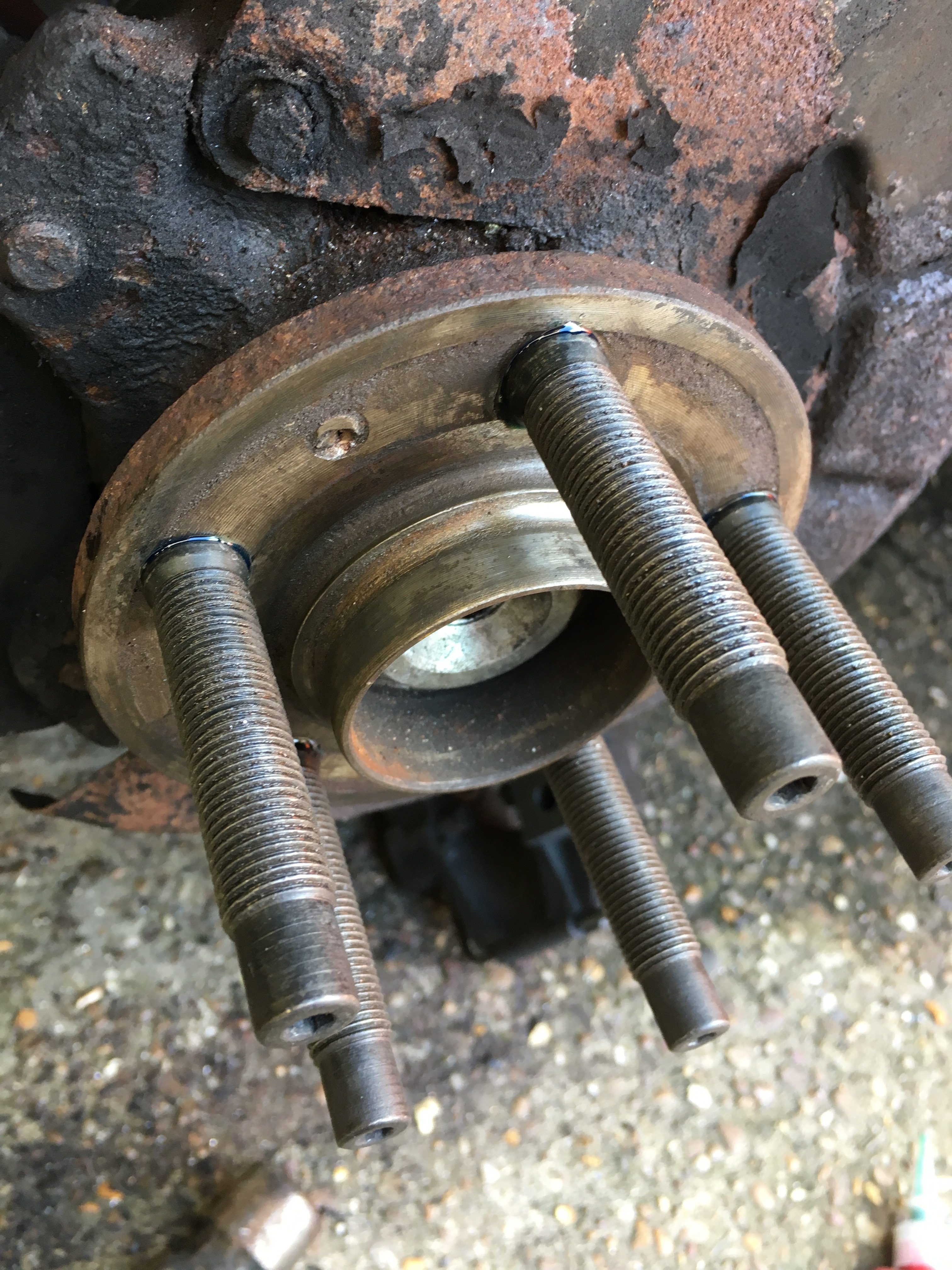

Removed and cleaned up the studs whilst there.
All back together.

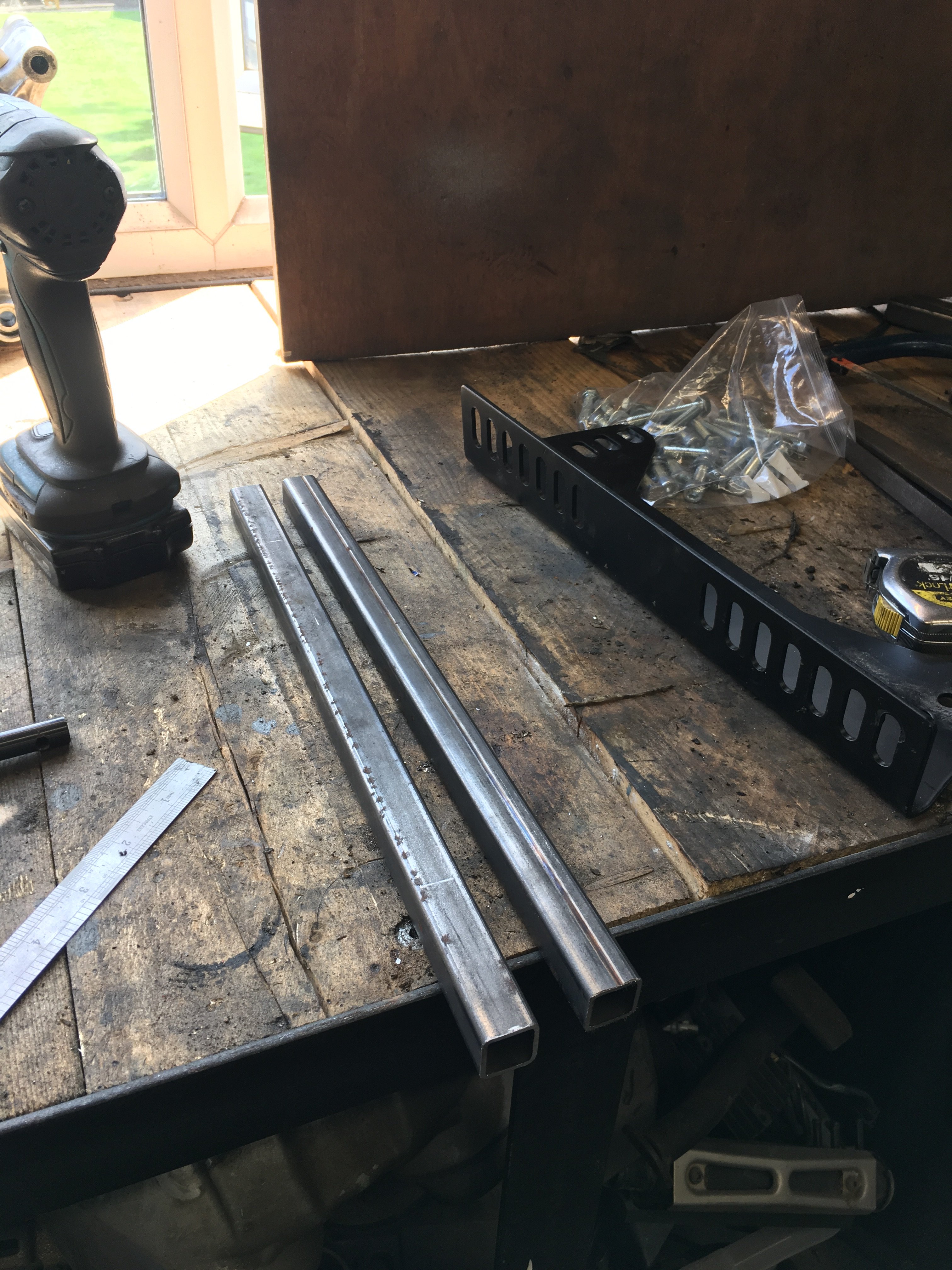

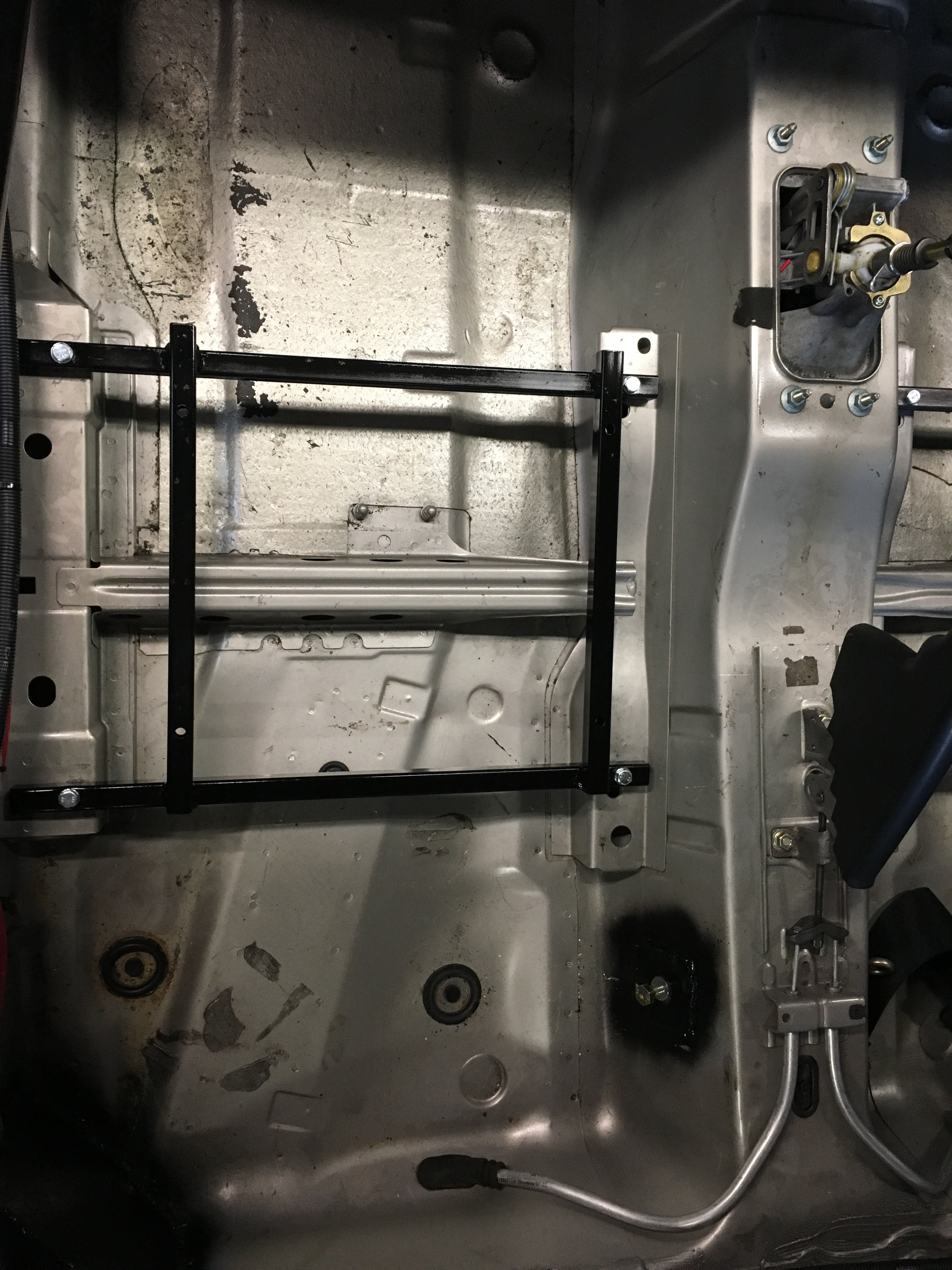

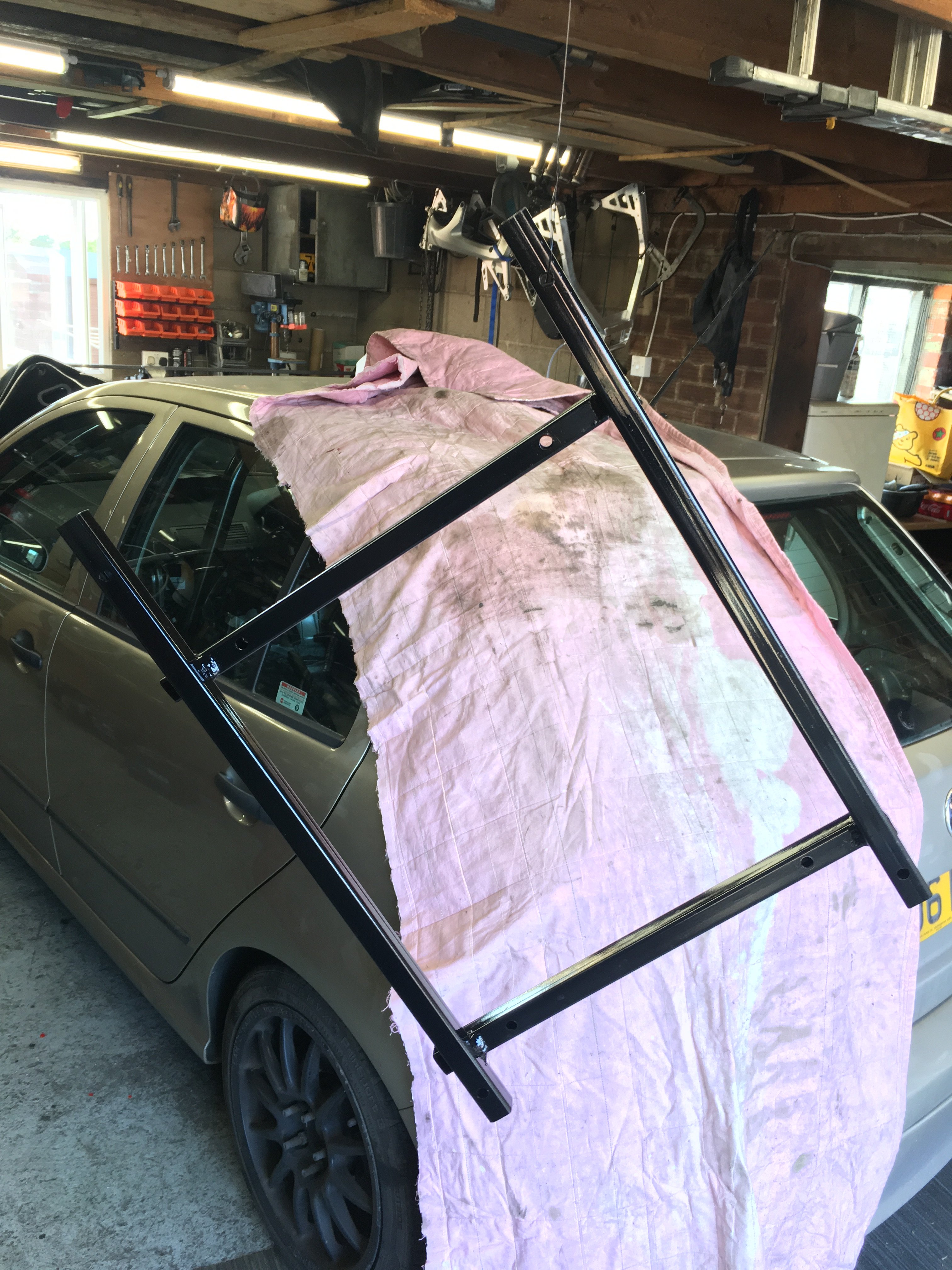

Set about fixing the seats, since i got them they had ali moubts which along with the runners squeeked and moved around alot.
20mm box made up proper mounts.
Ill get better pics once i’ve put the seats back on, waiting for paint to dry.

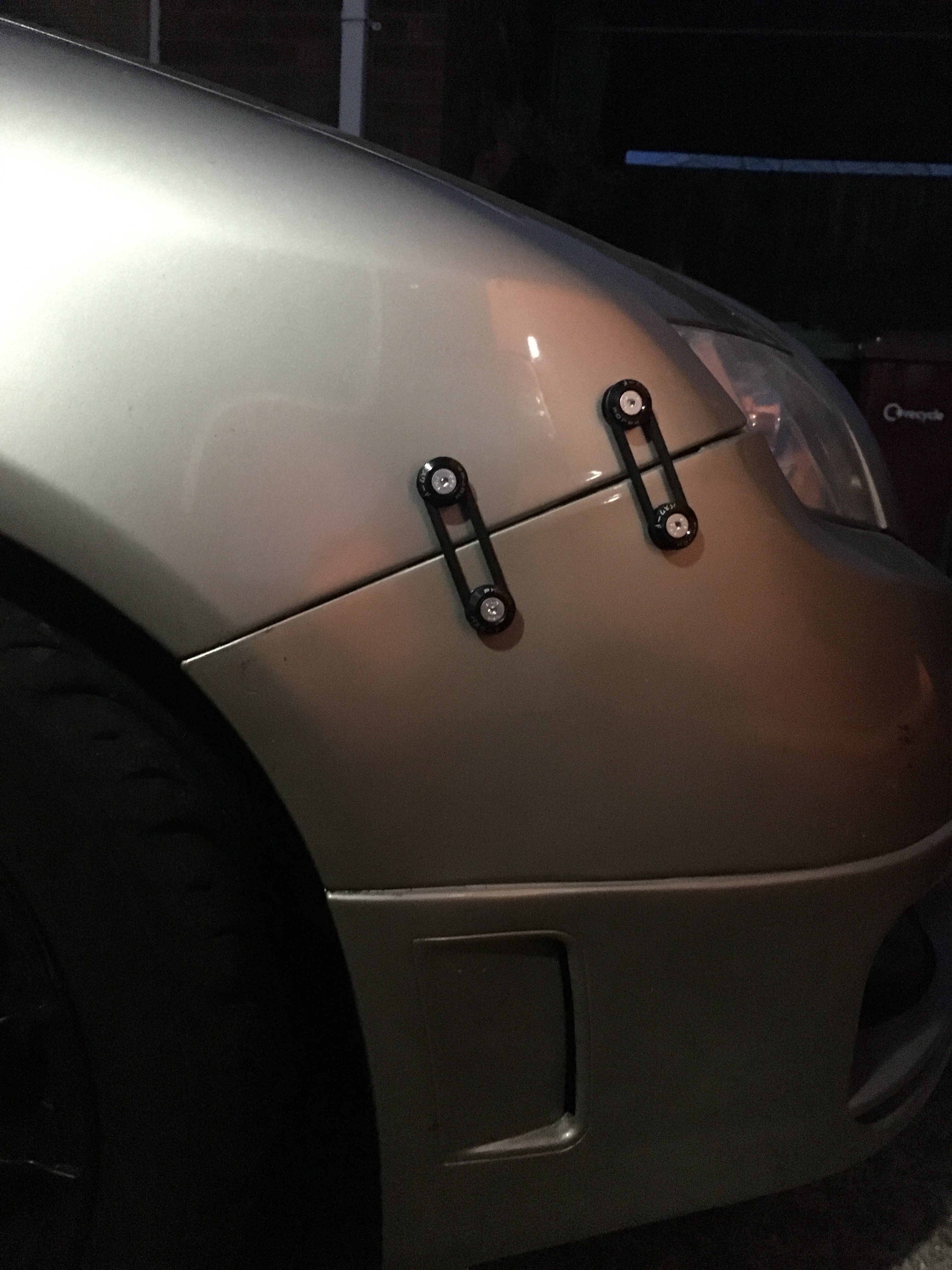

Also added some ugly bumper straps. Bumper keeps falling off, so had to do something :D

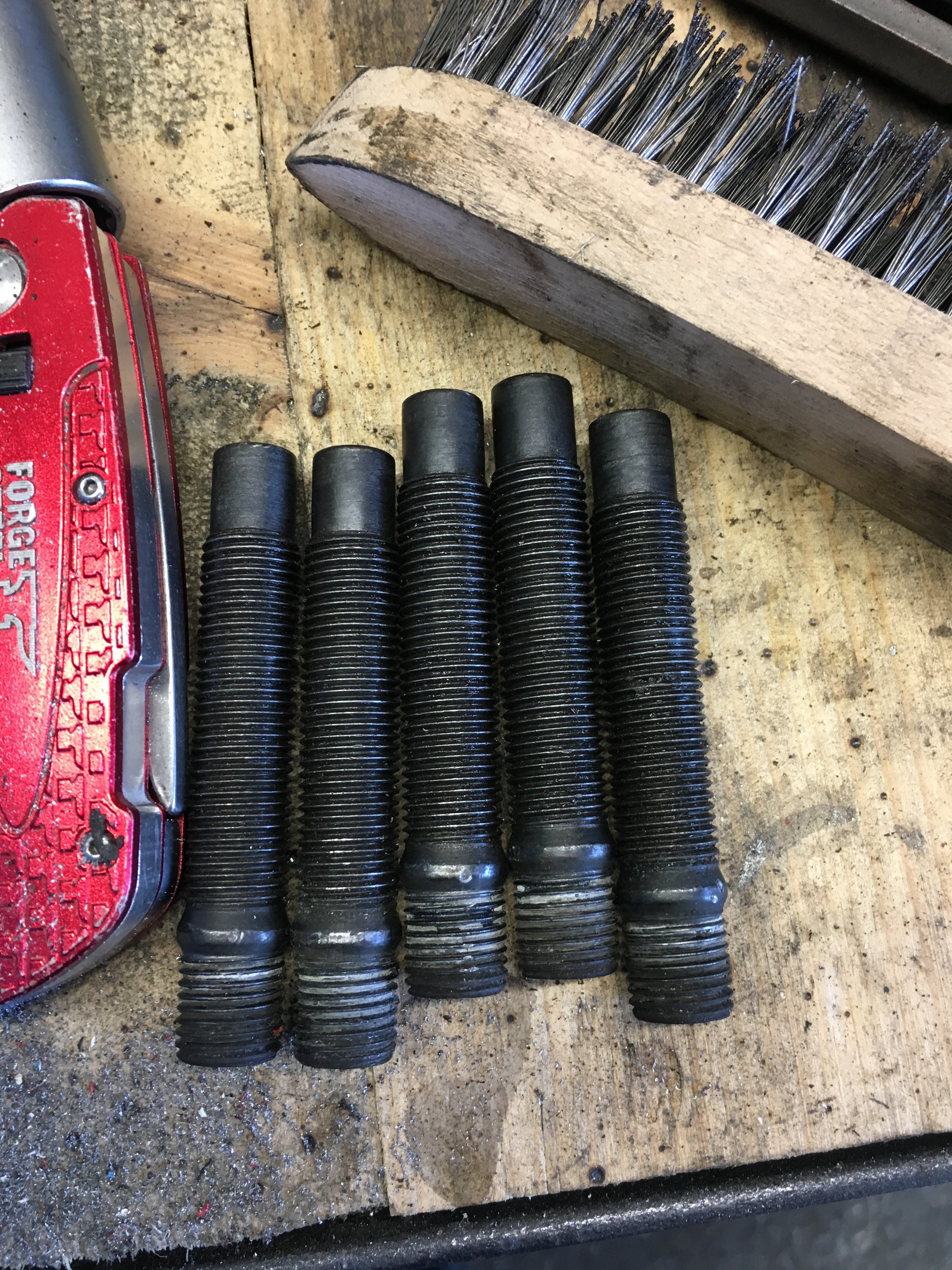

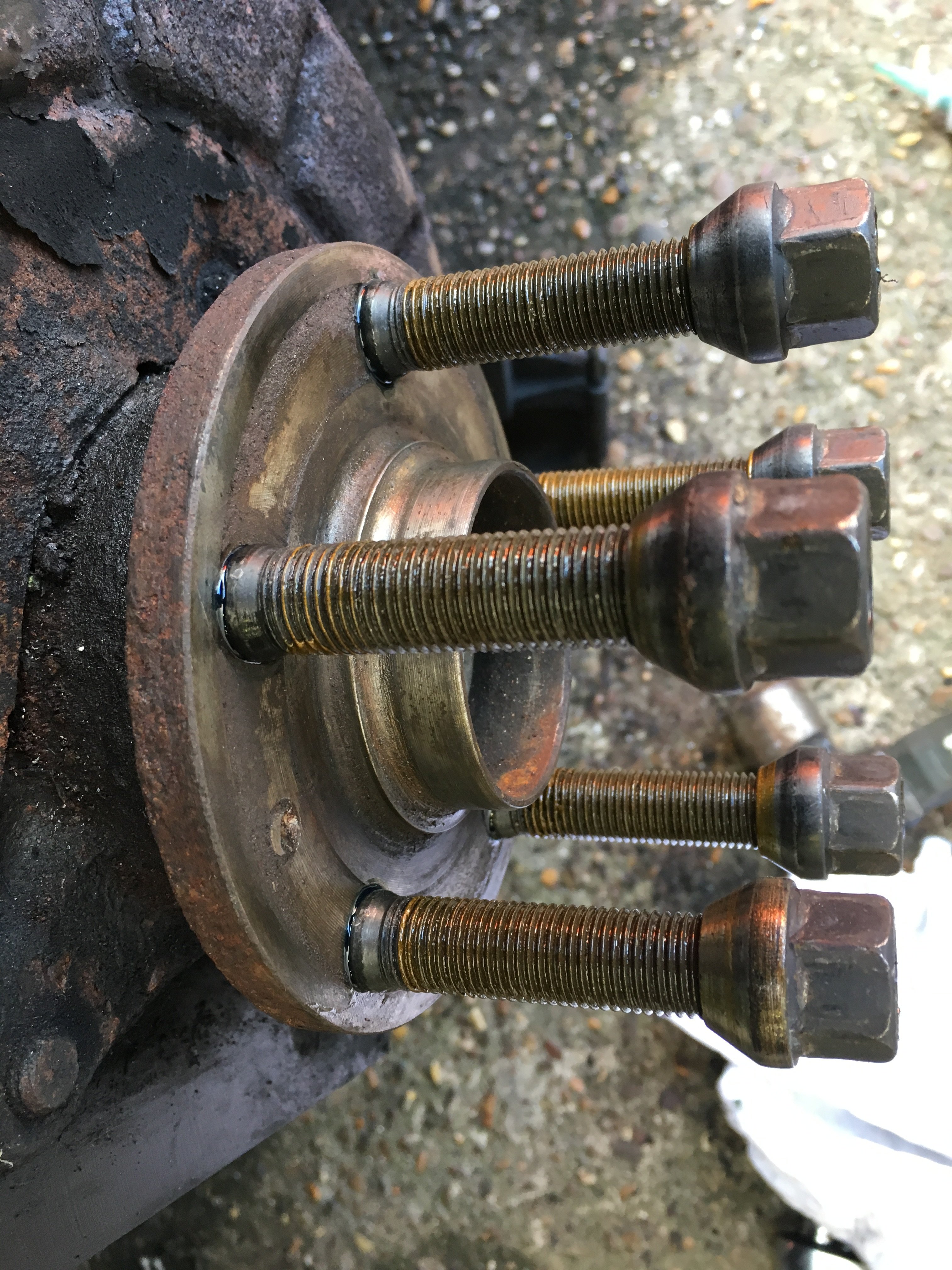

What length studs are you running? Darkside ones i assume?
They were off ebay, not sure really.

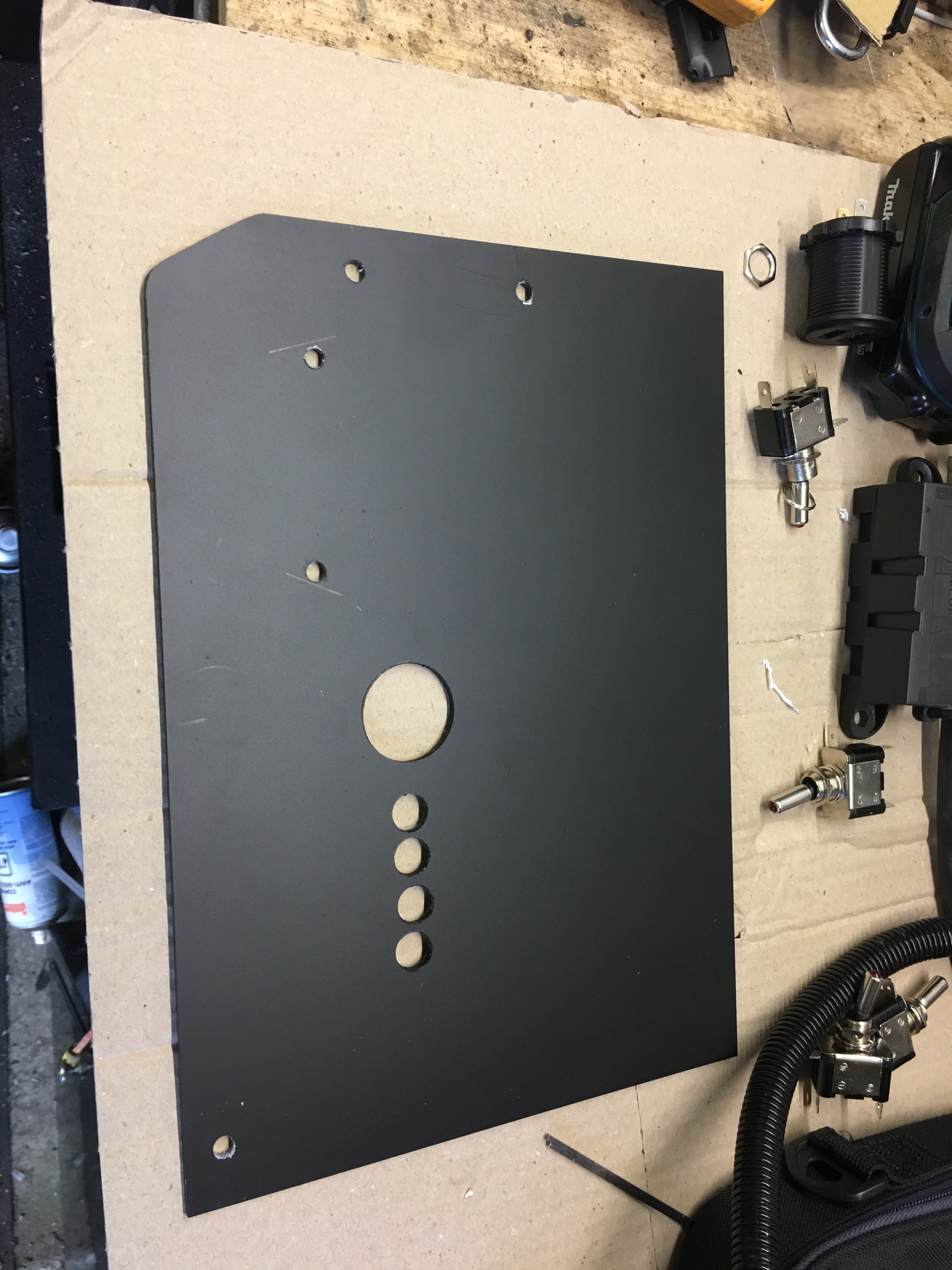

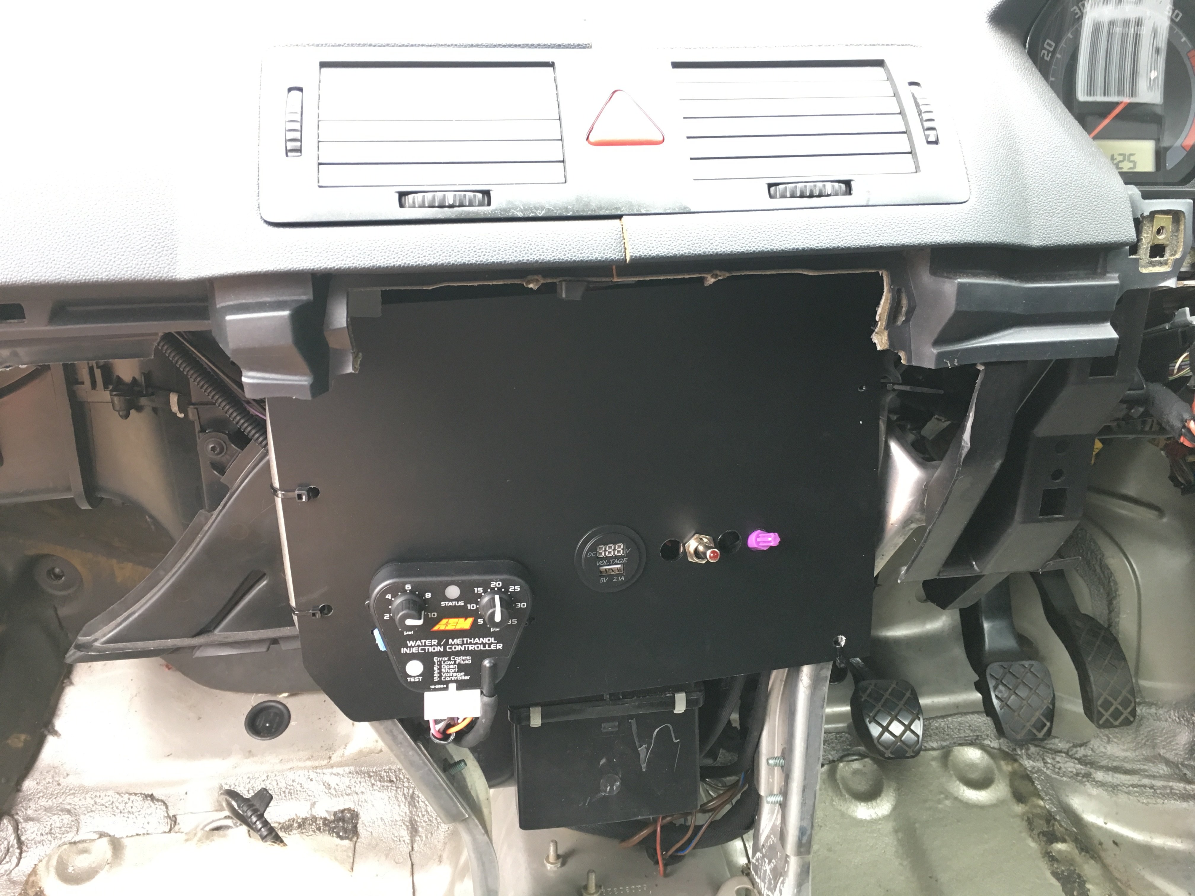

Quickly made up this so i can charge my phone on the way to Germany..
Going to make it properly out of Ali when i re-do the dash.
