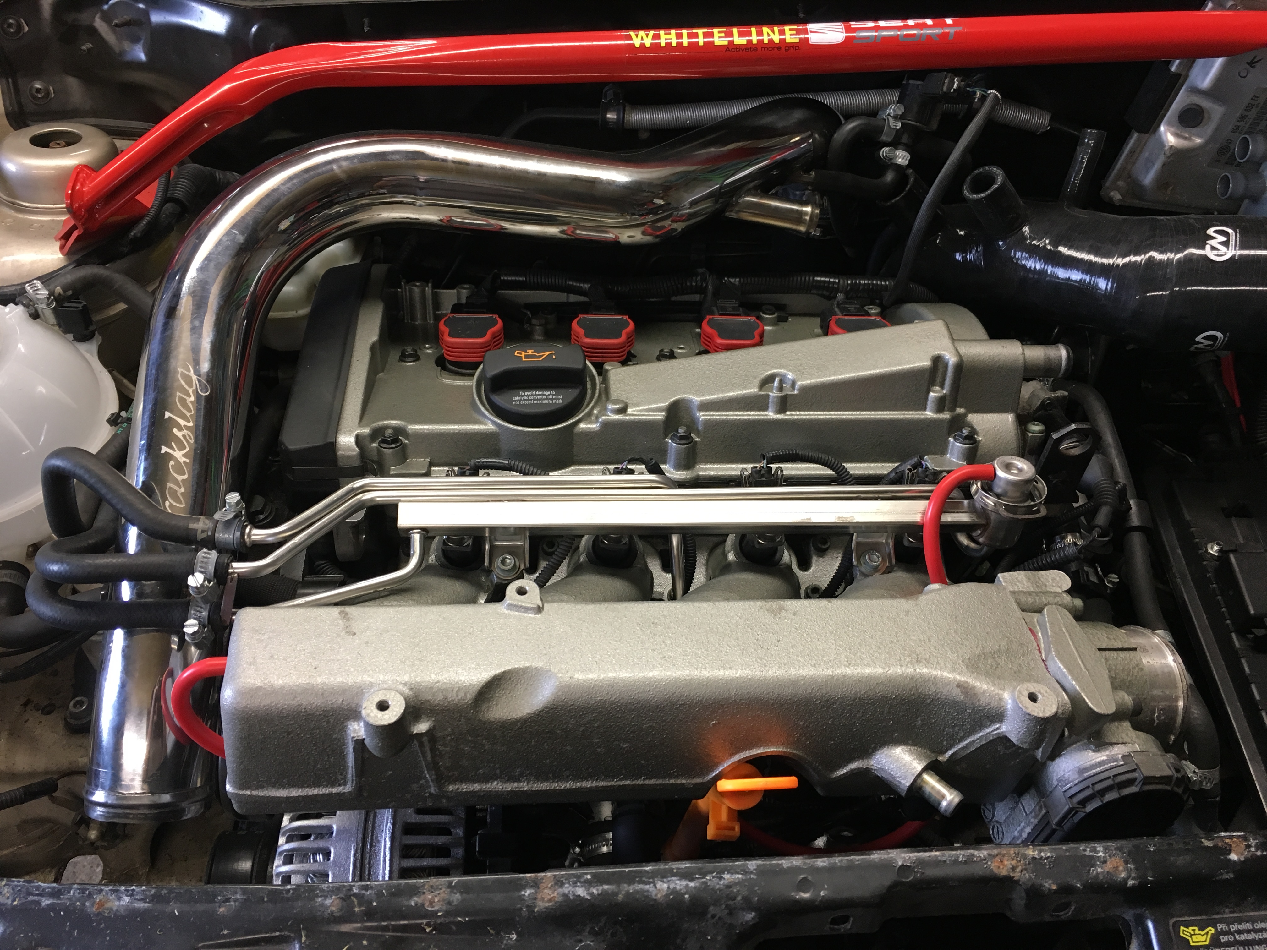

All wiring not put into bay and plugs connected. Injectors and regulator put into fuel rail and connected to the car. Fuel lines and cooling pipe rerouted to suit new charge pipe.

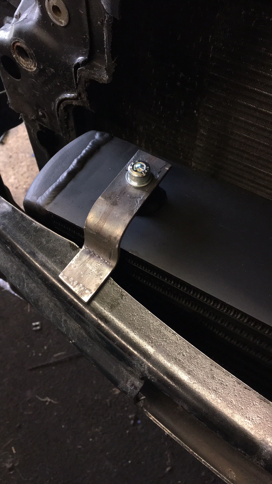

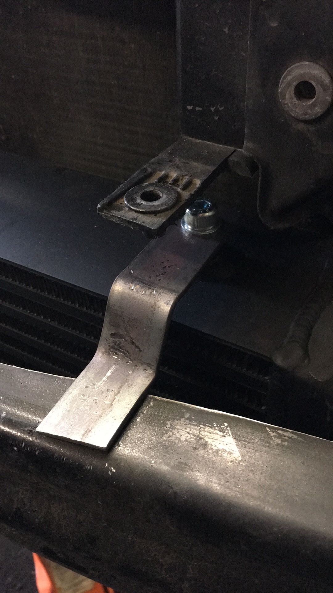

Fitted front end and cut everything away that would get in the way of the intercooler. Didnt secure FMIC as want to weld the tabs onto crash bar to make it secure. Removed all the front end until my oil cooler pipework arrives as it makes it easier.

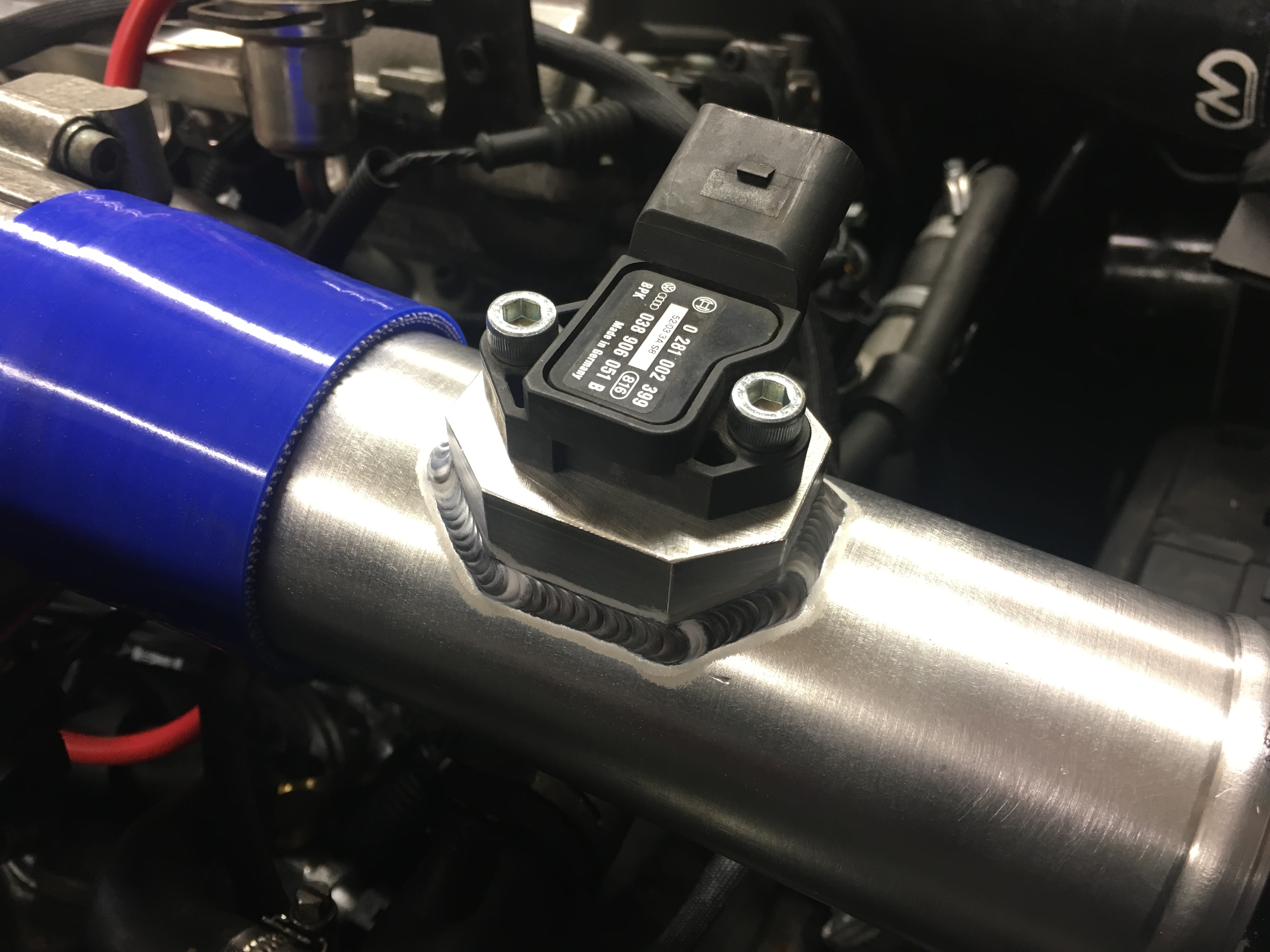

New MAP sensor pipe arrived.
(The blue is just temp until i know what i actually need)
Sweeeeeet.
