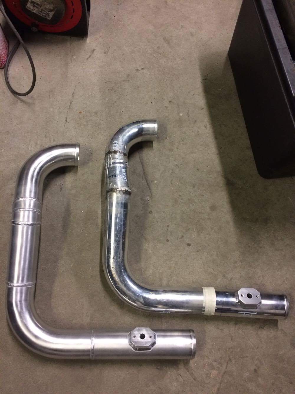

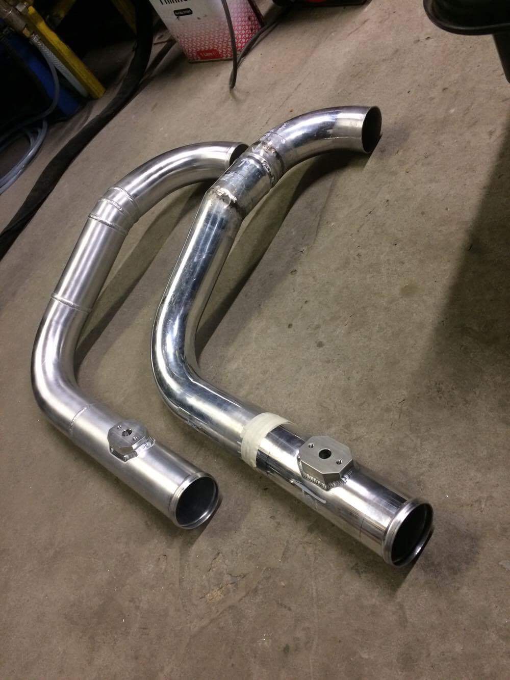

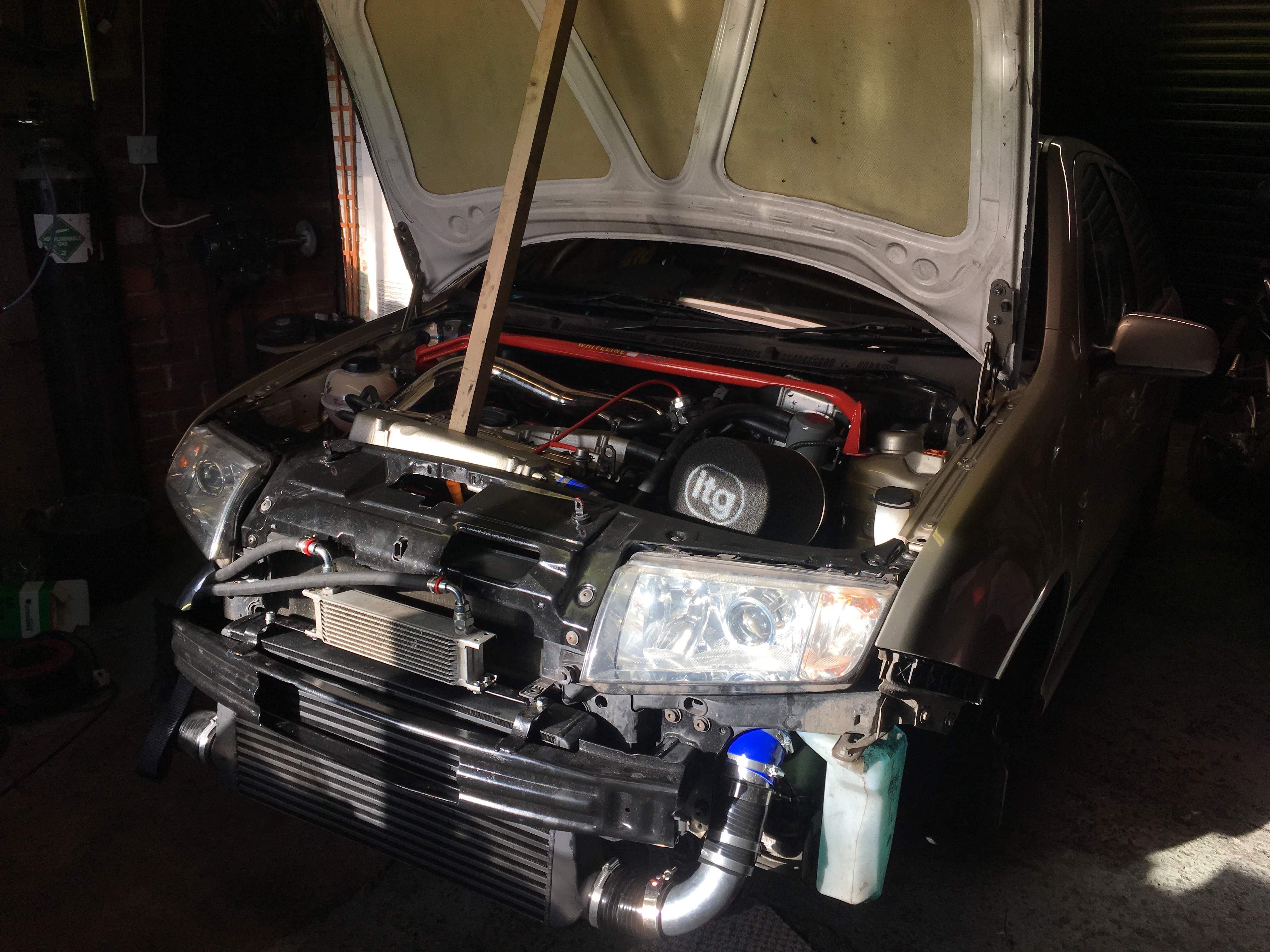

Intercooler pipework is proving to still be a pain, the quality of the 'universal pipework' is **** poor so it can't be welded properly. I've welded it and then leak checked it and its leaking the whole way round where the pipe has got hot. You can't see a hole it just looks permiable, so i've bodged it by fitting a small straight silicone over the joins and no leaks.
Need to finish this off in the morning then it can be ran.

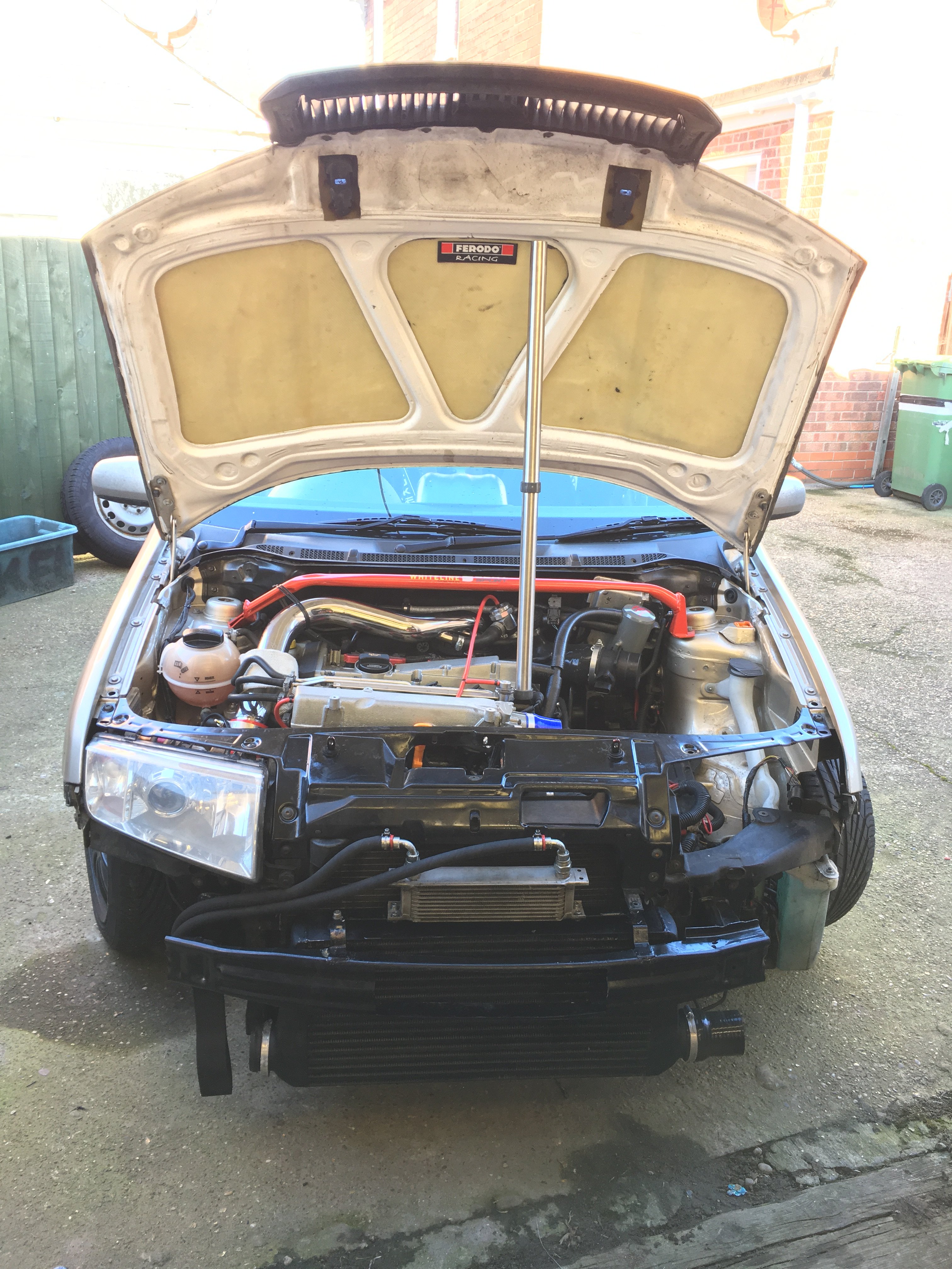

  • Fitted driveshafts and all bolted up. Wheels on and lowered to the floor. All intercooler pipework installed, just front bumper to chop up to fit.   Started it and it runs!!! WHOOOOOOO

Rebuilt it all.. ran upto temp, no leaks.
Jumped in the car to take it for a spin to get it proper hot, pressed the clutch. BANG
Clutch  release bar and release bearing fell apart and lodged the bar in the clutch so it was permantly engaged.
Dropped the box and sorted out bit litrally taken all day.

No updates really as i'm waiting for my boost pipes to be made. Get rid of my bodged attempt :biggrin:
New intercooler pipe against the one i bodged B)
Credit for trying though ;)
