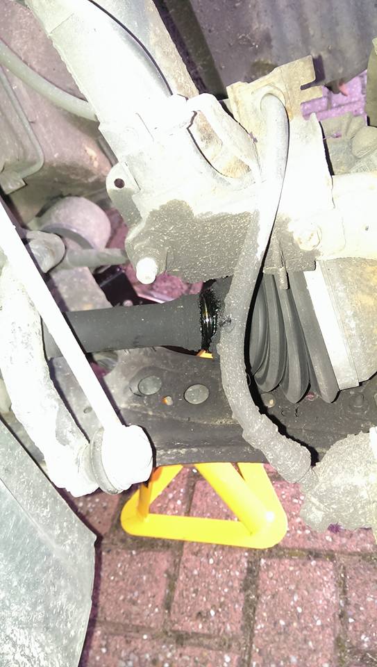

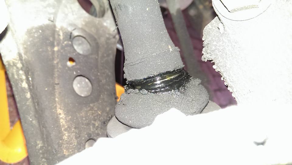

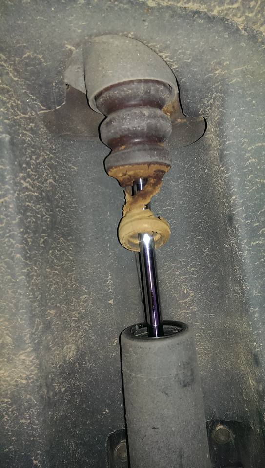

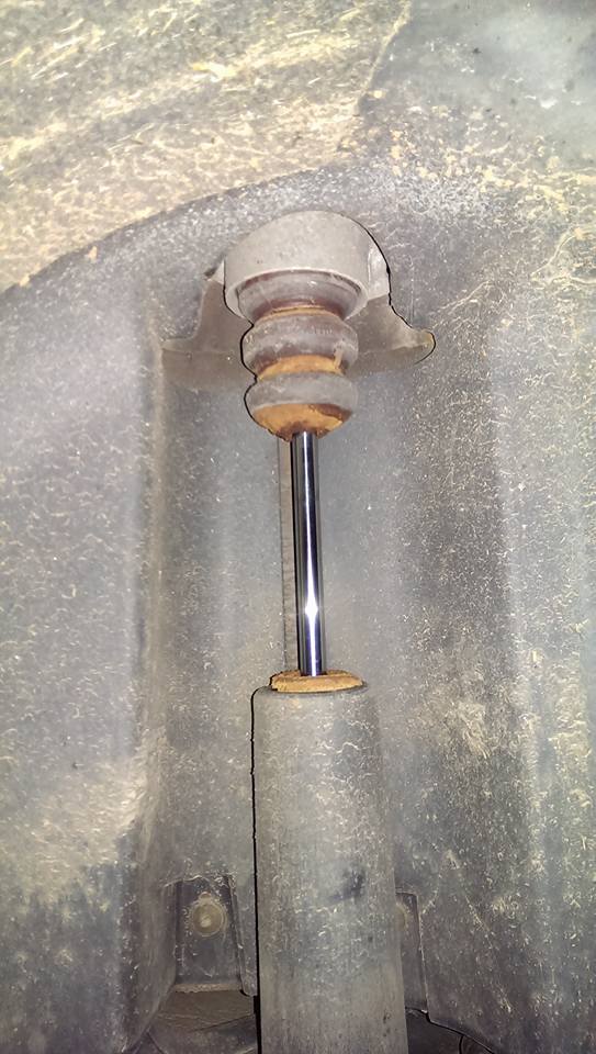

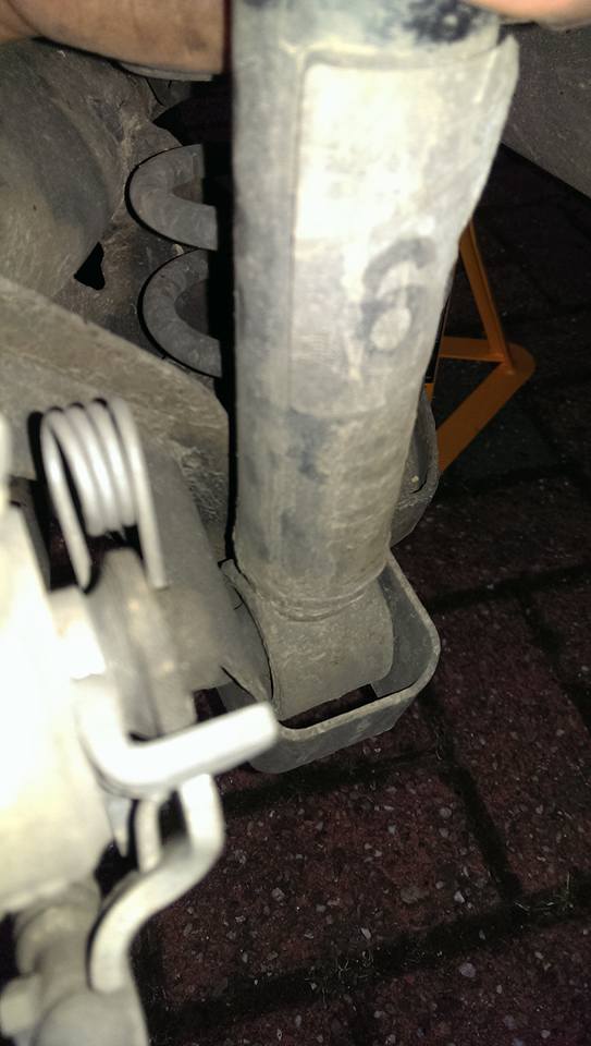

Hi guys looking for a bit of advice from some people with experience, so I get creaking and knocking when going over bumps and a slipping noise when turning while reversing so did a check of all four corners and have these photos of the results..... The only test I did on the bushes was a visual inspection, would this be sufficient or do I need a crowbar? Bit of additional info, when I bounce the suspension on the back it creaks would this be the springs, the look fine from what I can see?!
Any help would be much appreciated.
Oh dear, you really need a crowbar, please don't bother posting a picture of one, I already know what a crowbar looks like. Sad CV boot btw.
Those damper covers can rattle around when the bump stops break allowing them to drop like that. You can buy new bump stops to fit to the covers.

Defo the top rear bump stops are shot & the CV joints on the drive shafts, those are the causes of the noises I recon, both items need changing anyway.
I have some shocks and springs in good condition just come off my 05 plate fabia vrs they've done 75,000 and I had no issues with them, just wanted to lower mine so got full set of lowering springs n shocks. You can take em for £50
I know the CV outer needs doing but would it hurt if the bump stops aren't replaced?
It's a cause of one of the noises, & could be an MOT fail...............
No, it's not necessary, unless you're constantly driving around fully laden on bumpy roads then the rear suspension won't bottom out anyway.
Get that CV done and go from there.
Not if you don't mind the covers rattling around on the dampers.
