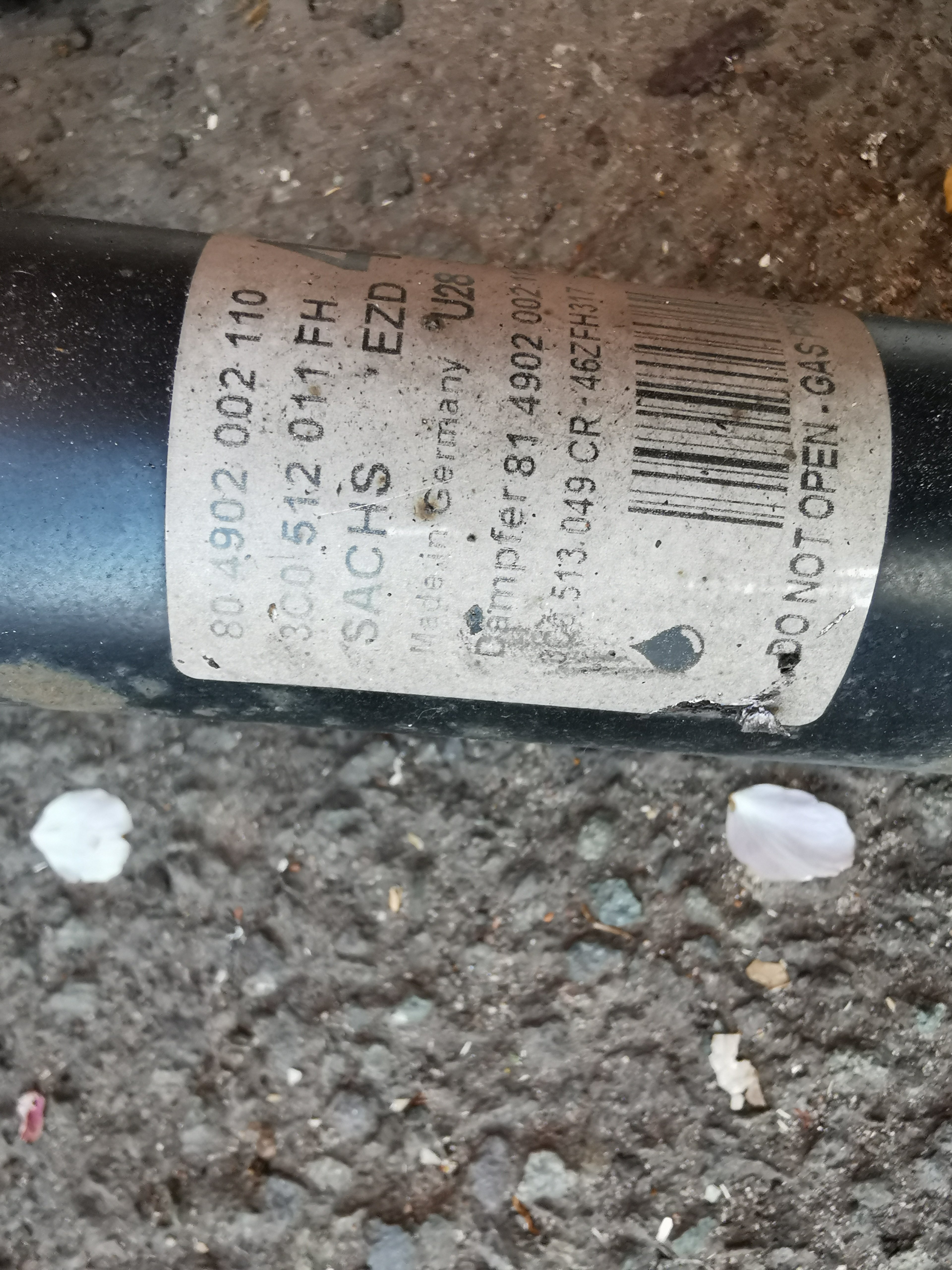

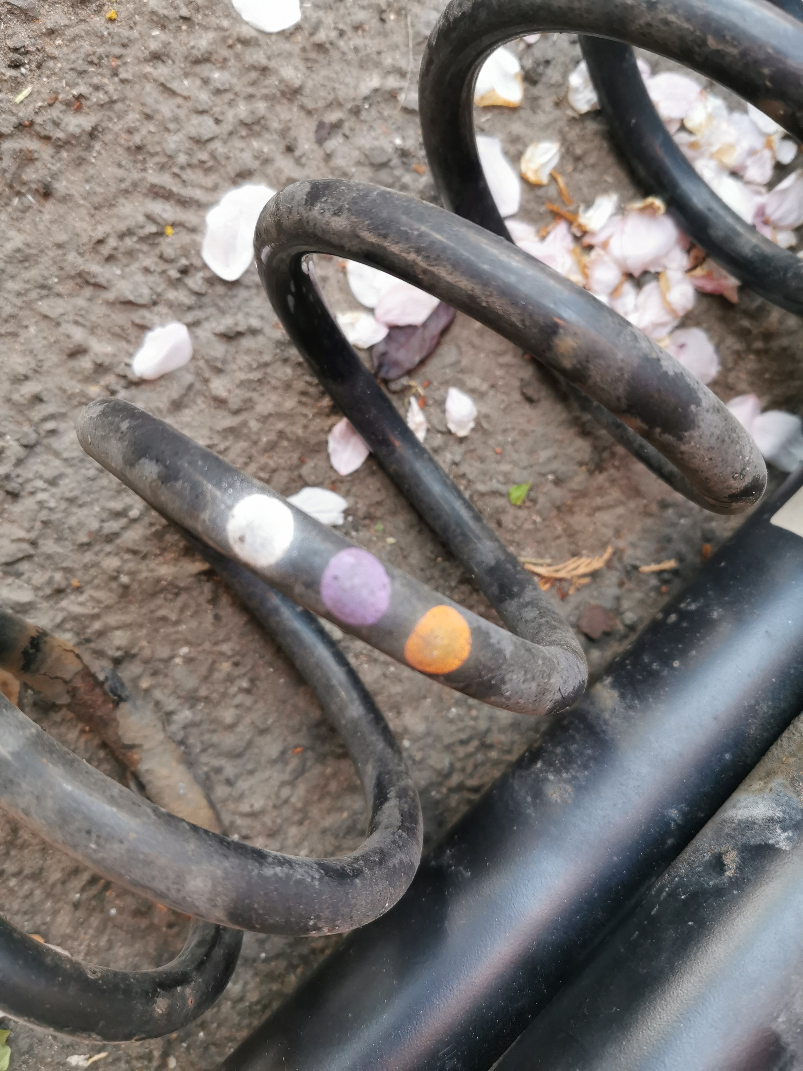

  • To add some info to this.    Just replaced the original rear shocks and springs in my 2013 170 4x4 combi.   Had standard chassis with weight range 7 springs as the pics show.
Replaced with bilstein b3 springs and b4 shocks.
Bilstein b4 number 19-151069
Bilstein b3 number 36-148257
Drives really nicely and sitting at correct ride height.

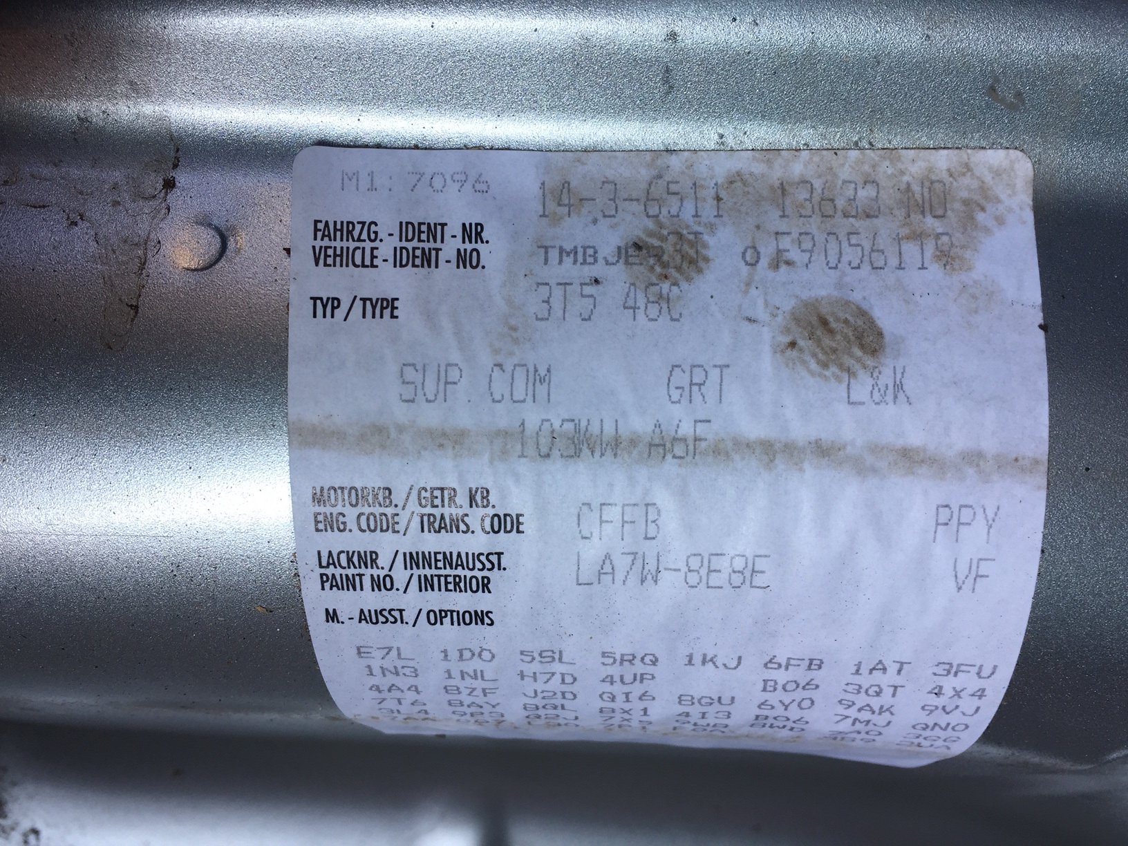

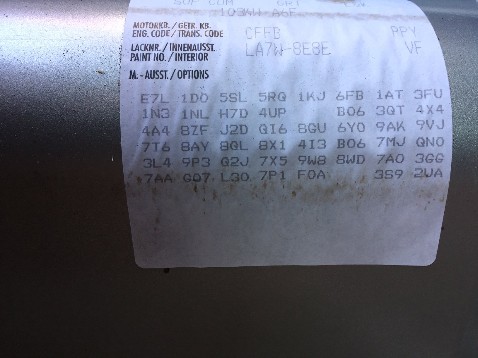

I have  2.0 tdi    II  estate  , see enclosed photos of badge .
 90% of the time driving with 120kg of tools-eq in the luggage (rear) . can you give me some advice of where to go for a better solution than the standard ?
I might be reading wrong , but I find no 1J.. Or OY.. ?
I am more of a fast comfort driver . so i want to be more near standard ride height .

Most of the suspension related codes are not printed on the option label, only the one for front damping. In your case this is G07 which means it's standard chassis. If you sign up to erWin you can pay to get the full list of PR codes for your car, or a friendly dealer might tell you what's fitted. Another thing you can do is jack up the car and see what paint marks are on the rear springs - they can be cross-referenced with the table I attached to the OP.

The code L30 means that you have front springs with OEM part number 1K0411105BP
You can confirm this if the front springs are marked with 2 orange dots and 1 white dot, or 1 red dot, 1 white dot, and 1 red dot.
http://www.oemepc.com/skoda/part_single/catalog/sk/markt/CZ/modell/SUP/year/2014/drive_standart/768/hg_ug/411/subcategory/411001/part_id/2561497/lang/e
Your rear springs may have OEM part number 1K0511115DE
You can confirm this if the rear springs are marked with 1 white dot, 3 orange dots, and 1 brown dot. Code 0YE would also confirm that your car has these rear springs.
http://www.oemepc.com/skoda/part_single/catalog/sk/markt/CZ/modell/SUP/year/2014/drive_standart/768/hg_ug/511/subcategory/511000/part_id/2561497/lang/e
