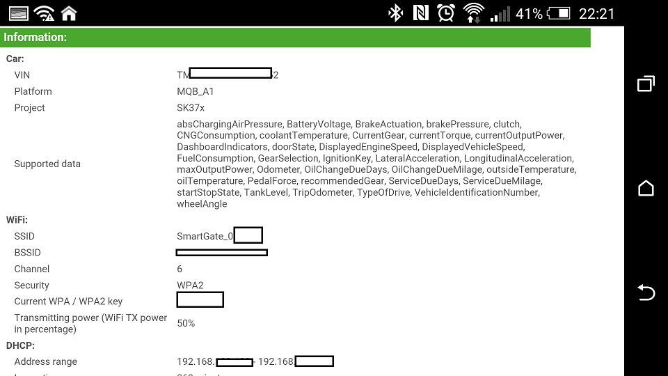

What software version do you have?
(You can find this by connecting your phone to your car's smartgate, standard wifi is fine, and navigating to 192.168.123.1 in your phone's browser.)

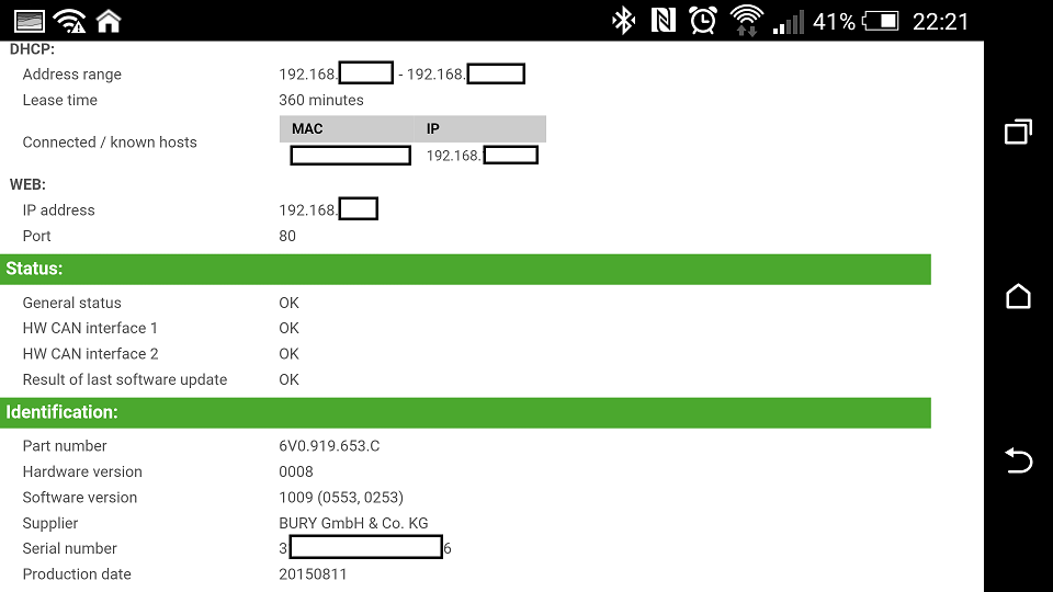

Hi again:
Hardware Version:0008
Software Version: 1009 (0553,0253)
The Partnumber is the same as yours (I think it's the same Box in all VAG vehicles).
I can't find the ota file anywhere on the internet. Even the Skoda customer hotline couldn't tell me where to get it. The only advise i got was to get in touch with my dealer.
