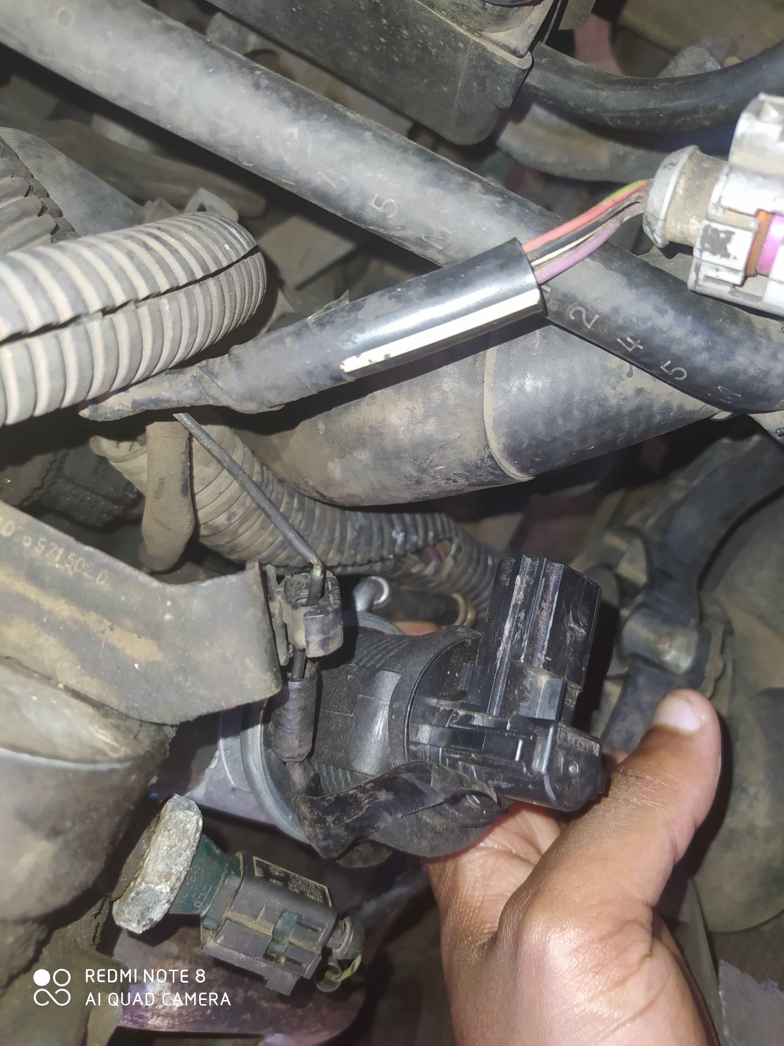

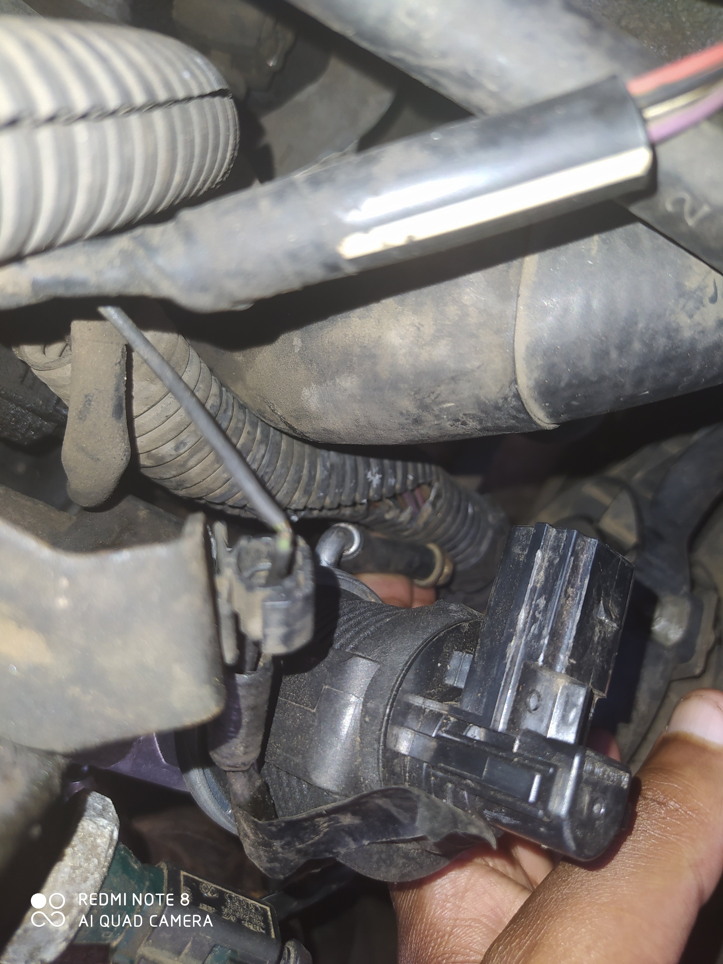

Hi Guys.  I would like to know where the vacuum pipe from the EGR connects to.  My vehicle has displays EPC.  I have changed everything. MAP sensor,EGR valve, Coils. Still without solving my EPC problem.  I have taken it to different mechanics to solve the problem and even went to the dealer to no avail.
I have the following error code
Barometric / manifold pressure signal
    p1553 35-10 - Implausible Correlation - intermittent
Intake Air system
   p1504 - 35-00 - leak detected
readiness : 1010 0101
I have noticed that the pipe from the EGR is cut short and a bolt put inside to cover the air from entering I figure.  It is not connected anywhere.
Your help is greatly appreciated
I'm guessing you have a petrol engine of some sort, we need to know what sort.
The vacuum pipe is not a vacuum pipe, just an air pipe which usually goes to the filter box or simply vents to atmosphere.
You need to repair the EGR system with new pipework and get it working or you'll never get rid of that EPC light.
Are you sure that it is a bolt that someone stuffed up that small air pipe end, or is it what it should be a plastic rough and ready filter to stop any major nasties getting drawn up that small pipe.  If a bolt has been stuffed in the end of that pipe, that EGR might now have problems as a theory was that that small pipe was to allow some air to pass through the body and so slightly cool the EGR assembly.
Back to basics, checked that the pipe from the EGR valve "output" - or at least where that pipe goes at the Throttle Body, has a clear air way into the manifold and is not choked.
Remove the MAP sensor and carefully spray clean it and refit.
It's is a petrol engine. Here are pictures of the eye and the pipe I am concerned about.
So I must change the EGR pipe system not the only the EGR itself?
Yes that pipe is supposed to vent to the atmosphere, not vacuum. Remove the bolt blocking it. Reconnect the EGR valve and disconnect the battery for a few minutes to clear the ECU.
Thank yo very much, I will do that.  You have been very helpful.
