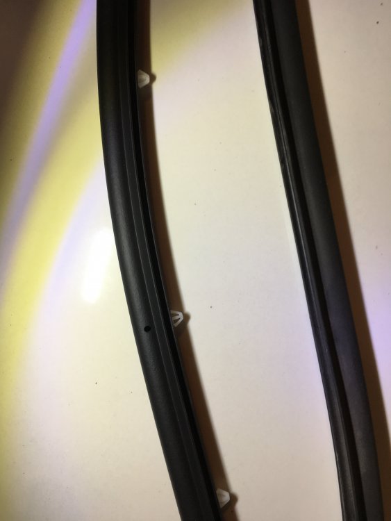

  • Looking at mine Original seals: no holes on outside of seal ---*---*--- ----------- Modified seals: the holes front and back line up ---*---*--- ---*---*--- New seals: the holes are offset. Tha
  • See x3 files attached 1 Outside of car showing the water run off 2 Outside of seal, note the holes are located near to the bottom of the seal (@ approx 5 O'Clock) 3 Inside of seal, note the holes a

Maybe someone with the modified door seal could post a photo of the area around the drain hole ?
I had the 'fix' applied to mine when it was quite new, there is another thread about this from a couple of years ago. Basically, the dealer cut a bit of the seal away near the drain hole, it did help a bit but mine still collects water when parked facing down slope, and it's gradually getting worse again. Some say it's normal and will not affect the car, but mine did leak water into the inside once when it was parked up for a couple of weeks in poor weather. Got fed up of worrying about stuff like this ages ago so just living with it as not intending to keep mine long term so any potential rust issues will not affect me.
