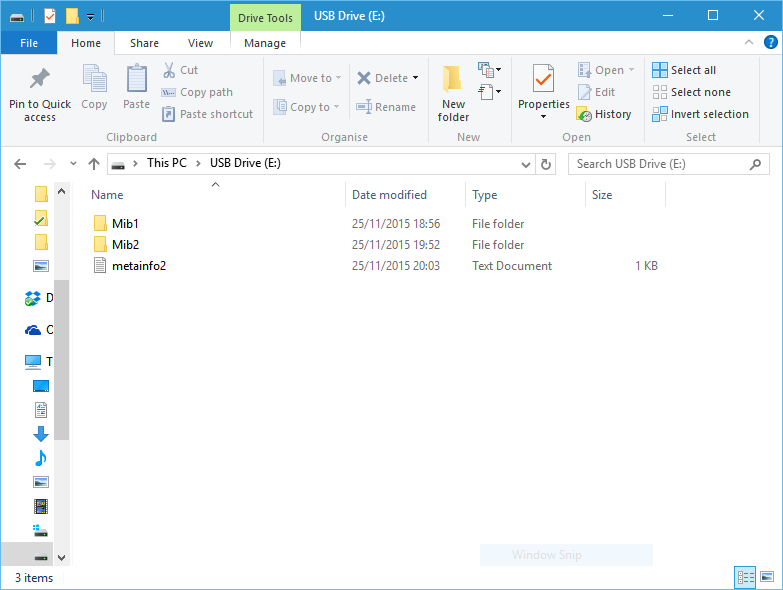

If it says 'No data found' then the card isn't correct.
You should have a folder structure like this on the SD card

I have still problems to get my Columbus to recon-nice the update. I have re-format the SD-card, tried from SD slot 1 and 2, but with no luck.
When I look into the "metainfo2.txt" file  in the Mib1 folder, it seems that the data is for an Audi.

Nothing wrong with the files. Are you doing this on a PC or a Mac?

Is there anything else on the card?
VIN lookup says No update available
No other data on the card. I format (FAT32) the card and copies data (Mib1 + Mib2 + metainfo2.txt) to the card.
In which case you are not eligible for an update ..........
