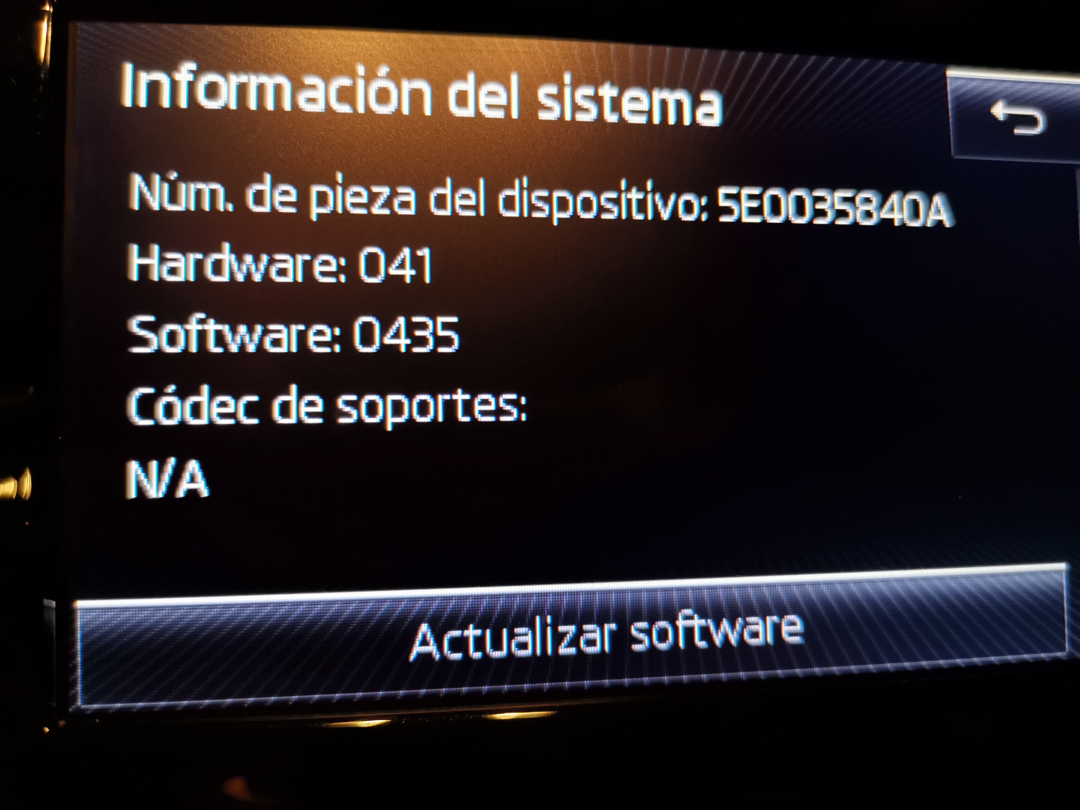

Currently trying to upgrade our amundsen with the new maps.
This is my current firmware version.
IMG_08022020_160434_(1080_x_810_pixel).thumb.jpg.aa3655939c0e6494dba2140f496ff6a2.jpg
Before I start do I need the latest software version?
Edited by caprixpack
No, you don't need to update the software to use the latest 2020 maps.

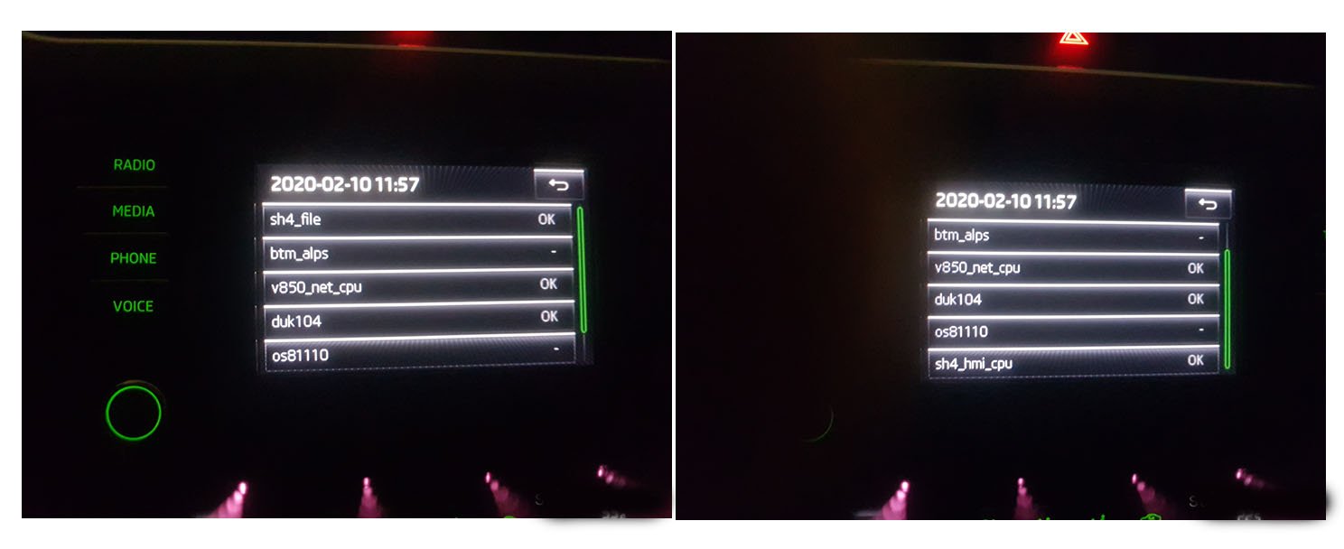

I updated the other day and everything still working. Just want to share my experience. First of all thank you guys for the firmware. I created a USB Toshiba 3.0 16GB formatted to FAT 32 and copy the folders and the meta file to the root of the USB drive.  The instructions say to do it with the engine turned off and the lights but, just for the sake of trying and as well to make sure the battery doesn't run flat during the update, I decided to do it with the engine running.
I turned off the lights, disable the auto start/stop and A/C, eject any SD cards I had inserted in the unit from the glove-box. Insert the USB and keep pressed the menu button about 10 sec until you get to the service menu, then click update, the unit will look for the update, once it found the update, came with a list of what will update and what will skip (I guess because they already updated), I didn't change anything at this point and click update.
Everything started fine, the first step is to download the files in steps from the USB to the internal memory, before updating, very clever, this way it minimise the risk of bricking the unit.
At download 2 of 14 it gave me an error message, I kinda panic a bit, although I new that at this point nothing was updated because it was just uploading the files from the stick, but still. I pressed retry, the unit rebooted and tried again download 3, took a bit longer but yet gave me the same error message, I clicked again retry ... and so on 4 times. The forth time the download was successful. Then just follow the steps.
The unit will reboot several times, and some of the time the screen will stay black for longer time, don't panic, don't try to stop it, just stay calm, it will finish.  When you get the radio o GPS or whatever you had before the update then its done.
The update its very clever, and I'll say very safe. It first uploads the files in a sequence to its internal memory then you will get a shadow copy screen (This is the danger zone), this is when it erase the eprom and copy the new files. Even if for whatever reason it fail and you cant turn on the unit, I see it has some sort of emergency  OS, that I guess is some sort of safe mode to try to restore the unit. The emergency OS is the last thing the unit will update.

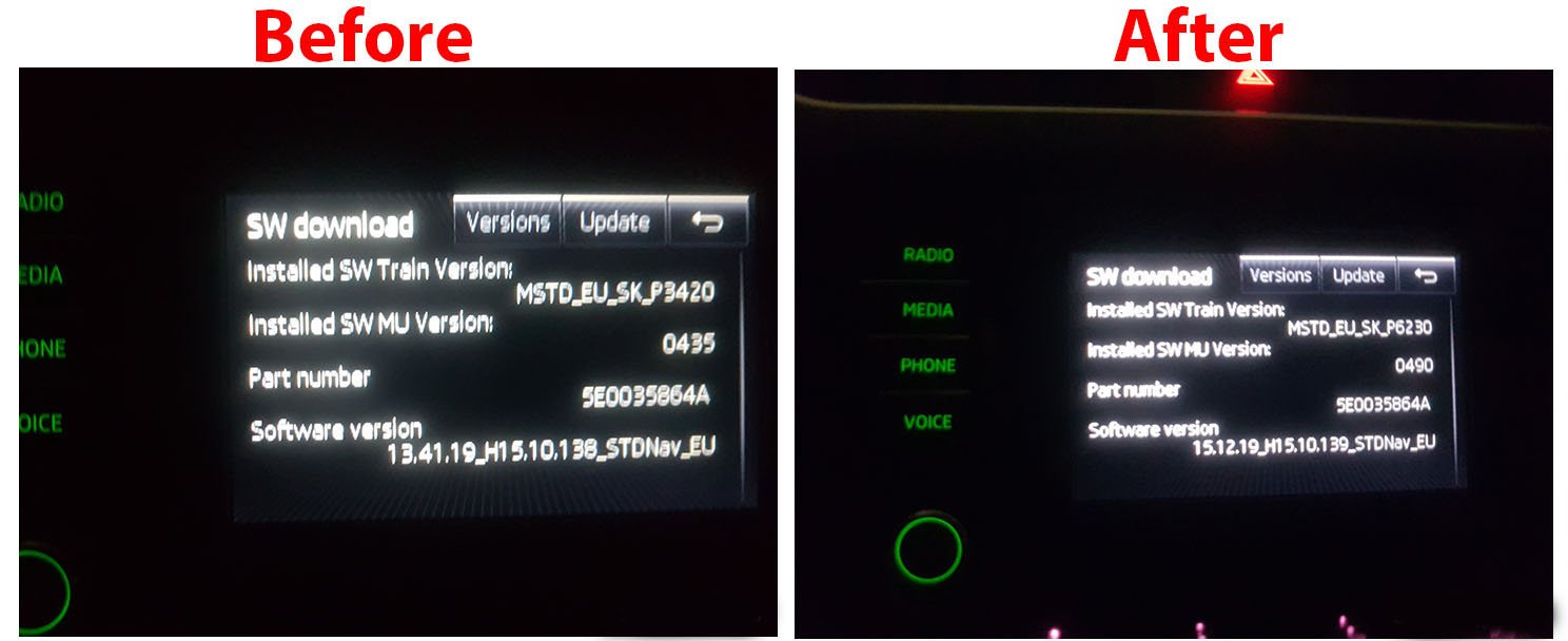

As you can see from the photos, I was on 435 and now I´m on 490, visually I haven't noticed any changes, maybe the screen is more responsive, and the music sound better but it could as well just be my subconscious. Somethings has change, the update is almost 5GB so something must have change.
Is it worth the upgrade, I´ll say from 435 to 490, not really, if your unit works at it should leave it as it is. If someone have a changelog, it will be interesting to see, what has change.

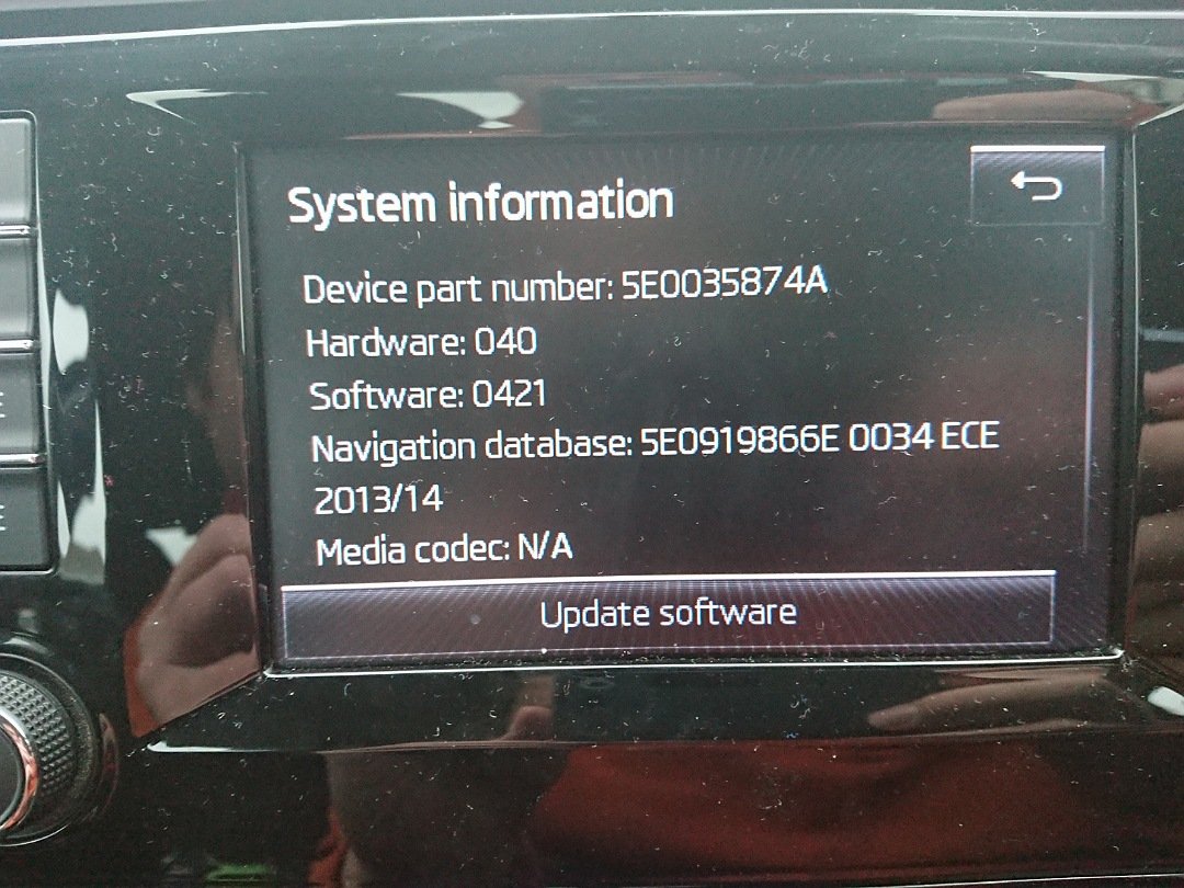

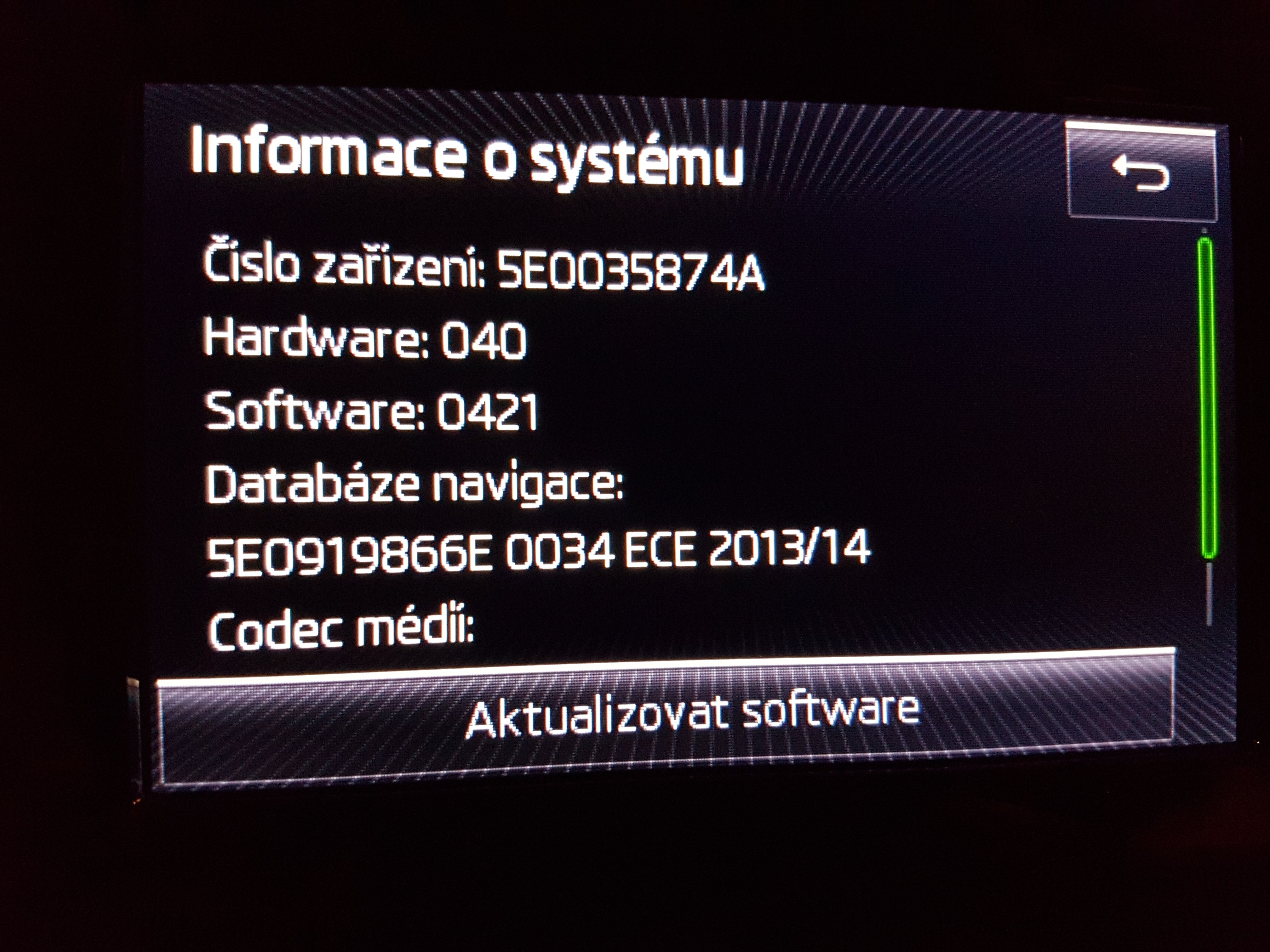

Hello
Can you tell me if my system is up to date ?
