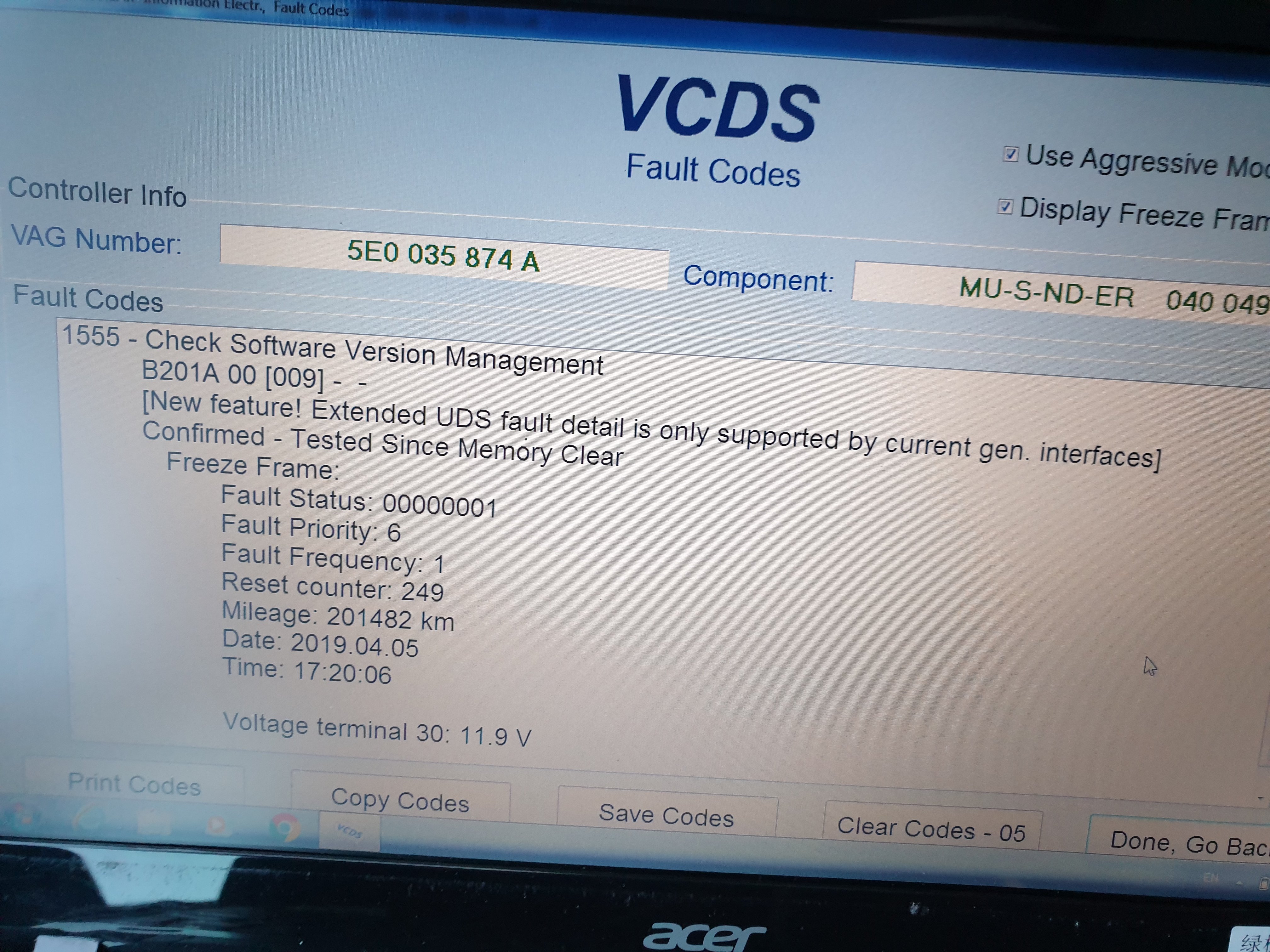

hello. i make the update sw to 0490 mib1/amundsen unit. after that, i erase all errors code find with vcds tool, except one.everthing works fine, but this error still haved,even i erased....any solution,please?
VCDS CODING:
1) 5F (Infotainment) module, Adaptations, channel: 'Confirmation of installation change'
2) Note your current coding
3) Start Windows calculator and set it to 'Programming mode' and select 'HEX' option
4) Calculation: (current coding) Xor C9D2
5) Change the adaptation channel to the new code (Don't be surprised if it changes back to the original coding, this is normal!)
6) VCDS main screen, 'Auto-Scan'
7) Check for fault codes on all modules and clear the DTCs
Note that VCDS displays your code in 'xx xx' format (small letters and a space character).
You have to remove the space before you calculate your new code.
When you enter your new (calculated) code, insert the space again and use lower cases.
EXAMPLE (don't use these values):
'1a 1a' (original coding of the adaptation channel)
1A1A Xor C9D2 equals D3C8
Enter it as 'd3 c8'
If your original code starts with zero(s) just remove them before calculating (i.e. 0A fb=AFB).
If the new (calculated) code is less than 4 characters, insert zeros in the beginning (i.e. FBB=0f bb).

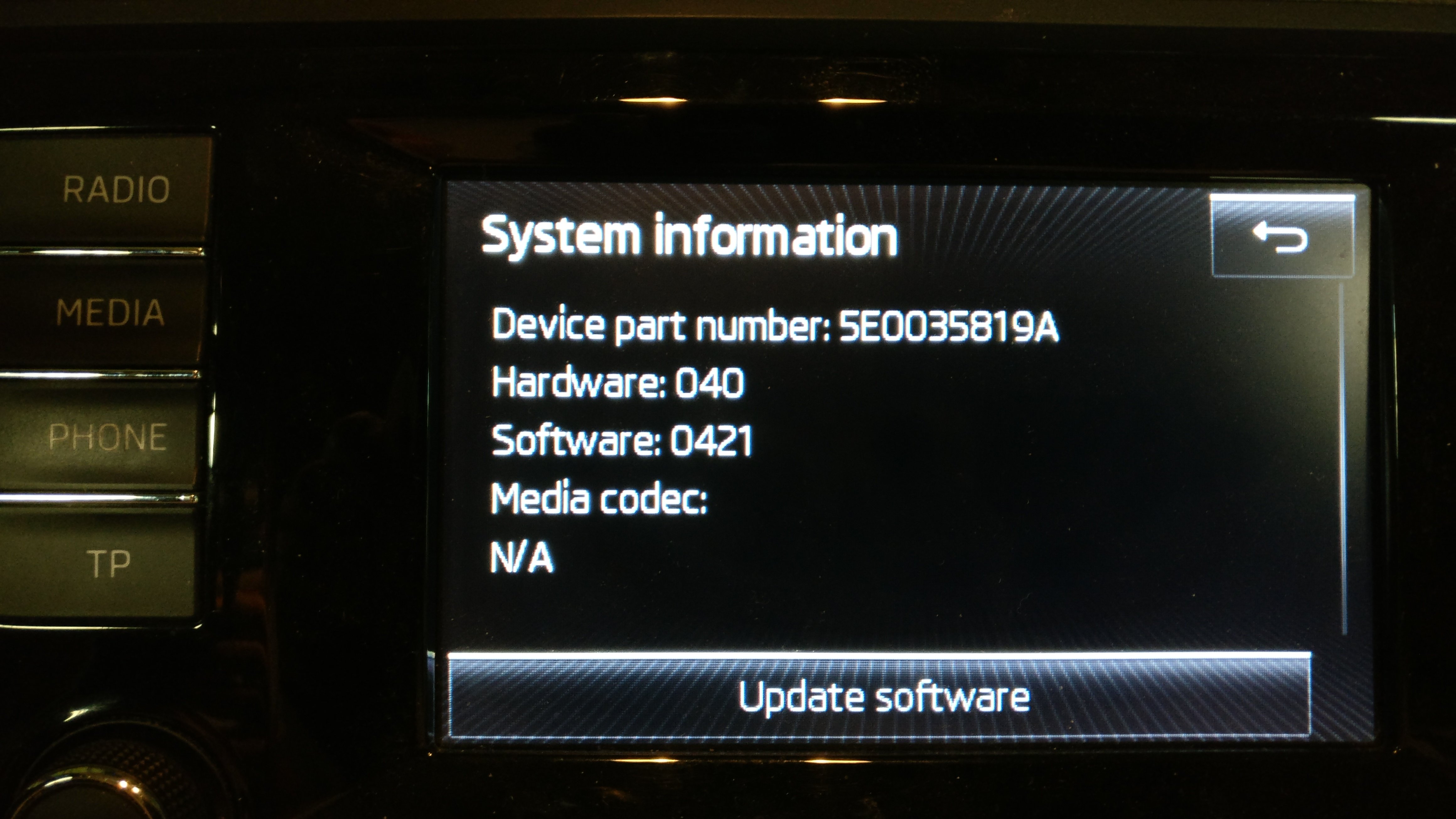

Hello
I have
Device 5E0035874A
Software 0421
and would very much appreciate a link for the latest compatible update.
Thanks!
