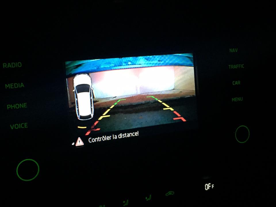

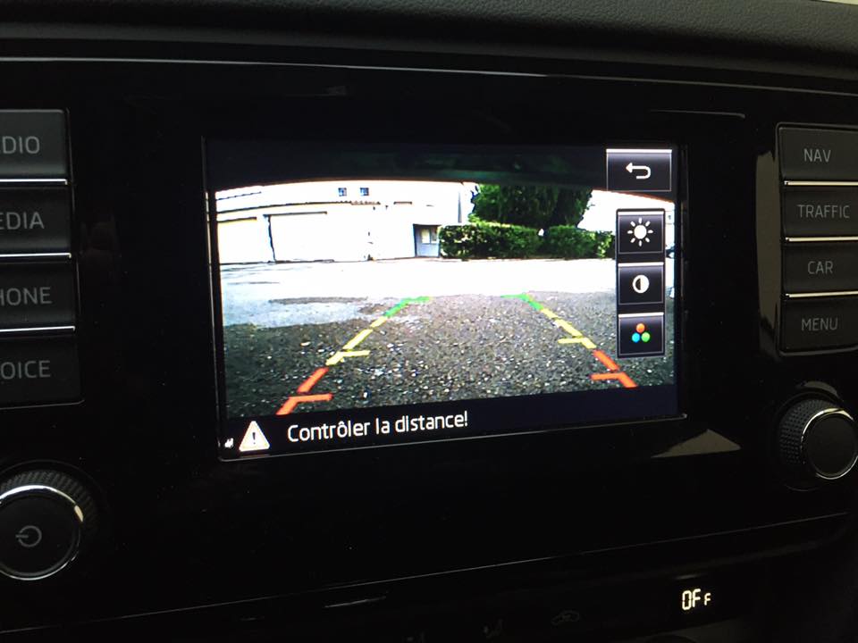

Good evening everyone. finish camera mounting . Here is a picture before the car with "black" mode, and then in transparent mode after updating the radio . Thank you Aki has for his skills !!!

I experienced the same, you need to restart (reboot) your headunit after coding.
Otherwise you will see only the camera picture. Things should work fine after. :)
Press and hold the POWER button for cca. 10-15 seconds until Skoda logo appears again.
You probably don't need to code the park assist module.
I have only rear parking sensors and it works fine with just coding the 5F.
With your 0435 FW you will have the 'advanced' display with transparent background.
Check the youtube videos in post #99 to see the difference.
(FYI: you must have the factory bluetooth module to see the camera picture.)
More info here: http://www.briskoda.net/forums/topic/341794-new-feature-simply-clever/
Edit: 2nd (new) youtube video is gone, check this.
Edited by aki78
