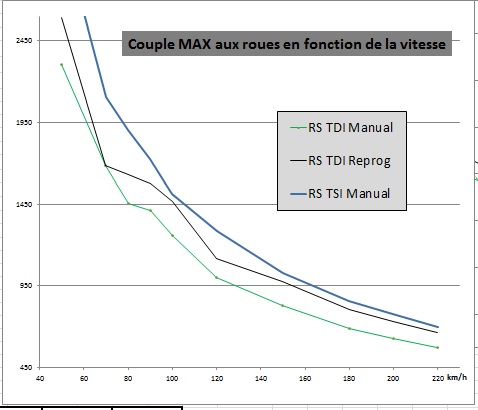

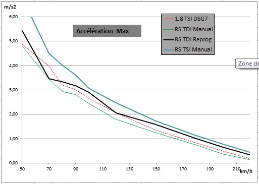

I made some 'theoritical' computation some times ago related to this subject.
I used the Power and Torque curves from a stage 1 remap TDI, so only 220hp, 450Nm.
Already, we can see the gearbox ratios are not very well suited to the power and torque increase, especially at low speeds.
The remap TDi closes the TSI performances only at high speeds.
First curve shows the max torque (in Nm) made availble to wheels for different cars.
The second one shows the associated max acceleration (in m.s-2).
("RS TDI reprog" stands for the stage 1 TDI remap)

Seems a little biased comparing a mapped TDI VRS against a standard petrol version.
Try putting the mapped TDI against a mapped petrol VRS, Revo for instance do a stage 1 map for the TSI mk3 VRS which comes in at between 309-328bhp and between 320 and 360Lbft of torque.
I know which one my money would be on.
