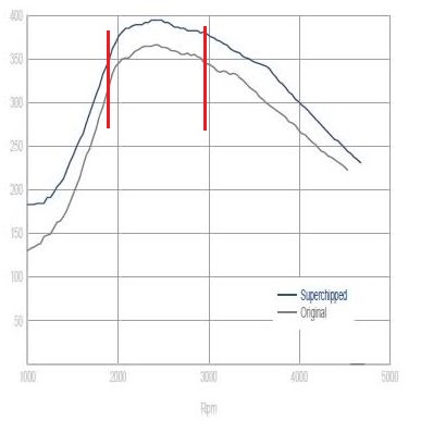

Back to the OP's question, a couple of people did suggest it earlier (before the handbags started flying :p) I will qualify this by saying this is from my experience of other diesels and I have not driven a vRS TDI (before any handbags come my way)
Diesels tend to be better in higher gears than you would be in a petrol to make use of the torque, so the gearchanges are critical.
If you rev it to the redline in 1st you will be getting nowhere for half of that as you are past peak torque. If you then change gear it puts you at the end (if not past) the peak torque again. Keep revving it like a petrol and it will not get the best out of the engine as you will miss the torque band in each gear.
If you rev it to the point the torque drops off (about 2700 -3000 in most) then change, your revs will end up back at the start of peak torque and have another dose of torque push. Change at the same point again and you are in third at the start of peak torque and that will get you places.
It feels really alien to change early, like "short shifting" in a petrol and a petrol (corsa?) revved to the redilne may momentarily get ahead but very quickly the car will be in a higher gear in the middle of the torque curve and will be going as well as it can.
If adrenalin gets the better of you and you hit the redline in 1st - try straight into 3rd?
This torque curve is for the Ford (PSA) 2.0 TDCi (which I'm a big fan of) but the same principle applies, get it between the red lines and try to keep it there.
Get to top of torque curve in top gear and then a petrol will then have the edge but that is normally way past the legal limit for most diesels and explains why they can be very effective on the road but in a straight run to top speed would lose out to an equivalent petrol. it also explains why diesel and DSG don't always get along for some people
I am a big fan of common-rail diesels, but I now drive a petrol - Horses for Courses

Not true. Torque is multiplied by the gear ratio so even at the top of the Rev range you have more torque than in the gear above.
