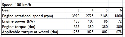

I intend to show that the best performance (acceleration) of a car, be it diesel or petrol, is achieved when keeping the engine in its rev range of max power, and well above the revs of max torque.
Let's take a concrete exemple: an RS TDI driven at 100km/h (62mph).
Based on the wheel radius, this correspond to a wheel angular speed of ~860rpm.
We want now to apply the max possible acceleration to this car, thus the max possible torque to this wheel.
We can do this using several possible gears.
Let's try in third gear:
Based on the axle ratio and 3rd gear ratio, a 860rpm wheel rotational speed requires the engine revs to be ~3920rpm.
We need the engine to be at max load, so 3920rpm corresponds to a 135kW engine power and a 325Nm engine torque.
The transmission ratio as above translates the 325Nm engine torque into a max applicable torque at wheel of 1255Nm.
(note that the power at wheel is then the max engine power).
You can repeat the computation from 4th to 6th gear with the following result:
Here we can see the max torque applicable to the wheel (thus the max acceleration) is achieved with 3rd gear,
when engine revs is in the max power range and when engine torque is below the max engine torque value.

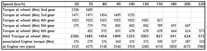

The same can be repeated with different car speed values.
The result is given below:
This table shows that whatever the car speed, the max acceleration is always achieved with a gear making the engine revs above the max engine torque revs (3000rpm), and always close or within the max engine power revs range (from 3500 to 4000rpm).
This is always the case when the gearbox is well tuned for the engine characteristics.
