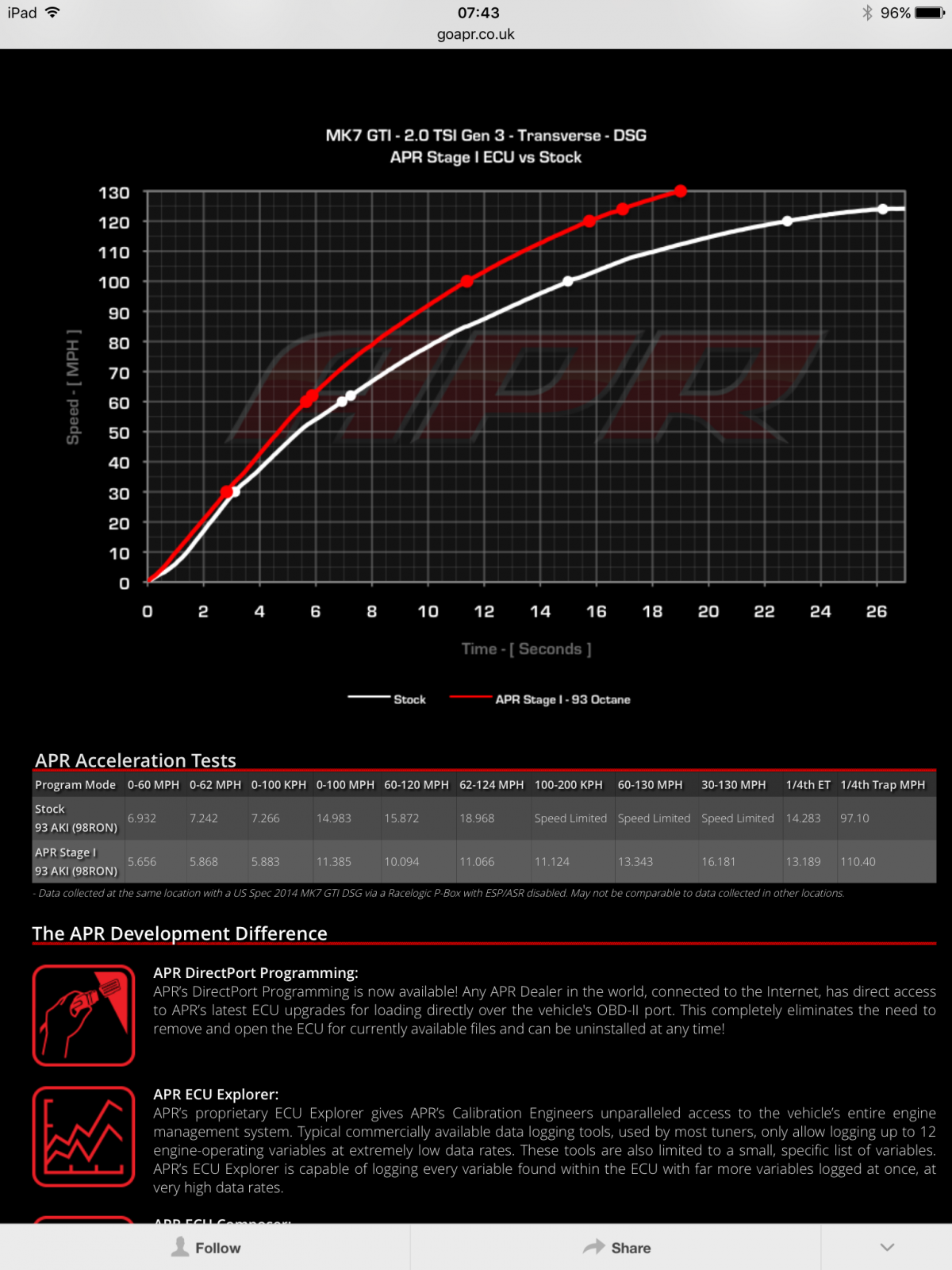

I'd be interested to know some definable differences of these things. Like a quarter mile drag of a standard car versus remapped.
(Not that I'm actually interested in having one just now/yet, but would just be interesting to paint an actual picture of the actual real world differences)
Some real quarter mile times for normal vs this stuff in real world terms, only just interested as you hear a lot about these sort of things but its only really relevant in real world terms !
Taken from APR website using their Golf GTI
Thats quite close figures to my mates non-supercharged Menaro v8 6.2 unmodified.
That said even with those figures I wouldn't be in a hurry to Santa Pod even with that, I'd just hate to see a constant stream of red top novas and corsas coming alongside you, hardly worth bothering for ;)
Mind you might have been to some degree his lack of experience, he was struggling to get sub 15s and his car was meant to do at least 14 or even less! Unlike the corsa boys though he'd gone to absolutely no effort to lighten his car etc.
