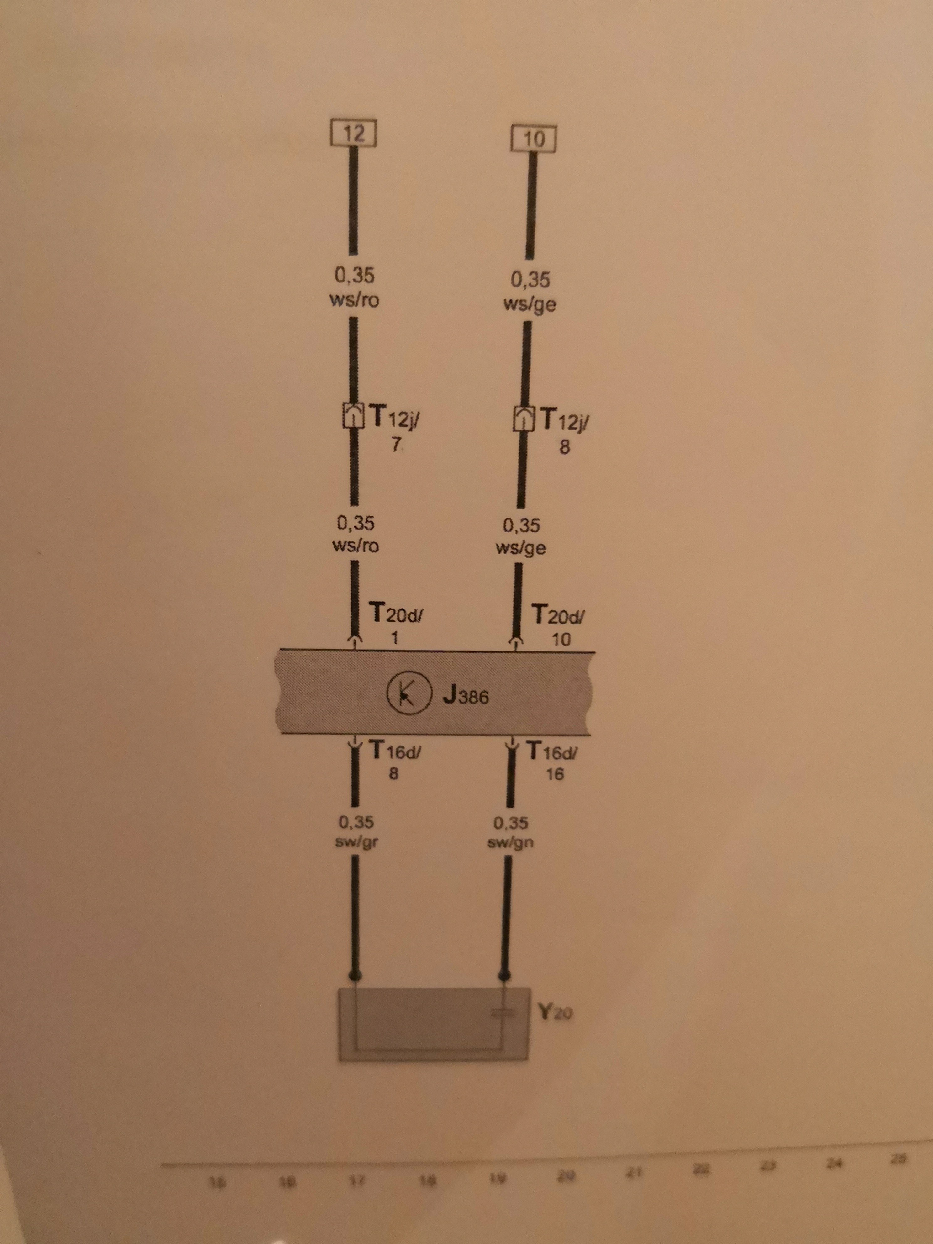

One wire runs from the dimming mirror, through the door loom and to the auto-dimming rear view mirror. That's what turns them on/off. Pretty sure the other wire is just ground :)
I have retrofited dimming mirrors on my car. Actually there are two wires that run from mirror, through the door controller (just passing through the controller), door loom and to the rear view mirror. None of the wires is grounded (maybe inside rear view mirror?) 15402250272102636434149891902100.thumb.jpg.76aa793b44e4d15f2f5884746caa32a7.jpg

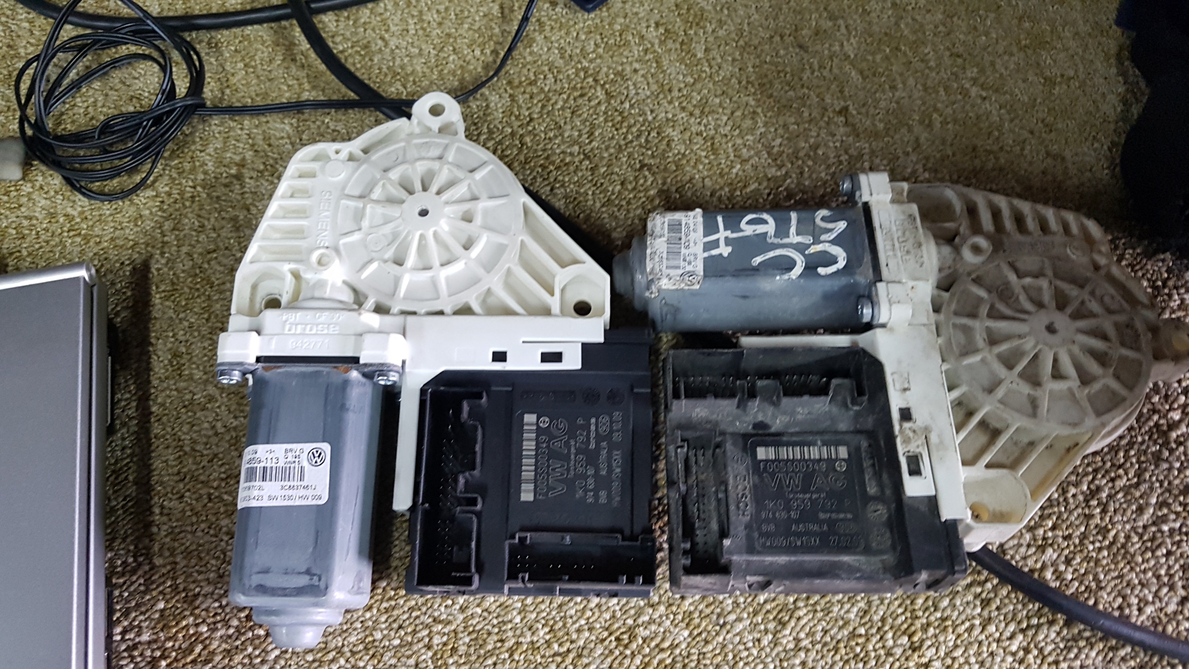

I found 2 controlers from passat cc ...
will see if it works
Thing with controllers from other cars is that it might not work correctly on auto lifting/lowering the window. Although they have same code on controller they have different code written on EEPROM. I have experienced this issue when retrofited folding mirrors on my car. I had two door controllers from a Golf but did not work auto window. I had to write EEPROM with code from Octavia.

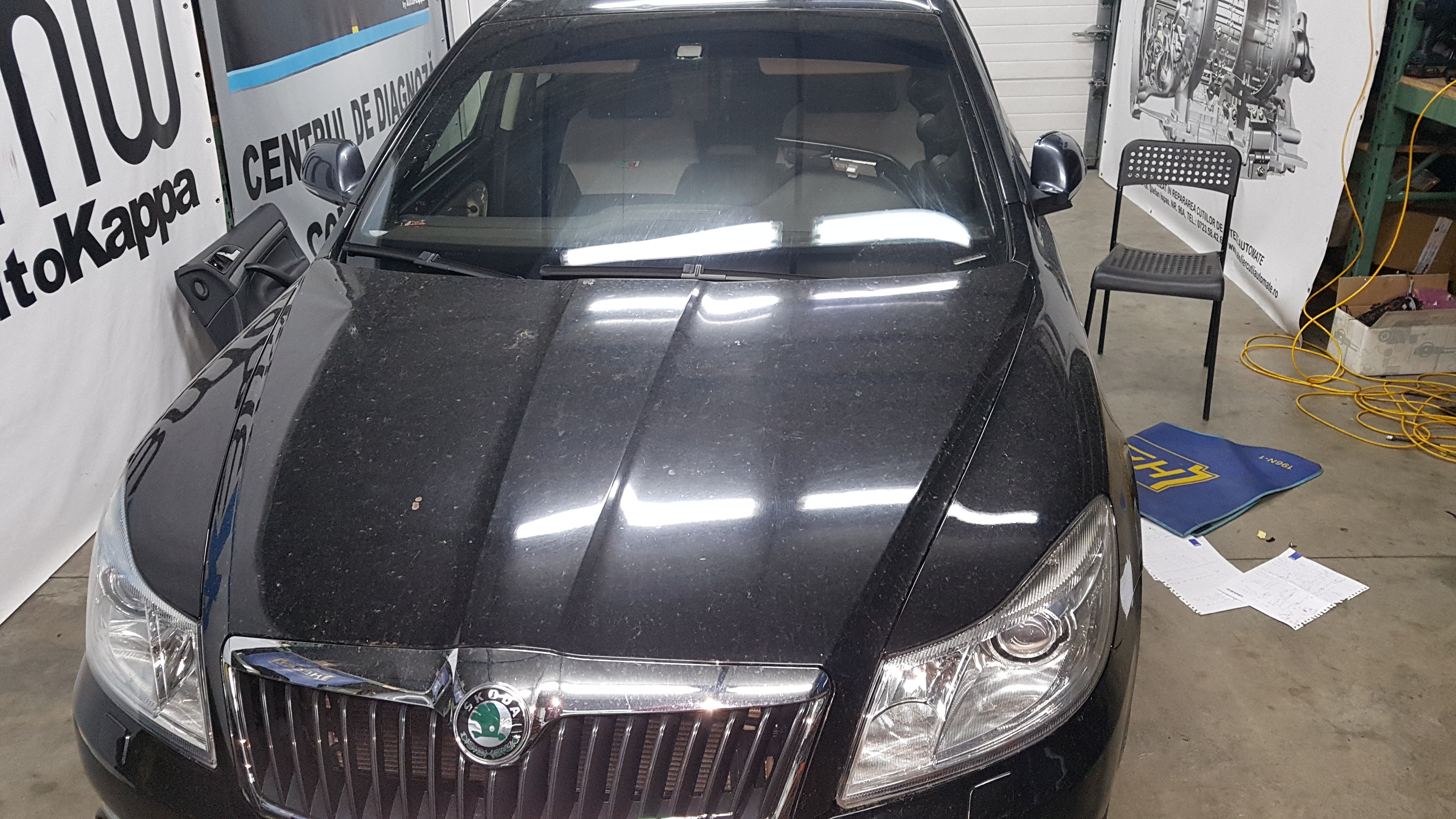

bleahhh...not working because i have gen 2 on my car and cc controler are gen 3 and i fond sometging on  my gti.com and wiring inside door is different!
i moved all wires for gen 3 max from gen 2 min and this is the result...
one on one off...i can not set them to fold corectly....
can somebody  give me the sgo file for door controlers...i need to flash them because they came from passat cc...
Edited by gabi2004
I don't think there is an SGO available. Dealer tools will parameterise the EEPROM using an online connection but that may refuse give the incorrect part numbers.
Assuming it's just one mirror that's incorrectly folding, you could try flipping the wires on that side?
yes...with the wires from pin 14 and 15  reversed it is ok  but the windows opens 2 cm when i unlock the doors...because the controlers are from passat cc ...i gues i need another  controlers...if sgo it is not enough...
If you have ODIS-e you could do what I did. You can edit EEPROM controller one byte at a time with a correct code. Takes a lot of time and it is kinda risky too, one wrong byte and you can destroy the controller, or worse, maybe something else on your car.
Not something I encouraged you to do but it worked for me.
