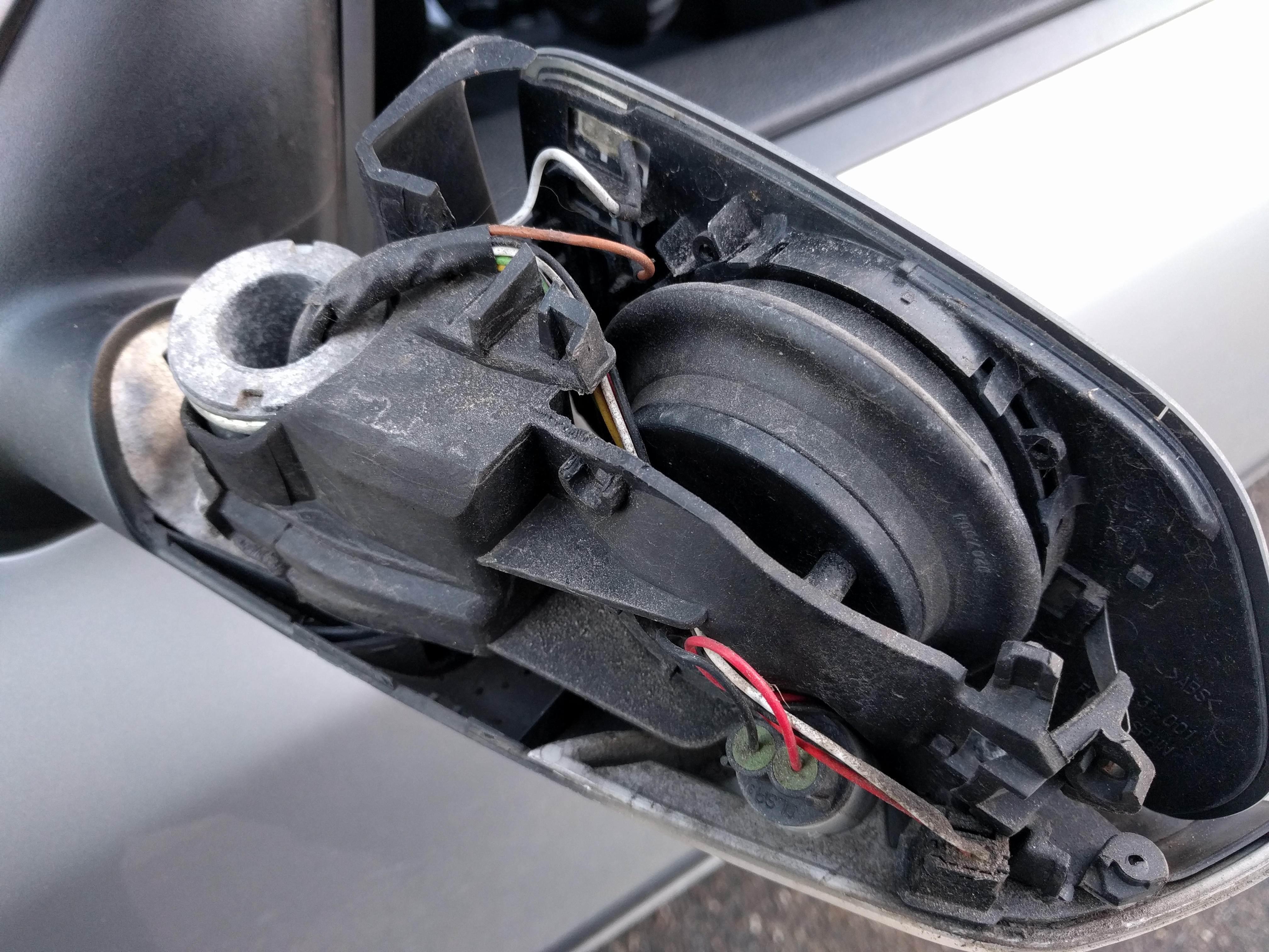

This is a pic of what mine look. See the 2 cables going into the puddle lights. You need to install those too if you don't have them. No need for a whole mirror. Just the bottom part I think.
13 minutes ago, Inex said:
Hmm. Think you need to draw wires for the lights unless they are already present.
My car has them from the factory. The only reason I mentioned them in my post is because I think that's all the cabling you can get from the factory to a pre-fl.
OK. I guess this would involve removing the door card and threading wires through the gator between door and body. Then where would they connect to - CECM?
How about reverse dip, does that require any retrofitting?
I've never done it before so I wouldn't know. Hopefully someone more experienced around here would know.

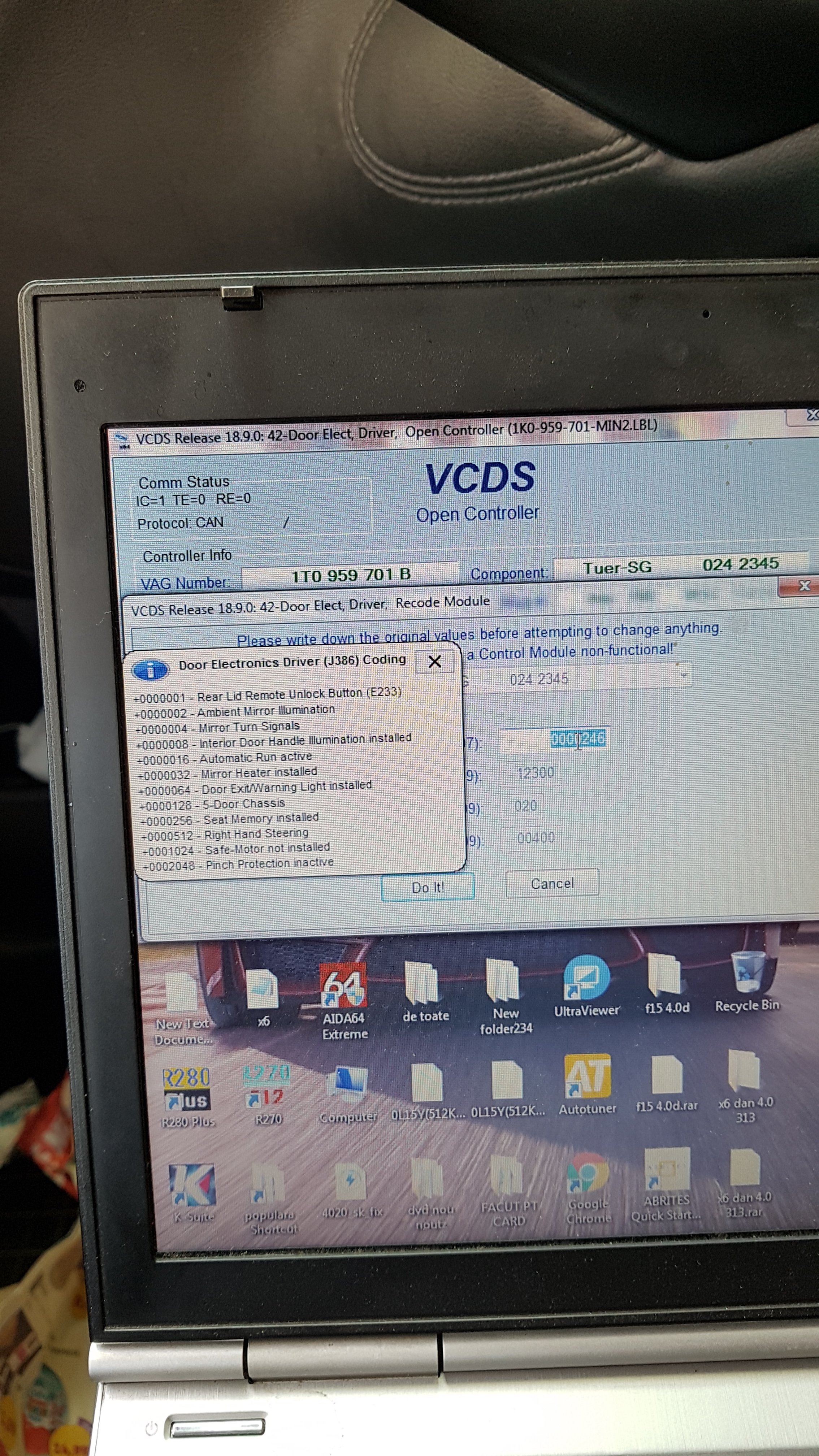

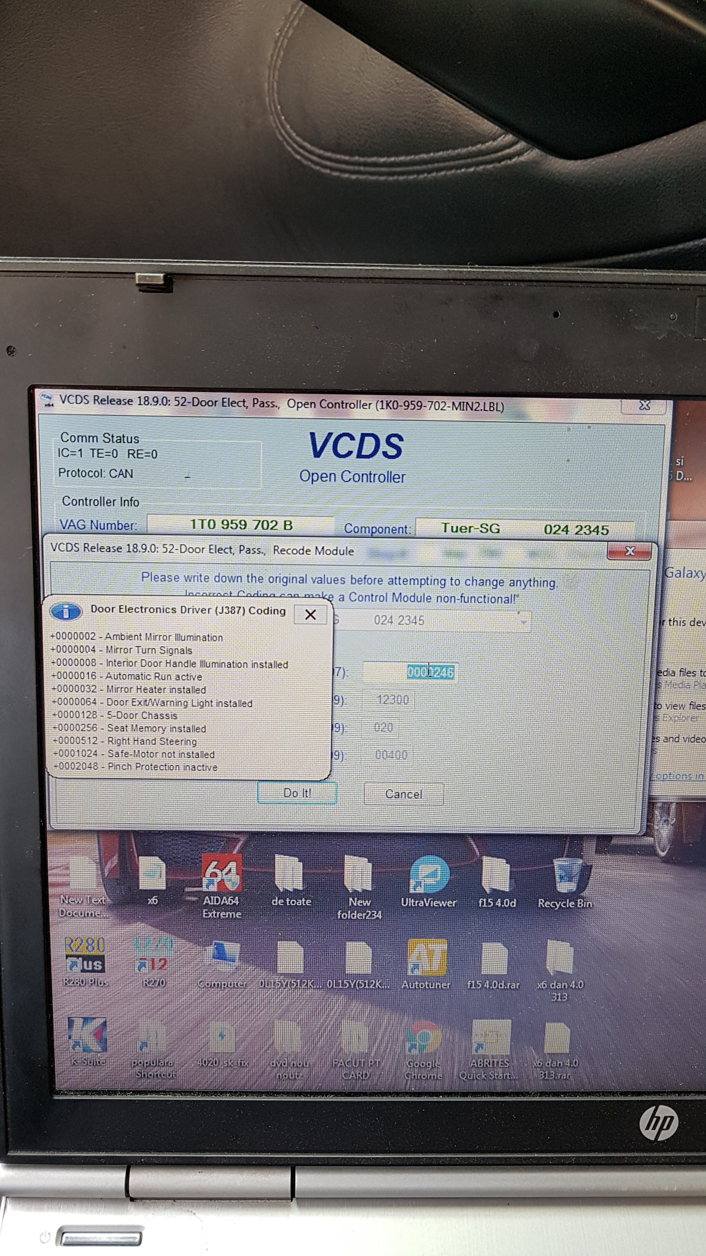

Had my car scanned.
Though the last letter is different, can I assume I can play and play the mirrors?
Address 42: Door Elect, Driver        Labels:. 1K0-959-701-MIN3.clb
   Part No SW: 1T0 959 701 T    HW: 1T0 959 701 T
Address 52: Door Elect, Pass.        Labels:. 1K0-959-702-MIN3.clb
   Part No SW: 1T0 959 702 R    HW: 1T0 959 702 R

these controllers don't support folding mirrors

hi! my controlers  does not suport folding...what can i do?
Replace them.
They look to be pre-fl part numbers so it may be a challenge to fit folding mirrors are I think they are FL only.
