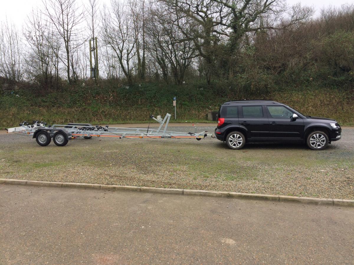

Here is my setup and even now that I have a 4x4 I still sometimes use the rope trick to keep away from losing traction on weed.
Edited by Yetigreenline2
I must say thats Impressive, a Yeti pulling a Boat and a Motor Home

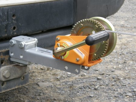

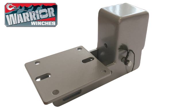

For launching recovering use a towbar mounted winch.

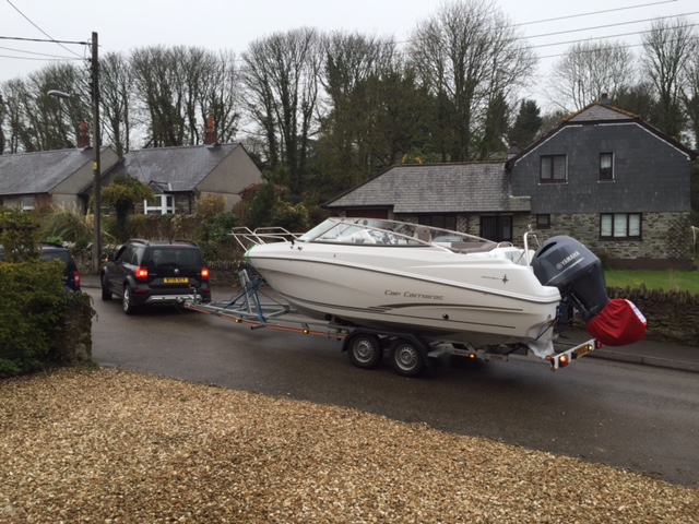

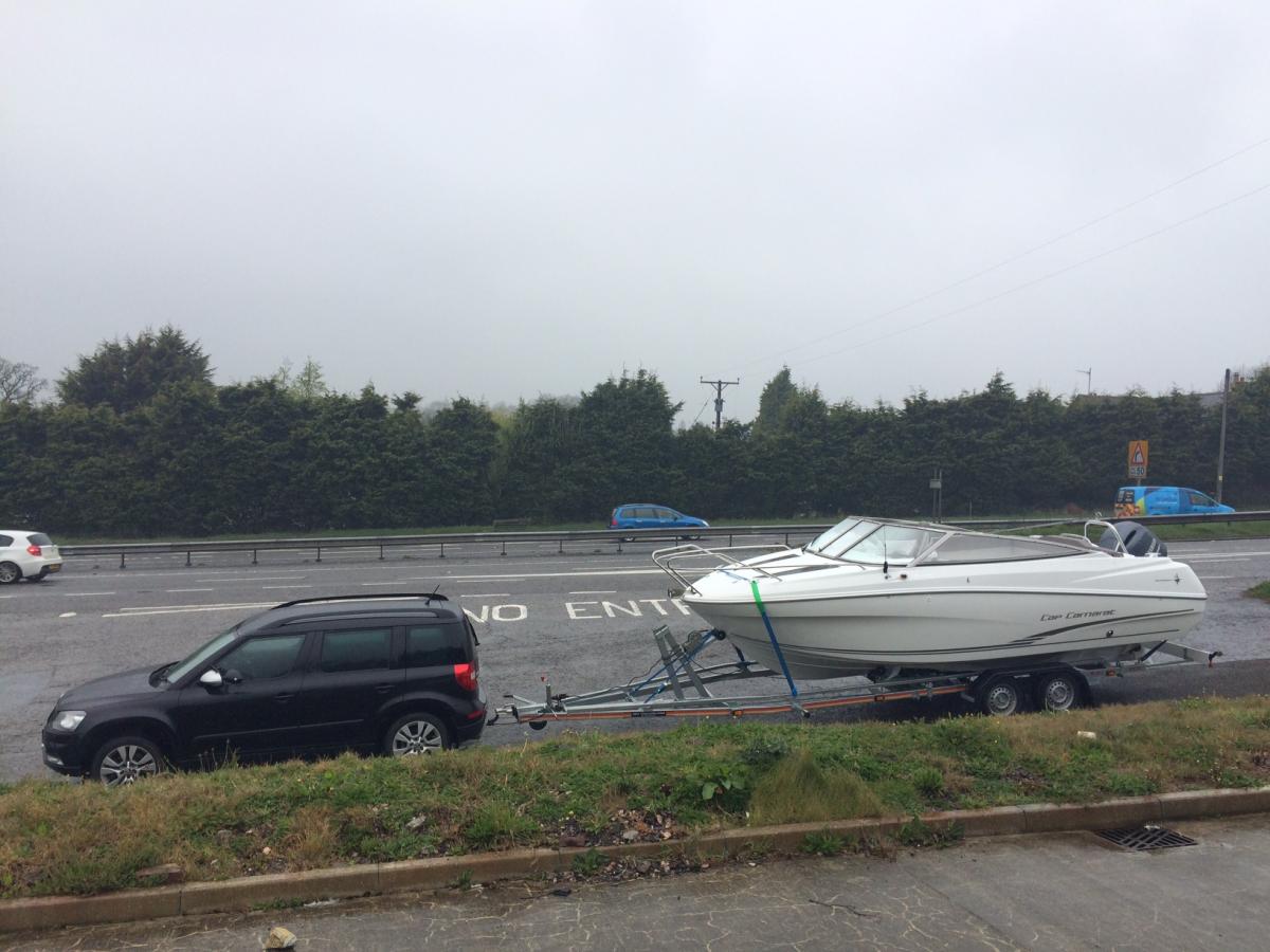

Posted an empty boat trailer photo and the Yeti earlier in this trail and thought I'd post another now we've collected our new boat.
Car weighs 1660kg, boat weighs 2050kg (according to our local DOT weigh bridge) so not only legal but also tows like a dream! The Yeti towed the boat quite happily just under 200 miles from Lymington down the horrid and steep coast road to Cornwall - though it's much happier at 60mph+ in 6th or 5th at 2000rpm +

Hi there!
Plated trailer weight is 2600kg. On it's own it weighs 520kg plus the boat weight of 1530kg giving me a legal mass of 2050kg. We did loads of research and listened carefully to the advice that Ryeman, Llanigraham and Bossfox (and others) had given on this forum about Yeti towing at the upper limits before we embarked on this. VOSA's website confirms that the individual car and trailer plated weights must not be exceeded (2100kg for my 170 Elegance 4x4 & 2600kg for the trailer) and that the cars Gross Train Weight (4210kg) and individual axle weights must also not be exceeded. There was some confusion about trailer down plating a few years ago, but this is no longer required provided the 'actuals' do not exceed the 'plated'.

If you've noticed that our Yeti looks a little lower than normal it's not because of the 70kg nose weight - it's the quarter ton of gravel in the passengers footwell I used as ballast to even up the mass ratio in this combination without my usual passengers!
So the Yeti in these pictures has a rolling weight of 1660kg (car, full tank of fuel and me), 250kg gravel (which is the same weight as the passengers and kit that I'll add when towing as a family), 40kg of spare wheels (car and boat each) and 20kg of tools and 2 ton jack.
So a 1970kg car versus a 2040kg trailer; or 2040kg car and 1970kg trailer once the nose weight's transferred from the trailer to the car. Any which way you cut it I'm still legal and am hovering around the 100% mark.
