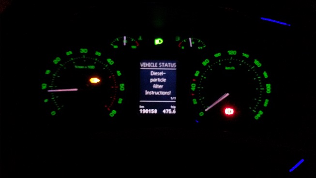

Is it simply because the non vrs pre FL diesels didn't have a dpf so the non vrs clocks don't have the light?
My 2008 pre-fl (BLS engine) have the DPF light and even a proper message is displayed on the maxi-dot.
Thanks, this is good news :)
So even if I don't get a light I should get the written warning.
