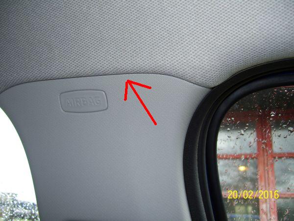

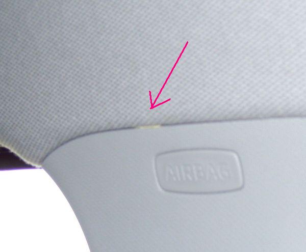

"i have some noise coming from the left side of the car, around the windscreen pillar, passanger side somewhere, it rattles at any speed over lets say 20mph, and it's annoying."
Perhaps had similar noise.
The interior roof upholstery is a rather loose fit.
I just manipulated it with the fingers, and the weak noise disappeared.
Hope it's the same source for the noise as your experience.
I
Edited by torslunde
And as your picture shows there's an airbag and electrical stuff behind there that could be a little loose?
