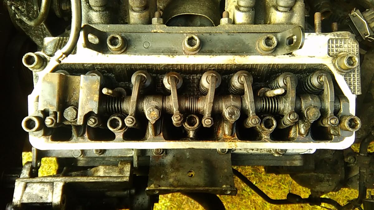

Felicia carbon in rocker box

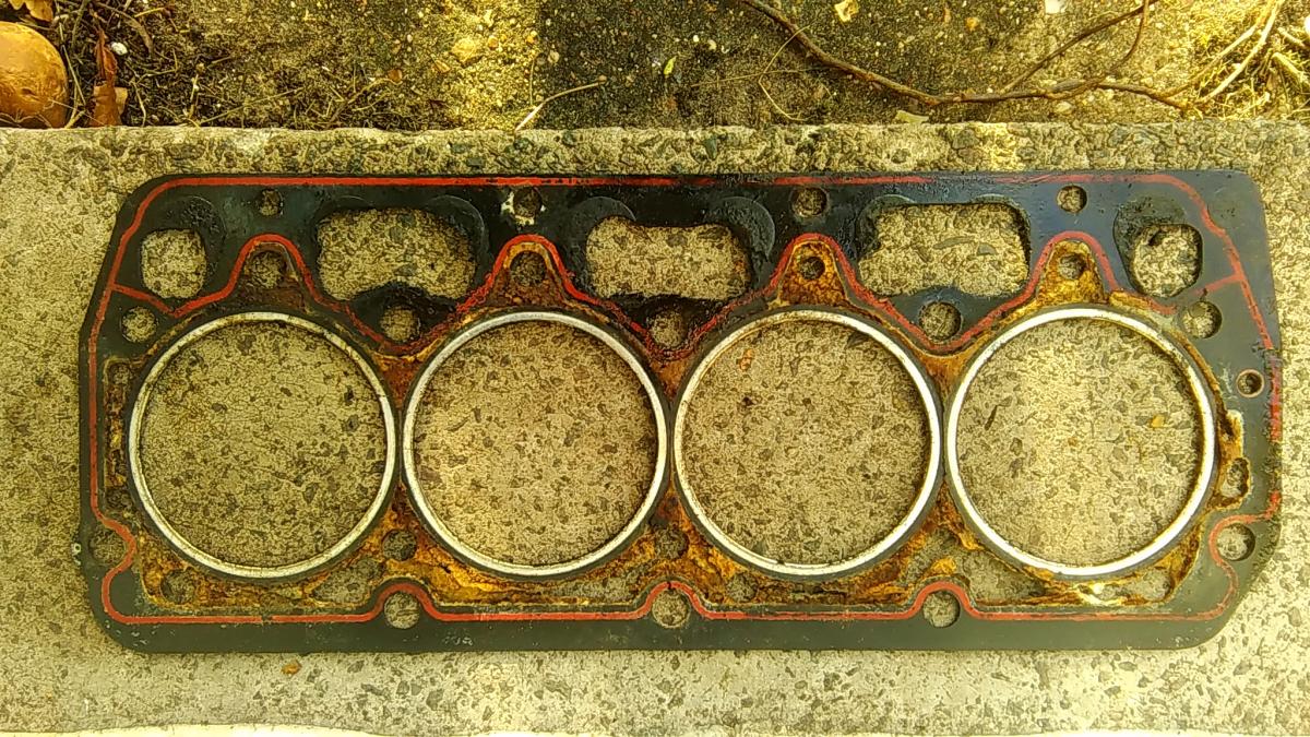

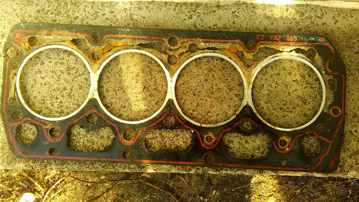

Head gasket photo today.
Rockers clean and now oiled.

  • Just sounds like a very neglected example to be honest. Brown staining in the header bottle is likely from having plain water in the cooling system. The crap in the rocker cover is what happens when

Looks like a couple of candidate places on the topside of the gasket for coolant to have been getting into pot 3, I think.
Since we have enough proof the engine maintenance has been a disaster (both on oil and cooling) I can only assume the only thing that worried the ex-owner was overheating. For obvious reasons, duh. Cooking oil and tap water are not listed as maintenance materials...
