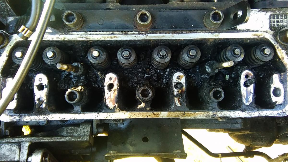

  • Just sounds like a very neglected example to be honest. Brown staining in the header bottle is likely from having plain water in the cooling system. The crap in the rocker cover is what happens when
  • Trying them with engine at operating temp, rather than cold should make it easier to undo them I think. If I were you, I would prioritise the sump end of things over the head, and see whether or not

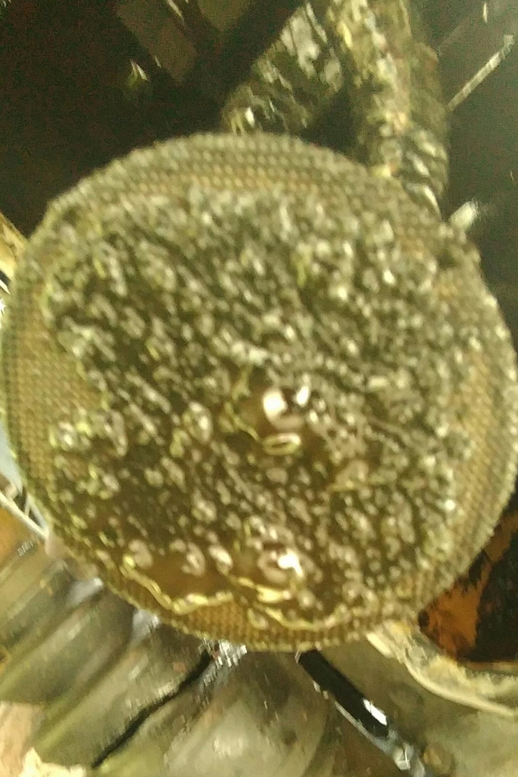

  • Ok Ricardo, I went to the full site on my Android phone. It seems to have allowed me to upload pictures of oil strainer and a small shot of sump slurry. I've cracked the head bolts and nuts, photos o

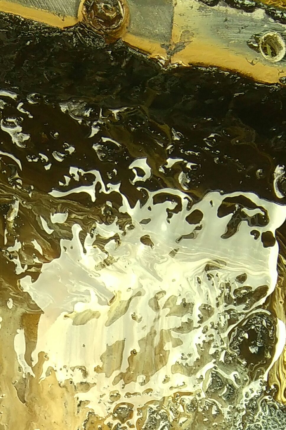

I've cracked the head bolts and nuts, photos of top of engine to follow, tomorrow hopefully.
Any metallic particles in there? If not (too much) you might get away only with a proper flush of the lubrication system. If that restores the oil pressure, you're sorted.
Hint: if you have compressed air available, remove the oil pressure switch and blow through the hole. Same for oil filter.
It was like a tarmac surface blocking the strainer. I've emptied the old oil and flushed the engine. I will clean the sump again before filling with new oil and fitting a new filter. The state of HG will tell the rest of the story.
I've set my camera to a lower resolution, so further images won't have to be cropped. The photos I took today have files that are too big, so I had to crop sections to upload, reducing file size.
Also, I kindly let my friend clean the sump, he assures me, there was no metal fragments in it, only carbon.

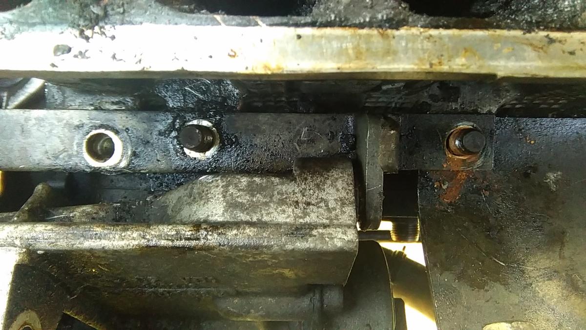

Can somebody please tell me urgently how to take the bracket off the front of the cylinder head please? It's held um by a part of the Casting in the centre of the photo.
Photos never loaded first time. Thanks I found the link you sent me. It helped. Head off, cleaned and checked, then refitted with new gasket. Photos to follow, I'm hurting all over, having done the job in the cold weather.

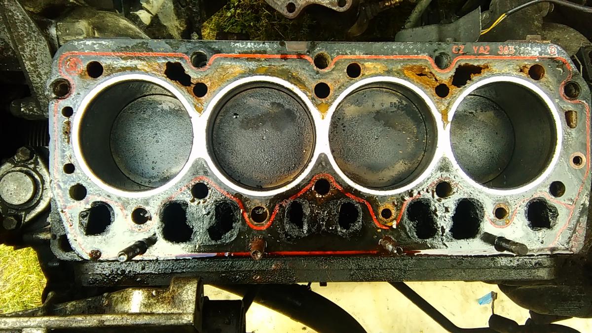

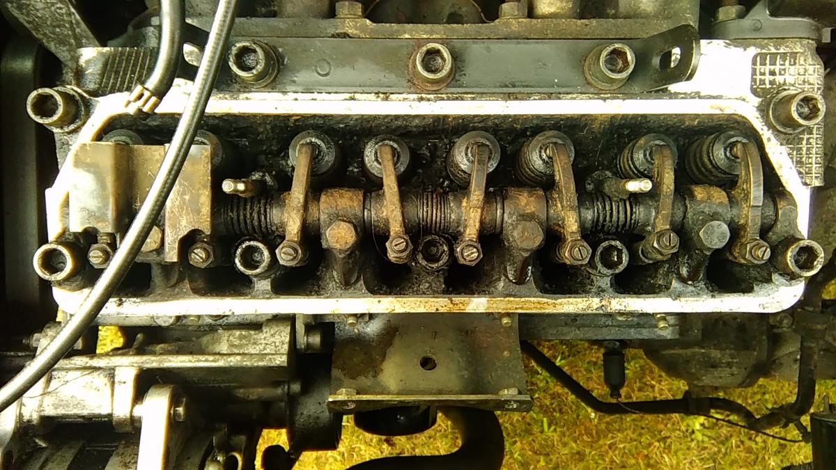

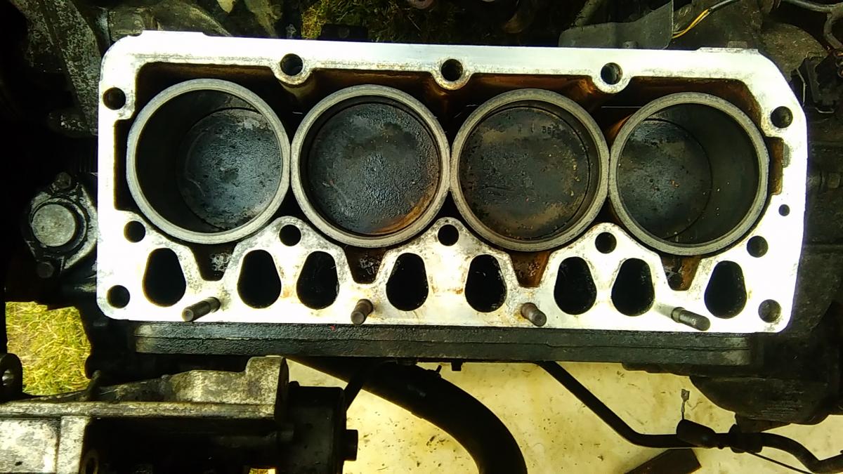

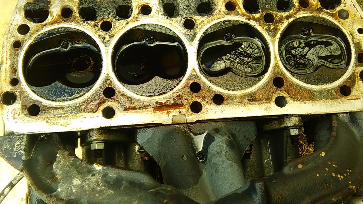

Before photos. Showing rockers. Under rocker arm. Cylinder block. Wet valve seat test.
And the cleaned off block. The gasket had perished accross the water ways on the block.
I was short of daylight when I put the head on, so I'm not sure if I stopped to take a photo of the prepared head.
OMG... that has been a very unhappy engine.
I gather you didn't feel the need to resurface the head? :think: :wonder:
Yes you gather right. It wasn't warped, just pitted around coolant passages.

One more thing. Can you take a photo of the old HG underside please?
Yes. Thanks. Will do all including photo.
